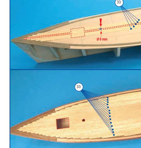

I have a question that I hope someone can answer. I'm currently planking the deck, and the manual seems to suggest that the deck boards should overlap waterways. All would be fine but both the waterways and deck boards are 1mm thick, so it's impossible (or so it seems) to make it work and still look good. Attached is a relevant part of the instruction, and here is how it looks on a real ship (with thanks to jeff averre for providing the photos): Image on Photobucket
I'm thinking about bending and shaping the outermost planks in the same way they are done on a real ship (not sure if possible or practical), or sanding the waterways almost flat so the aren't so thick and then following the manual and making the deck overlap (which also seem true to the original as the waterways are lower than the deck).

#7 Posted : 30 July 2015 11:43:18
Hi Michu, can see where your thinking is taking you. Remember though, although the planks at 1mm thick do overlap, you will when complete be sanding the complete deck over with fine grade sandpaper. The sanding process will reduce the thickness of the deck planking and remove any visible ridges between planks thereby reducing the thickness of the overhang too. Also, you are not going to see the majority of the bow section in question as it is covered by the next deck. You can of course also reduce the thickness of the waterways ... The deck planks on the real ship are not bent, they are tapered along the outer edge and there is a finishing off strip along the outer edge that is notched to accommodate the plank ends, that finishing off strip sits over the waterways, difficult to reproduce depending on woodworking skills......Cool Cool Cool .. Hope this helps..

Thanks Alan, that pushes me in the right direction I think. I'm more concerned not about the thickness of the deck planks over waterways, but about thickness of the waterways under the deck planks - it is quite substantial, at this scale it translates into 8.4cm of a ridge between the deck base and the top of waterways - and since the deck planks reach this ridge only at their end, at an acute angle, I see a lot of potential for unevenness and twisting of the deck planks, not even mentioning lack of contact with deck base board needed for gluing.
So I'll probably sand the waterways a bit, to around .5mm thickness, then apply decking, and then sand the whole deck surface again.

No probs Michu, here to help where I can.... If you are going to sand the waterways down to around 0.5mm then you could also consider very carefully notching the waterways to accommodate the deck planks ends, elimiates the need for an overhang altogether and still gives you the step down from the deck (1mm thick) to the waterways... As a test, you could try notching a scrap piece of walnut to see how much of a challenge it would be.... Just something else to consider...
