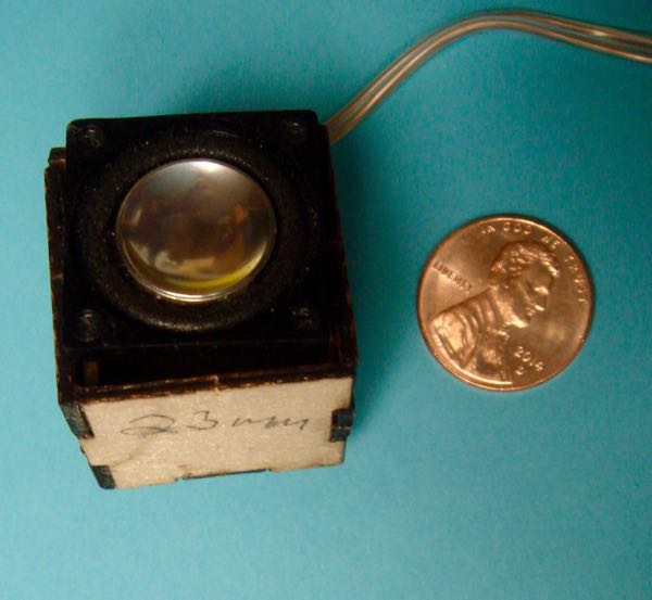

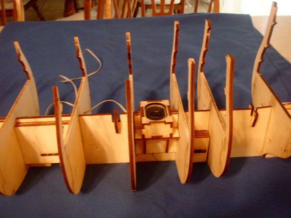

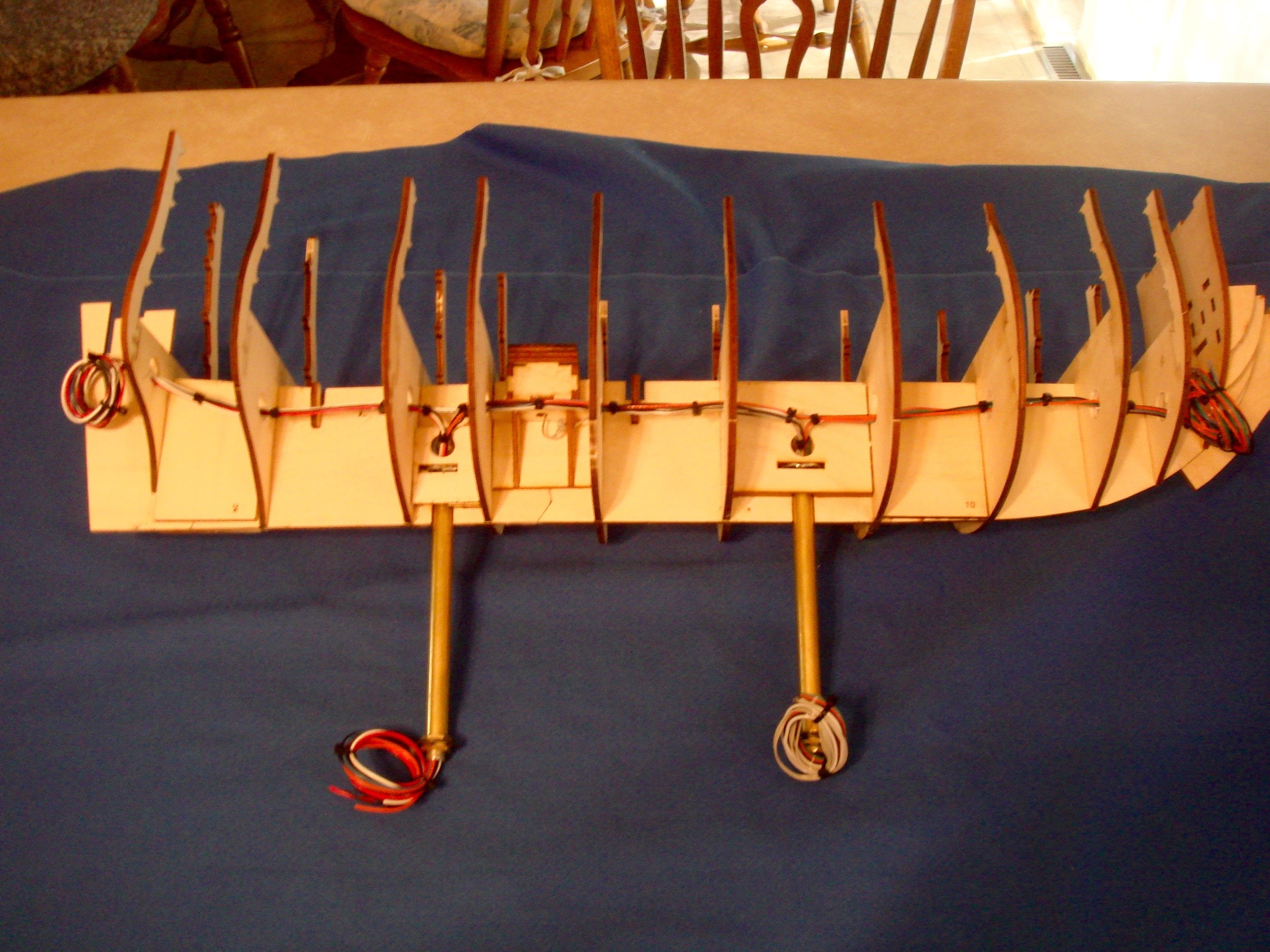

I've been thinking long and hard about how I'm going to add sound and lighting to my Sovereign of the Seas. I have finally decided to use 4 lighting circuits - 2 toward the bow, and 2 toward the stern. I will use 3 speakers for sound. The largest speaker will be in the center of the ship and two smaller ones will be mounted forward and aft and higher (one in the gallery and one in the forecastle). The sound and light board, along with the amplifier will be mounted under the display table. The first thing I had to decide was how to run the wires to the inside of the ship. I decided to use the threaded pipe that comes in lamps and I re-threaded it to add T-nuts. I cut out an area on the spine of the ship and reinforced it to accommodate the T-nus. I found some polished brass tubing that fit over the threaded pipe. I haven't determined a final length for the pipes yet.
MikeL attached the following image(s):

#9 Posted : 02 August 2015 01:52:50
Rank: Amateur level 2
Joined: 03/11/2014
Posts: 46
Points: 121
Location: Random Lake WI 53075
Forgot to include the picture that shows the pipes with the brass tubing.
#10 Posted : 02 August 2015 09:53:21
Very interesting Mike and looks like a good solution for lights and sound, will be following with interest....Cool Cool.. As it looks as if you're not using a build jig you'll need to be extra careful to ensure the keel stays absolutely straight and true, especially during the early planking phase.....Cool Cool ..
