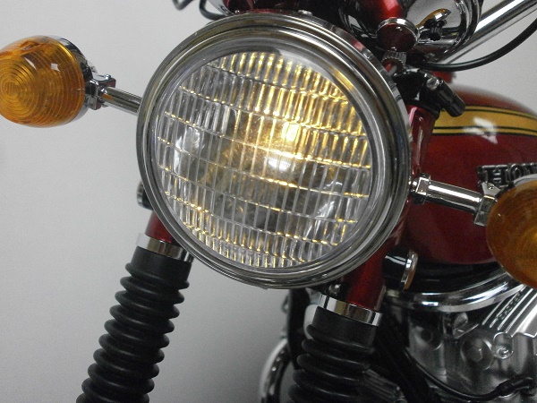

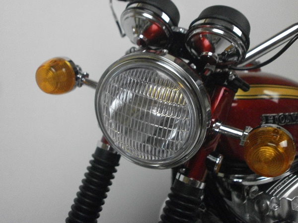

The Headlight, Instruments and Brake light

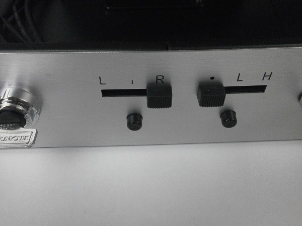

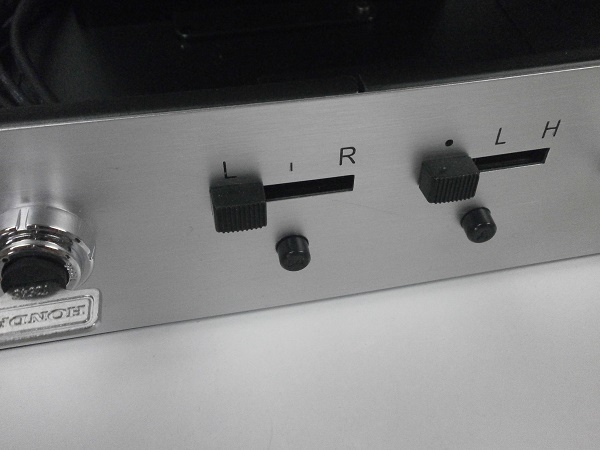

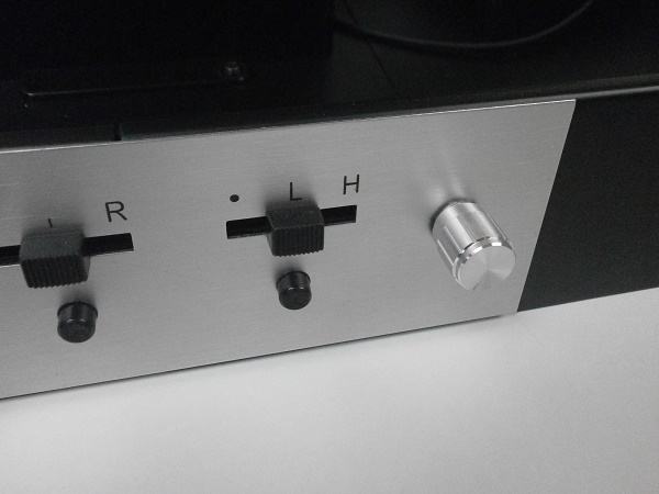

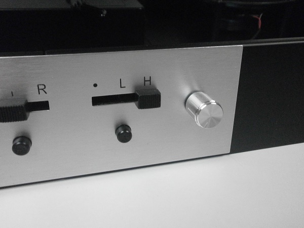

The right hand switch has a slider with a 'L' and 'H' above it, sliding it to the 'L' position should light up the headlight [dipped beam] ,instruments and brake light. Sliding the switch to the 'H' position will give a full beam effect. Next press the brake pedal and the brake light should glow brighter you can also turn the brake light on by turning the key in the base frame to the black dot position. Return the right slider to its off position.
The Indicators, Horn,Volume control,Starter switch and Kick starter.
The left slider has an 'L' and 'R' at either end sliding the switch to the left will turn on the left indicators and the right side when pushed to the right. The volume control when turned to the left will lower the sound and when turned to the right make it louder. The button below the left hand slider will make the horn work the right hand side button when pressed once will give the sound of the bike being started with the electric starter, pushing it again will be the sound of the bike ticking over. To stop the sound turn the key on the base frame to the off position. Pushing the kick starter down and letting go will also produce the sound of the engine starting again use the base frame key to switch off the sound.

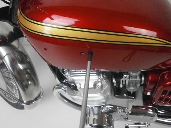

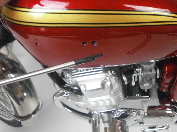

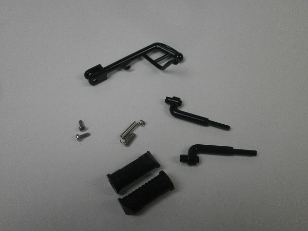

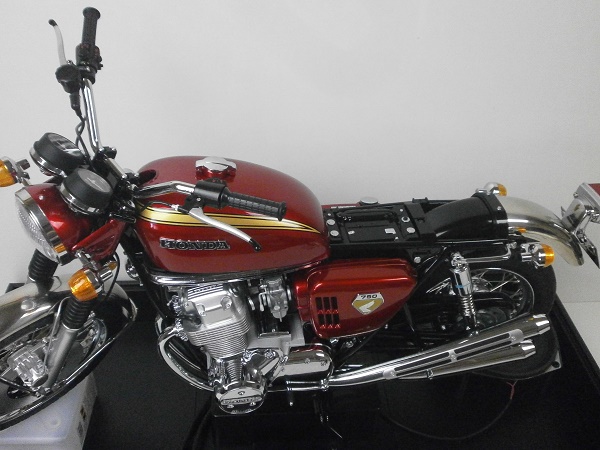

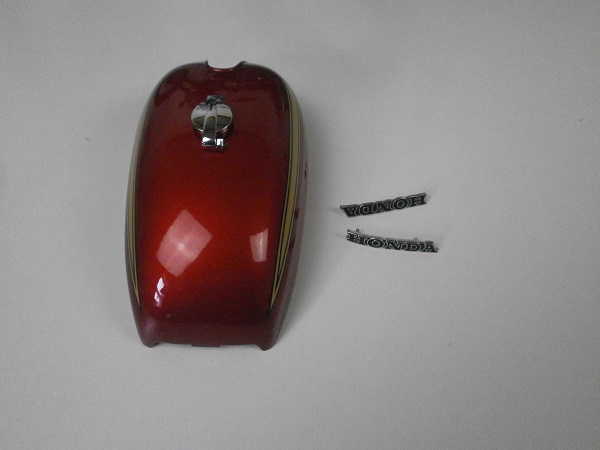

Take the fuel tank and remove the two Honda logos. Next support the main bike frame and remove the steering bolt,hold the front forks about 5mm forward of the frame and slide the fuel tank into position then replace the front forks onto the frame. Now use an 'A' type screw to fix the tank in position and replace the Honda logo, do the same for the other side.

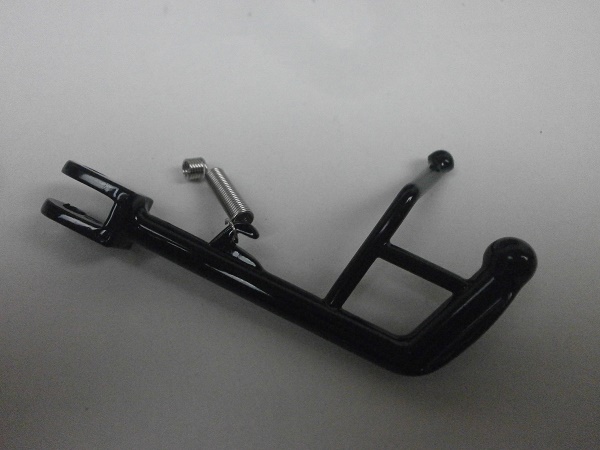

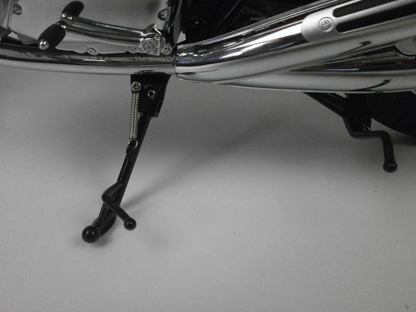

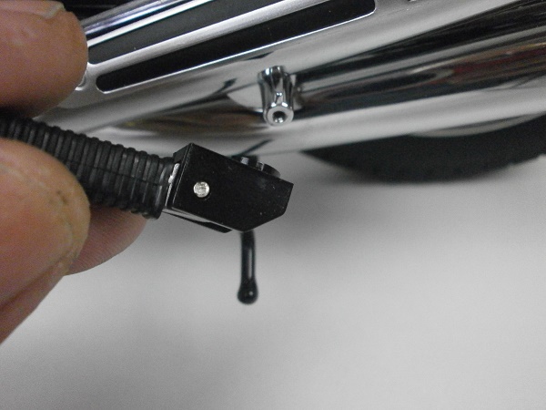

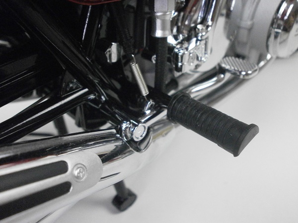

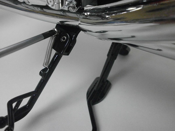

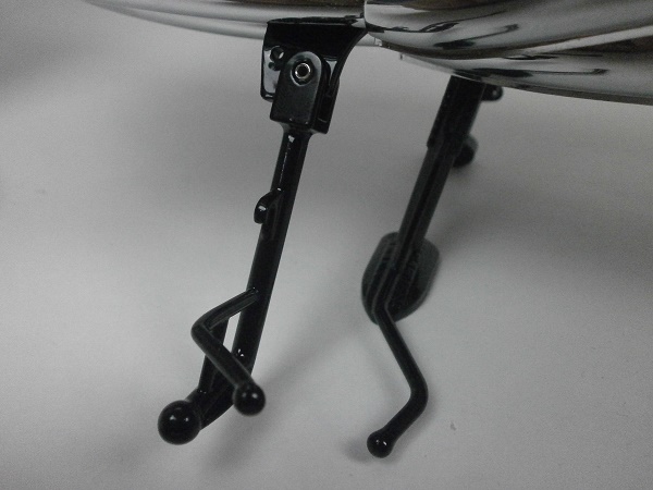

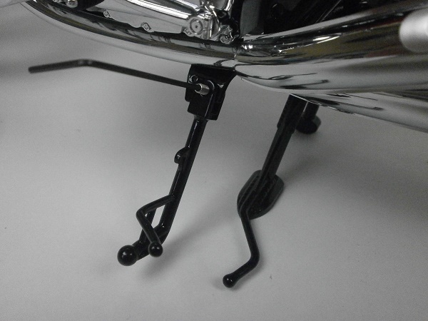

Take the side stand and check the spring fits, I found that fitting the stand first then attaching the spring was the best way to do this. So fit the side stand to the frame using the threaded pin and allen key then mount the spring hook onto the stand and fix to the frame using a 'N' type screw. Check that the side stand pivots correctly.

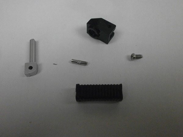

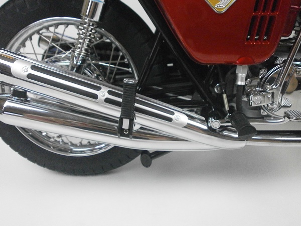

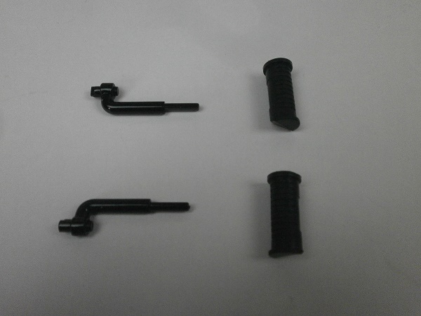

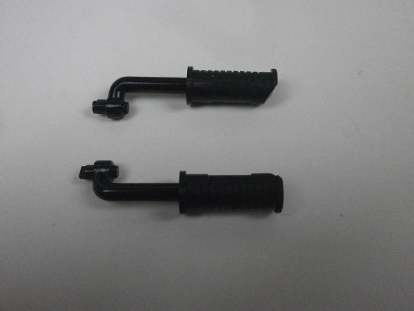

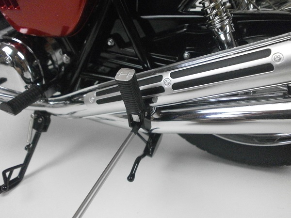

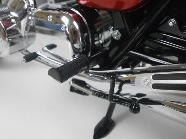

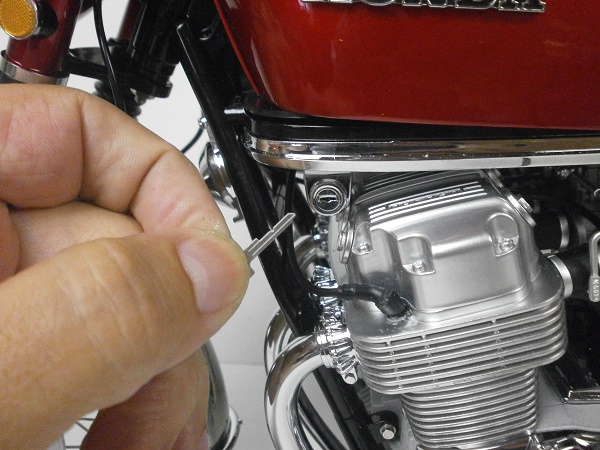

Next take the two footrests and rubbers line each one up with the 'D' shaped hole and push gently home making a pair. Line up the left hand footrest with the frame making sure it lines up with the notch and press gently home. On the right side push down the brake pedal and move the oil hose to one side to fit the foot rest again pushing gently home

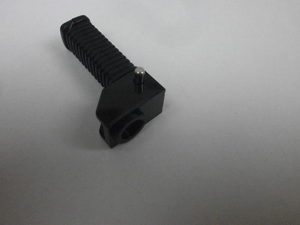

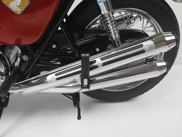

Stage 74 contains Pillion left footrest,bracket,pivot,rubber,covers and screws.

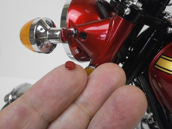

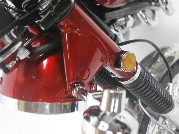

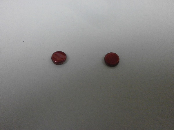

Take the two screw hole covers noting that they are marked 'L' and 'R' fit the left cover to the headlight housing first making sure it align's with the notch and push gently home. Do the same for the right side.

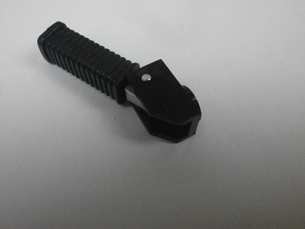

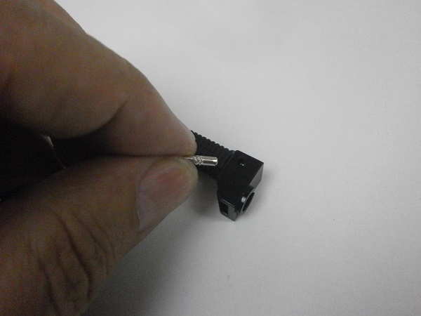

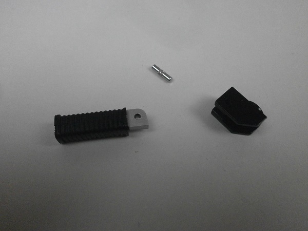

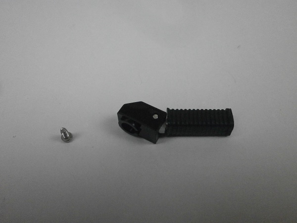

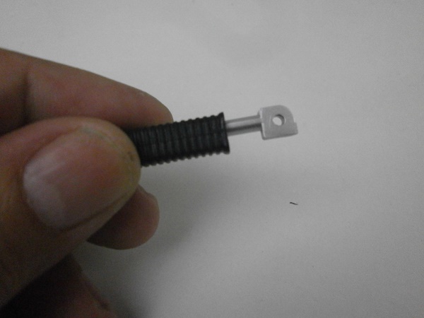

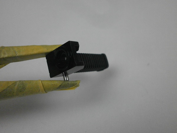

Next take the pillion foot rest and rubber line it up with the 'D' shaped hole and push home. Now take the bracket and slide it onto the foot rest making sure the holes are aligned then place the pivot into the hole and using pliers wrapped in masking tape squeeze the pivot into place then check its movement. Line the footrest up with the left hand side silencer taking note of the notch at the top, Align the foot rest with the notch and fix in place with a 'P' type screw. Check that the footrest moves freely.
At this part of the instructions it is recommended that you use a silicon oil spray to dress the tryes and not the grease provided with the kit earlyer in the build.
This concludes stage 74, store any assembled parts safely in a bag labeled with the stage number for future use.

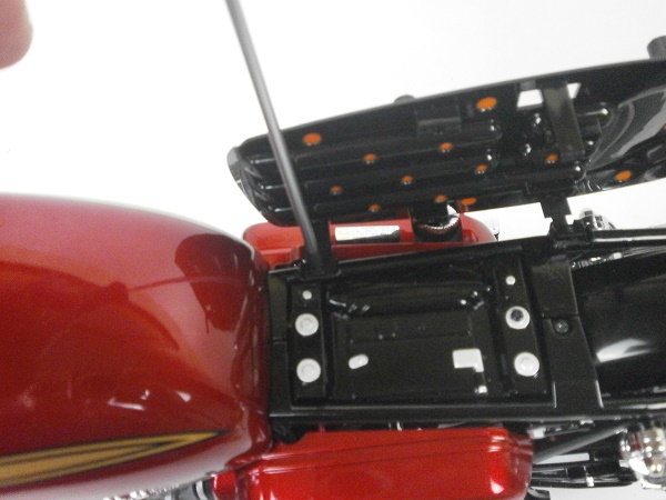

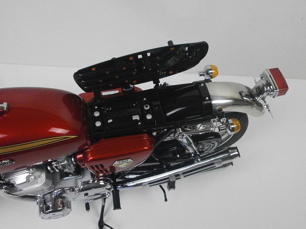

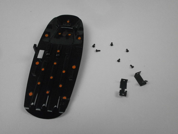

Stage 76 contains the seat base,hinges 'A', 'B' and screws.

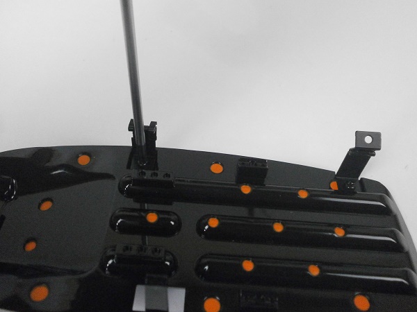

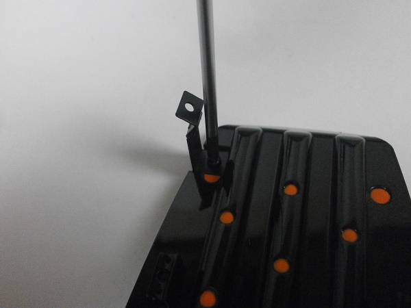

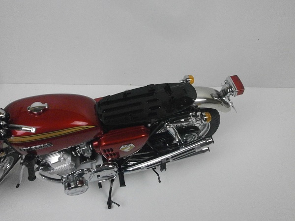

Take hinge 'A' and line it up with the front end of the seat base then fix it in position with a 'G' type screw now do the same for hinge 'B' placing it at the rear of hinge 'A' and fixing in place with another 'G' type screw. Next take the seat base and line it up with the two mounting holes on the frame, use two 'T' type screws to fix it in place. Test that the seat moves correctly.
This concludes stage 76, store any assembled parts safely in a bag labeled with the stage number for future use.

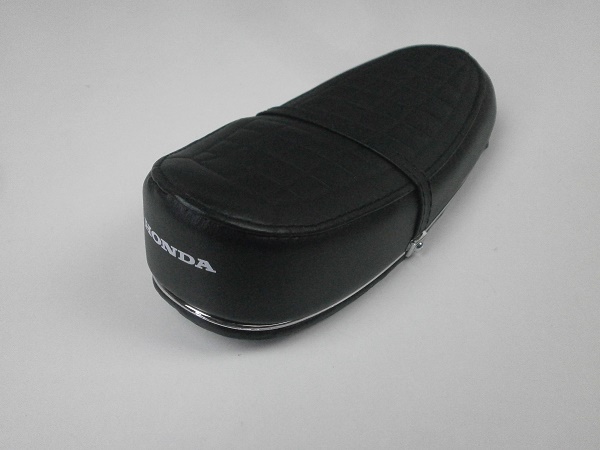

Stage 77 contains the seat and screws.
Line up the seat making sure the four pins are located into the four posts on the seat base once you are happy with the post locations push the seat gently home until the base hits the spacers. Check the movement of the seat and adjust if needed.
This concludes stage 77, store any assembled parts safely in a bag labeled with the stage number for future use.

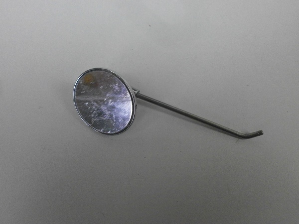

Stage 78 contains the left rear view mirror.
For this stage you will need the Main assembly.
Remove the protective film from the mirror face then line up the stem with the 'D' shaped hole in the left handlebar grip. Hold the handlebar steady and gently push the mirror stem home.
This concludes stage 78, store any assembled parts safely in a bag labeled with the stage number for future use.

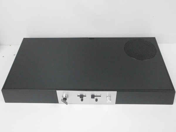

Stage 80 contains the Display base top plate, speaker frame and grille.
For this stage you will need the Main assembly and the display base.

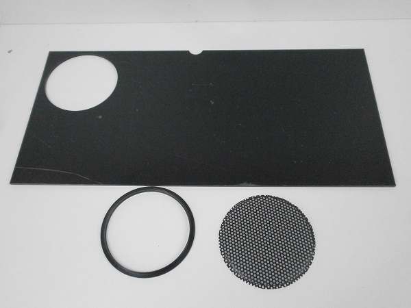

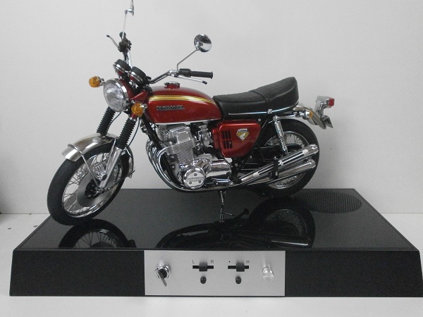

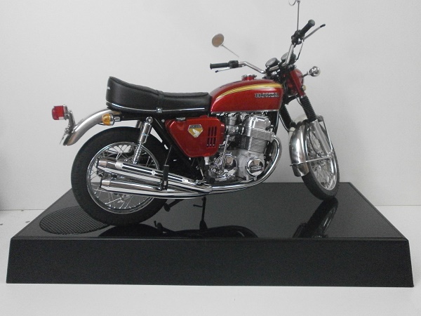

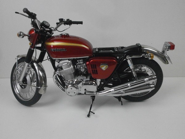

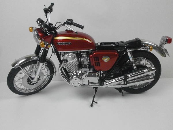

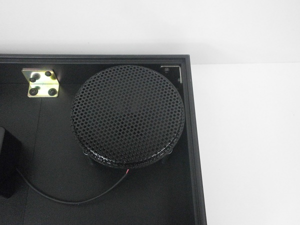

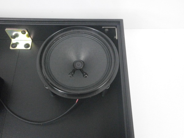

Take the speaker frame and put it onto the speaker in the base making sure the lip faces uppermost then add the grill to the frame. Next remove the protective film from the base plate and fit it into the groove around the top of the display base making sure the hole for the speaker is positioned correctly. Next take the model and position it over the sensor you can use either the side or centre stand to do this.

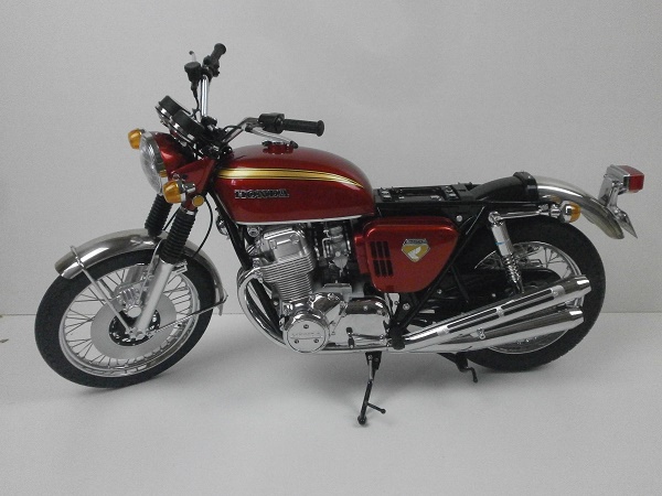

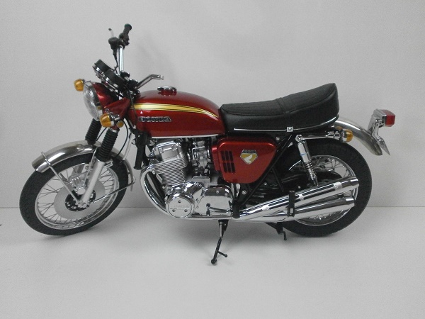

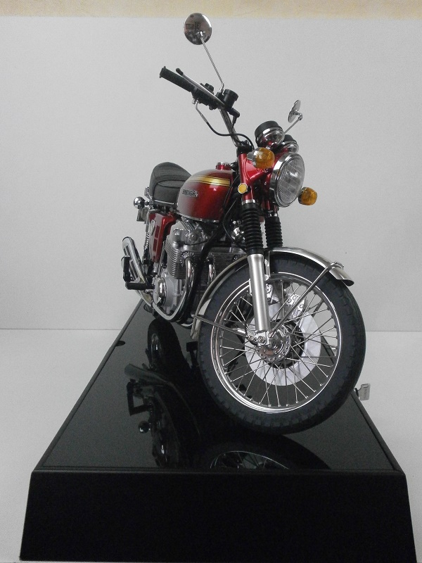

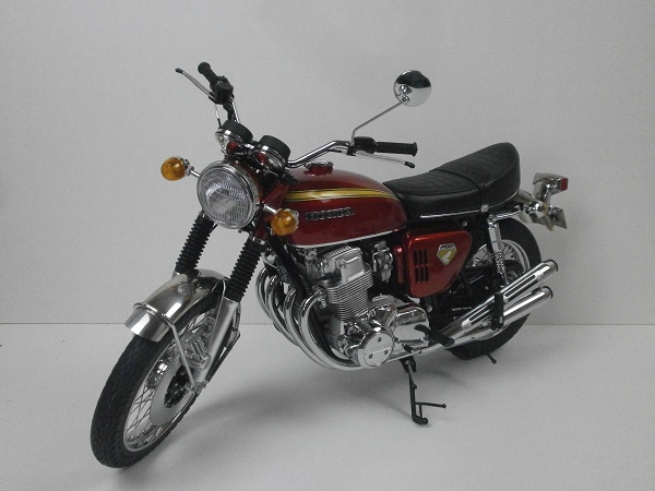

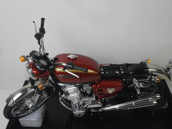

This completes the construction of the Honda CB750 four, I hope you enjoy the build as much as I have!
