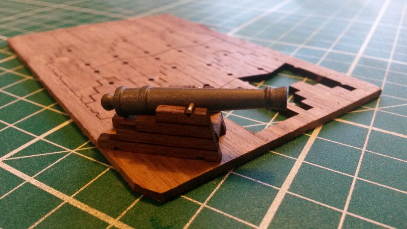

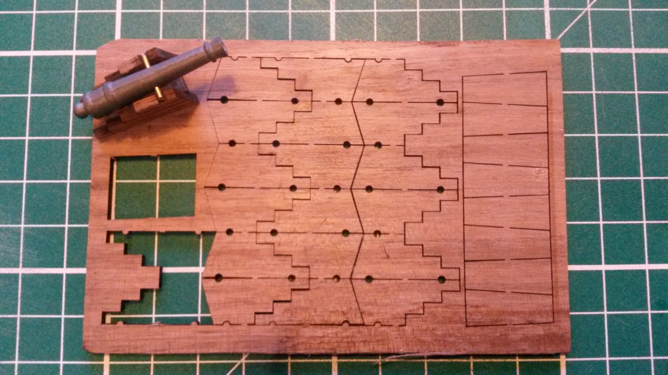

I forgot to mention about pleasant surprise that happened to me when i opened my kit.Drool
Browsing other members diaries I noticed that all San Francisco II kits have cast iron cannon carriages. They are in my kit but additionally I have wooden cannon carriages which I never seen before.Blink
Of course couldn't resist to assemble one of them,LOL just have to add wheels as they not included in my kit.

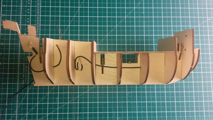

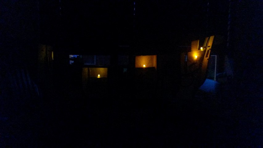

Today I started work on "electric installation " of my SF.
This is only a try without any mounting. As you will see on pictures light from LED need to be diffused I decide so I use simple white card as a diffuser. Card will match grating colour so is barely visible in daylight. Have to say I'm quite pleased with the results.Cool Cool
My plan is to use LED lights under every grating, in captain's cabin, deck house and lantern. Also I'm considering to add a window beside the dor on the front of the main deck.
I think I should have about 9 LED lights so I will connect them in three separate circuits just to have chance turn off some of them in case ship will look like a Christmas tree.LOL
Comments and suggestions as always more than welcome!

#13 Posted : 04 July 2015 09:29:02
It will look good lit up. But be careful on how bright the led's are. The lighting on ships was very dull.
The defused light you show is good although a little bright. You might also consider having the light slightly to the side of the gratings, so as to not see the source of light.

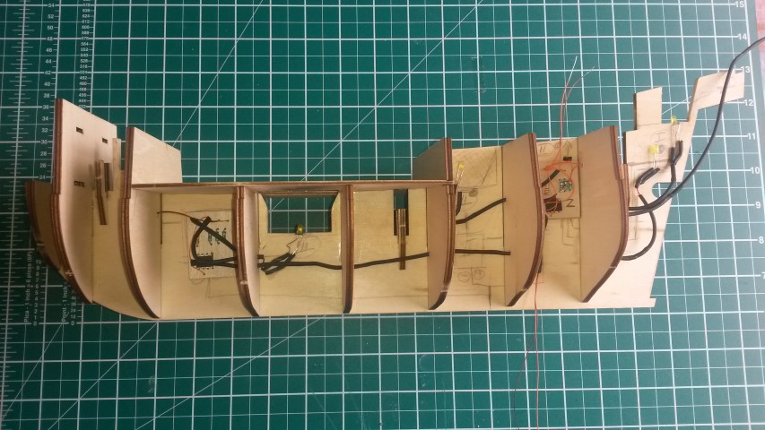

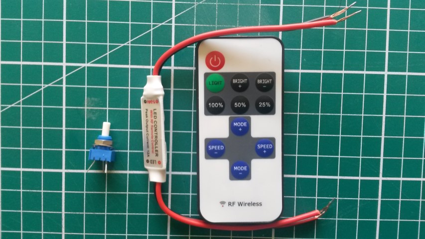

It took me some time but wiring of my SF is almost over!BigGrin
I used a variable resistor for the entire system and now I have a complete control over LED brightness (again thanks to WildRover for advice). When resistor is set at a minimum my camera was not able to catch the light so I'm happy. When I was looking for resistor I came across a remote control switch and I decided to use it as well . The problem is that to many elements have to be installed in the hull and yet I have to make room for dummy canons so the battery holder, variable resistor and sensor for remote switch I will to install in ship stand.
I have to admit, the building becomes more complicated than I thought.Cursing It looks like I'll have to build the boxes around some of the LED lights that the light is not leaked by some parts of the ship and plan carefully placement of the dummy cannons.
It will be a long way before I even start planking the hull .....but seeing all this adds-on working is very rewarding.Cool Cool

#20 Posted : 08 August 2015 22:23:12
You certainly have a good end result. is the intention to see the light from the gratings?
If you are adding dumb cannons you will have to build boxes for each one, so as long as you carefully seal them that should stop any light leaking through.
