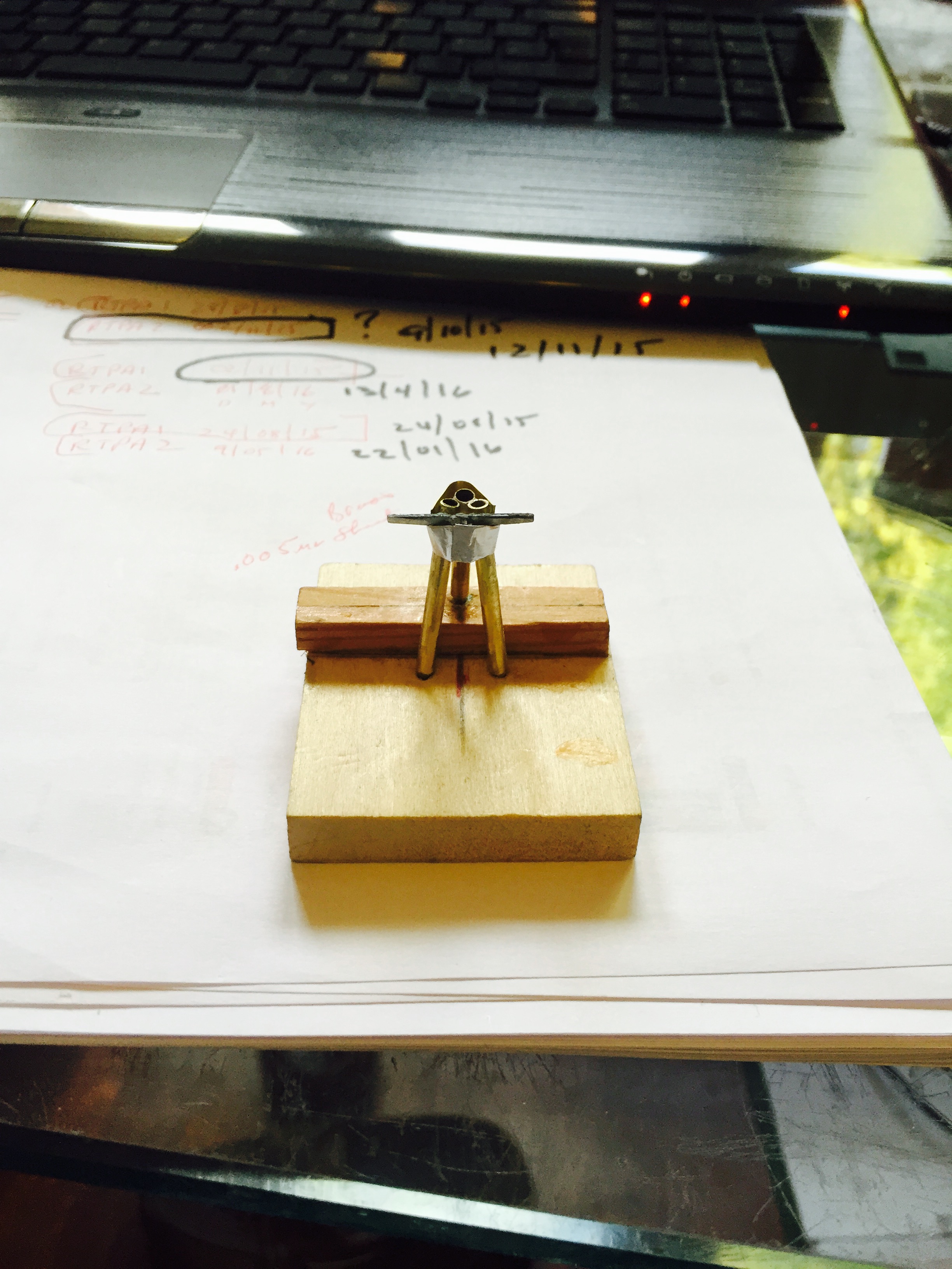

Thank you again for your comments and suggestions. Your suggestion triggered a thought that I could use Foil Wrap folded to add strength and put part of the brass strip in the back so that it would support the light. It turned out pretty well, not as good as yours, but acceptable for someone of my skill level. I have attached pictures, any comments would be appreciated.

#7 Posted : 23 June 2015 19:38:13
BigGrin Hi Dan
It looks spot on to me and once the upper mast parts are added and the small deck here it will look the bizz
