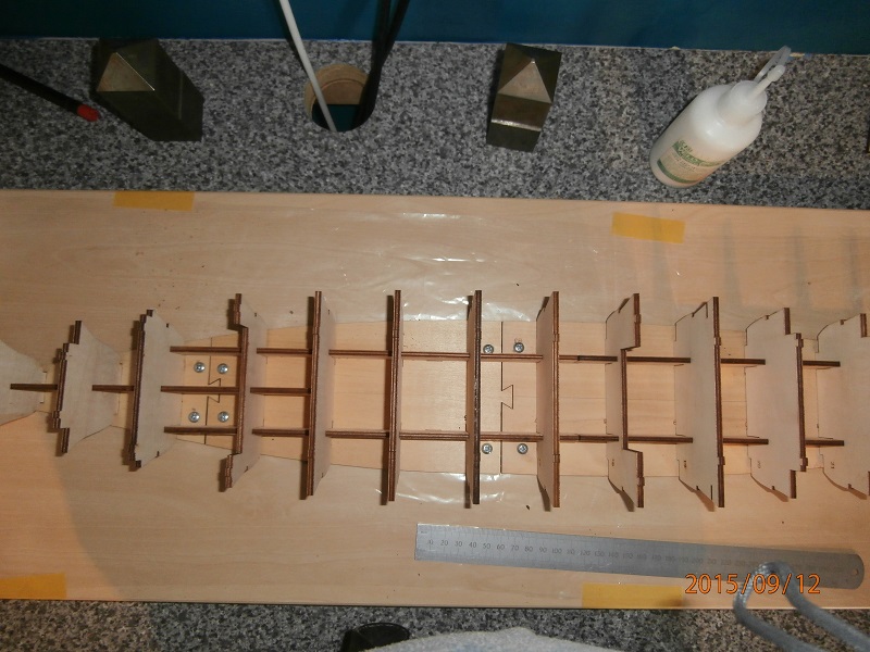

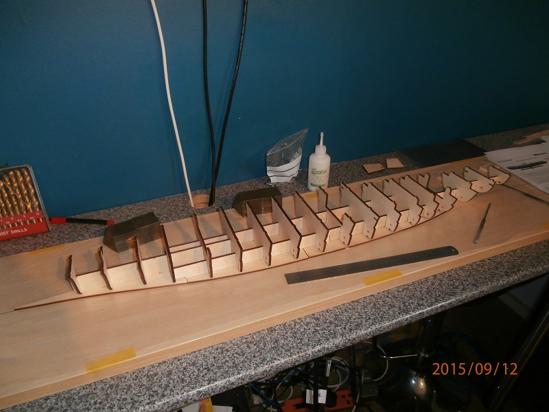

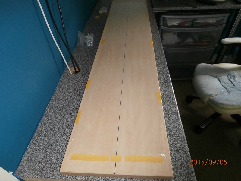

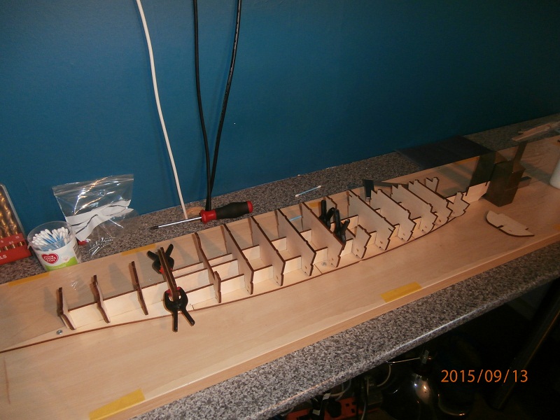

I have now received pack 4 and started the build Laugh .

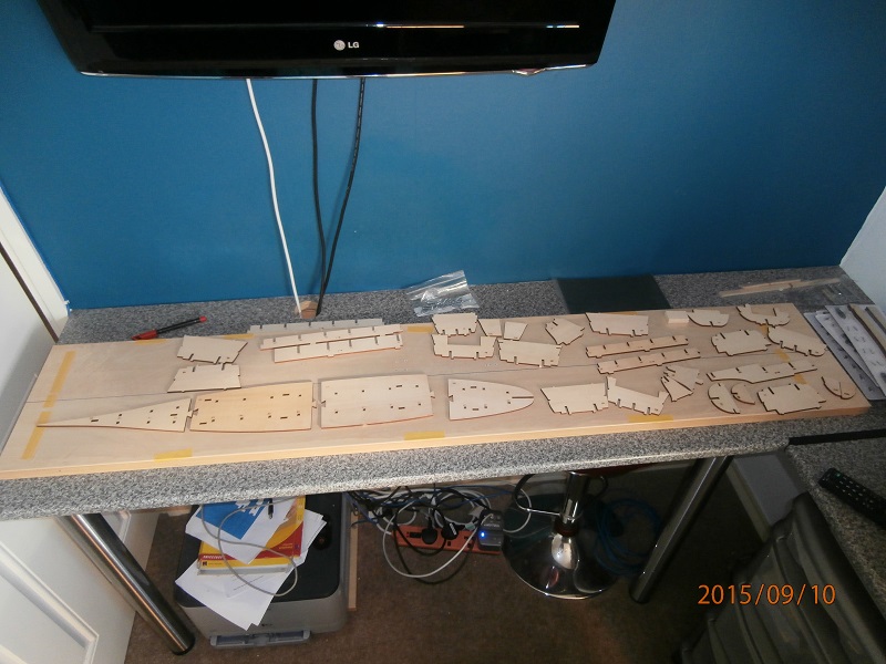

Pic 1 shows the build board set up with a centre line and covered with polythene to prevent the base plates from sticking to the board.

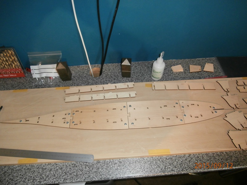

Pic 2 shows the parts received to date still in their packing. I will be leaving all the metal parts in their packing until they need in the build.

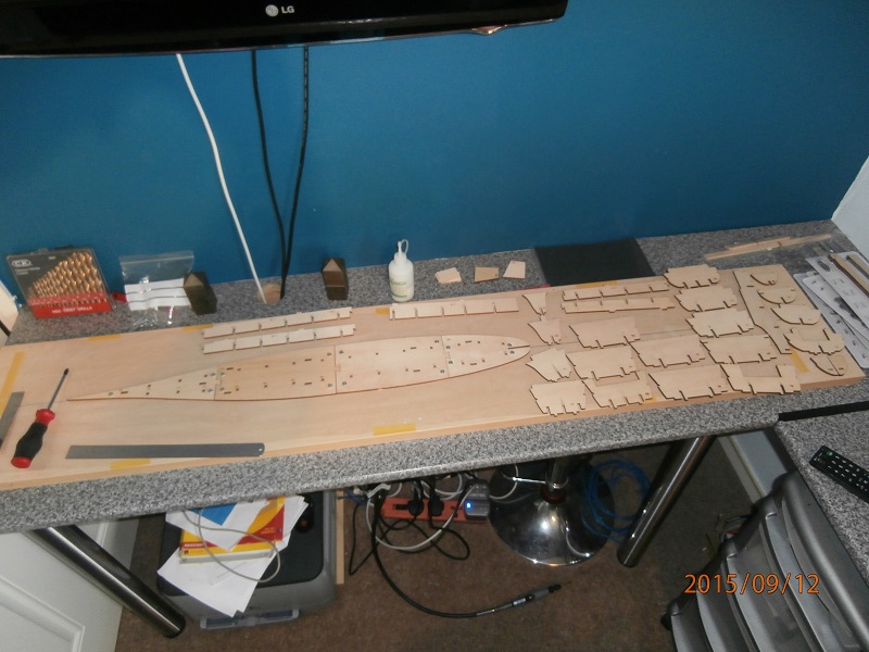

Pic 3 shows all the frame parts laid out.

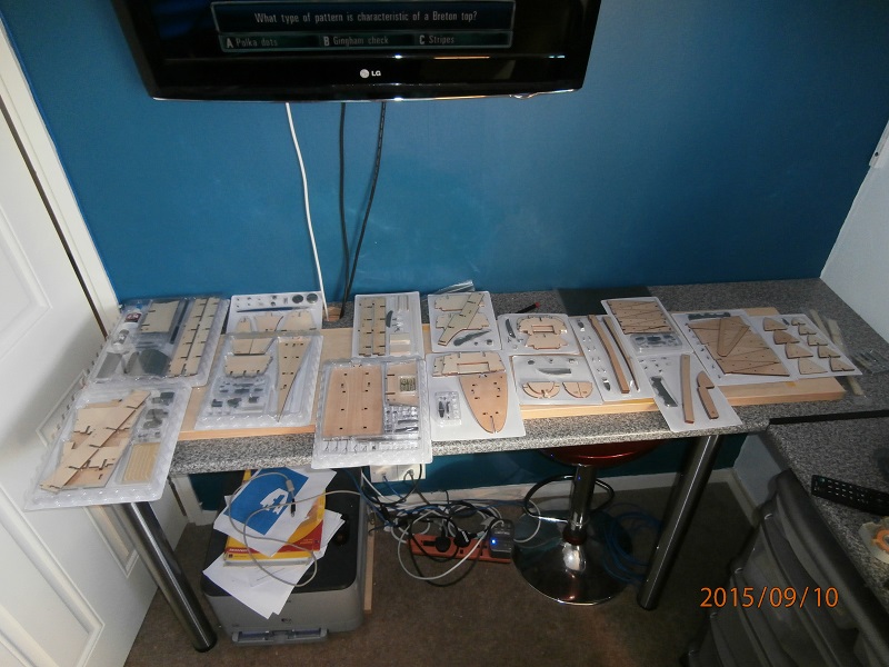

Pic 4 is of all the frame parts dry fitted.
At this point I positioned the hull along the centre line of the board, drilled pilot holes in the base plates and screwed them to the board.
Pic 5 shows this.
I then removed all the frame parts, Pic 6 and then unscrewed forward of the 2 centre base plates,removed it, applied glue to the forward end and then replaced it and screwed it back down. I then repeated the process with the aft centre plate but applied glue to both ends before screwing back down, pic 7.
i am leaving the base plates to dry overnight before gluing all the frames back in place.

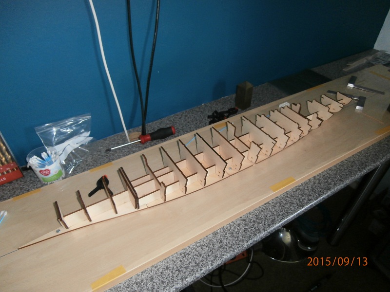

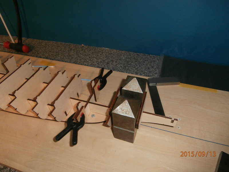

Just a brief update. I have glued all the frames up to 26 in place and I am going to let them dry completely before adding frames 27 on asI will have to remove the bow screw and the 2 stern screws before I can fit them.
Frames 24-26 at the stern were setup using an engineers square then held in place with a couple of machined steel blocks while the glue dried.
