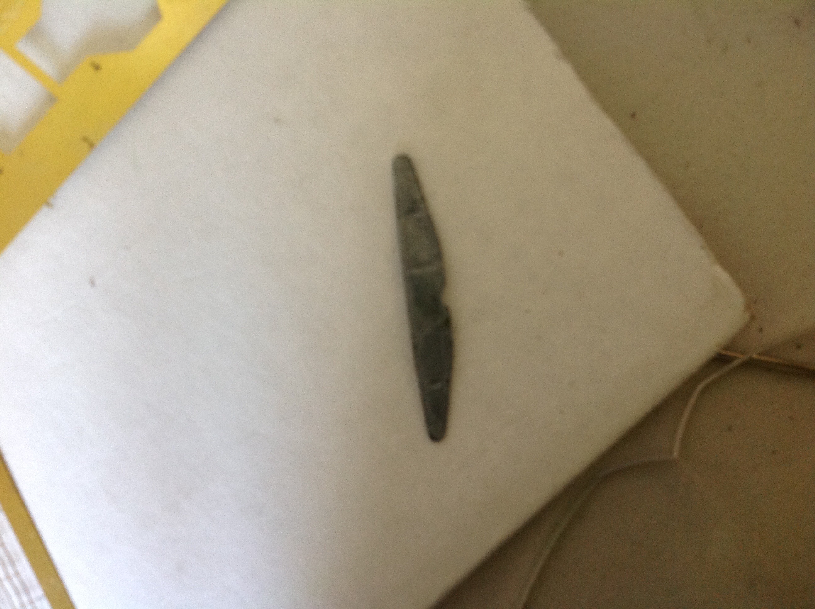

I seem to be having problems with the type of paint I am using for the airplanes. The instruct call for watercolour however I have not been able to find any except for they type children or professional artists use, neither seem appropriate. I experimented with Tamyira IJN green and Humbrol Matt 64 but when applied to metal that was primed, I have some spare, it turned out very blotchy, especially they Humbrol. Maybe it's the Matt paint versus the acrylic paint or my technique, but I am wondering what brand and type of paint you used.

I simply washed the parts in soapy water 1st then used a grey primer for cars to undercoat the aircraft and used the Tamiya acrylic IJN green and grey to paint them. I had no probs doing it this way but it sounds like you have contamination from some where affecting the finish. Perhaps a strip back of the paint now on the aircraft and a restart may cure the contamination problem if you have one. One other thing to watch also is the decals are very delicate so be careful when you apply them. Hope this helps.
I thought it would be a good thing to clarify what is meant in the instructions on the meaning of 'water colour Paint' the paint in question is acrylic water based paints for models Tamiya, Mr Gunze and Vallejo to name but a few and not the artists water colours which are a completely different type of paint and more of a wash than a true paint
#3 Posted : 17 May 2015 18:46:33
I would give the parts a good wash as Andy has suggested.
Are you painting with a brush or airbrush? I find that with Tamiya paints, to get a good finish, you need to build up several thin layers. I have found that this can vary from 3 to 5 layers. Personally I find that thinning them with Tamiyas own thinner a little helps with brushing

Thanks everyone for your advice and help. It appears that my Humbrol Light Grey Matt paint was contaminated, although how I do not know.
