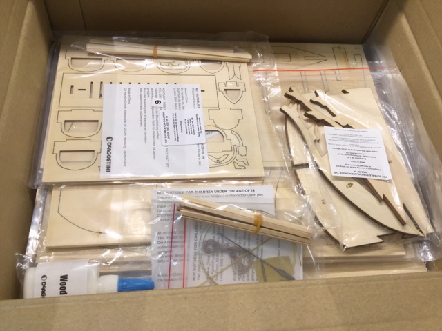

Based on a suggestion from a member I am going to start a build log (sounds like fun) for my Victory so that other members can add comments, helpful suggestions, and advice. And so I can also ask question or two as the need arises.
So, without further delay - here goes.

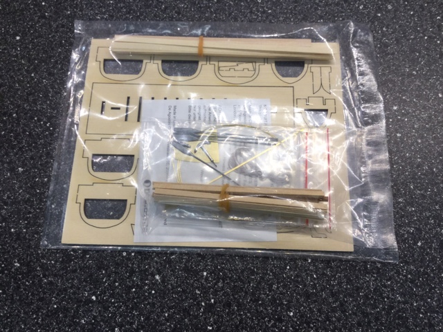

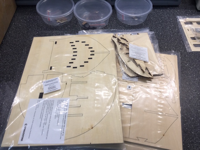

Opening the box and checking the contents - looks pretty good - not so many parts that it seems overwhelming. Probably good to divide it up into months like this.

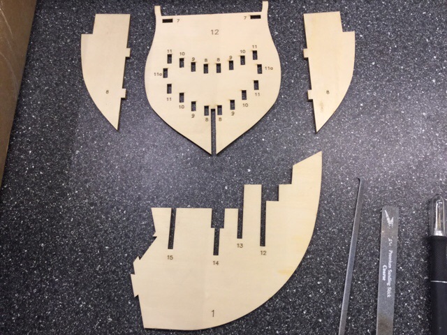

Starting to remove the first of the parts from the frets and cleaning them up with a light sanding to improve adhesion as suggested in the official build diary.
First I cut the fret attachments through and then cleaned any remaining little nubbins? with my hobby knife. Then I carefully rubbed all of the edges with a sanding stick to remove some of the char left by the laser cutting process being careful not to round over any edges, change the shape, or remove too much material.

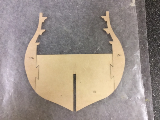

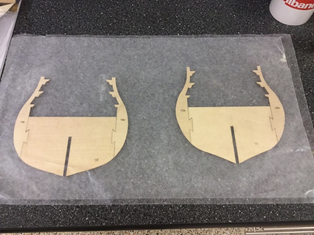

Next I started to assemble some of the frames by gluing them together and then weighting them to dry on a flat surface. I cleaned up any glue that seeped out but put them between sheets of waxed paper to protect the bench and the books I used as weights just in case any additional excess glue seeped out.

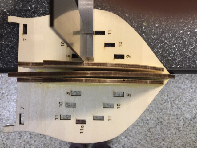

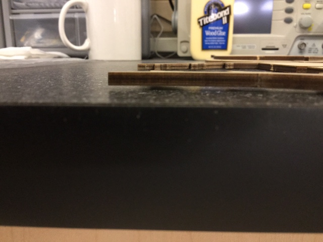

Here's Frame #14 all glued up. There seems to be ever so slight a warp to it. It wasn't from how I glued it. It looks like the plywood center portion of the frame is slightly warped throwing off the whole piece. The warp is very slight but noticeable.
Will this straighten out once I add the false decks and align everything, or should I take some other action? Frame 18 looks like it has a similar slight warp to it.

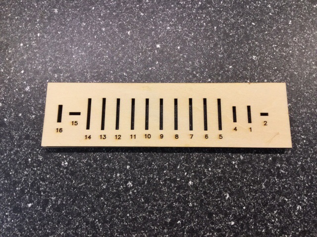

All bulkheads/frames from parts 1-10 are now assembled. The last one was pretty warped. I weighted them all flat until I'm ready to glue them up after I get the false decks. Hopefully it will straighten out.
I also put together the jig for the ship's launch.

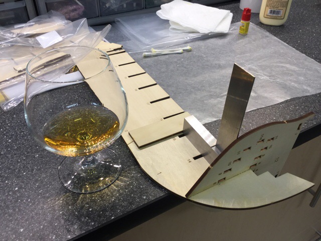

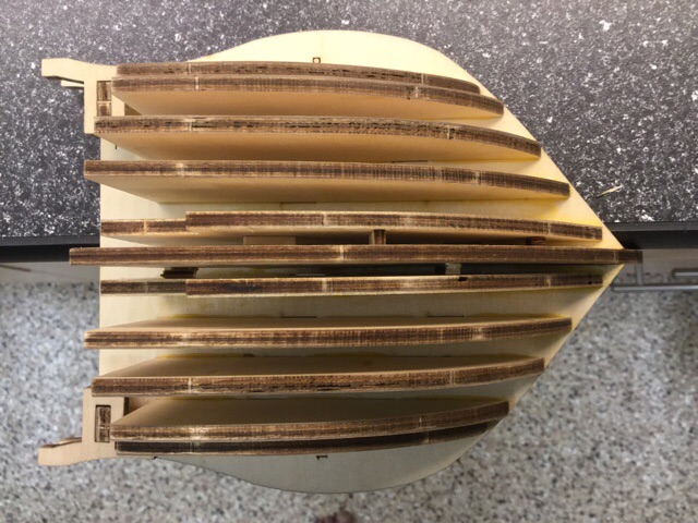

I finally attached the first of the frames, bow frame 12 and glued the first extension to the keel in place. You can see my machinist square (all the way from Sheffield, England) in the photo to make sure everything is nice and square. Then had a wee dram of a fine single malt to celebrate.
I'll start the bow formers tomorrow.
I noticed that the second part of the false keel, part number 2, also has a slight warp to it. I'm assuming that the false decks will help square all of this up at the end prior to fairing and planking. I am keeping everything pressed flat with heavy books in the mean time.
DSoldano attached the following image(s):

Thanks. Yes, I am following the official build instructions so I have only glued up that one frame and will glue the bow formers. I glued in the first of those this morning - both parts 8 - and the spacing between the bow portion of the false keel and the formers is uneven as it nears the top of the bow. Turns out part 1 is also warped. If I left this and planked it the bow would never look right.
I'm going to lay in a good fillet of glue along the base of each part 8 for strength, then do the same for each part 9 after I install them and then I think I will have to glue in some spacers made from the scrap of the plywood frets to force it straight and true.
Is it normal for this many of the plywood parts to be warped? I'm getting a little concerned about how difficult it's going to be to true this all up at the end before planking. I imagine someone with less general modeling/woodworking experience might be in deep doo doo. Crying

#15 Posted : 07 May 2015 17:37:46
Hi Dominick,
There are many diaries on here reporting slightly warped frames across many different kits, not just partworks, It's not a big deal to get these straightened out.
Slightly dampened frames left under a piece of glass with some weight on top usually sorts it. You will be nailing the false deck to the frames and keel as well so this will also help pull them straight - just check they are square while the glue is setting.

Thanks for the advice. As this is my first plank on bulkhead kit I'm not quite sure what to expect so replies like yours are very helpful.
I have the parts weighted with some heavy books but didn't dampen them. I'll do that this evening. Should I do that singly, or is in a stack OK for the frames?
Where I am in Northern California the climate is pretty dry so it won't take long at all for them to dry back out.
I didn't notice the warp in the bow section until after it was glued up and there is no way to press that now so I'll deal with that using some spacers as I described in my earlier post.
I also plan to make a jig using a piece of shelving and a few pieces of aluminum angle stock to ensure the keel is nice and straight when I apply the false decks and the first of the planks. Alternately, I have a "fair-a-frame" from Model Shipways that's been in the garage cabinet for quite a few years. I never assembled it and restumbled on it the other day. I'll put it together and see if that will hold the keel straight.

#18 Posted : 07 May 2015 19:09:48
Hi,
Dampened slightly is usually better and between 2 glass sheets is preferable. I "borrowed" the glass from some picture frames for mine and placed some books on topBigGrin
The build jig is a must for keeping the keel frames straight and should remain in there until you have done a good ammount of planking, after this it wont be needed.

Thanks as well. I think your tip will come in handy but I thought it might be difficult to unglue this particular assembly since I had already installed some of the bow formers and laid in a fillet of glue. I also had used some CA to hold the part square while the PVA dried. You present a very good reason not to use the CA in the future.
Anyway, I made some shims from the leftover plywood frets and used them to straighten up the bow portion of the false keel. Now it's nice and straight and right down the centerline. I haven't glued the shims in yet, they are just held in place by friction right now. I want to wait and see if any adjustments are needed before I glue them in..
Here's a picture of the completed bow formers with the shims inserted. Looking good if I do say so myself.
Next steps, dampening and weighting any of the frames and keel sections that are warped, building a jig to keep the keel nice and straight once the warps are out and the keel is completely assembled (which is the next step in the instructions pertaining to the hull), assembling the cannon, anchor, carronade, and ships boat.
