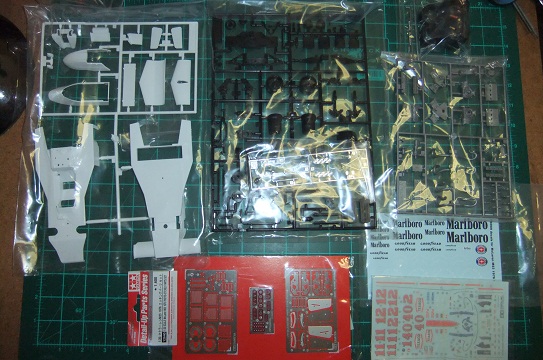

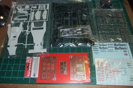

Not a magnificent 1/8 ( unfortunately ) but a 1/20 Tamiya kit.BigGrin
I've got the sponser decals and a Tamiya upgrade P/E set.

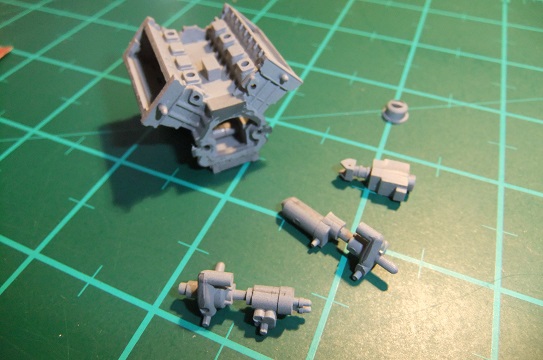

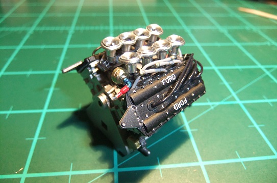

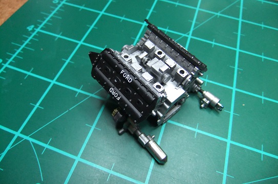

Here we go. First off the DFV.
I'm going to use Alclad 2 a little more on this build ( I need to practice Airbrush cleaning !! ) so I've used Tamiya grey surface primer then Alclad black and finished with Alclad Aluminium. The covers are in Tamiya Matt black.
#7 Posted : 18 April 2015 16:58:31
A little bit of detailing to finish.BigGrin

#10 Posted : 26 April 2015 11:14:11

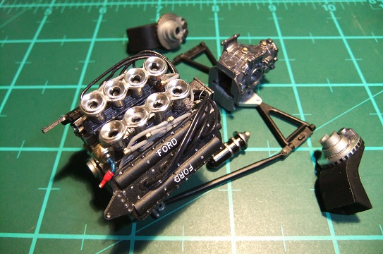

I decided to use a slightly thinner wire for the plug leads and added a red sleeve to each at the distributor made from thin electrical cable with the wire striped out.

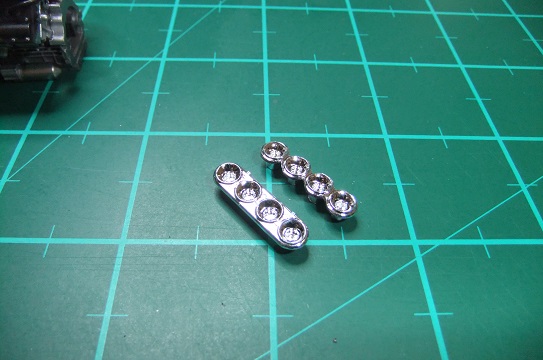

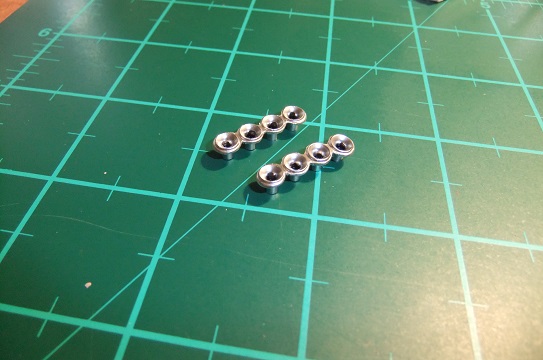

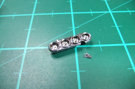

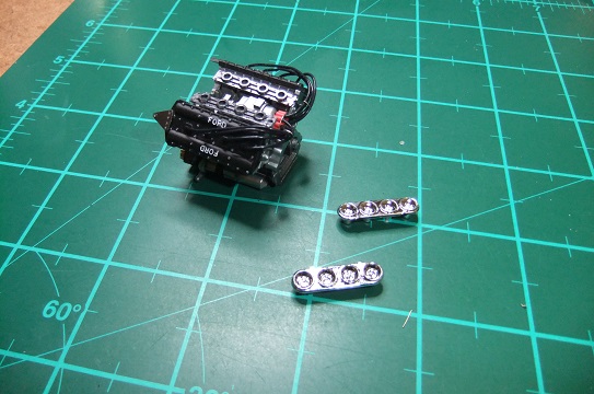

Not happy with the venturis that came with the kit. The plate that joins them and the chrome finish are not to my liking.
So I nibbled the plate away with a side cutter and smoothed the edges out. Finished with a light spray of Tamiya chrome silver. Plus a small dab of flat black in the holes.

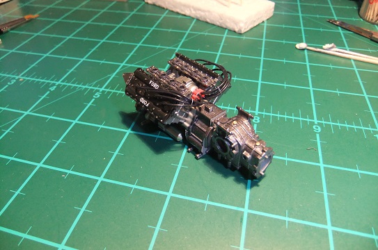

Early stages with gearbox assembly.

Nice work Malc and making good progress with the engine/gearbox assembly. I did exactly the same as you with the induction trumpets on my kit and they certainly look much better and more to the point, accurate with those plates removed - well done. Cool ThumpUp
Kev BigGrin

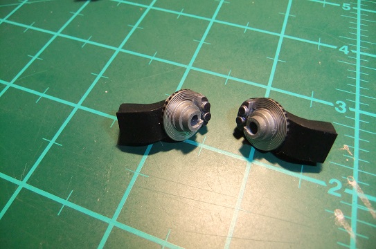

#14 Posted : 01 May 2015 16:30:37

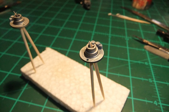

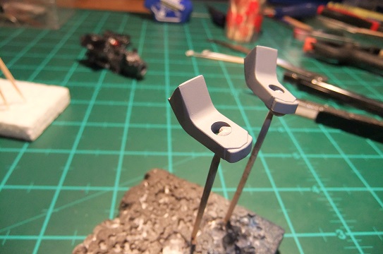

The rear discs and brake ducts are quite straight forward. There's a couple of PE parts to add to the sidesBigGrin and I've added some ventilation with a small brush and much cursing!Laugh .

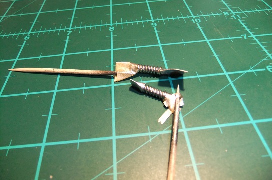

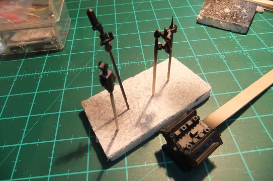

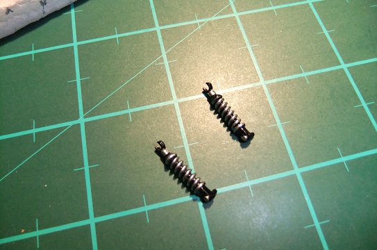

The rear spring units are one piece mouldings so I sprayed them gloss balck then masked off the core and sprayed the spring coil tamiya metallic silver.
