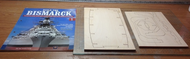

Browsing ebay over the Xmas period i came across Hachete's partwork "Build the Bismark" all 140 issues Drool unopenedDrool
A deal was struck and completed and i recieved the goodies in good time
Cool I wisely decided not to start the build until after the Hogmany celebrationsBlushing
During this time i opened all the issues and only found one setback

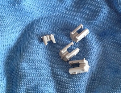

Crying One of the antiaircraft guns moulding was not complete
A search for back issues on ebay was not successful for the one issue i required
But i did come across someone who was selling spares and one of the photos showed the items i required.
So now i have a complete kit and spare decking and plastic fittings
The parts are the usual ply and various types of wood for the hull and superstructure and main gun frames etc

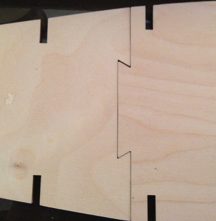

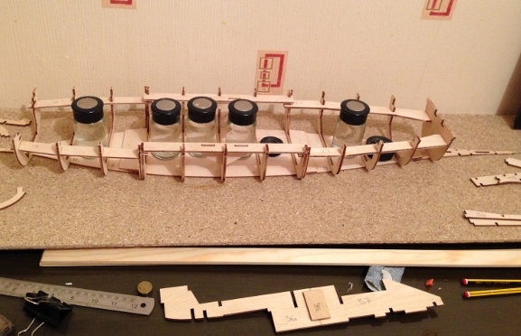

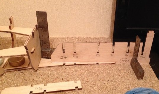

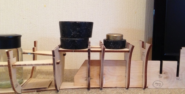

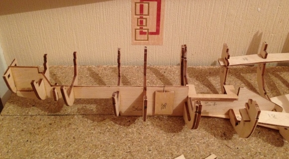

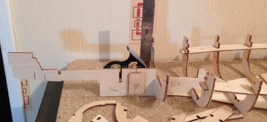

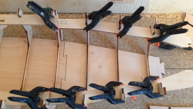

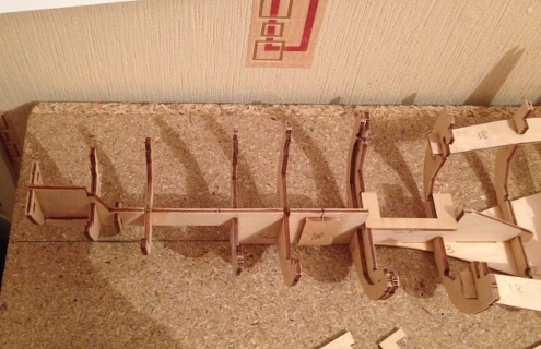

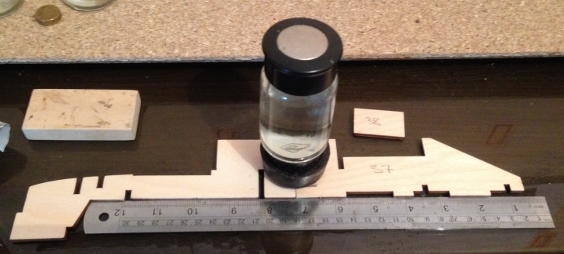

BigGrin On with the build....Drool wanna do the big gunsDrool but
Despite the parts being several years old there does not seem to be any warps on the flat keel but it is not as tight a fit as expected allowing slight movement
So using a straight line on the build board and dry fitting the frames and supports out comes the glue
budgie attached the following image(s):

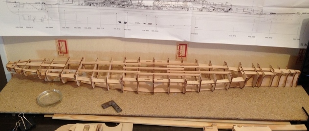

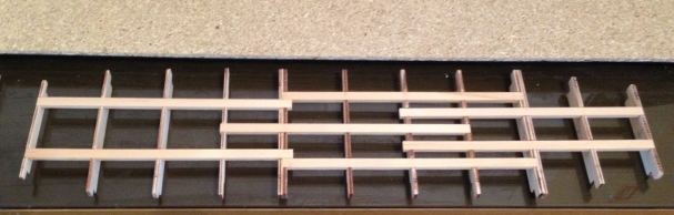

@ARPurchase...i am humming and hawing over conversion to R/C
LOLFirstly i will need to make sure my build is suitable to be seen in daylight
My other issue is that at the moment the instructions say that the middle deck is removable for access..
Confused Will that mean that the deck planking will have a noticable gap straight across the deck at those two points
Cool Am thinking that access may be available by removing the superstructure parts instead
Cool Food for thought

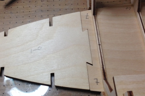

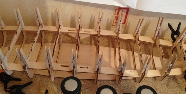

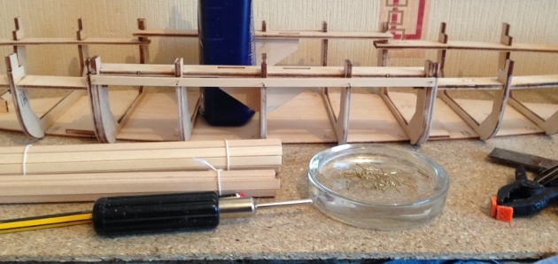

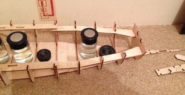

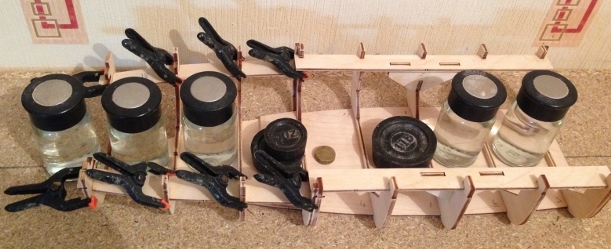

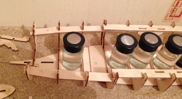

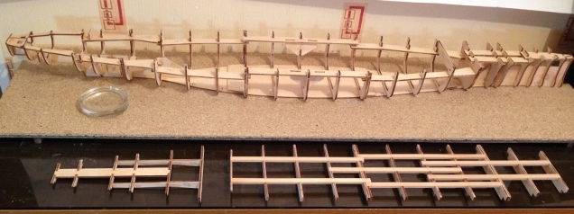

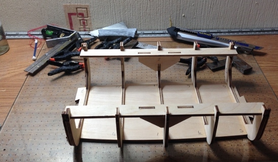

Anyhoos no sign of the big guns yet...onwards with the frames
They all seem to square up nicely together

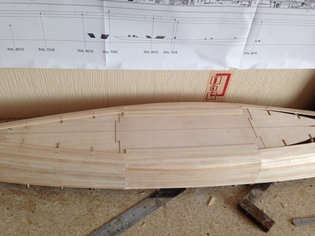

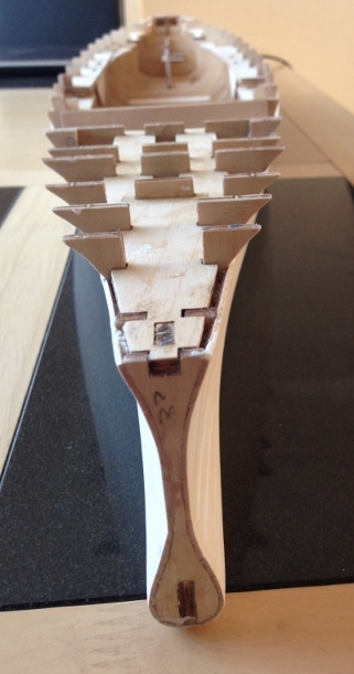

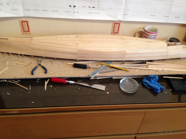

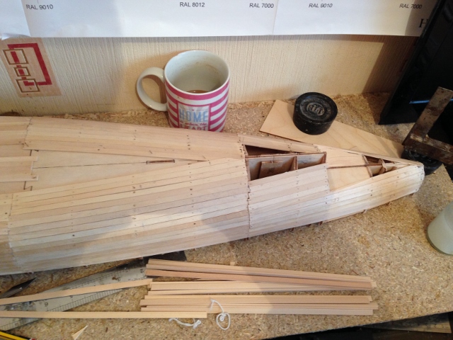

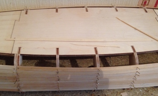

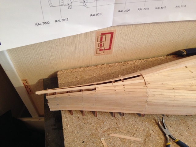

Crying Time to body swerve the planking and start the big guns mmmmmm

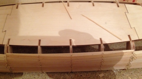

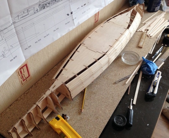

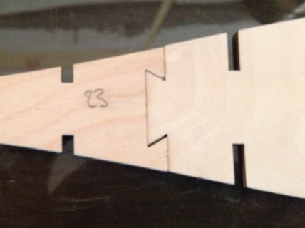

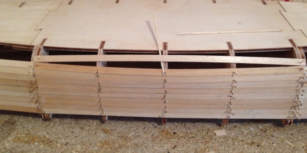

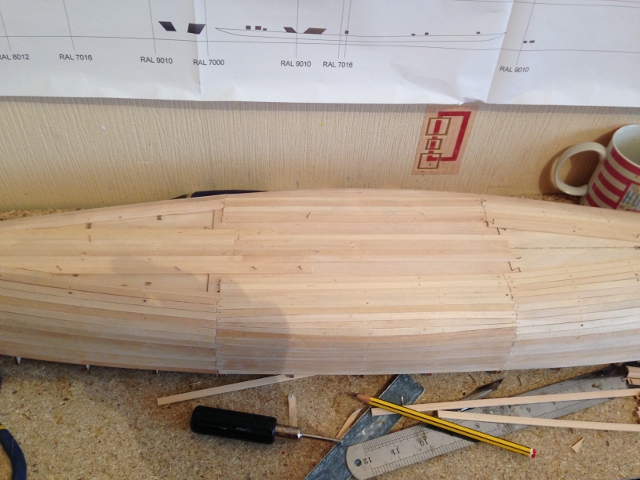

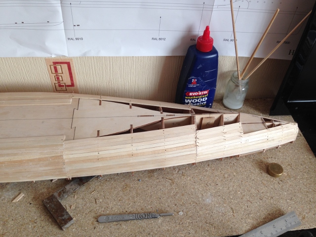

Confused The instructions for planking tells me to lay the planks parrallel to one another not staggered like we are used to
I almost swayed from the instructions and stagger the planking .......
but realised this is how the designers want us to do it.....
Huh Where the ends of the planks rest the frames are twice as thick
Huh The inside of the hull is to be covered in gauze and glue
Huh The 2nd planking is staggered
A problem did arrive several strips down which you can see in the picture
I felt too much effort was require in order for the plank to be pinned and glued to the previous laid plank
Letting it lie naturally leaves a gap to be filled....but there is no space on the frame on which the ends can rest
Maybe it would not matter as the inside is going to be strengthened and an outer layer of planks will be added later
Tapering both ends of the plank seems to have resolve this issue as i can now lay the plank against the previous laid one without much effort and the next plank requires no adjustment
BigGrin Woo HooLaugh

#11 Posted : 05 April 2015 08:32:23
BigGrin Coming together nicely, shaping the plank is the best way to solve that little problem you could also have planked around it letting the upper planks lie as they want and then filling the gap left with a shaped plank.Cool

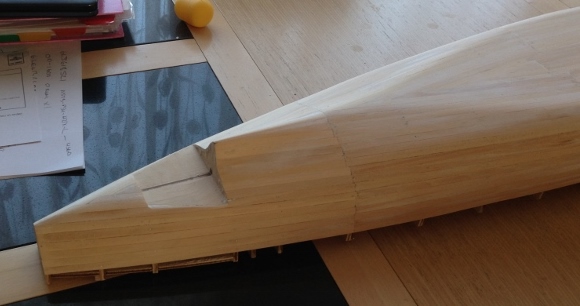

BigGrin Thanks for nice comments chaps

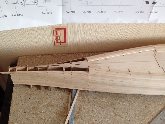

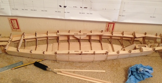

Mellow The gaps slowly getting filled in

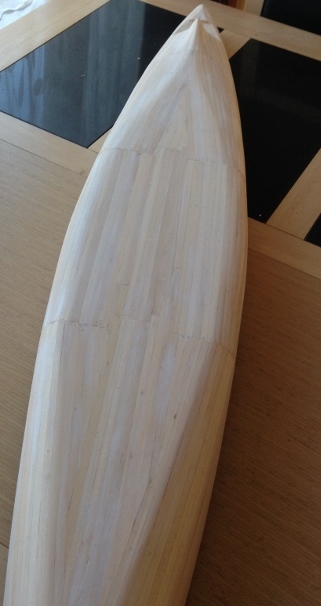

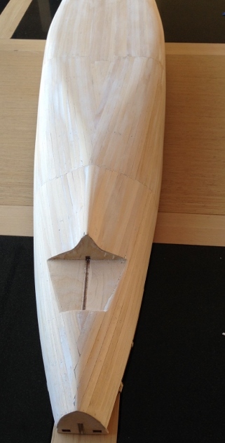

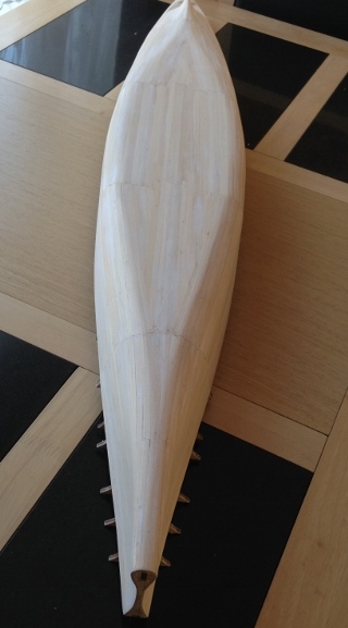

BigGrin Well thats it Folks
Cool Build diary now up to the stage i am at with the model
1st planking sanded and a layer of filler was spread all over the hull and slowly sanded to a smooth finish
BigGrin Thanks for lookin'
