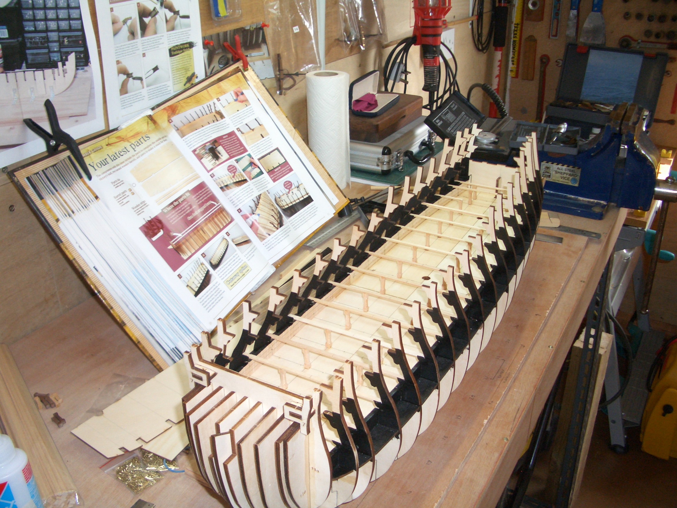

Well a very kind old friend has given me an old camera so now I can show you some of my Bodge jobs!!!
Bodge def. = an attempt at the build with two left hands and poor vision...
Issue 14 - Launch [a].JPG (1,376kb) downloaded 58 time(s).

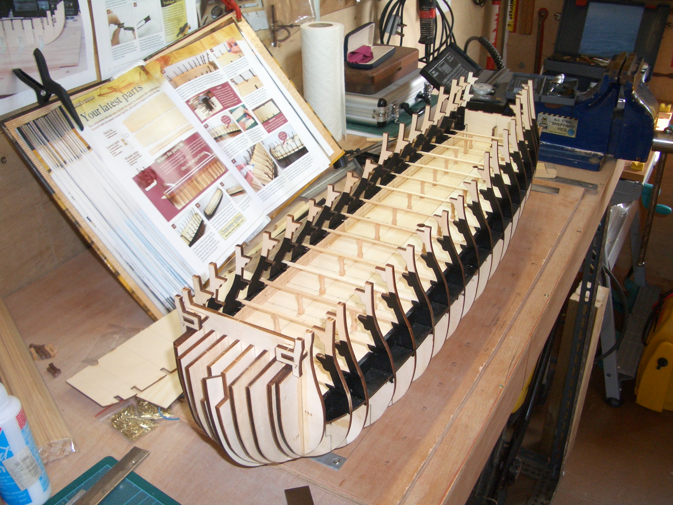

Still don't know why my pictures wont work, perhaps it's the age of the camera or the age of the operator - maybe I need to change the film!
Issue 17 - Gun Deck Supports [a].JPG (1,347kb) downloaded 94 time(s).
Issue 17 - Gun Deck Supports [b].JPG (1,344kb) downloaded 62 time(s).
Issue 17 - Gun Deck Supports [c].JPG (1,336kb) downloaded 58 time(s).
Issue 17 - Gun Deck Supports [d].JPG (1,308kb) downloaded 59 time(s).
Issue 17 - Gun Deck Supports [e].JPG (1,317kb) downloaded 80 time(s).

Great photographs and very neat work. I see you have decided to plank the middle deck it looks very effective. Can I ask how long you made your planks? BigGrin
Pam's shipyard is closed for now no more room!
ArtfulBodger
#6 Posted : 06 October 2010 23:04:00
Joined: 26/03/2010
Posts: 146
Points: 473
Location: Plymouth
I planked the decks in halfs [using 0.5 x 4mm]and then seated the decks and used one long strip to cover the seems. My technique for planking was to put a full plank on wet [ie. using pva glue] then cutting the strip up into lengths to give the planking effect. The length used was just about rib distance because I tried smaller, which would have been to scale but it looked too cluttered. A bit of poetic licence bearing in mind this is only the middle deck.

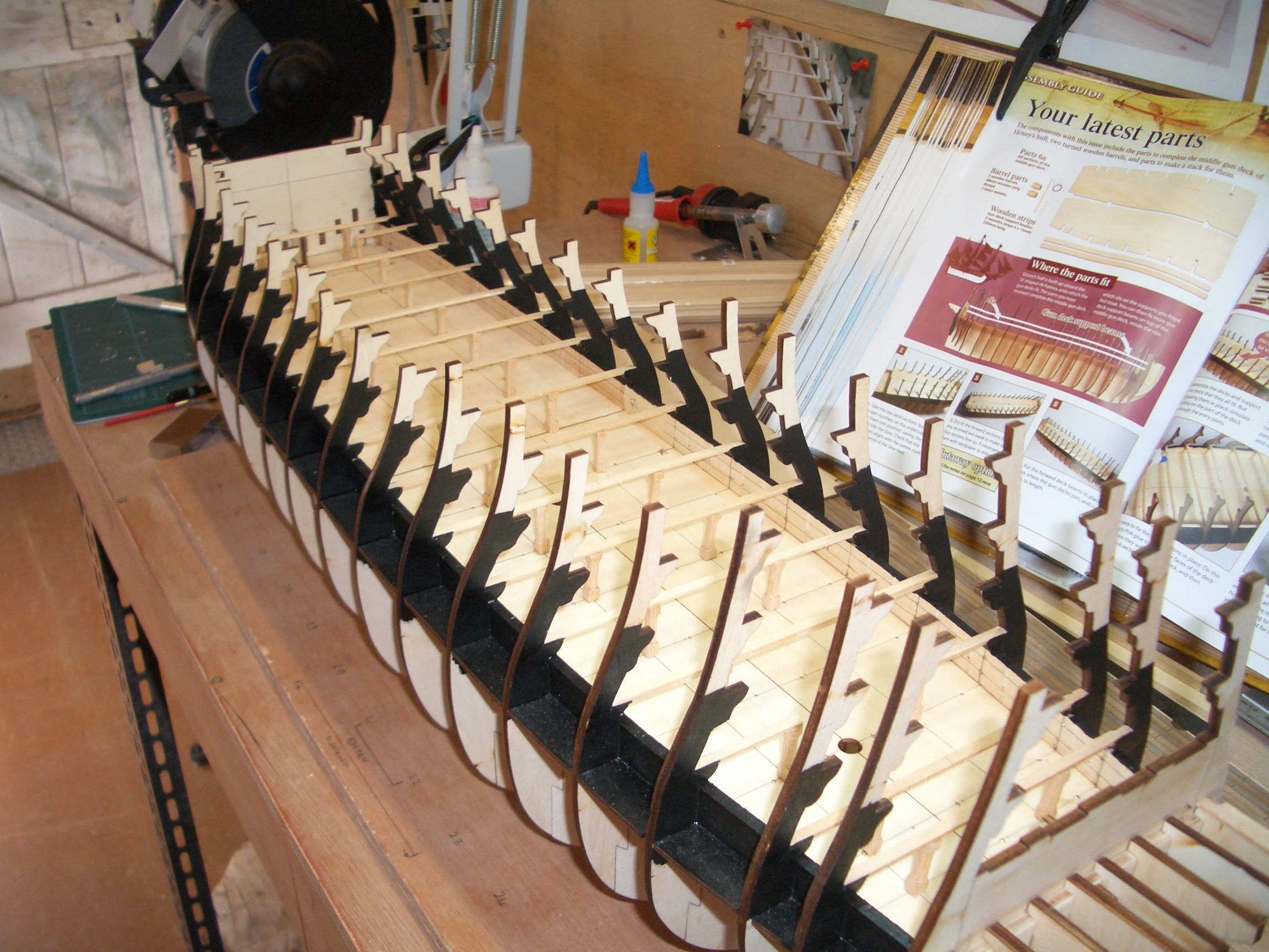

At Last!!!

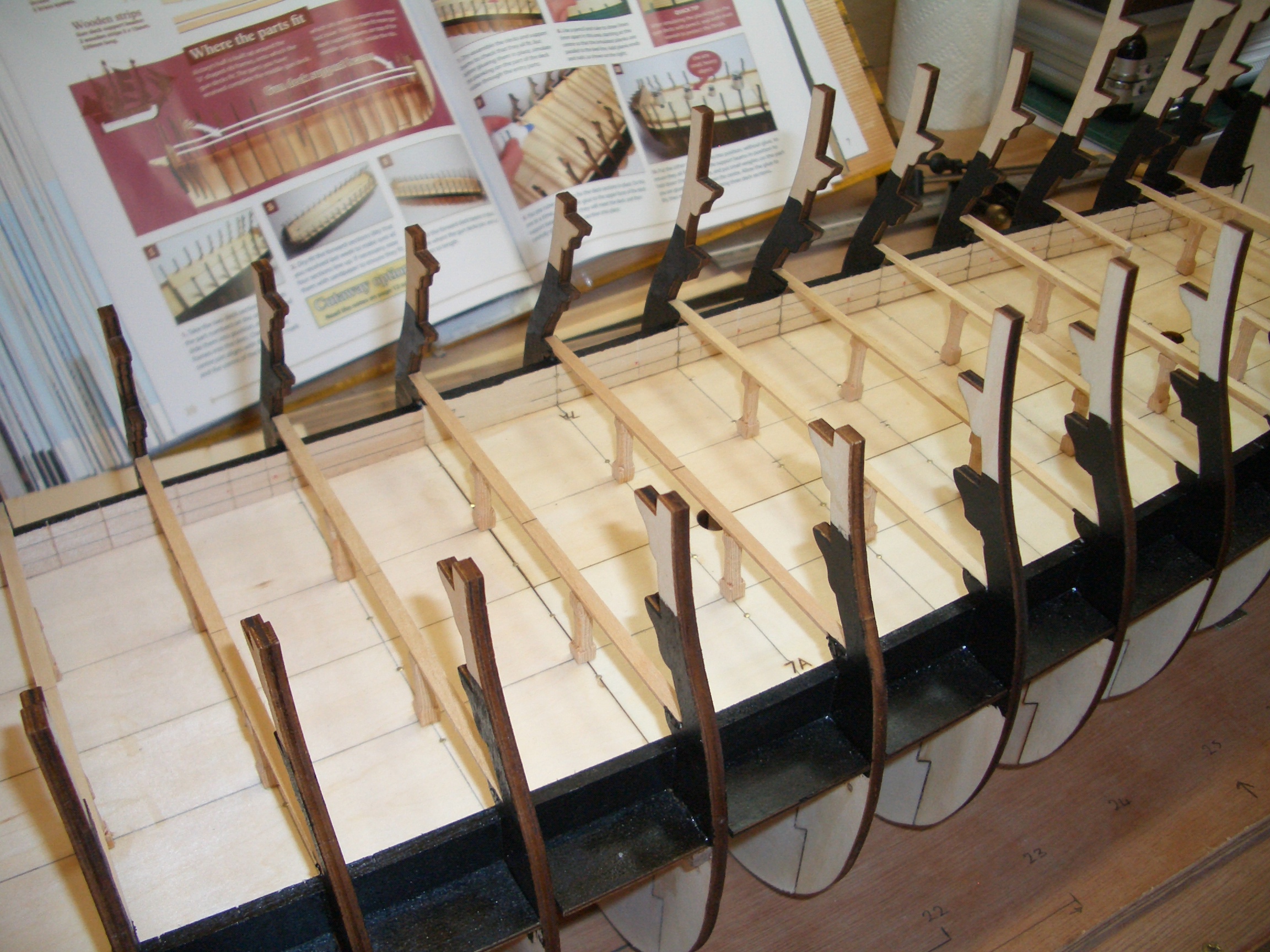

Absolutely brill work there...very nice in deed, I noticed the top of rib 15 there?? in your progression from applying the first plank up to the stage where you are at at the moment, has this had any affect on rib 15, i.e is it drawing it into line???...
Mellow
ArtfulBodger
#13 Posted : 07 October 2010 12:38:30
Joined: 26/03/2010
Posts: 146
Points: 473
Location: Plymouth
Jonny
Rib 15 is a nightmare but we all know that. My theory is sand where necessary and rebuild where necessary. I've used some 0.5 x 4mm strips to build up where needs be.

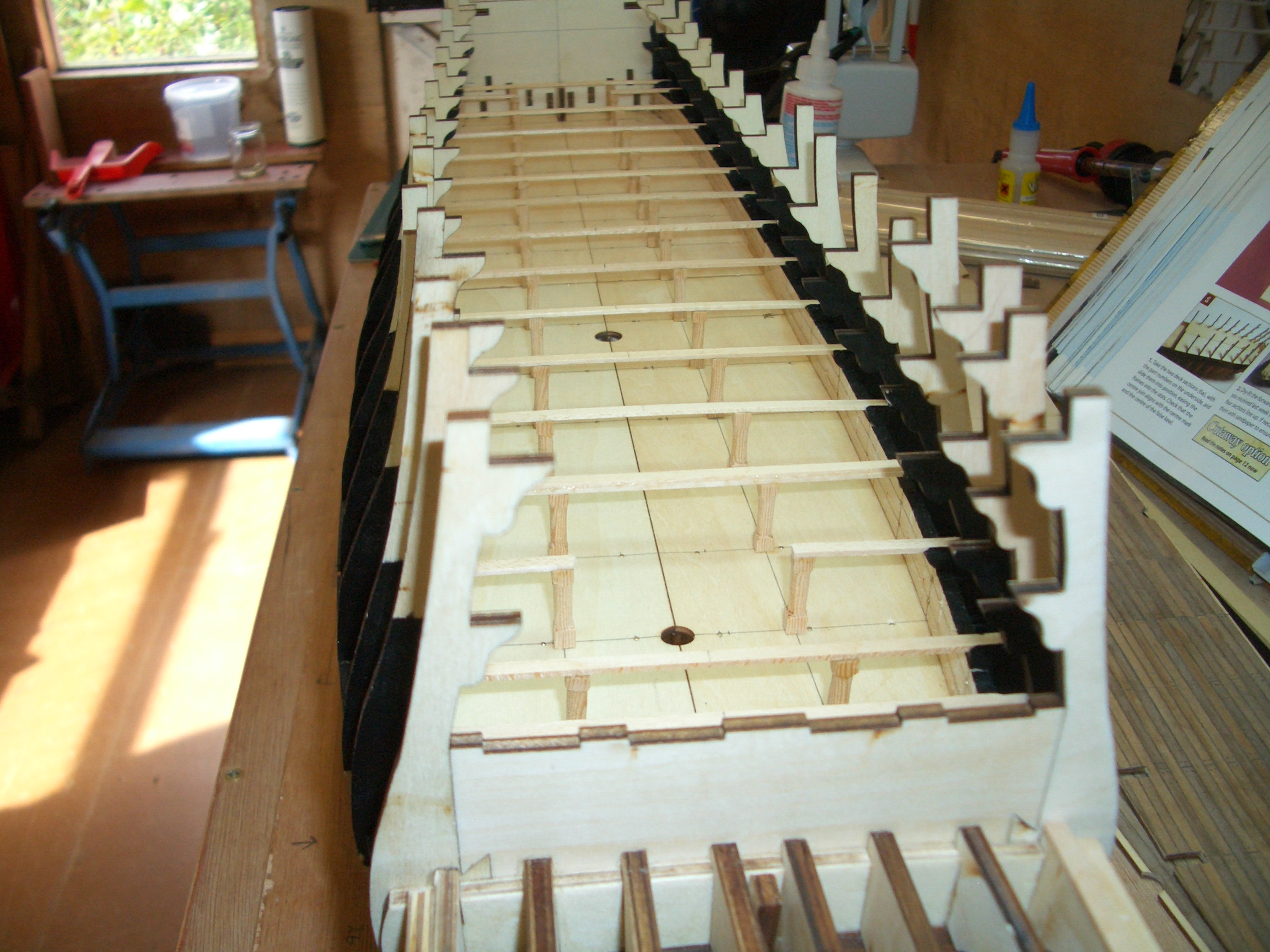

Hope you don't mind me saying but at the rear parts numbered 34 are mean't too be sanded flush too the keel like on Tomicks.
