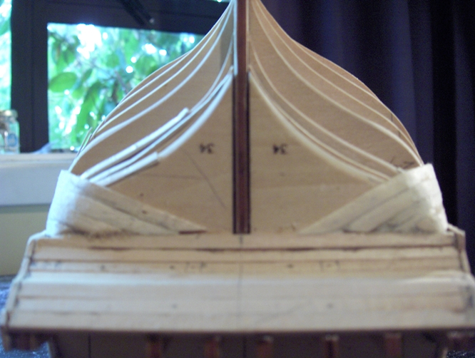

Here's my pic and my problem. As you can see, photography is not my forte and possibly not shipbuilding.
Got a funny feeling, looking at the pic, that the righthand side of fr:29 may be a little higher than the left.

Hi Sinbad, looking at the pic It seems that you have taken a bit more off the frames on the left of the photo during faring, although the frame on the left between the two you have built up looks like it could do with a little more taking off.
Basically there seems to be a mismatch in the profile of the hull between the left and right sides and this will lead to you planks not coming in line at the stern.
It's not actually that far out, you have room for about one more plank on the left and about a plank and a half on the right to get them to meet evenly at the sternpost.

Thanks for that Steve. I will strip it down and check measurements. You say it's not that far out Steve but if I carry on with this difference won't it affect the finished planking? I mean, it will be this far out from this point. Anyway, it doesn't look good.

Hi Cliff,
You should make the corrections so that the planks line up at the point where the sternpost meets the under gallery planking, once this is done the rest of the planks will line up.
You could get away with over tapering the remaining planks on the left side of your pic to match the right side or perhaps remove 2 planks on the left, match the profile a little more and re-plank with more of a taper.
