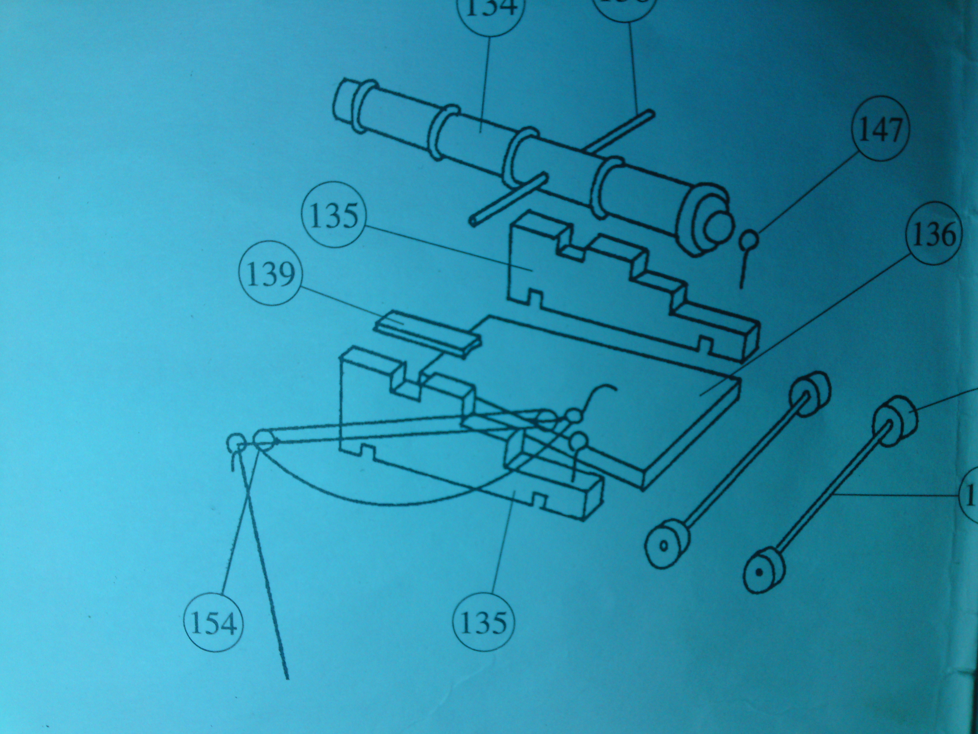

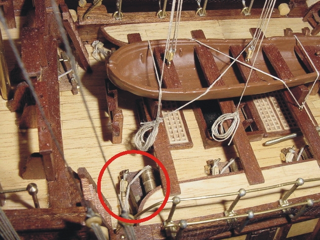

I am at a loss trying to understand the rather cryptic drawing detail provided with a Constructo Kit (1:85 Scale) of my HMS Pandora model. Attached are two JPEG files, one showing the drawing and one of a completed Pandora discovered on the Internet.
I am trying to reconcile the two files. Please can somebody help to unravel the drawing to the final construction as partly seen in the photograph of the centre deck area with the csnon circled in red.
Further, is there a "standard way" to secure a canon of that era to tbe deck with ropes to alleviate the recoil of the canon? Perhaps the Constructo Kit could be assembled this "standard way", if there is such a thing, or are all models different in this repsect?

Here is a Pic of a canon on HMS Surprise which is also a Frigate ship from the same era. If you rigg your canon this way you won't be too far out if anything...
Chris..

Hi Eugene
This is a picture I took on board HMS Trincomalee which is Europe's oldest floating warship.
You will see that the breech ropes which control the recoil are actually not very long because contrary to popular belief the cannon only recoiled a couple of feet on board British ships. Just enough to allow for re-loading.
The other tackle is for running out the guns after they have been reloaded. Notice how the long end of the rope has been neatly flaked down into a coil.
The third tackle hooked around the end of the carriage, would be taken to a ring bolt near the centre of the deck during action and was used to keeping the gun in the re-loading position on a sloping deck.
This photograph is how I finished my guns on my HMS Halifax model which is also a Constructo kit.
You'll notice that the guns have no breech ring at the rear of the barrel and the rope passes around the gun.
Hope this helps
Mike T
