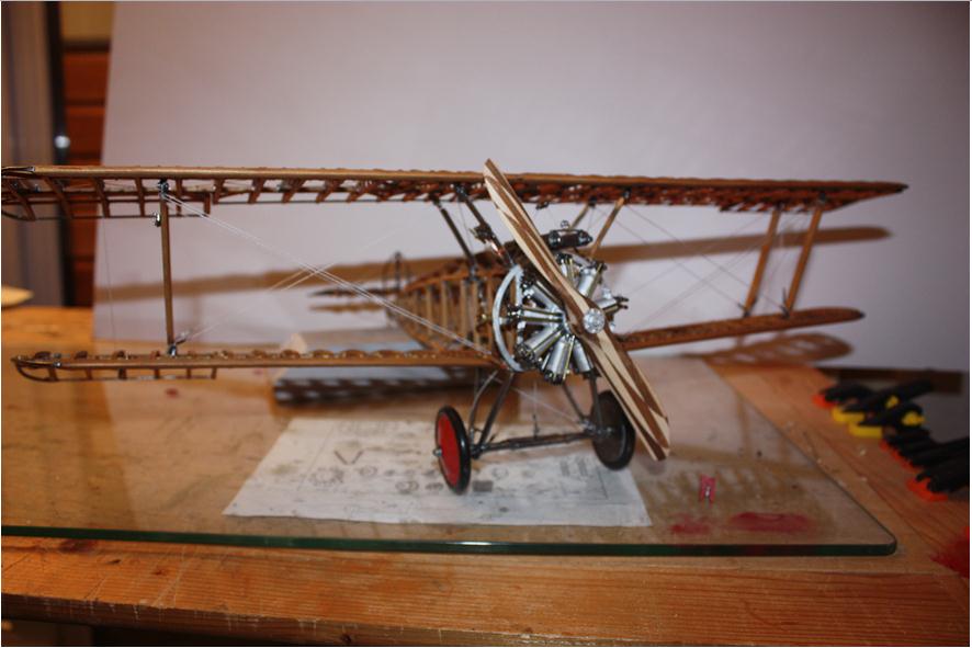

Well this build took a bit longer than I thought it would. I think I must have been spoilt by the comprehensive instructions that are part of Deagostini and Hachette builds. The instructions for this build where a bit sparse
This is Model Airways Kit that I purchased from the USA. Should you contemplate doing the same bear in mind that what you pay for the kit will not include any import tax/vat which will be payable when you parcel arrives in the UK. Their web site does warn you of this. Model Airways offer a free replacement for broken, missing or damaged parts which they have done so in my case, but bear in mind that it will take some time for the replacements to arrive (4 weeks in my case).
There are no instruction regarding what colours should be used so I have used a light stain for most of the woodwork, Gunmetal for most thing metal, red for the wheel covers (Mainly so it matches the Focker Tri Plane I built some time ago.)
Care is required when handling this kit, being a scale of 1:16 some of the parts are fragile and easily broken.The Britannia metal parts are soft and the castings do require some tiding up. After re gluing the fuselage for the second time I ended up reinforcing the joints with pins I had left over from my Victory build, the heads I painted gunmetal.

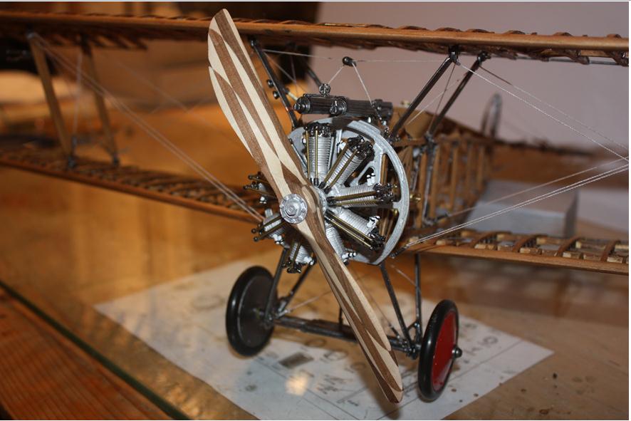

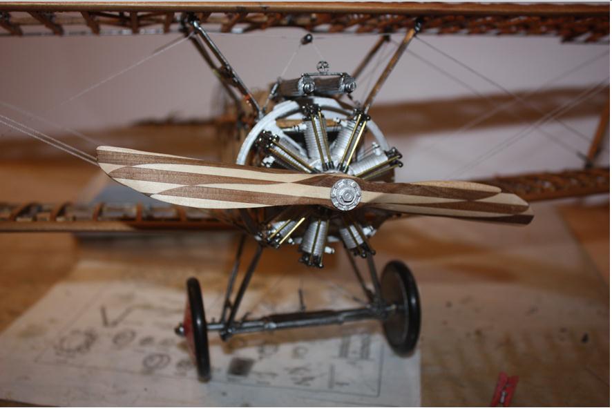

The Propeller parts supplied consisted of ply cut outs which I did not like so I made my own out of 4 X 4 mil lengths two different colours to give the finished effect of which I am well pleased.
One final point all measurements are in fractions as the USA are not metric. Had to download a conversion chart as all my drills are in mm

Love the laminated propeller by the way. Love Drool
