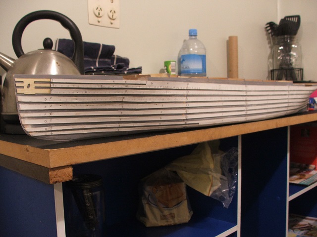

So having decided not to completely strip it down, I have added the 3 main side and bottom hull pieces. This has straightened out the keel somewhat, and the planking will further do this, I am ordering the etched Minibrass bulkhead replacements as I believe they will look much finer than the cardboard decals supplied. Once these arrive the build can really get underway. Until then, I will concentrate on getting the Hull planked and painted so the major part is done. Pics will be posted as i progress.

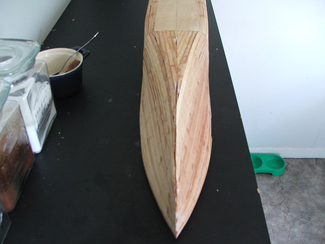

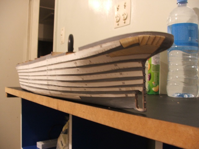

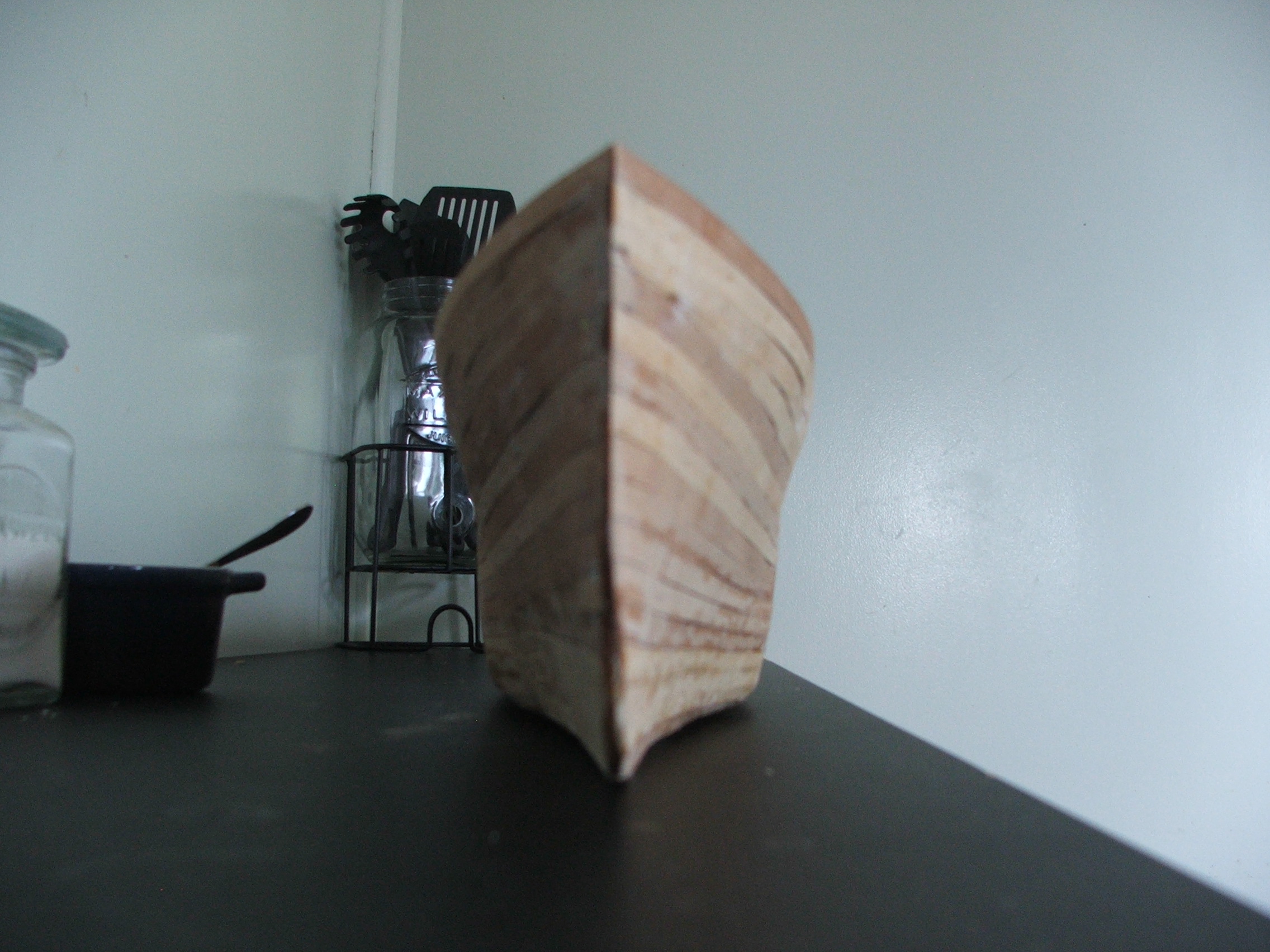

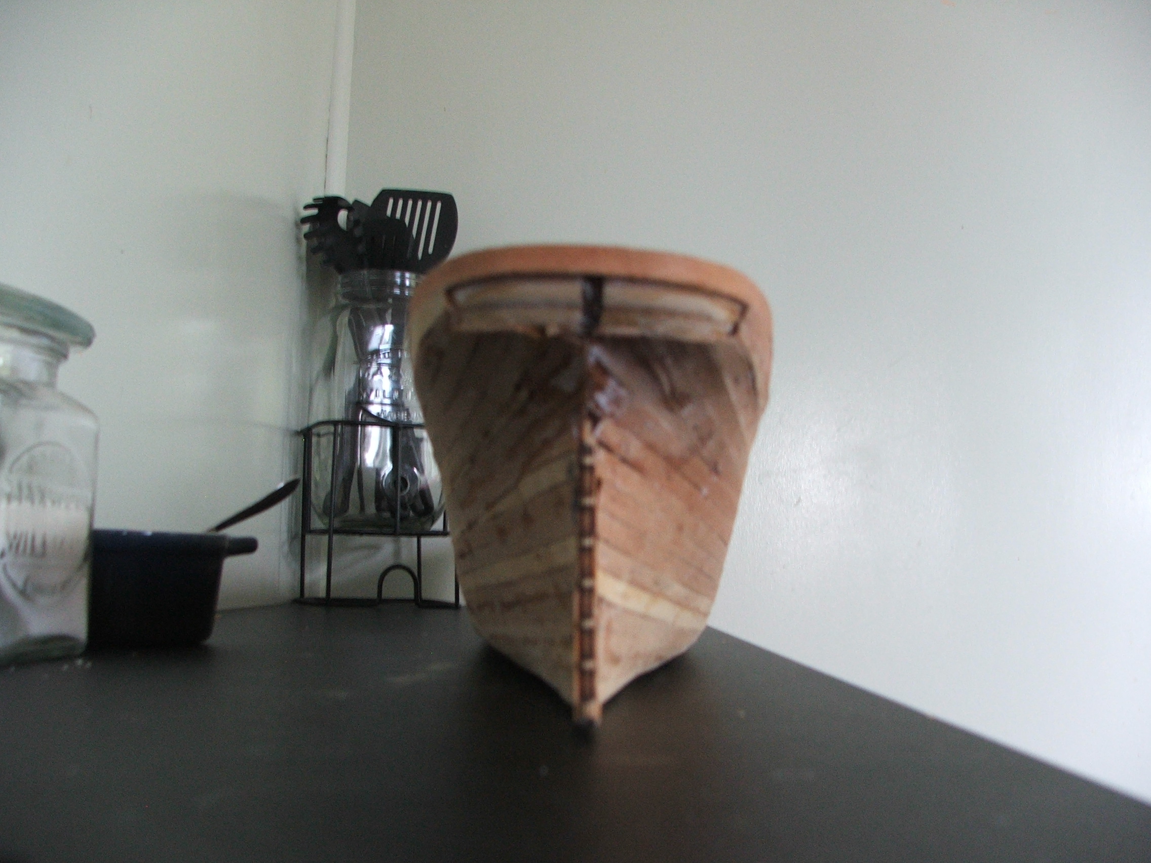

Hi all. Here is the first updates of my rebuild. The hull planking first layer has been completed. Next will be filling and sanding to give her a nice smooth finish before the second layer of planking goes on. More updates soon.
Titanic (1).JPG (913kb) downloaded 112 time(s).
Titanic (2).JPG (916kb) downloaded 63 time(s).
Titanic (3).JPG (918kb) downloaded 56 time(s).
Titanic (4).JPG (928kb) downloaded 53 time(s).
Titanic (5).JPG (913kb) downloaded 50 time(s).
Titanic (6).JPG (926kb) downloaded 75 time(s).

Titanic5972
#9 Posted : 01 February 2015 10:23:44
Joined: 09/12/2014
Posts: 75
Points: 224
Location: Timaru, New Zealand
And if someone could explain how to get my photos to show up here rather than as download links It would be greatly appreciated.

trying again with the pictures. These are the same as the ones previously uploaded but ive resized them so hopefully that works.
Titanic5972 attached the following image(s):

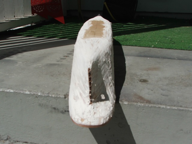

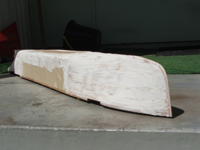

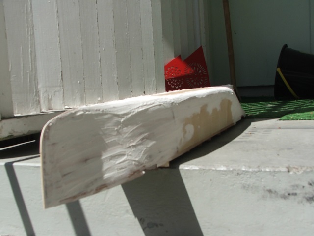

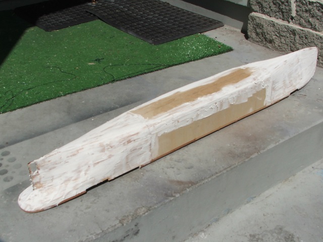

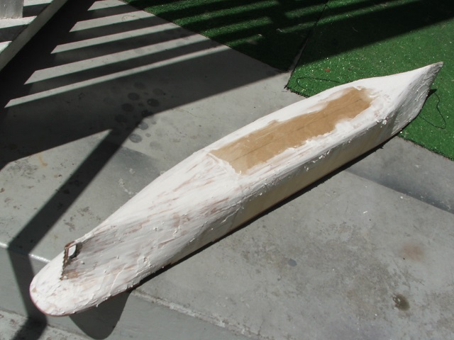

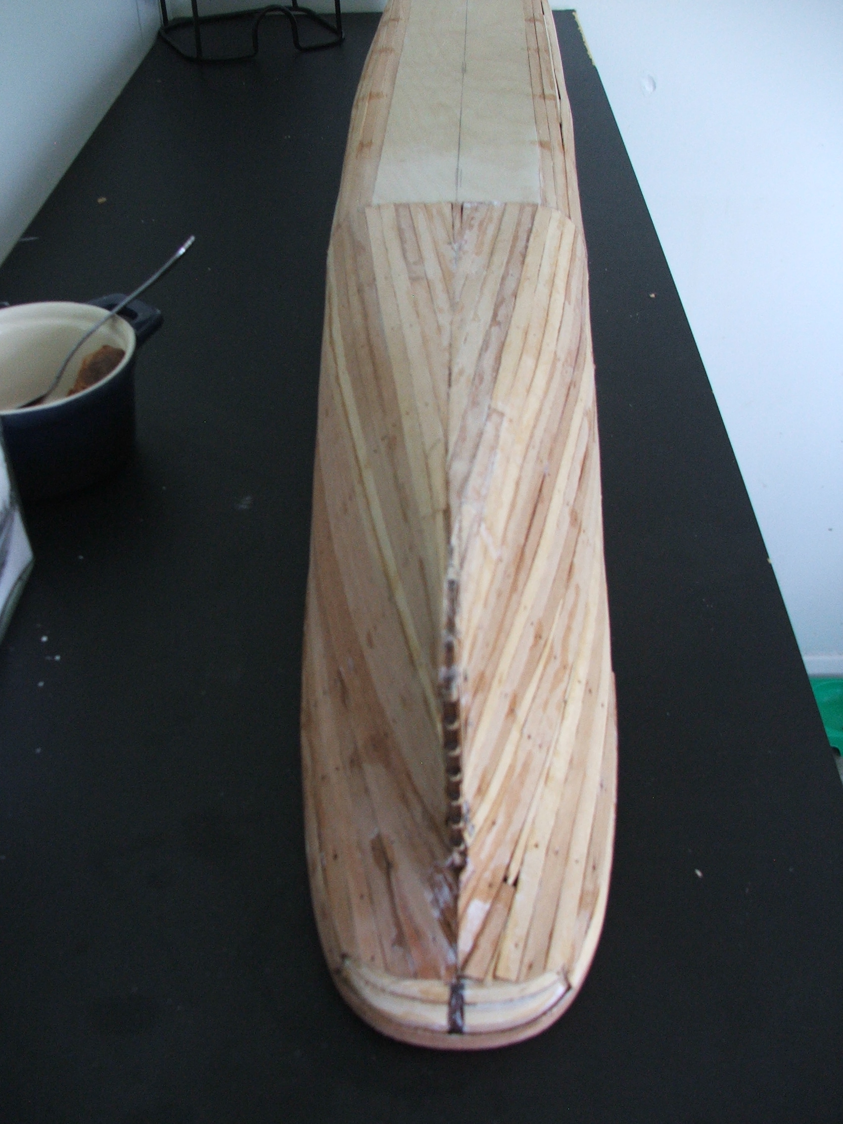

I have now done the first layer of filler on the hull. It looks Horrendous at the moment but once it is sanded down and has its first coat of primer, any holes will be redone and it will get there.

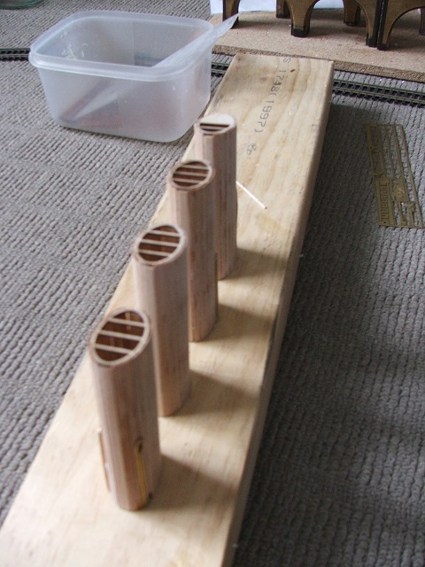

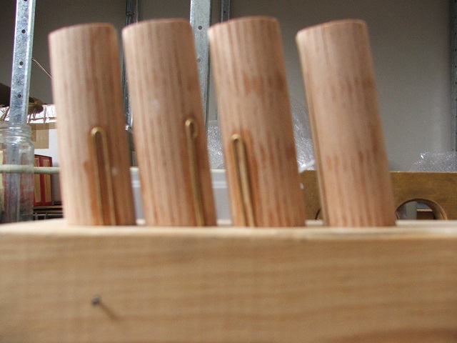

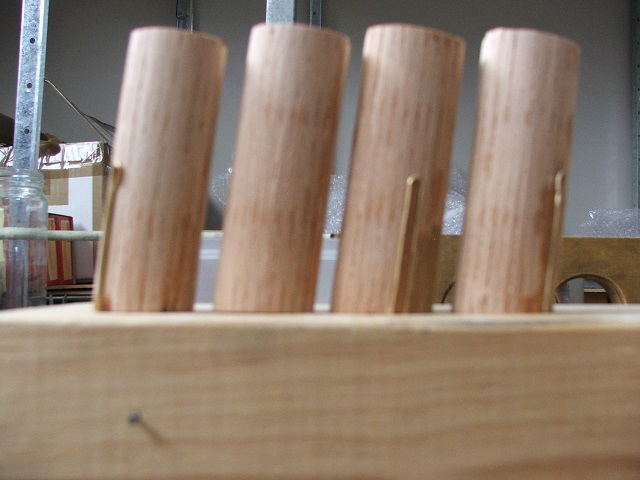

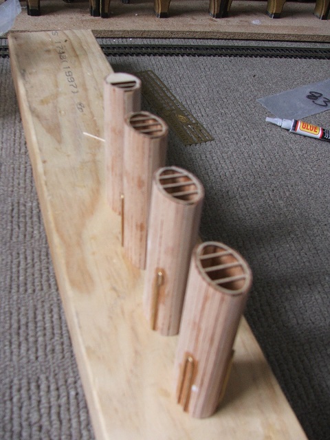

While the Hull filler is drying off, the funnels are underway. Just need final filling, sanding, & painting.

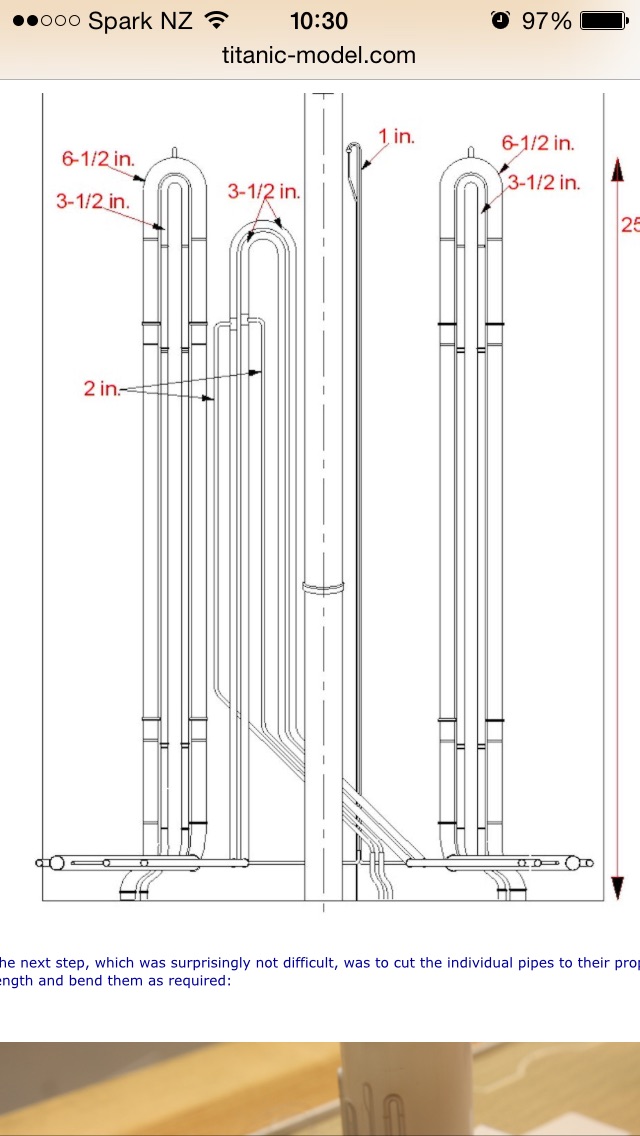

So I will be doing a few modifications to the funnel piping on Funnel 3. I've added a photo that shows the correct piping layout so I will be adding this to my funnel shortly. Picture belongs to Art Braunschweiger I believe.

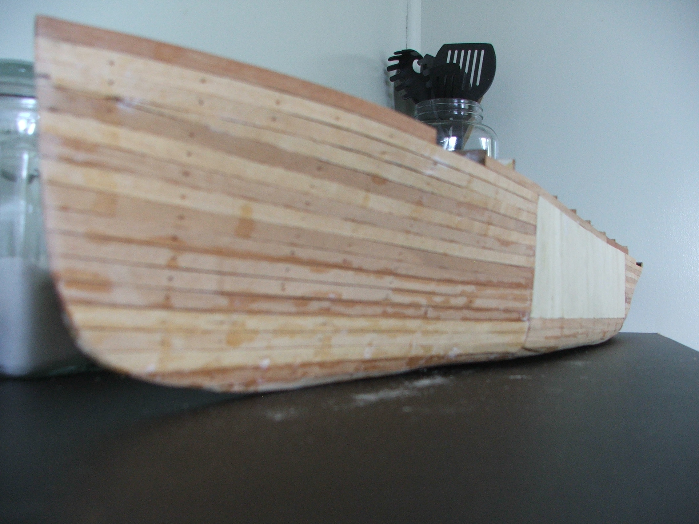

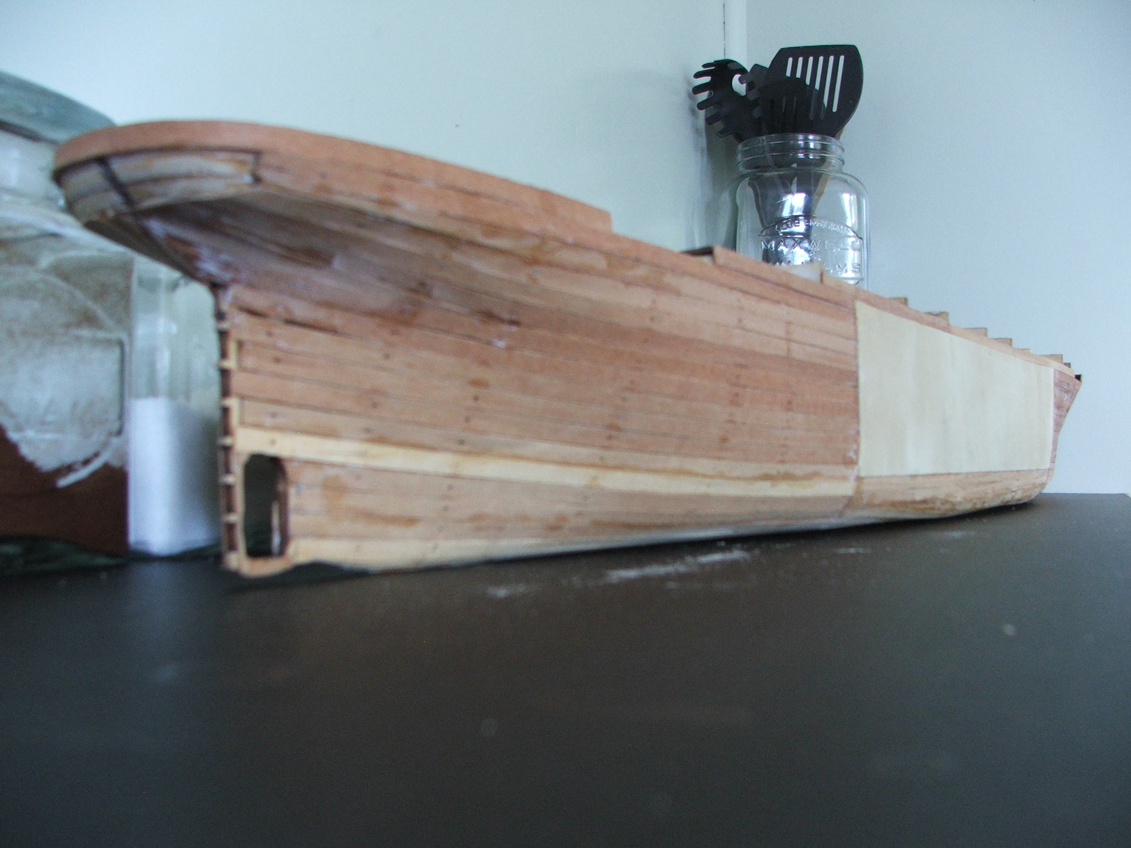

Here is the latest update. The port side of the hull has now had its second layer of plating applied and i just need to drill the portholes on this side. Starboard side will begin shortly.

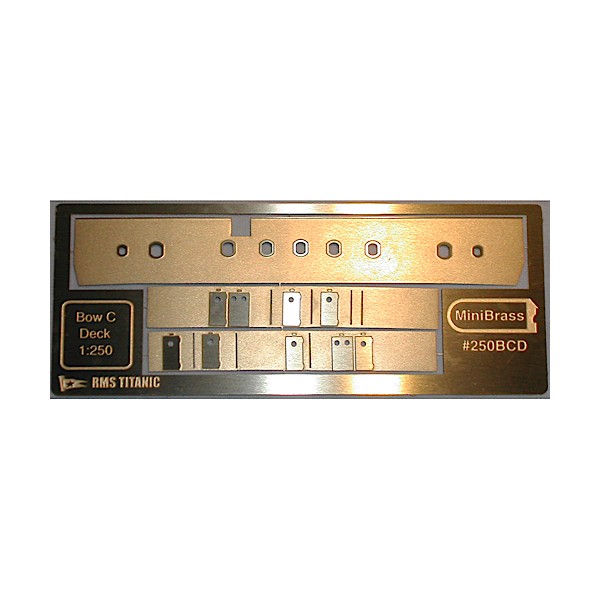

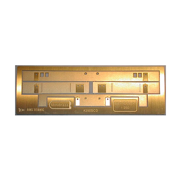

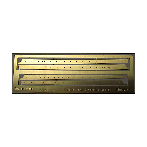

So i have ordered my first etched parts for the Titanic. The forward C deck parts, aft C deck parts, and the Bow & Stern profile pieces.
