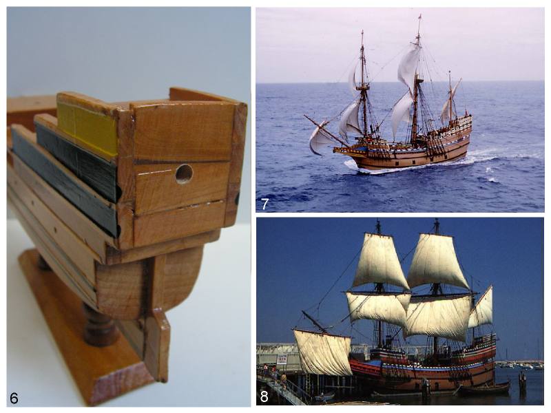

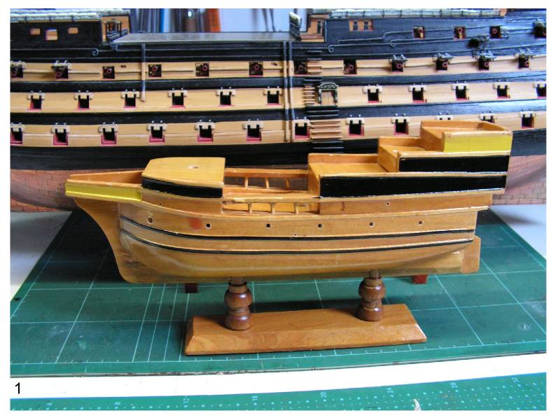

In Photo 1 we have the hull up against the old Victory. The Victory is about 180ft in length (the real one that is!) and I assumed the Mayflower was about 60ft which would have made this ‘model’ the same 1/100 scale (I’m thinking crew figures here!) In actual fact the original Mayflower was somewhere between 80 – 100ft long which would make this one about 1/120 scale. Still, we’ll see how it goes first, I might get away with it!Blink

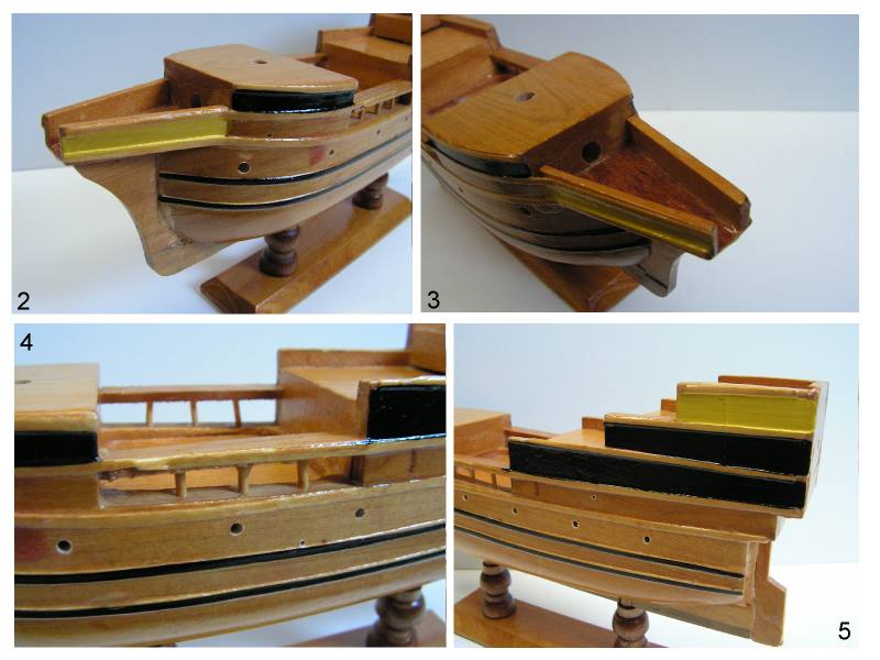

Photos 2 to 7 show the hull in all her glory. The first major mistake is that the Mayflower only had two levels of deck from the waist to the stern, not three as in this case. However, since this ship is built up out of solid blocks of wood, altering that is far too much like hard work! So three it will remain. Also, the two model Mayflowers I’ve been busy nicking photos of from the web both show solid hull sides in the waist so my first play-around will be to saw out those railings and then to sand down the entire hull from the waterline up before I add in the bulwarks, veneer the hull with some of the Bounty and Victory’s spare second planking and re-plank the decks with Costa Coffee wooden spills (I’m still ‘collecting’ them even though Messines was finished five months ago!)Blushing
The last two Photos 7 and 8 show one of the modern reproduction full size Mayflowers. This is the sort of appearance I want to try and achieve (with the lights down dim and a severe squint!)Flapper

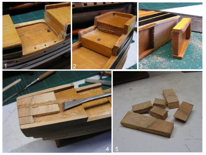

OK then. In Photo 1, the first part of the original kit to be removed was the ‘fence’ along the waist area. As you can see from the picture, one side came away cleanly but the other remained stubbornly glued in place and had to be sawn away. Eventually, the waist will be enclosed with a solid wall or bulwark with a new slightly raised deck level.
Now this would have been the main area of work on the overall deck layout, unfortunately (for me) dear Stevie-o (bless his little socksGlare ) mentioned that he had also received this ship from his Mum a couple of years ago and had also gone to work on it including cutting away that unwanted third deck at the stern. Well, couldn’t be ‘aving that now, could I?BigGrin So off it had to come as seen under way in Photo 2 and completed in Photo 3.
(I forgot to mention that after this, the whole hull was then sanded down to remove the varnish and the 'wales', these will be replaced after the hull has been veneered.)
That left the remaining half of the sawn through deck block to be either removed or shaped into a steeper gradient for the poop deck planks to go on. This was the point where my patience with heavy manual wood removal using files and sanders ran out. As you can see in Photo 4, I eventually found a far quicker technique – I used the Exacto razor saw to cut a series of lines down through the block and then used my set of wood turning chisels in a way they were never intended for – a good smacking with a lightweight hammer to chisel off the offending pieces of block which can be seen in Photo 5Blink . After a light sanding the poop deck then looked as seen in Photo 6. The stern torpedo tube is actually half of the hole pre-drilled in the stern which took a dowel used in the rigging set up. (I can still remember a 1940’s war time American cartoon about the Pilgrim Fathers with a really funny scene featuring the Mayflower – as the ship sailed past, the bow was full of 15th Century English settlers gazing at the New World, whilst at the stern was a full complement of US sailors in steel helmets manning an anti aircraft gun with ‘Anchors Aweigh’ blaring out!)LOL
It was as this point that I decided that the rudder may as well come in to the upgrade schedule, so off that came too as in Photo 7. I still have to go over the ‘stump’ with the detail sander yet though.

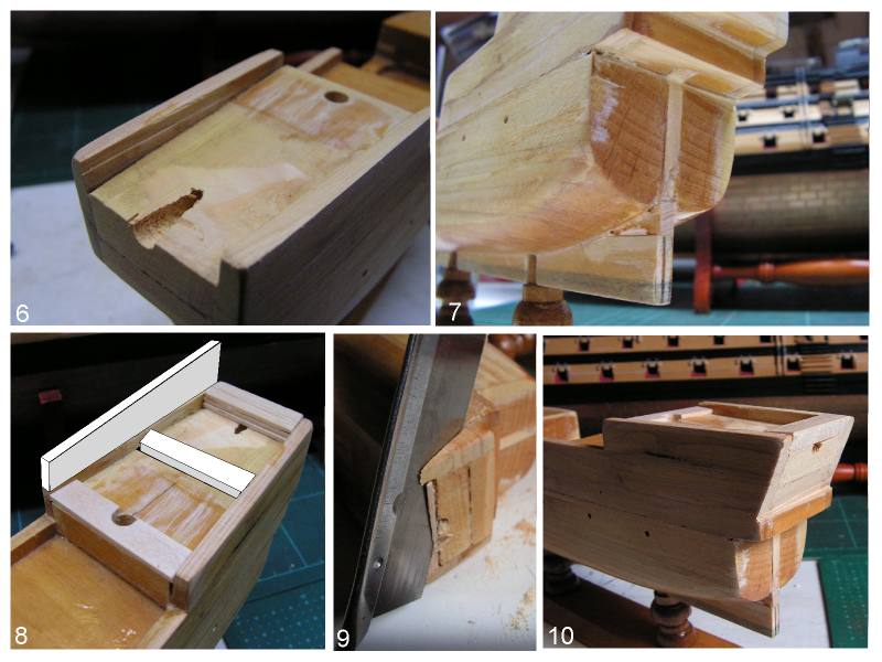

Photo 8 illustrates the poop deck with the first few ‘add ons’ – lollipop stick spacers to incline the future decking planks at the steeper angle. As you can see, the forward one has had the cut out ground away to allow the mizzen mast to go in later. The two diagram additions show the middle deck support to be fitted later and the proposed poop deck bulwarks to be added after the stern ‘plate’ has been cut to size and glued on. Before designing the plate however, the right angled stern had to be cut down into a raked appearance, there is only one step from the hull to the transom on the real ship, not the two found here. I simply drew a pencil line from the first step to the top of the stern and cut the excess wood away with the razor saw again as shown in Photo 9. The new sloped or ‘raked’ stern can be seen in Photo 10.
