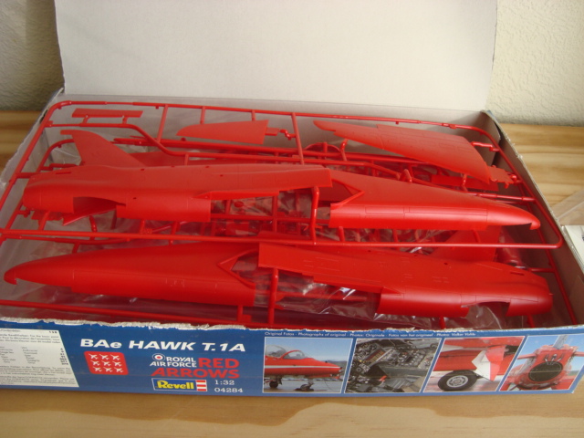

This is my Build of the year 2015 entry.
I will be taking my time with this as it will be fitted around everything else, plus the fact that I have the whole year to complete.
The build is going to be a Red Arrows presentation rather than a dio.
Contents of the build so far -
Revell 1/32 Read Arrows Hawk T1
3 Packs of Eduard etch for cockpit and External
Mastercasters resin pilot figure

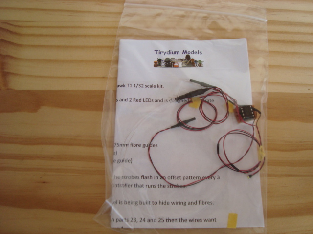

Tirydium models lighting kit
Airfix double pack of Red Arrows Hawks (1/72)
To follow at a later stage -
Metal pitot tube
Metal landing gear
Possible wing flaps conversion kit
Flightpath Hawk access ladder / work platform
Basically what I want to achieve is this -
A 1/32 scale hawk on the ground with pilot and steps, fully lit with nose light, strobes and wing lights.
The 1/72 scale Hawks will be overhead in the crossover maneuver mounted on lit acrylic tubes, possibly in red and blue. Like I said, not a dio but a presentation - I will also be incorporating the Red Arrows Insignia into the base too.
The difference with this build and what I am used is the paintwork, this one has to be perfect as it's gloss so a lot of time to get the surface prepared plus a bit of research into gloss airbrushing and top coats will be done at a later stage.
I want a beautiful finish with no imperfections. Weathering as you might imagine will be very subtle, just panel lines, gear bays, cockpit grime and slight chipping etc, I have plenty of reference pics for the job anyway.
So, you get the idea - more info with each post.
The build will start with the 1/32 Hawk cockpit in the next post.

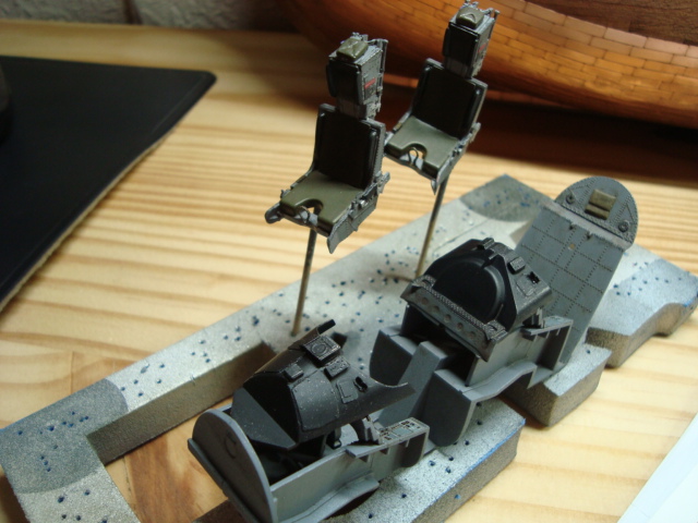

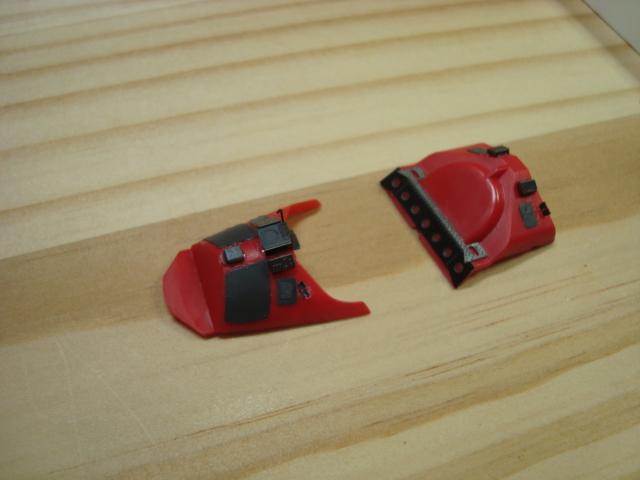

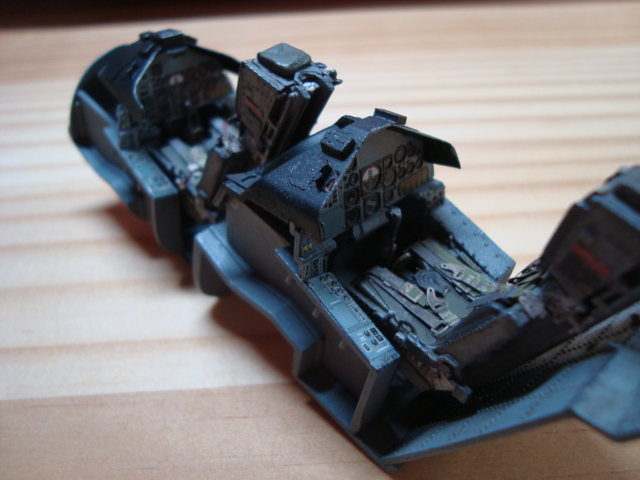

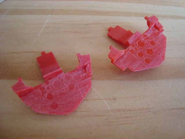

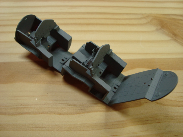

#9 Posted : 20 January 2015 15:05:33

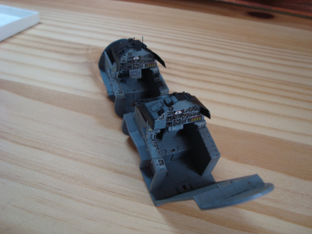

OK, and we're off! BigGrin

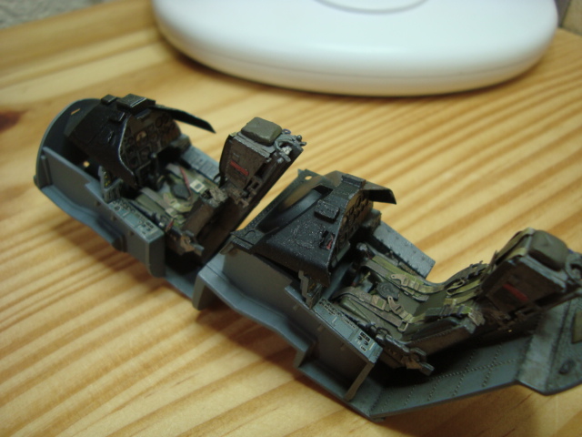

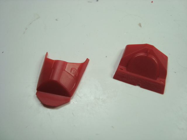

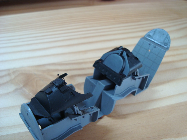

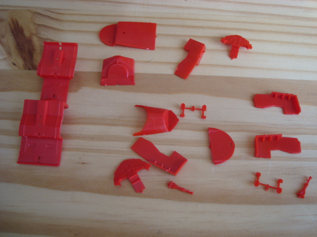

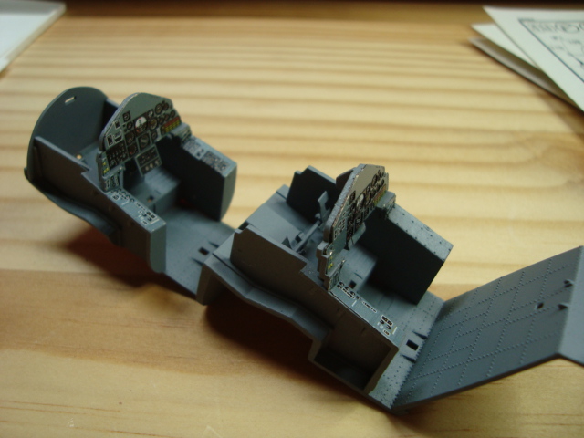

As usual the cockpit is first and in this case is going to take a fair bit of time as there is stacks of etch to go in when you include the seats. The red plastic is horrible to cover up but the fit of parts so far is very good.
The pics below show the parts to make up the main cockpit base. The instrument panels needed sanding off to allow the etch panels to go on instead, as did the side consoles too.
Primed it all using Vallejo grey primer and then a coat or two of Tamiya Ocean grey followed by a wash made from AK's grime streaks mixed with white spirit.
Loads to go yet, this cockpit will be around for a whileLaugh

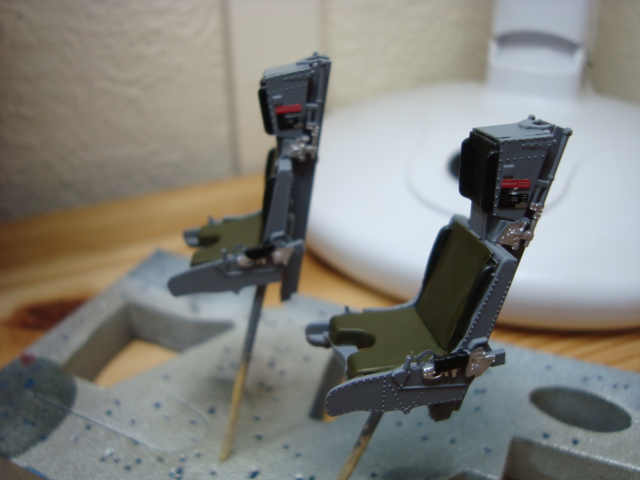

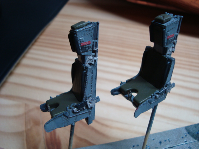

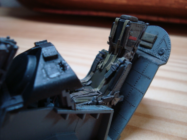

Thanks for looking guysBigGrin

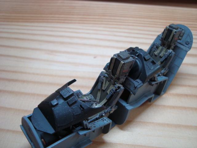

Firstly, a couple more packs of add-ons came today - the pitot tube (much needed on this kit as you will see later).
Also, the resin lowered flaps kit from CMK - Revell dont have any option to lower the landing flaps, only the ailerons so this kit is a must for an aircraft on the ground. I also have the etch and metal kit for the entry steps and nozzle and intake covers from Flightpath which looks very good.

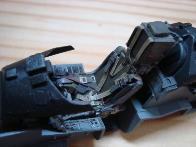

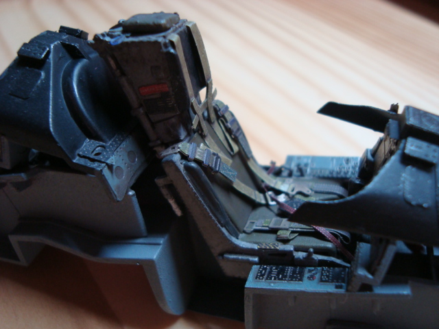

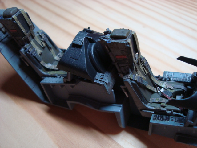

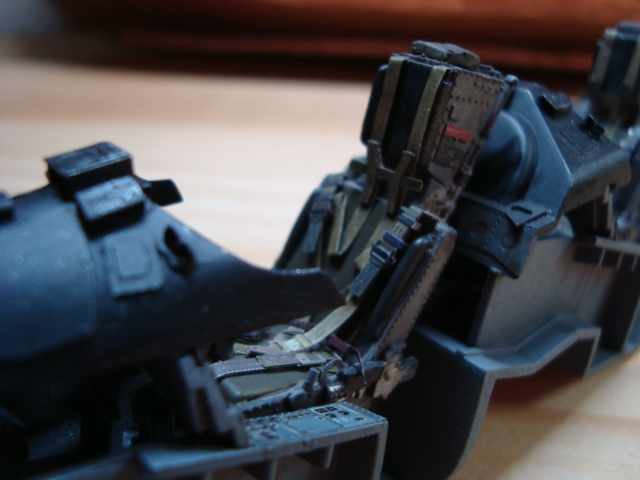

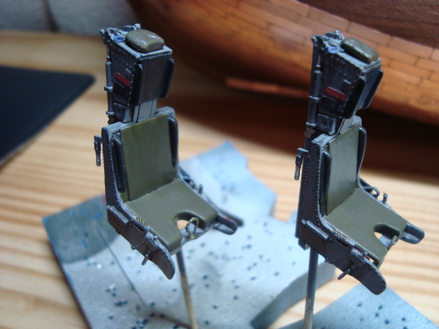

On to the build, I have done most of the work on the ejection seats and belts.
The cockpit base has also been chipped slightly, having seen inside one of these and I also have a few pics too, they are certainly not pristine cosmetically, very worn internally with loads of scratches and chips etc so I am trying to replicate a very well used cockpit area.
Revell did not include the drogue chutes on top of the seats or the doc folder on the bulkhead, I had to make these from clay.
Havent glued the seats in as I may still have to add a satin coat to the metal parts, not sure yet - also I think I may need to add some hoses on the seats tooBigGrin
Some progress pics anyway.
