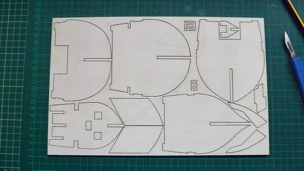

The bulk of the Hull framework is on two main frets with some additional infill parts on a third fret. These are identified and numbered as per the fret guide /part numbers plan included in the kit (the first 3 pictures below).

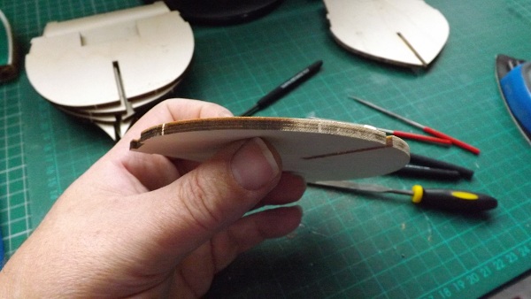

2.Having cut these parts from the fret by cutting into the attachment tabs on one side of the fret and then finishing by cutting completly having turned over the fret (the forth picture below).

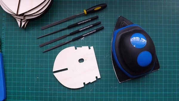

3. What I then did was to remove the ash from the parts which is left as a result of the laser cutting process. Gently does this stage of the buld as you want to remove the ash but do not want to start removing wood and altering the shape of these components. The fifth picture below shows the tools I have used for cleaning up the parts and the sixth picture showing some huge "sausage fingers" holding one of the frames will hopefully allow you to see how the part starts to look as the ash is removed.

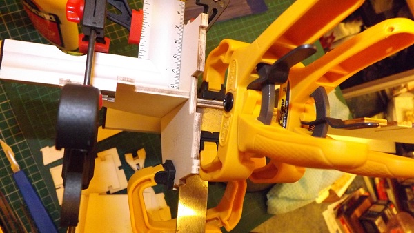

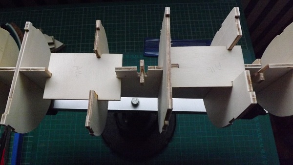

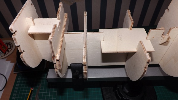

1. Having clamped up the False Keel I did a test fit of the frames to ensure that first and foremost they fit without being either too tight or too lose for the slots in the Keel (Pictures 1 and 2 below).

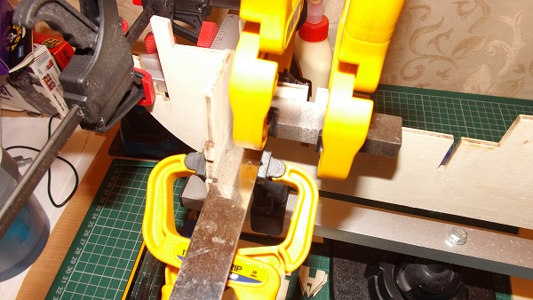

2. Having satisfied myself that the frames fitted well and are nice and level along the top of the keel (ie not dropping too far into the keel slots) its time to start gluing up.

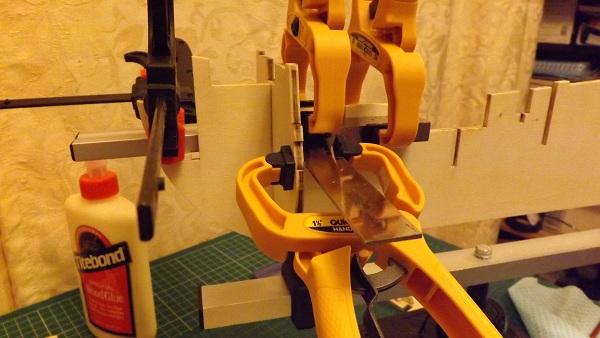

3. My prefered method of getting the frames square to the keel involves using a square (possible 2) and in this case some rather nice 1.5" Irwin quick clamps.
My glue of choice for this one is "Titebond" original Wood Glue.
Pictures 3-5 show the process of gluing and clamping up the frames.
