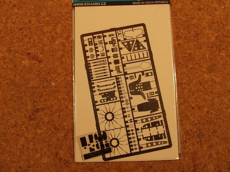

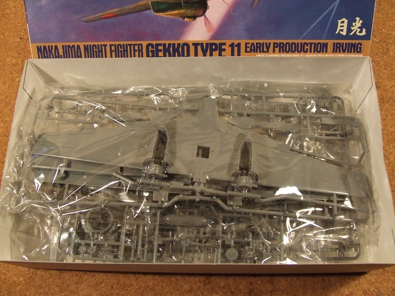

This is the Tamiya 1:48 scale (Early Production) J1N1-S Night fighter ‘Gekko’ Type 11 (Allied codename – ‘Irving’). The kit is typical Tamiya fare being so well detailed that it hardly needs any aftermarket goodies to be added!! However, I have decided to make use of the Eduard Photo-etch set for it, along with some very nice ‘Master Model’ turned brass replacement gun barrels to prevent the plastic ones from getting knocked off or broken, and an Eduard ‘Mask’ set to help with the painting of the cockpit framing. My reference material for this build is the superb ‘Modeler’s Eye’ (No.1) book for the aircraft type. If you’ve never heard of this series they are simply the best – though becoming very hard to get hold of!! Although the text is mainly in Japanese (it does have a useful amount of English as well) it is unlikely that you will need to worry about that as the book is packed full of many, many full colour and sharply photographed images of every part of the aircraft, so much in fact, that you simply won’t need any other reference material – it’s all in the book along with scale plans and colour profiles, plus all the correct colours are given in Tamiya code numbers, so you just can’t go wrong!!
The photos below show the kit and its' contents, the small amount of aftermarket stuff needed and my main source of reference material for this build, the superb ‘Modelers Eye No.1’ Reference book and some typical examples of its’ content.
Well, there you have it, that’s what I will be using for this build, it's a great kit and being Tamiya this should be a trouble free build and lots of fun, so I can't wait to get started. The next update will be about my start on putting it all together!!

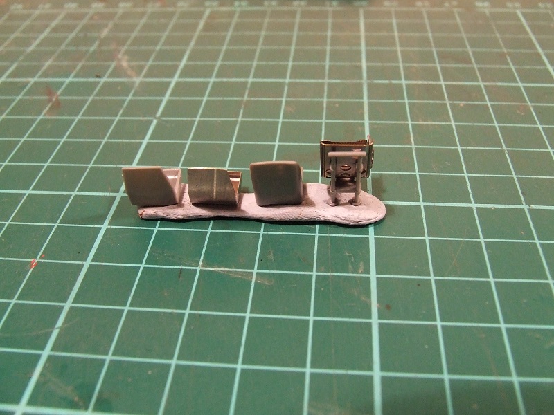

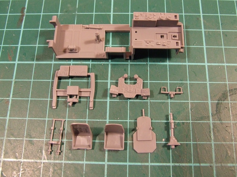

This won’t look like a huge amount of work done but it certainly took a few hours to do as most of it was about fitting some fiddly and sometimes very tiny bits of photo-etch with a bit of scratch building thrown in for good measure. As is usual with a model aircraft build work begins with the cockpit and fuselage internals, which on this aircraft involves an unusually high amount of work to do before I get to close up the fuselage halves, due to there being a pilots’ station, navigators’ station, then behind him the main radio section and aft of all that there are the oblique guns and their carriages. This update deals with some of the work in the pilot and navigator stations. The first photo below shows the main parts used in this section of the build.

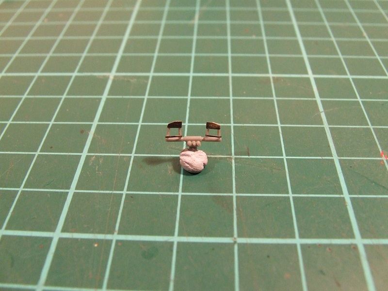

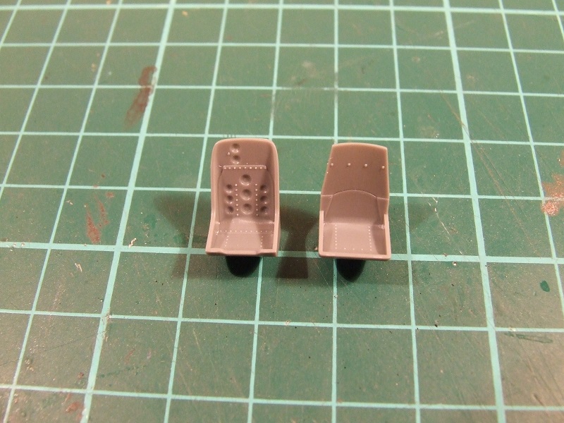

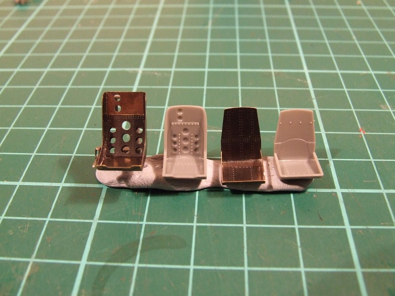

First job was to do something about those seats, which although the kit parts look pretty good, according to my reference material, they are not as accurate as they could be!! Luckily, the Eduard photo-etch replacements are very close to the real thing, if somewhat fiddly to assemble and even had the correct double skin on the pilot seat, the bigger of the two seats in the photos being for the pilot. The navigators’ seat was just a straight etch replacement part, but the pilots’ seat was a combination of etch seat, whilst using the plastic kit framework and I used a cut-down dressmakers’ pin to replicate the pilots’ seat adjustment lever as the etch part was flat in profile, when it should be round and just looked so wrong. Pre-painted etch seatbelts will be added later, after the seats have been painted.
Next job was simple and involved adding some etch footplates and leather straps to the rudder pedals. Before and after can be seen in the photos below.

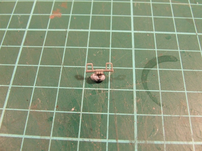

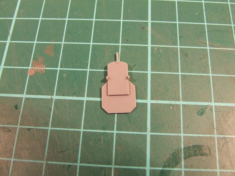

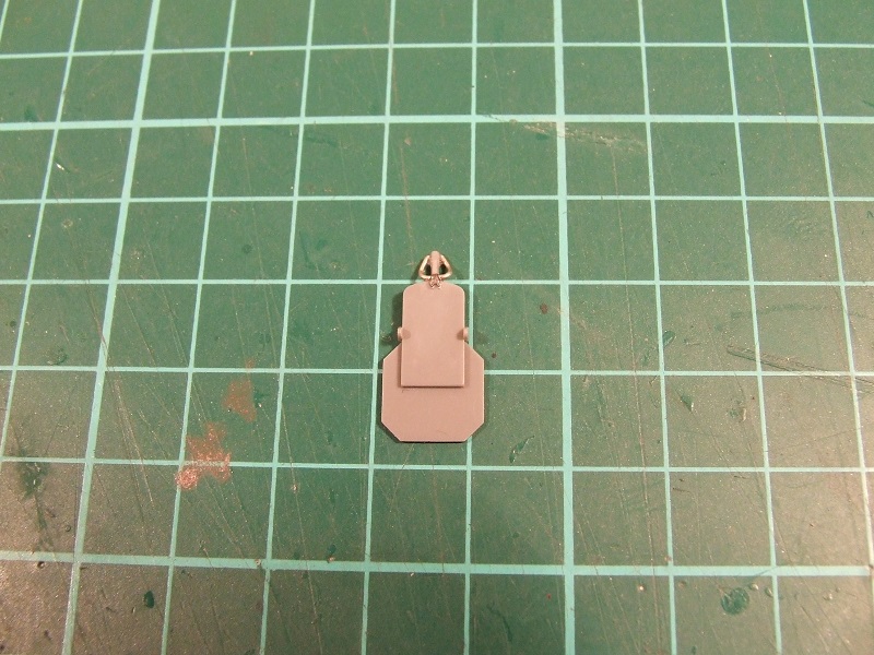

The pilots’ armour plate is a fairly basic part in the kit, but Eduard supply a small etch bracket in their set which fits at the top over a piece of fuse wire, which replicates what looks like a white coloured section of rubber ‘bungee’ between the armour plate and the underside of the fixed section of canopy? I presume it is some type of handhold loop by looking at one of the reference photos from my ‘Modelers Eye’ manual. Before and after can be seen in the photos below.

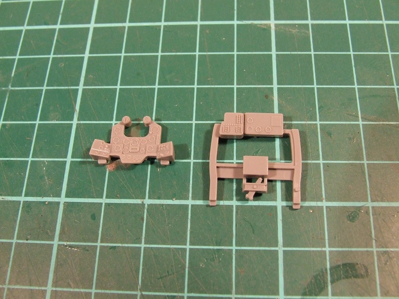

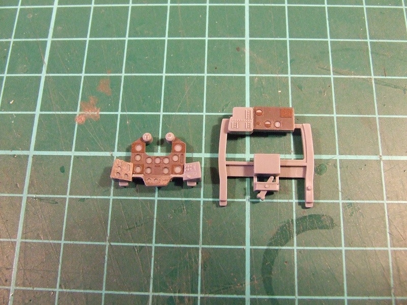

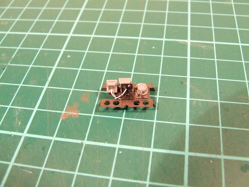

The pilots’ and navigators’ instrument panels were up next and all that was needed was to carefully carve away the raised detail where the better detailed Eduard etch parts will replace them once the main parts have been painted. The etch parts are not glued in place in the photos below which again, show before and after stages.

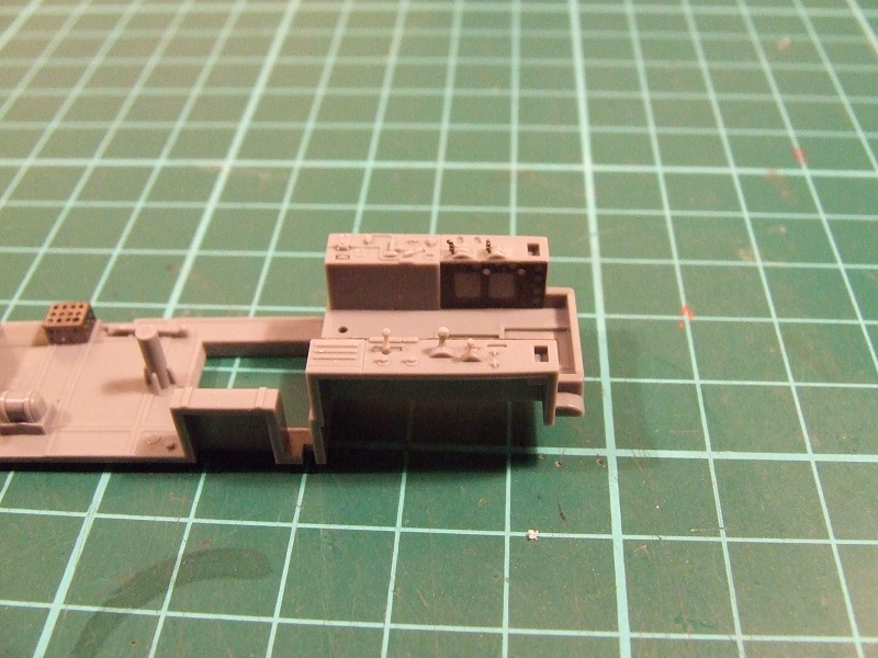

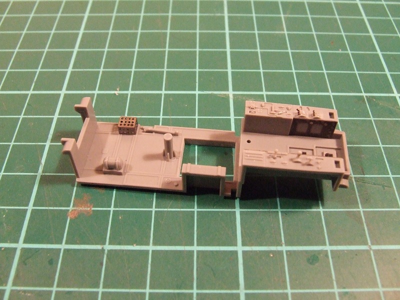

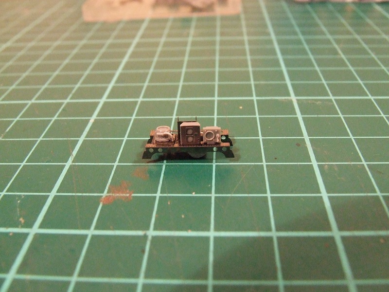

The main crew tub was next and several etch parts were fitted, all of them being enhancements where the kit part lacks detail including four tiny double levers on the port side console. There were three etch levers for the starboard side console as well but they looked seriously under scale according to my references, so I made them out of stretched sprue which was then melted on the end to form a blob and hey presto, new levers!

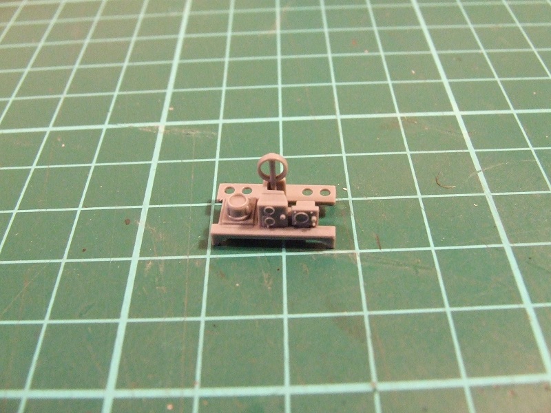

Last job for this update was to replace the kit part for Radio Compass and its’ mounting platform. Being situated in a very prominent raised place between the pilot and navigator and fully visible through the canopy, I was pleased to find that Eduard had gone the full distance with a near full replacement of the whole assembly. The only kit parts used are the compass binnacle which was surgically removed from the main part, and the compass instrument panels and the loop antenna. The rest is all etch. I also added some cabling from copper wire and stretched sprue to add even more detail. The last three photos below show the standard kit parts loosely fitted together and the Eduard replacements with added scratch built details.
Well, that’s where we are at the moment with this build. Next update is a continuation of work on the cockpit area and the rest of the fuselage internals.
Please feel free to comment or criticise if you wish.

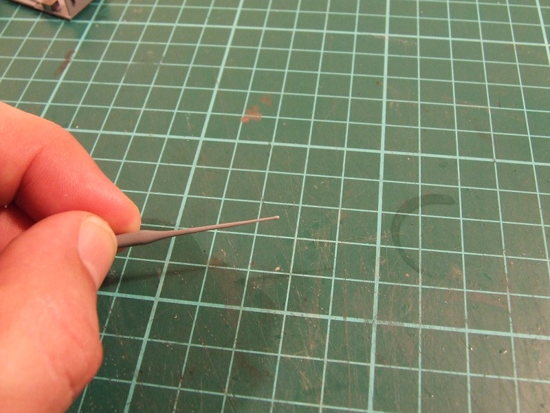

Yes, great stuff stretched sprue, many uses and surprising how thin you can stretch it out to .... once you've mastered the art of not breaking it in the stretch!! LOL!
