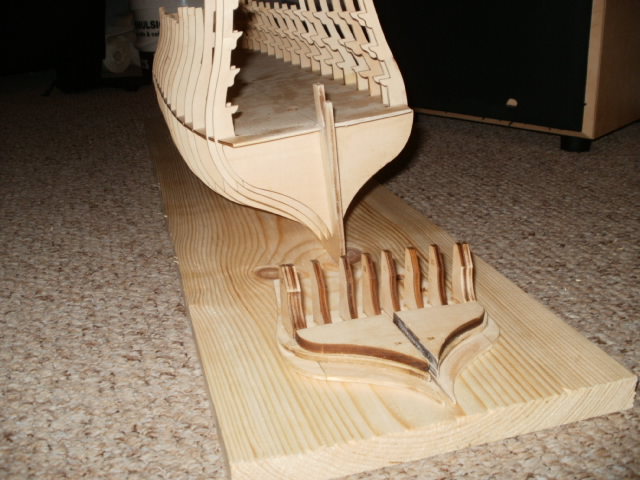

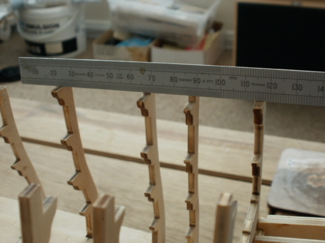

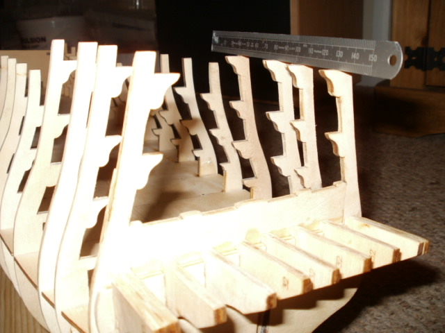

Well not off to a good start here, i seem to have the same problem as Foz got a warped ship, Darren (Son of Bullwark) suggested it could be piece 30 so i have checked and it does seem quite a bit higher any ideas shipmates.No use proceding on till i got this issue fixed going out later to get some bits so im gonna pick up some acetone and try and remove the end section.

#2 Posted : 28 October 2014 12:47:29
Hi John
Have you made sure all the formers are seated all the way down on the false keel as this can cause the type of problem your having.

#4 Posted : 28 October 2014 17:11:38
Id have to go along with Andy and say to check your formers are all fitted as far as they can into the slots, they may be very tight so you need really push them in. Some more pics might help, perhaps if we can see the bottom of the formers at the false keel. Good luck with it anywayBigGrin

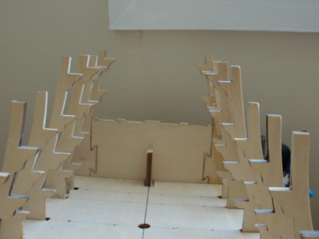

managed to get the back part off, sanded it down and retried it and its spot on dohhhh!!!!! silly me didnt have it pushed down properly

#6 Posted : 28 October 2014 18:23:35
Its easy done and quite a few have fallen foul of this. Good to hear its now sorted BigGrin

Yep sure was 2 hours with acetone to get it off but was worth it cos i didnt damage anything taking it off, also i am going to jig it up to morrow and make sure everything is spot on, no twists etc etc then i can carry on with the build.
