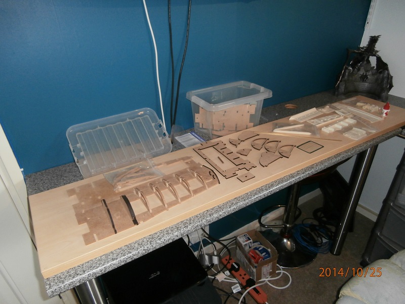

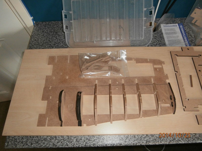

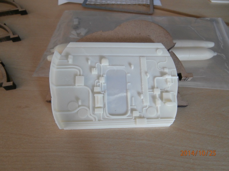

Hi all, start of another build.
I am building this with the torpedo room enhancement which I have now received but as yet I only have issues 1-3 of the Hatchette parts (issues 1 & 2 mainly being replaced by the enhancement parts). I expect issues 4-7 next week.

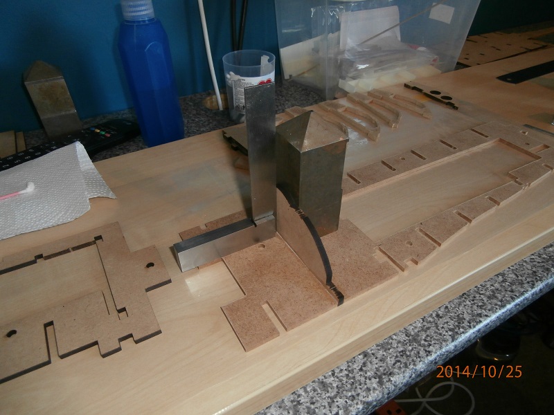

I have not glued any parts as yet but the photos show the bow with the bulkheads sat in place as the enhancement mdf parts are milled, not laser cut, which means all the slot corners need to be squared off with a needle file so the bulkheads fit correctly - which they did with no problems.
As I mentioned in David's build the ends of the horizontal slot just behind the forward bulkhead will need to be removed which I will do once all the other bulkheads are glued (but not the forward one) so as to prevent any excessive opening of the slot.

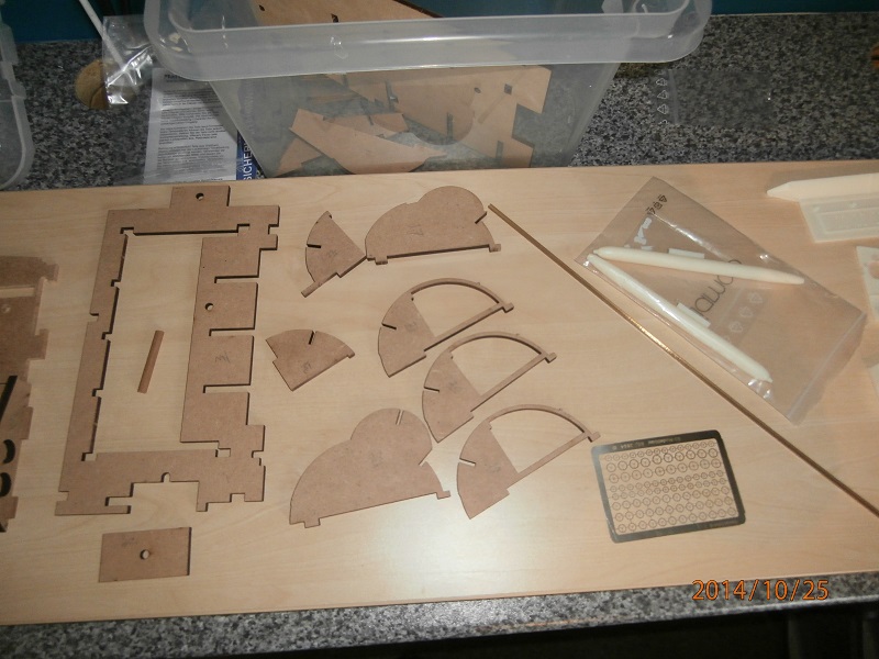

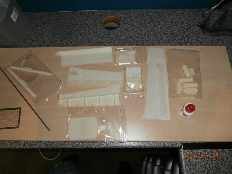

The photos show the parts I have to date, including the enhancement parts, laid out ready to start the build. The last one is a close up of one of the torpedo room bulkheads.

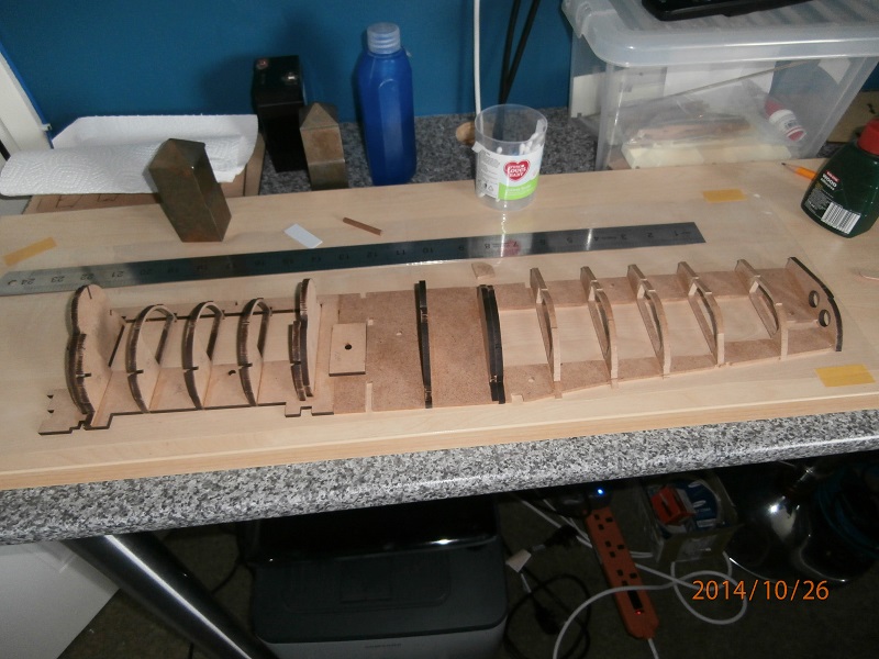

1st bulkhead now glued
