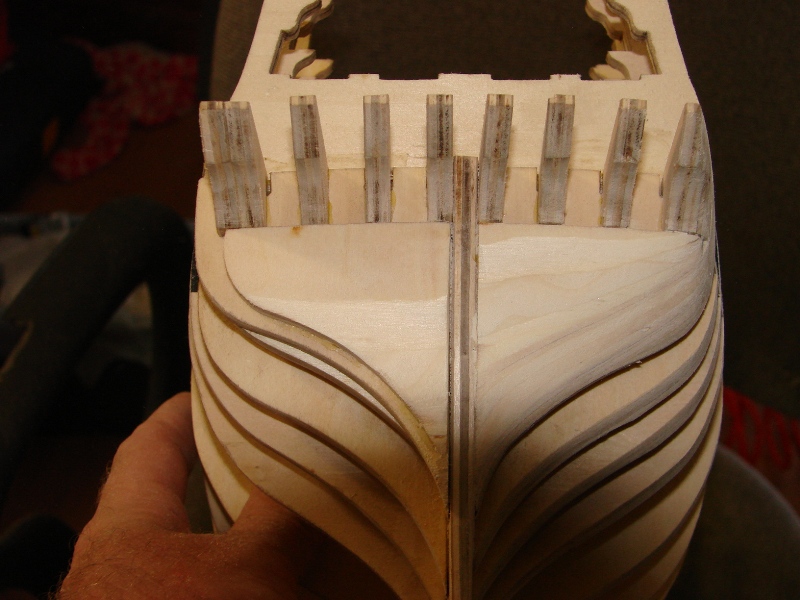

Before I make a huge mistake I need your help.
The sanding of the hull around the end bits 28-31 do they have to be even? One bit (forgive the lack of technical knowledge)is prouder than the other two so do I sand it down to be level. The photos are good but I need some very down to earth help. The mag says place a plank to check if smooth but I don't want to mess this bit up.
Any help would be more than helpful and fully appreciated but I will be cheeky and ask if it can be put in basic English -e.g you need to sand down part A to fit part B.
Thanks everyone, love the forum and everyone's advice.
As a complete beginner to model making this bit scares me.
I am also going to plank the gun deck just waiting for my planks.
Thanks everyone
Pam (Derby)Mellow

Hi
I am not so good on the photo side as my Apple Mac is playing silly devils with iphoto.
What I am worried about is which bit to sand down at the back of the boat is the bit that sticks out and its the bits before that that need I think sanding so they are all level.
I hope you tech lads can understand what I am asking.
Plus I noted Mr T on your photos that the square end you have curved slightly. God I have got to get a new computer so I can get some photos on board...
Cheers
Pam

Hi everyone
Its issue 20 picture no 3+4 showing rib frame 34, Do you have to smooth down so all the stern pieces are the same height? I hope you can all understand what I mean.
The insert on picture 3 shows all at the same height.
Thanks
pam
#7 Posted : 25 September 2010 15:23:25
You need to smooth the stern frames so they blend into each other in a gentle curve, this photo should help you.

#10 Posted : 28 September 2010 21:12:23
What do you mean by finish off, there isn't a great deal of fairing required at the bow other than ensuring you have a good contact surface for the planking to be secured to and for it to run smoothly, use a plank to check the flow around the bow up to the keel, have a look at my diary build for issues 20/21.
