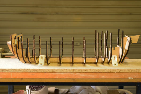

Hi All,
I just could not resist the temptation to make a start on my Black Pearl. (Following calls to first finish the Victory, Victory Cross Section, SOTS, Bismark and The Golden Hind - But what do they know?Sneaky )

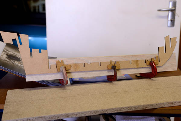

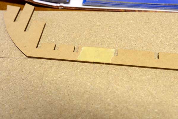

I decided to wait until I had all the parts for the keel and ribs - in an effort to keep things aligned and square. I glued the 3 hull pieces together and clamped them to a piece of chipboard. The masking tape is to stop the glue sticking to the chipboard.

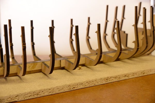

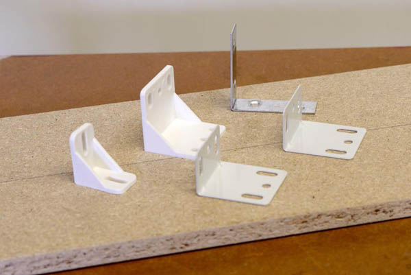

I bought an assortment right angle brackets to fit to the base.
(I must point out, that here in RSA, we have a hardware store that specializes in kitchen cabinets and wardrobes. Their prices are about 1/3 that of the main hardware stores.)
As it happened, I used these angled brackets and spring clamps to hold the ribs square as the glue dried.
Note: '...there is no such thing as too many clamps!!!'
Thats it for now. Hope to finish the ribs next.

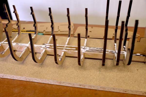

Hi All,
Fitted the rib braces and the remaining ribs. I had to move my angled brackets - and I think that I will cut them off when I fit the lower deck. I prefer to keep the ship attached to the chipboard for as long as possible - rather than using the frame supplied in issue 7.

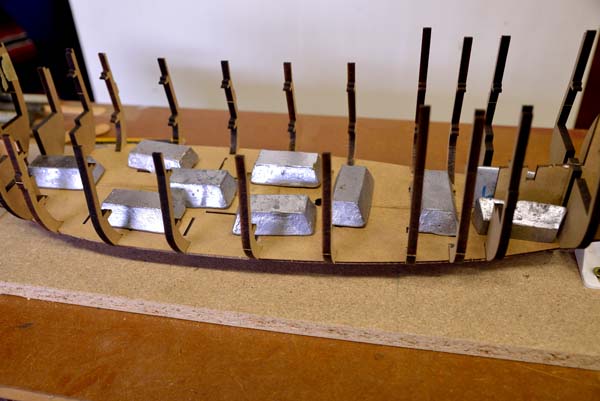

Spent some time on my Pearl as well this weekend. Fitted the lower deck.

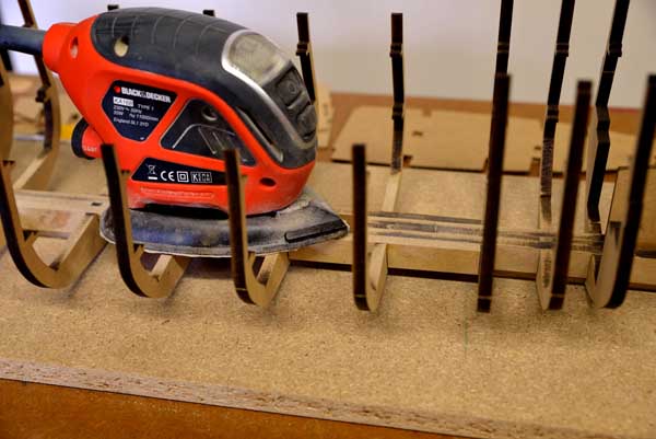

I sanded the inside of the keel and ribs, as well as the deck to ensure that it is a fairly loose fit. My little Mouse Sander works a treat for this.
I found that forcing these parts only causes problems later on. Parts warp and tend to move out-of-square if their fit is too tight.
Pasted on some wood glue and weighed down the deck with lead weights.

Your pearl is looking good. love the weights you used on the decking.
