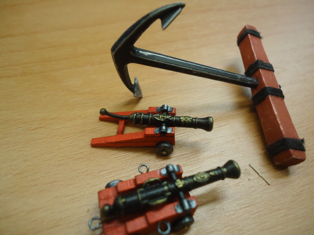

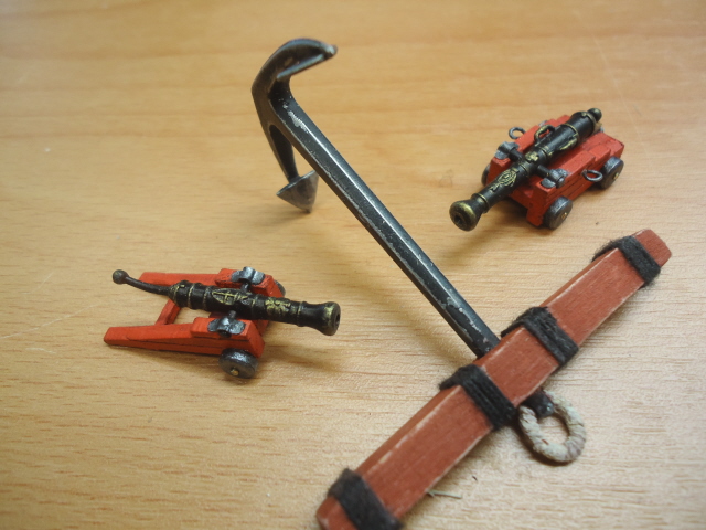

Here is the 1st start to my Diary build. Waiting for more issues to arrive but had a play round with building and painting a couple of cannons and an Anchor.
Ofcoarse I spent considerable time going through other builds and took note of how others are painting/finishing there cannons.
some I noticed preferred a more subdued finish to the bright red. I definately considered this but felt my self the cannons would look better standing out a little amongst the bussiness of everything going on with the deck and rigging.
Greg

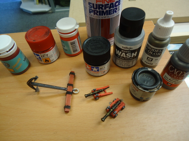

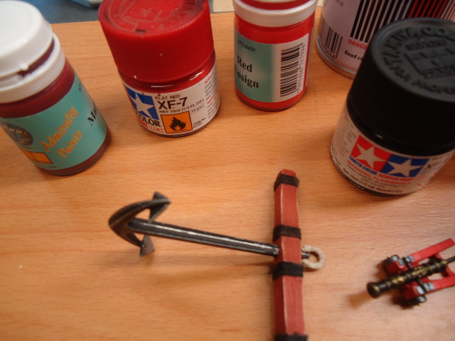

Here are some of the paints used
Cannons & Anchor were primed with Tamiya superfine surface primer then airbrushed with Tamiya XF-1 Flat black. What I like about Tamiya XF-1 on metal is that its not totally flat like on plastic..more of an egg shell finish. Followed by some subtle drybrushing of Vellego 70998 Bronze to the details and high points of the canon. Wheels and brass bits were primed and painted matt black and dry brushed with Game colour Gunmetal 72054 . The wood on the canons was primed with Tamiya fine spray primer then painted with Tamiya XF7 Flat red then over coated by brush with the Admiralty paints Red ensign then given a vellego dark grey wash to give a bit of depth to the red.
Anchor wood was Tamiya spray primed, sanded and then I brush painted with the Admiralty paints moroon colour. I quite like the contrast of the maroon to the black thread. I will add some boltheads eventually to the block. I then subduely distress sanded the edges of both the wood and the metal edges.
As this ship is my first build I'm looking forward to trying some weathering techniques that may or may not succeed.
Photo showing paints used.

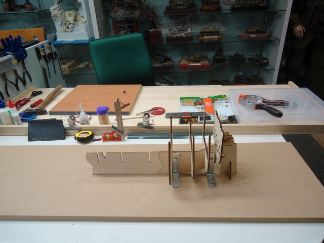

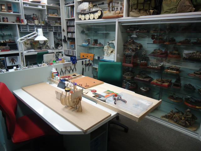

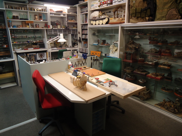

This is the Drydock where the SOT's Is to be built, although the occasionl red has been drunk in hereLOL . Thought it might be interesting to see it rise from a few ribs through to compleation. As a plastic kit modeler I have lots of other builds to keep me busy while waiting for the next issues. I'm primarily a 1:35th scale Armour/Diorama modeler. But also build 1:32 aircraft 1:20mm Mak (scifi)and a few busts and figures.
Pics are a bit dark as I had to turn the lights down low to take a few pics. Normally it is lit up like a Xmas tree.
Greg

BigGrin That's a very nice build/display area GregCool
#11 Posted : 13 September 2014 12:31:40
Greg
What a wonderful workspace you gave yourself there if I ever win the lottery (that will be the day pigs start flying LOL ) it's the sort of thing that would be at the top of my wants list.
Looking forward to seeing how your build comes along. Believe me those 4 weeks shipment times will not be noticed once you get into this build. There is lots to do and those parts will suddenly start appearing very quickly.
#12 Posted : 13 September 2014 22:15:10
Now that's a workspace most members would give their eye teeth for, looks very well laid out too..... Cool Cool

Thanks for the kind comments guys. I'm pretty fortunate to have a very supportive wife who loves my hobby. I've always felt as a modeller that its important to have your own work space for modeling no matter how small or big it is. If I dont go into my room within a 48 hr period I get withdrawal symptoms Crying.
Tony I think you are quite right that it wont be long befor the issues start piling up. I'm taking this time to find things I dont have such as an electric plank bender and various clamps etc.
