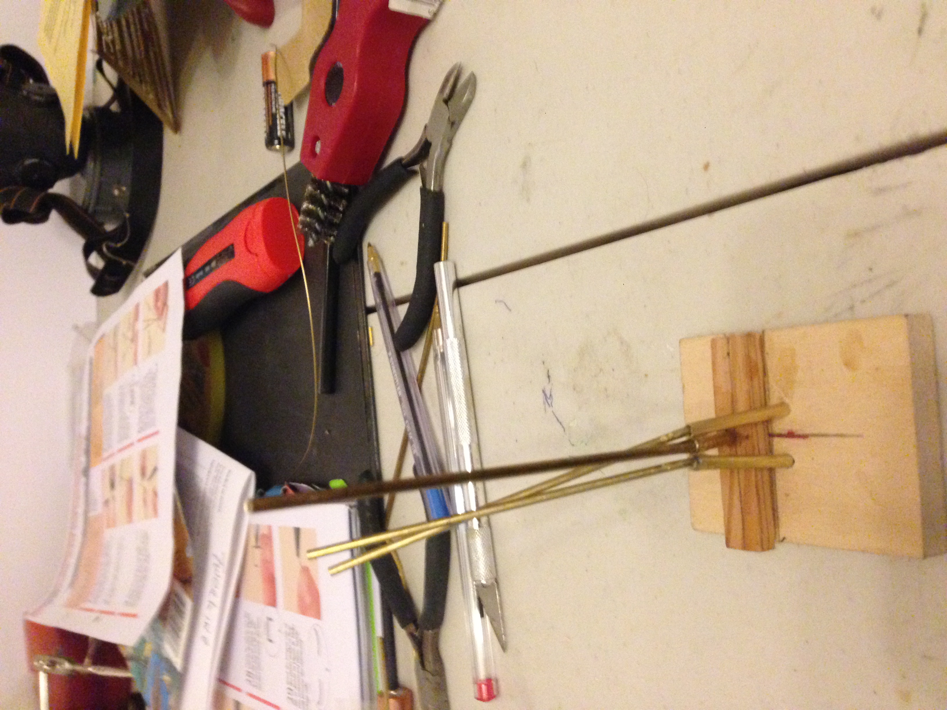

Thanks for all your tips, they have really helped me. I am sorry to say I could use another tip. I have got the rods for the back masts bent properly at least according to my eye-balls and protractor, now I am trying to figure out how to solder or glue the connecting rods (at least that is what I call them). While the fit nicely into the 3mm base tubes at the base of the structure the fit is a bit loose so they 'spin' rather than stay stable. I am wondering if you simply laid them on a flat surface and glued them to the side of the mast? If this is what you did how were the two mast positioned so that they would fit back into the brass tubes without breaking the glue joint? Did you glue the rods into the brass tubes so they would not spin? Any suggestions you have will be greatly appreciated. I really want to try this but I am getting a bit frustrated. I have enclosed two photos that show one of my issues.

What i did was bend the tubes as you have done to get the angles right, next you will need to stabalise it all by fixing the bottom three large tubes together. When you do this you can remove the upper outer two rods to prevent them sticking together, to do this i first used superglue to fix them then a piece of very thin metal strip to go around the joint to tidy it up, the searchlight platform goes on top of this strip.
Next replace the two outer rods if they were removed and prepare to add the first spreader rod, this will be the longest rod taken from the the preformed mast that came with the kit that goes across the top to each rear mast glue this in position with super glue. This will give you the correct spread and width for the rear two masts. Now these need to be attached to the central forward mast, this is done by again taking the longest upper rods and fixing them in position.
Once these three rods are correctly located it will stiffen up the whole structure then you can line up the whole upper structure with the base and glue together when your happy with it. Its then a simple case of adding the remaining rods to finish the structure, to do this just take the measurements off the wire one supplied, Im not the best at explaining things so please ask if there's anything that is not clear and hopefully the above will get you on your way.
