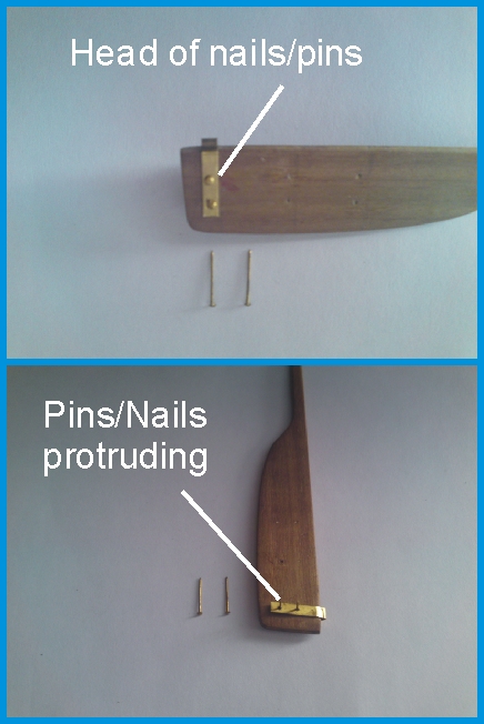

I am busy with a 1:85 Scale of the HMS Pandora by Constructo. The instruction manual and plans are some cryptic, especially the photos and pictures in the construction manual. I am having some problems with the rudder assembly ....
This might sound like (and probably is) a small issue and easily understood by experienced builders, which, of course I'm not. Pandora is my first attempt and so far, it's looking ok, with mistakes and all. I am enjoying the construction and have been working on her on and off for the 18 months, when time permits.
The rudder requires the use of nails/pins to secure the hinges on the rudder itself and the bottom rear section of the hull. What I cannot understand is how to fix and secure the pins/nails once inserted through the holes in the hinges. One side of the nail/pin has a head and the other side does not. How do you secure it and make both sides symmetrical? .... or is this assembly not symmetrical? Hope the words describe the question.
I have tried to attach an image (JPEG File) of the rudder, hinges and nails/pins but cannot find a method to do the attachment of the file. I have "ticked" the block that shows "Attach files to this post?". If the image does not appear with this post, please can somebody explain to me how to do this. Thank you. (PS ... I have also "clicked" the icon for "insert image")
Warmest regards.
Eugene

#2 Posted : 12 September 2010 16:22:31
Hi Eugene,
I usually use super glue/cyano to glue the hinge then snip the pin in half glue the pin into the hole and do the same on the other half of the rudder..
Hope that helps..
Chris.

Thanks Chris. Strangely enough, I was thinking of doing JUST THAT, but didn't think it would be an acceptable method!! Thanks for the confirmation and your speedy answer!! ... really appreciated.

In my opinion any method that gets the required result is acceptable.
In this situation I would use superglue to connect the pieces but then as Chris says, I would snip the heads of the nails and use them more as a detail part rather than a structual one.
Hope this helps

I agree with the rest, that is exactly what I did to fix the rudder on HMS Halifax which is another Constructo kit.
