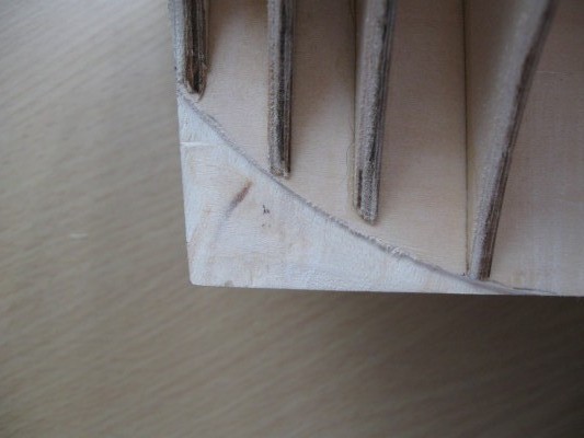

Tomick, I'd like to pick your brains please mate. In your build instructions where you had prepared the hull for planking...The section of the keel below the transom (the triangular section) ...I saw your picture of where you faired it, but can not quite make out what parts are reduced to 2mm? Hope you can help ,me here mate...much obliged...

Yeah, Id like an answer to that as well.
Not sure how it looks, maybe a side elevation photo and an angled one will answer it.
I cant make it out in the photo.

Hi Jonny7,
Steps 6/7 of issue 20 notes the thinning in an arc shape of the bottom of the false keel at the Stern.
Basically the false keel as it stands is 4mm thick, the task is to reduce ist thickness at the stern in an arc shape to 2mm thick which spans the bottom of frames 27-31.
In effect you end up with a 1mm thick arc shaped ledge on either side of the false keel at the stern, where the bottom of frames 27-31 are also smoothed to meet with the ledge of the arc, any adjustment can be made later on.
The arc thinning can be done using the corner of a sanding block, mark the arc and sand to line, just ensure that the sanding is done equally on both sides of the false keel (only removing 1mm from each side) and that the thickness of the arc ends up being 2mm thick.

Thanks very much Tomick for your very timely reply mate, I fully understand the process now...cheers mate..ThumpUp

Hi Guys I'm finished with the transom now and working on the narrowing the
back end of the keel where it suppose to get 2mm thick,question does the
2mm thickness curve has to be perfect I've got the curve correct but I'm having a hard time trying to get the 2mm thickness evenly I'm getting different thicknesses in different places, any suggestions thank you

Hi Ronald, narrowing the keel at the stern in an important part of the build. The keel has to be narrowed evenly from both sides until it is 2mm thick throughout the curved section. It is a time consuming process and one you should do with care. I used a wide rough file to start with to remove the bulk of the material, changing to a fine file and finally fine sandpaper, constantly checking the overall thickness as I went. When narrowing the keel it is also important you don't chamfer the stern edge. Care during the fairing stage will pay dividends later in the build.
Post a couple of pics if you can to let us see how you're getting on with it...
