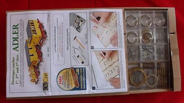

Have a look at the back of the coach instruction sheet and you can
see the 1st, 2nd and 3rd Class (Klasse) markings to see what I am
getting at.

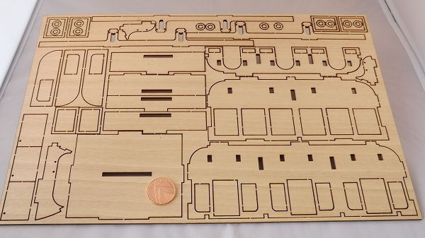

2. Another observation is that Occre show a parts guide with numbering
for all of the laser cut sheets but they fail to supply a breakdown
of the additional cast, wood and accessory parts that make up the
kit. I would recommend you follow the instructions and tick off each
part to ensure nothing is missing.

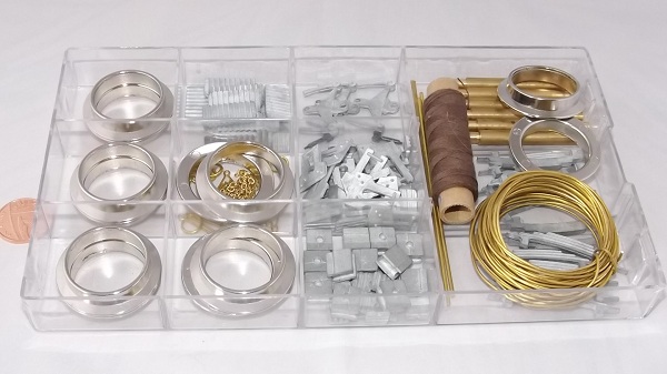

4. The box of castings and accessory parts that come with this kit weigh
in at 492 grams.

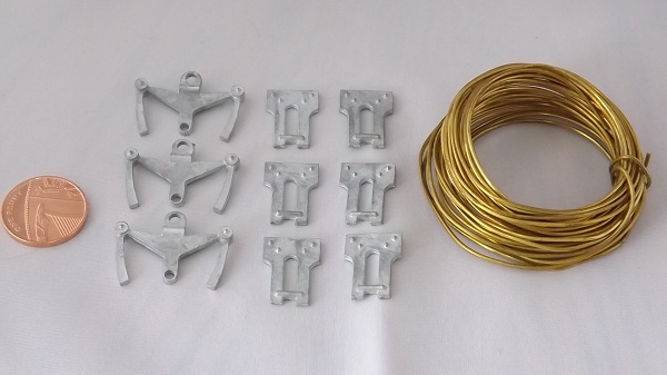

5. My main gripe with this kit is the metal cast square coach buffers.
Each and every one has been cast in a misaligned mould leaving some
major work to do. In addition the holes drilled for the Brass rod
buffer arms are way over size. Initial thoughts would be to remake
these using various thicknesses of wood or plastic strip. My
measurements are 9x9mm with the centre being 7x7 mm. should be simple
enough to replicate as it’s basically a 3 part “sandwich”.

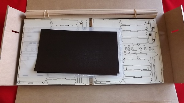

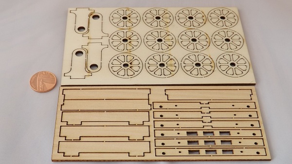

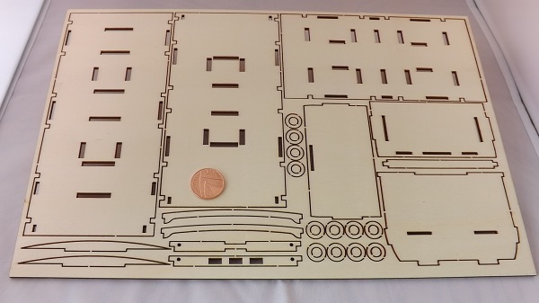

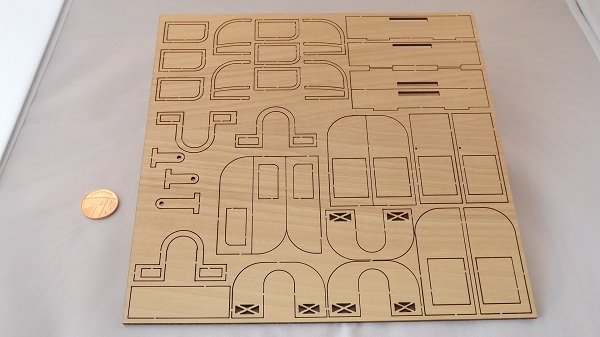

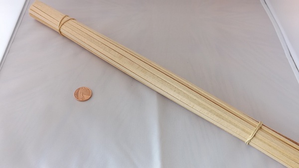

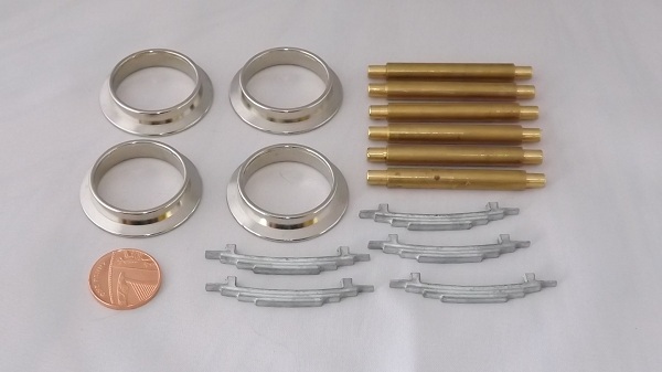

SO WHAT DO YOU GET IN THE BOX?
