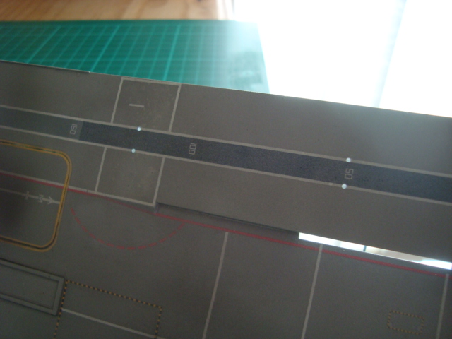

I drilled the 1mm holes for the fibres right next to the molded lights in the flight deck plastic,this ensure they were placed accurately
- the raised lights were then sanded off along with the whole deck to give a rougher texture before priming.
I needed to paint, decal and weather the deck first as I won't be able to do any of that with the fibres fitted, and I can't fit the deck to the hull until the fibres are in place, this is what I meant by having to change the order of the build.
Here is the deck with a coat of light grey, with a slight tinge of brown mixed in to give a more toned down look
After a coat of pledge is sprayed on I started the immense job of the decals. There are around 60 on the deck and some are 1mm white lines which were very tricky to get lined up. I used decal fix for these as I really didnt want these coming off again.
I left the decals overnight after a couple of layers of matt cote to seal them in. During that time I put together the few parts that made up the hanger deck.
Next job was to overspray the decals with a filter of the deck colour, a couple of very thin coats did the trick and it does look more like the box art now with the markings faded out.
Should point out that all I need to do now is "poke out" the the drilled holes to clear the paint / decals etc

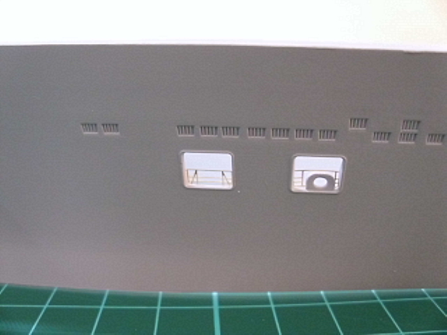

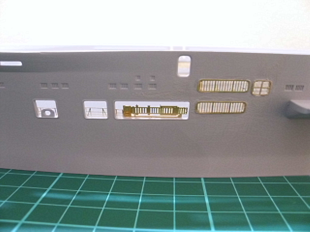

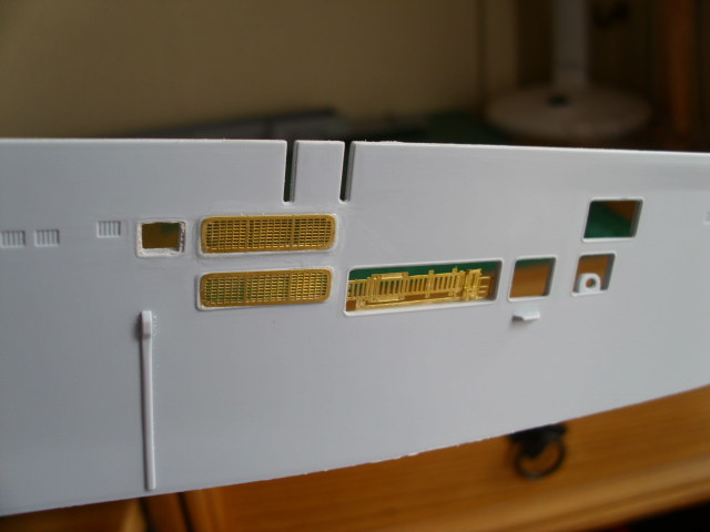

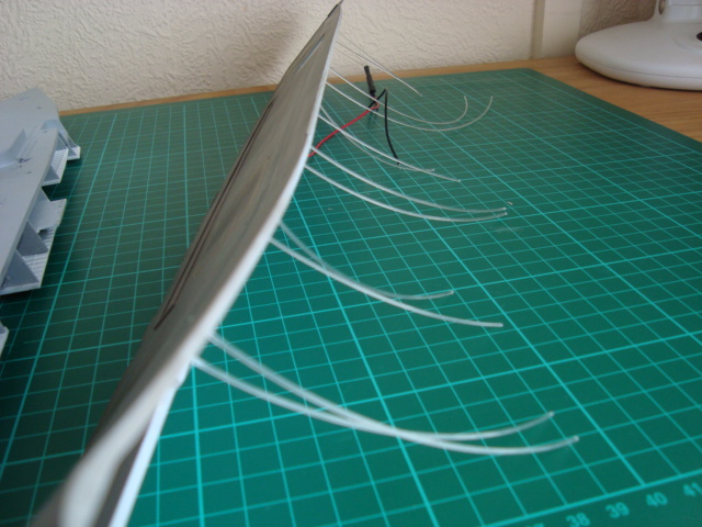

I have fitted all the fibres to the deck light holes so this can be put aside for a while. Next is to concentrate on the hull as I really want to get the halves together so I can fit the deck and sort the led routing out.

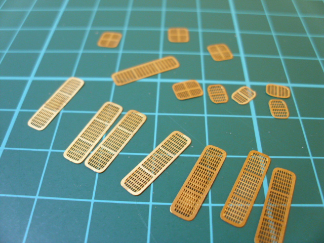

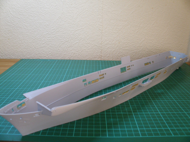

I'm fitting all the weather deck etch at this stage so I can prime and paint the hull in one go.

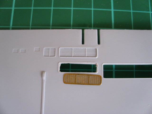

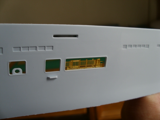

I had to cut out 15 holes to remove the plastic ventilation grills and replace with the etch. Although these are very slightly recessed on the real thing the instructions say to fit these flat to the outside. The inside of the grill is to be backed with white plastic card but I will fit this after painting.

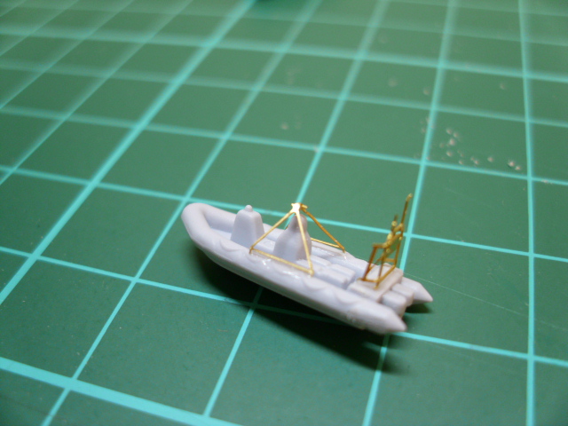

Also fitted the stowed entry walkways and some of the Atlantic boat details.
Here's the best of the pics on my useless camera.

Loving the detail on rib boat Cool

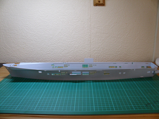

I have gone against the instructions again as they want the hull halves to be built around the hanger deck, I noticed that there was nothing stopping the hanger deck being dropped into the assembled hull haves last. The real benefit of this is that I was able to do all the etch railings and grills on the hull and I can spray this as one assembly with absolutely no masking required.
The pics below show the size of the hull, that an A2 cutting mat not an A3BigGrin so it's 2 ft long.
Next will be getting the main hull filled, primed and sprayed before getting the hanger deck in there and then the leds can be sorted out.

What size is that cutting mat, to give us an idea of how big that beauty is?

Great work Steve, thats some seriously clean PE work ThumpUp

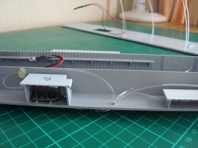

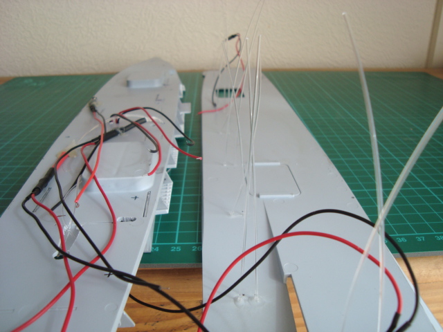

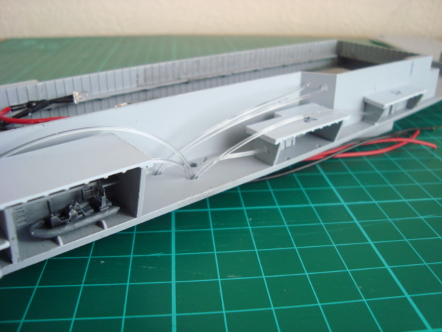

While I'm waiting for my new paint to arrive for the main hull colour I decided to do some fibre and led work.
All the fibres are in place now and I have also fitted some through to the boat decks / weather deck bulkheads for what I think will be very subtle lighting. Im going to fit amber and warm white leds to these.
The runway lights in pairs are going to be bright white and a row of reds at each end. The lights in the last pic are just to give an idea of what im trying to do, that's just sunlight in the fibres there but it shows how it will look in the end

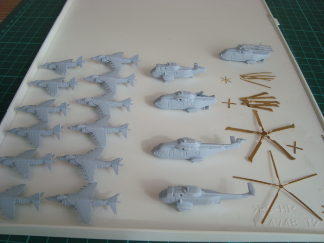

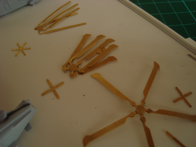

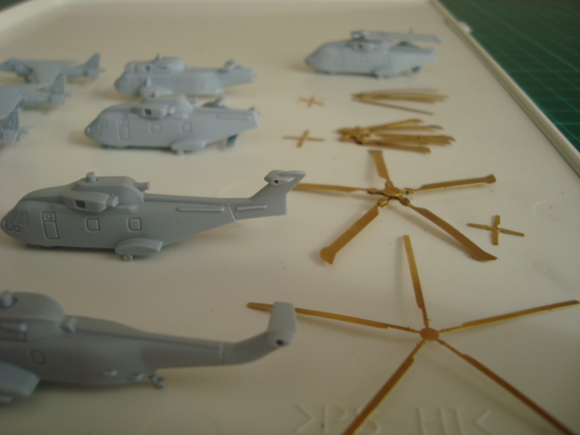

The final pics show all the aircraft that will appear on this model, 12 harriers - one taking off, one on the lift and 10 at the stern. 2 merlins and 2 sea kings on deck and one in the hanger (the hanger one is the one with the kit plastic rotors).
