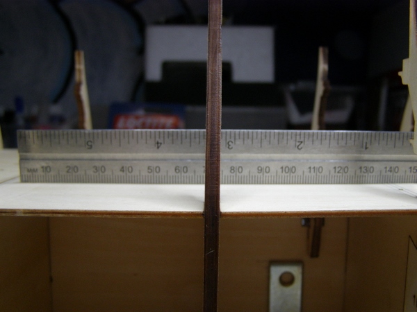

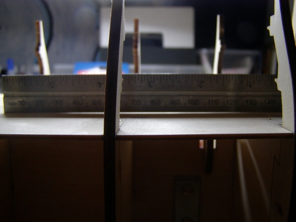

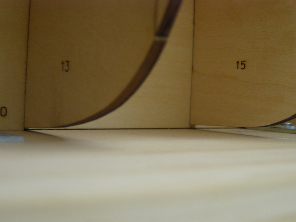

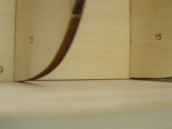

G'day folks. I have an enquiry associated with the lower deck and whether it should be level (flat) in the vertical plain when viewed from the side? I have just commenced with the laying and pinning of the lower deck (Issues #11 & #12). Up to this point I had not glued the ribs to the keel (they were dry fit until the deck was laid).
I commenced the laying of the lower deck sections (Items #31 & #32) without any problem and the ribs are square. When viewing my handy work from side on I realised that the lower deck was undulating in height. The worst parts at this stage are at frames #13 & #15. These frames are pushed as far as they will go into the keel slots. However, frame #15 is lower than the apparent even level by about 2mm. I can correct this by moving frame #15 upwards. Even though this will create a corresponding 2mm offset in position from the keel, I would consider that this can be remedied by gluing a planking strip to the bottom part of the rib and even it out when it comes to faring all of the ribs prior to laying the first planks.
So, essentially my enquiry is, should the lower deck sections #31 & #32 be completely level (flat) along frames #5 to #21. Acknowledge that the lower deck section #33 increases in elevation from frame #21 to #26. Once I have this resolved I can complete the laying of the lower deck then begin to align the rib frames with wooden blocks (as per Issue #9).
Pictures of the problem at hand are provided to aid in this problem.
Your assistance and guidance with this enquiry is greatfully appreciated. (or please point me to a corresponding / related post)
Adam

There is a natural gentle bow when 1st deck fitted. It slopes down very slightly from the bow to around 15 then fairly level and up again slightly from about 20/21. The decking is not meant to be dead level. BigGrin
When the second deck comes it too raises considerably more at the stern than the 1st decking and slightly to the bow.BigGrin
If you ensure all your rib frame bottoms are dead level with the false keel bottom they should be in correct position and you get that gentle bow over the full length.BigGrin
Someone more experienced than me will probably confirm what I'm saying. BigGrin
Hope that is of some help to you. BigGrin

For each of the lower deck sections from fwd to aft:
Frame 5 to 13 slopes downward (-0.7 degrees)
Frame 13 to 21 slopes upwards (+0.4 degrees)
Frame 21 to 26 slopes upwards (+2.4 degrees)
The frames 13 to 21 I readjusted so that the deck was flat. I still had to raise frame 15 by about 2mm to achieve this. All rib frames are pushed as far to the base of the keel as they can go. I don't really want to pull the thing apart in order to make a keyway slot deeper unless absolutely necessary).
I'm just not too sure whether the amount of slope required is within allowable limits (or I am looking into this too much Confused).

hi, there is a bow in the decks,provided you ensured that all the ribs slotted into the false keel all the way down you will have the right curvature in the deck.BigGrin
#5 Posted : 04 June 2014 00:14:17
Hi Adam, from what I can see I don't think you have any problems.... As long as you have ensured the ribs are fully seated then everything will be fine..... Cool Cool .. Carry on as you are, you are doing a great job..... Cool

Hi Adam. BigGrin
I'm glad more experienced builders came in to reply to your questions and with relief confirmed what I told you. Cool
The problems would have compounded if you had raised 15 by say 2mm, you would find that your planking later would be in by 2 mm on bottom as a depression following the ribs. The sides of rib would be out of line re shape and when you came to put beam for second deck on that rib it would be up in the air 2 mm higher than those next to it. So the less of the evil is to have the slightly bowed deck. I know it is slightly confusing as I too wondered at that point in time if I was going down the right track with having a gentle bow. BigGrin
