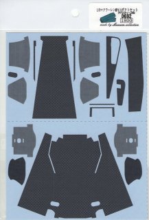

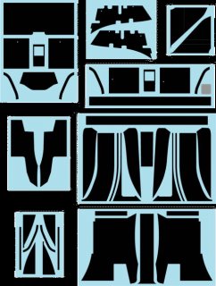

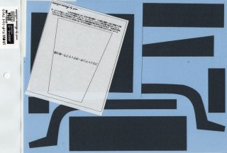

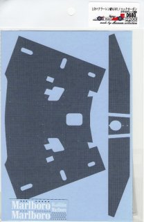

In order to advance my McLaren i purchased the MuseumCollection Decals and now i have several problems.
The first thing is, that there comes nearly no translation of the japanese assembly guide with the decals - so for many of them i have no idea where to apply them. So i`m hoping, there are other builders in this forum with more knowledge, who will also apply these decals so that i can learn from their build diaries.
Second:

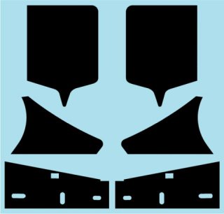

A part of the decals are hairlines for the insides of the front and rear wing sideplates.
Yesterday i disassembled my front wing to be able to apply the decals.
But in my opinion there is not very much of an effect visible:
I´ve no experiance with decals,so maybe i did something wrong?
First step I put Micro Set on the wing and after some watering of the decal i applied it on the part. Again i put Micro Set on the decal and let it dry. Last step was applying a coat of satin-matt varnish.
Is this the right procedure? Or maybe do i have to prepare the part i want to put the decal on in some way - paint it in some other colour maybe to make the effect of the decal stand out a bit more?
I´m asking because with the monocoque decals it says in one of the rare translations to first paint the part silver and then apply a coat of clear smoke-yellow varnish (no idea, what that should be!) - befor applying the decals. So i thought maybe one has to follow this procedure with the other parts too?
I know, this is a long post and many questions - but maybe someone can provide a little help!!
Thank you very much

The reason that you can see the detail while the decal is on the backing paper is because it is exactly that what is showing through, when you apply certain decals you will have to give the area being covered a different colour backing so that the detail will show through. An example is the "tub" decals that need different shades so that each panel will reflect the carbon fibre being used.

DaDatoka I share your pain: I also have bought all the Museum Collection decals for this model, so far they are disappointing. I am satisfied with the end plate decals, as the real car's end plates do not show much pattern-I did not apply an overcoat because I was satisfied with the sheen and texture 'as is'. I attempted to cover the front brake ducts with the supplied decals , it was a mess! There are too many contours for the decals to follow causing massive wrinkles, bubbles and tears, even when using Micro Sol solutions for setting and and 'painting' to try to set them in place- it was also a 'fail' for the black turbo inlets-again too many contours. Also the turbo inlet decals have a silver background, which is incorrect.

@Spencer: As all the decals are delivered on a blueish backing paper - does this mean i have to paint the parts in that colour to get the effect right?
If not - how does one know which basic colour to apply before putting the decals on??
I´m really stuck here!!
I could go back to building without the decals - but they were pretty expensive!
