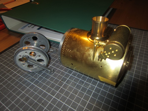

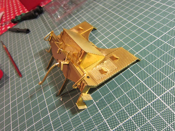

I received the first parts of this model on friday - and couldn`t resist starting right away.
This is my first experiance with epoxy-glue and i`m afraid i messed around a little bit!
Is there any good advise how to clean the metal and make it shine again?

A very nice start there I can understand you wanting to get going as you unpacked her as it just jumps right at you saying 'build me'Drool .
If you are intending to go for the brass finish I would recommend getting some cotton gloves to minimise the greasy fingers marking the metal, also the parts come in a coat of protective oil so any epoxy spills/marks should lift off when washed in soapy water I think if not use a very mild metal polish. Hope this helps and keep p the good work

Acetone is a good cleaner/solvent for epoxy. If your wife has nail polish remover that may also do the trick.

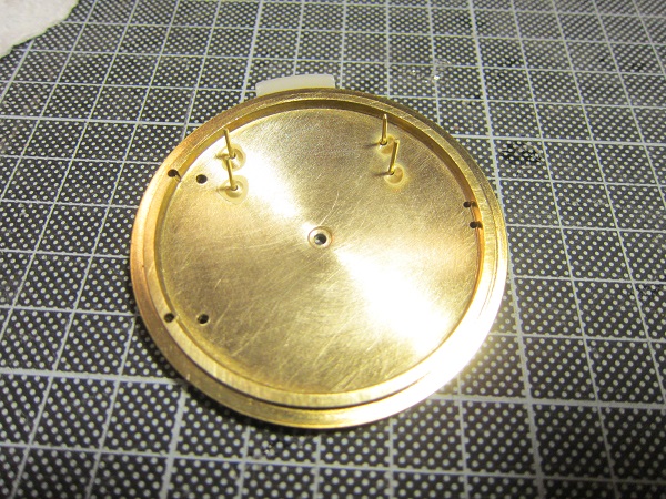

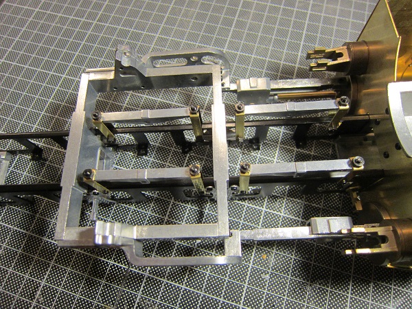

As i didn`t like my results of Pack 2 at all - with all the adheasive spill everywhere - i reordered Pack 2 and tried again.
I´m much more pleased with the results this time.

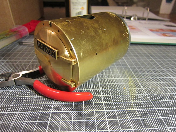

I still find it very hard to keep the brass clean! My idea was that the model would be easier to build if not painted - but i`m not so sure anymore.
Especially the super glue is hard to work with - it makes white shades on the brass, which i dont`t know how to remove!

if it looks wrong before it the super glue sets quickly wipe off with water

Super Glue is available in different thicknesses. I use the medium (JET brand) because the thin stuff runs everywhere. Find a good hobby shop that specializes in Radio Control planes, they should carry it.
Acetone should also dissolve super glue and help clean up. The hobby shop should carry a super glue cleaner/solvent.

Superglue 'fogging' comes from moisture in the air reacting with the fumes/vapors, also the more superglue you apply, the worse it can be, and especially so in confined spaces where there is litle ventilation.
You can use a hairdryer to "dry out" the air around the glue and you won't get the fog. Good ventilation+very little glue is key.
Superglue fog can often be removed on metal parts with careful use of a superglue de-bonder and a cotton bud.
