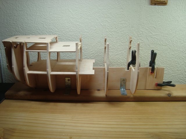

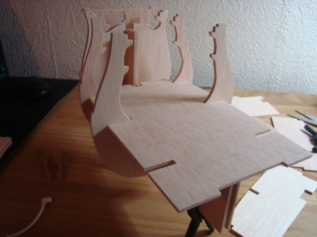

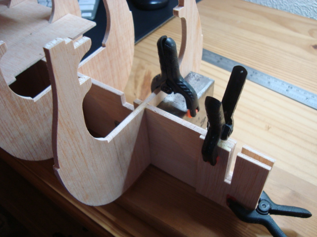

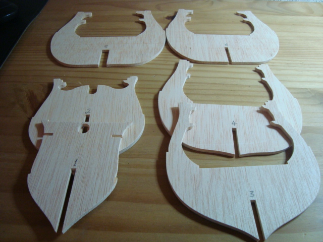

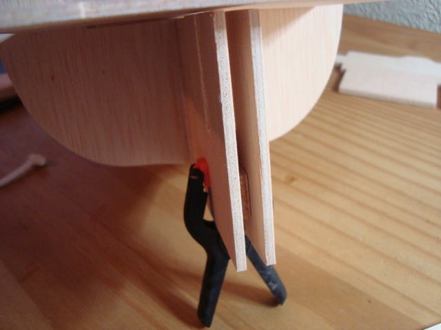

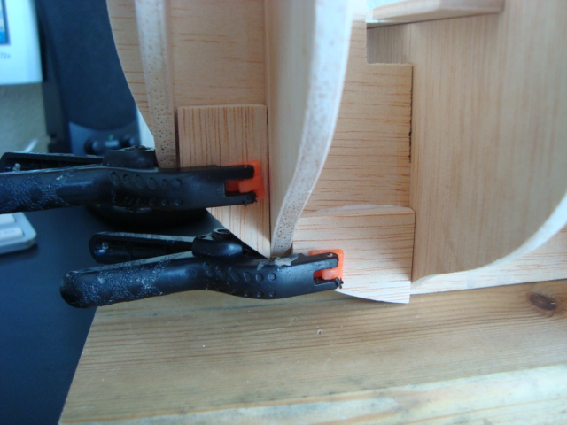

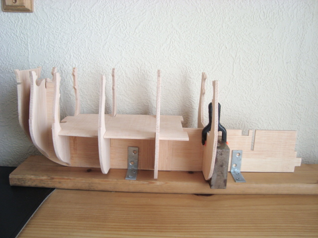

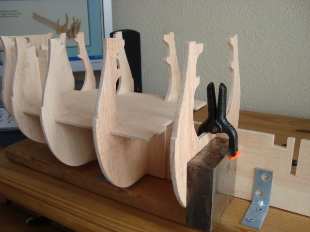

Just a couple of pics here of issue one, no need to dig out the old Victory build jig yet until I add the second piece of the false keel, and this won't be added until the joint reinforcement are dry.

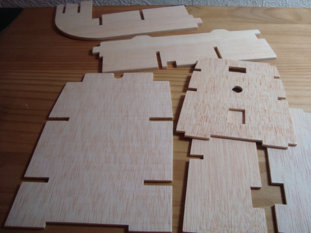

I only have the Victory to compare this with really so will be making comparisons / references to that build a fair bit but, the first thing noticeable was that the frames are cut much more roughly than the Vic's were and did need a fair bit of sanding to get all the splinters off and get a nice smooth finish.
Next it was just glueing in frames 1-4 and ensuring they were square, the deck is not glued in, just there to check things are level.
Not done much tonight but will push on tomorrow...now out to the garage to find my jigBigGrin

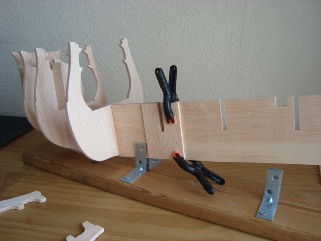

BigGrin Hi Steve
Excelent choice on your new build and it will be nice to see another build diary started. The false keel and all the rib formers are of light -ply but its the fitting of the ply decks that is important here as they are what square everything up, but im sure you know that already. The false keel also has two stubs that will get in the way when using a dry dock these are not really needed and are removed later I just cut them off from the start.

Fantastic, my first piece of good advice, hoping for lots more - I will chop off those lugs tomorrowBigGrin

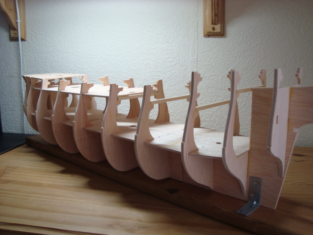

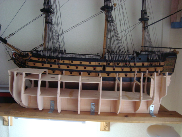

The lower deck is now nailed in place and supports are added for the upper deck. I am supposed to have the forward sections of the 2 upper decks in place by now but I have decided I want to wait till I have all the frames and false deck first before I carry on, this will allow me have better continuity in the deck planking rather than doing it in staggered stages.

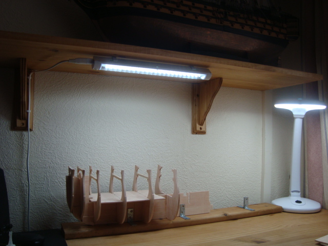

The other pics are my new light to go under my Vic shelf, it is a 65 led mains light and is very, very bright - I love itBigGrin It's really going to save my eyes for a few more years anywayLaugh

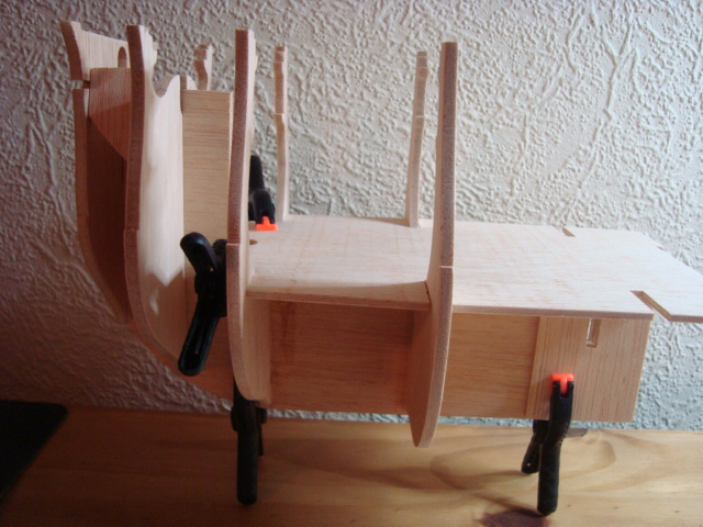

Well, good news - Pack 2 arrived yesterdayLaugh Bad news, it only took a couple of hours to do a months workCrying

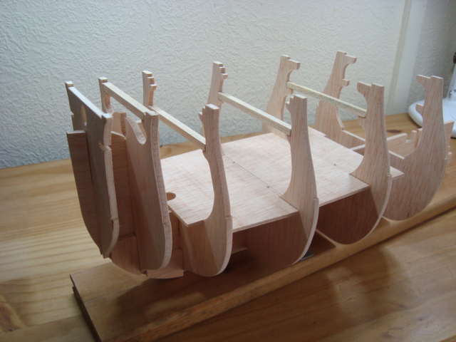

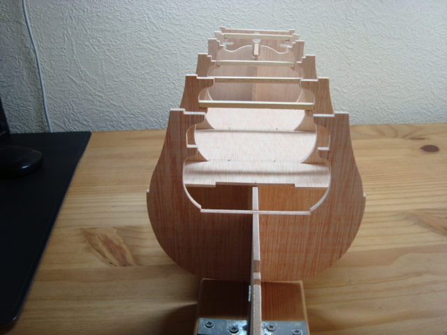

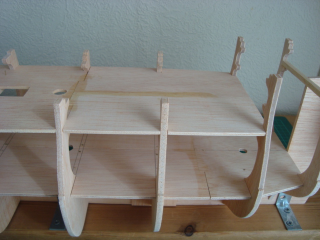

So, not much to report really, this is the state of play after 2 packs. I should have started the deck planking as well by now but I am leaving it until I get pack 3. The reason for this is that I want to plank the deck as one piece not add to it in bits each month, I have bought myself 40 metres of 4mm Tanganyka wood, hoping its going to be enough!BigGrin

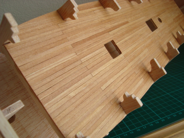

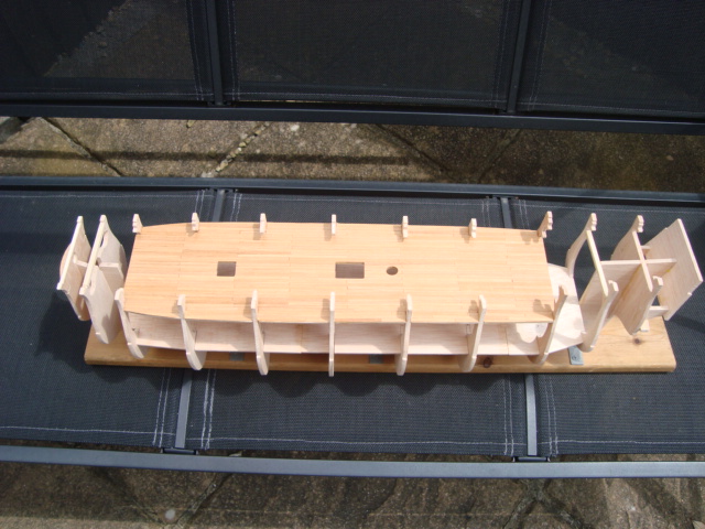

Had some more bits delivered for this so on we goBigGrin

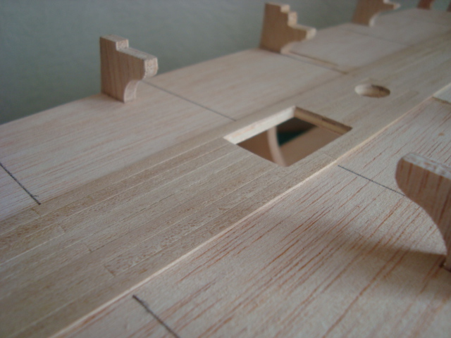

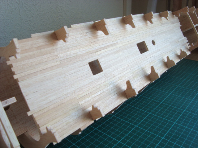

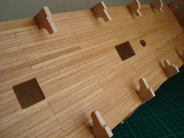

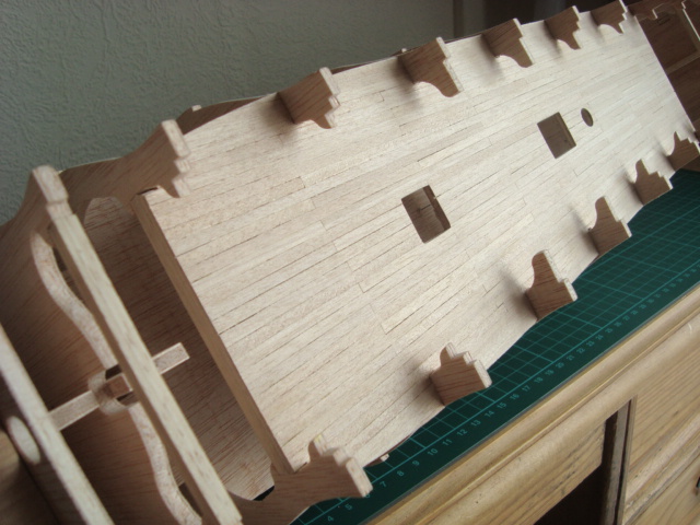

fitted the last 2 sections of the lower false deck and was then able to get the whole deck planked in one go. This is the first ship I have built where the deck is planked before the hull and it is much easier this way as you dont have to lay the deck against the inside bulwarks. This way the deck can overhang the false deck for easy sanding off later.

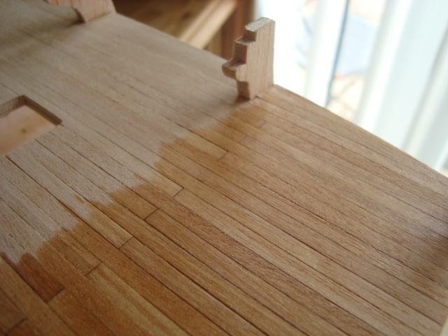

I replaced all the kit deck planks with 4mm wide Tanganyika at 1mm thickness. 3mm would have been more in scale but I went for a happy mediumBigGrin
The first pics are the deck before sanding, then after sanding then with the danish oil, not weathering this deck, may do a 25% mix of "weather it" on the top deck.
The pic with the oil being applied is basically to show that even without any added caulking effect the oil changes the colour of the gaps so much that there is a subtle effect of dark gaps or caulking between the planks. Not sure if Im going to do the nails on deck either.
Need to let this deck dry now then matt varnish it and then I can add the deck supports for the next level.
More soon,
