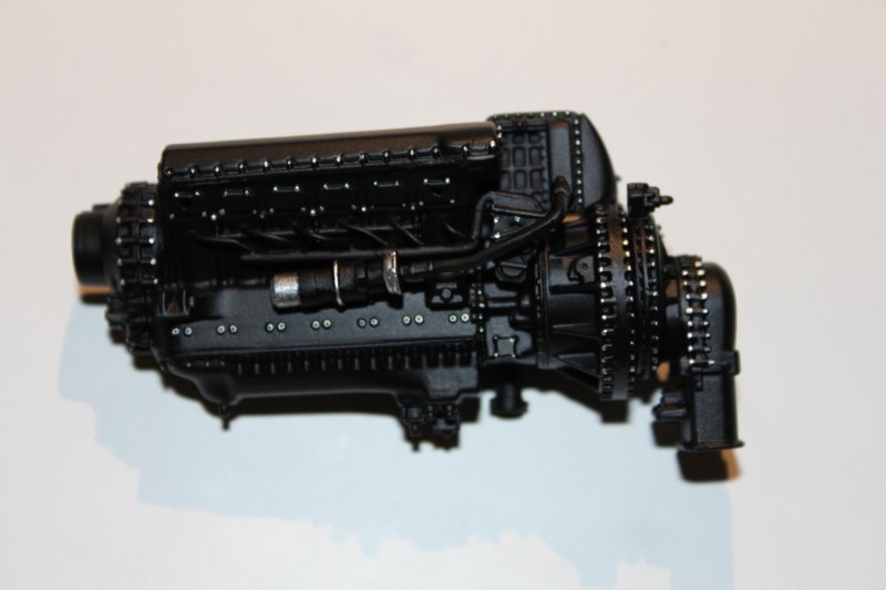

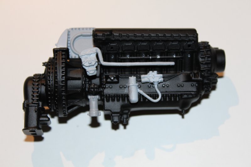

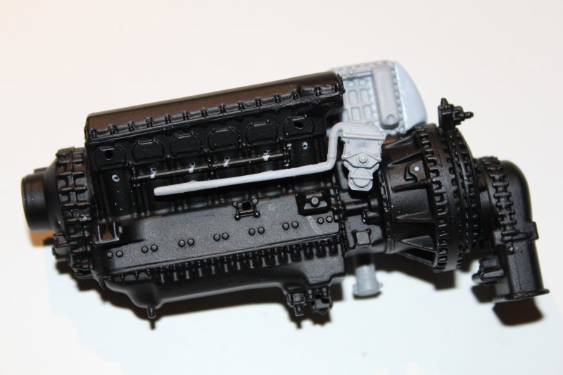

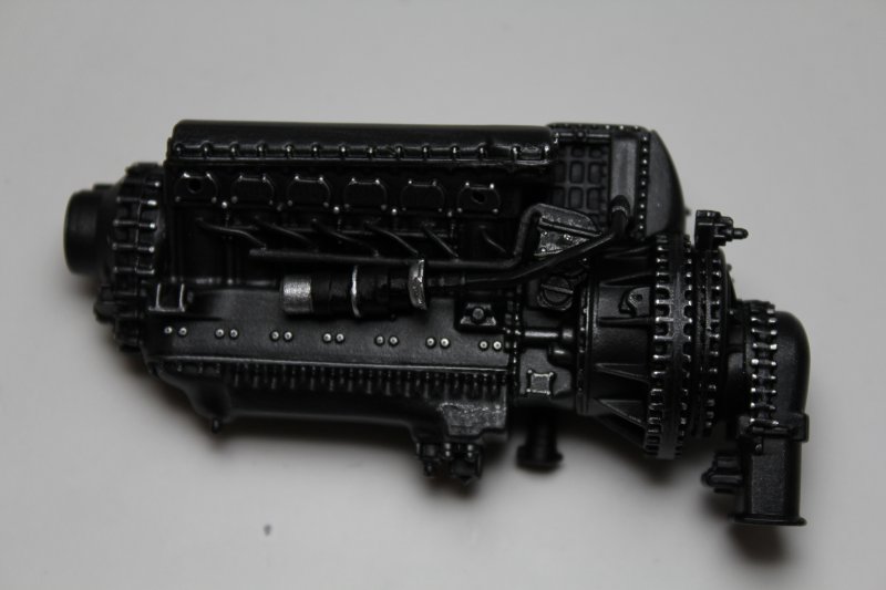

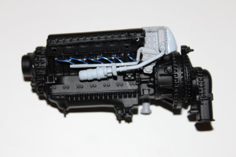

Assembly of the Merlin.

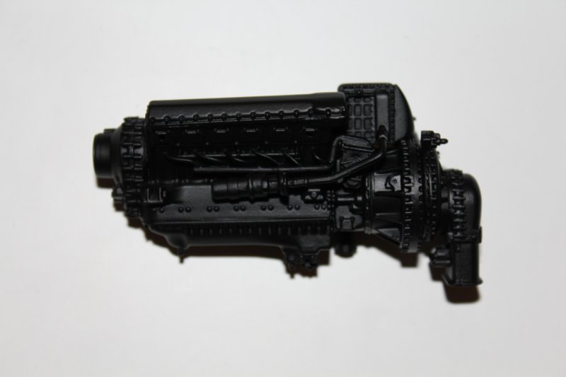

Very few parts but well deatailed for an old kit. The flash on the parts was removed (and a lot of it) and the main engine assemply put together and undercoated before small details added. A coat of Matt Black was then applied and small details pointed out with silver. A light weathering was than applied all over to "Lift" out some of the fine details.
#7 Posted : 03 April 2014 22:01:44
Excellent start on the merlin Spencer, looks great. I love a large scale plastic kit, so much can be done with them.
I remember watching a couple of progs on the "Red Tails" many years ago on Discovery, very interesting. There was also a 2012 movie on them but this was pretty poor though.
Good luck with it and watching with interestBigGrin

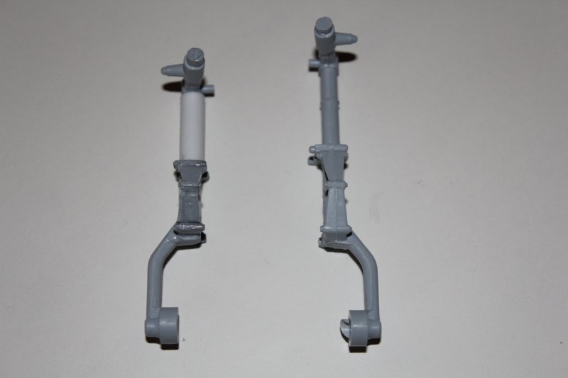

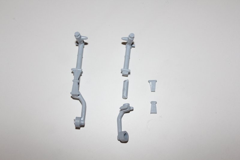

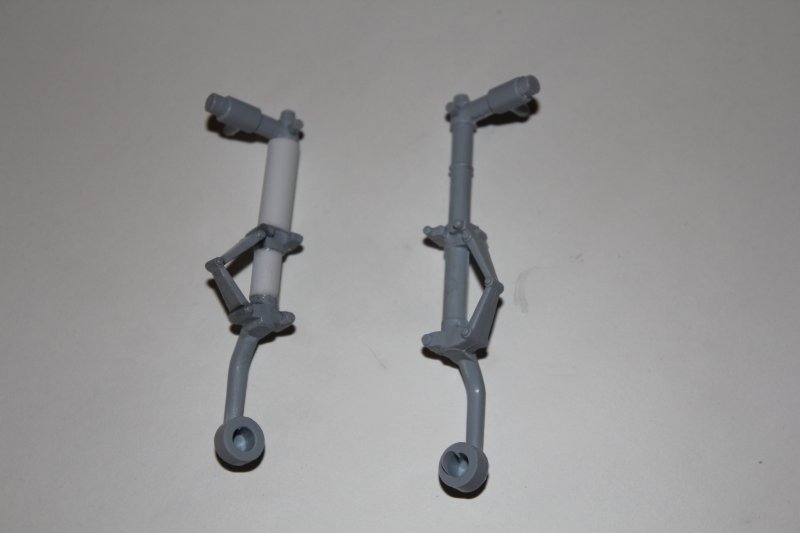

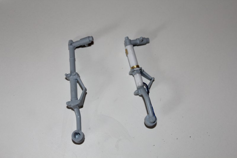

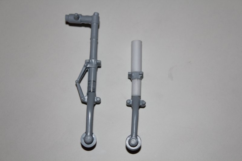

Thanks Steve and Trev for your comments BigGrin A lot of detail to go yet but this will be added once the Merlin is housed into position in the Fuselage. Todays update is to tackle the undercarriage as the parts provided are way too long for an aircraft sitting on the ground. At this point I decided to rather than go for the easy option and get aftermarket parts i would tackle the problem myself. So here are a few pictures of the process and hope you agree they will look much better once painted etc.
Spencer
#10 Posted : 06 April 2014 13:18:53
Somehow I have missed the start of this build!!! looks great the little details make all the difference and nice to see you correcting the undercarriage to allow for weightCool
looking forward to more

Thanks for looking in and you comment Jase BigGrin It's been a long time since I've tackled an aircraft and I've done a lot of research on the Airfix Kit to find out its missgivings etc. Theres a lot of work to do on it but it's also fun to correct and add to.

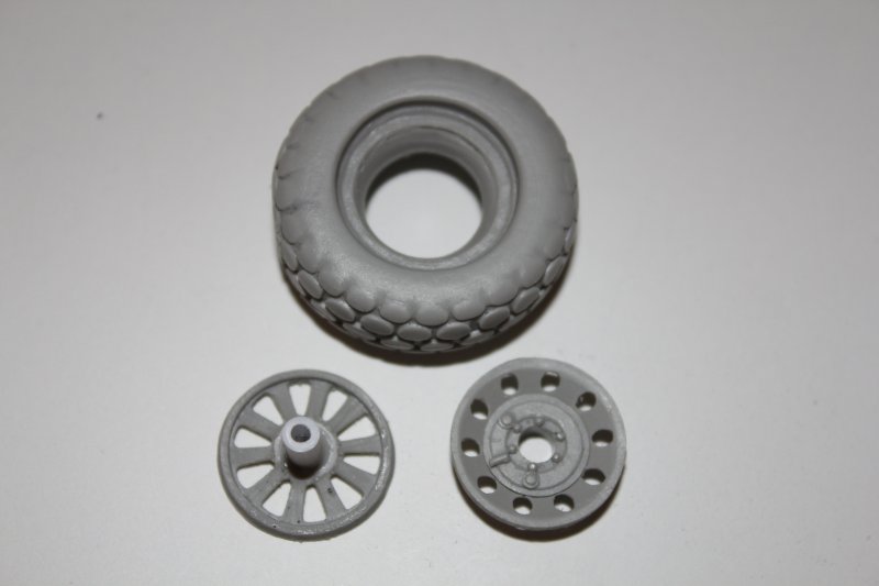

Many thanks for all your kind comments guy's BigGrin

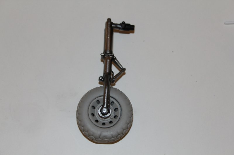

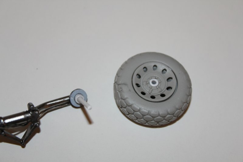

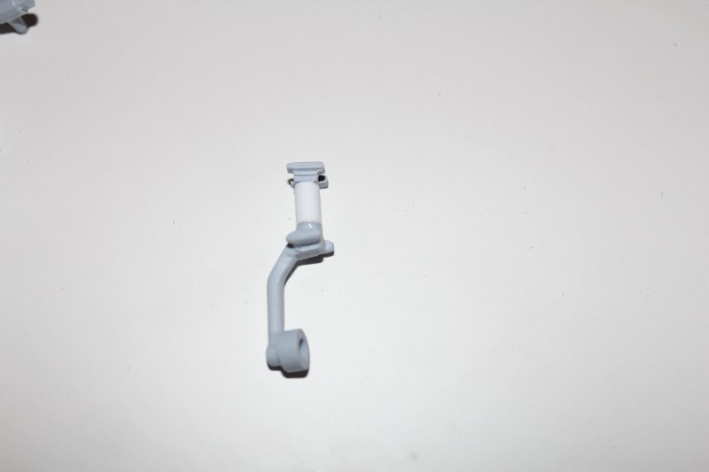

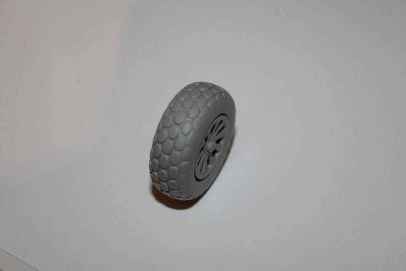

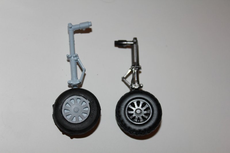

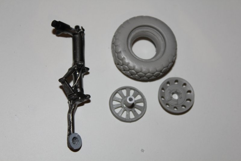

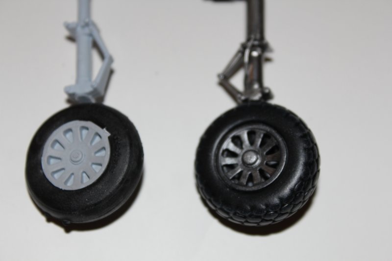

Another update as I work on the undercarriage and then on to the wheel wells etc. The Wheel/Tyre is of resin construction and to make it fit to the leg i had to insert some evergreen tube. The undercarriage was then modified to include the shaft so that the wheel could be put in place rather than just attatch with glue etc..
The last few pictures show the kit part for comparison.
More updates soon BigGrin
Spencer

#15 Posted : 13 April 2014 10:28:08
stevie_o wrote:
Love the resin wheels, very nice, what a difference from the kit parts.
Hi Steve and thanks again for looking in and your comment BigGrin The Kit parts are hideous Steve and something that needed to be corrected. The Kit provided tyres are also to thin for this scale and the resin ones make it all look so much better.
Spencer

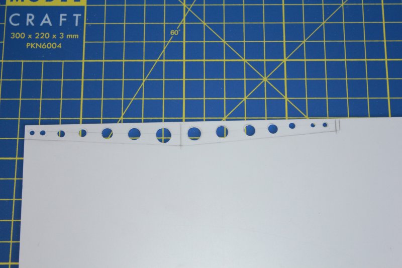

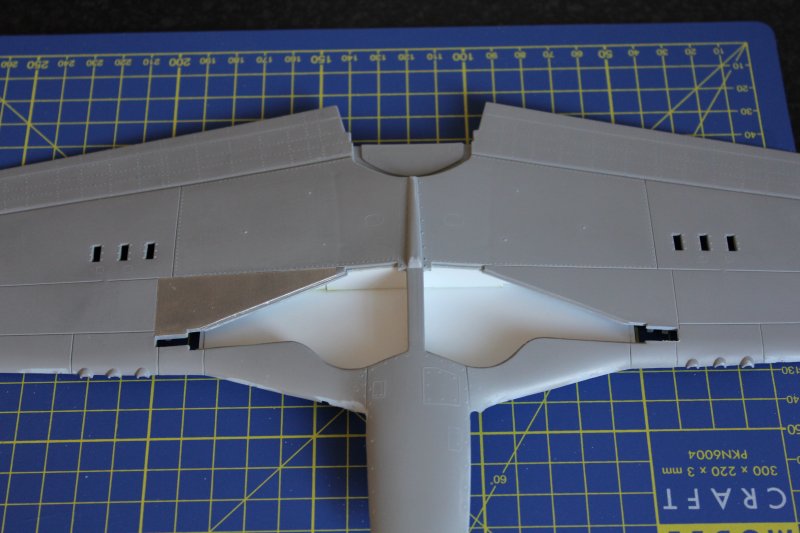

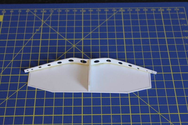

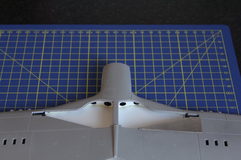

Time to start on the non existent wheel bays! Apart from the holes that the undercarriage goes into there is no detail what so ever so using 1mm plasticard I first outlined the area that needed attention. After a few measurements and re-measuring the main wheel well was in place. All that is needed now is some detailing with struts and cables etc.. More to follow soon BigGrin
Spencer

#18 Posted : 13 April 2014 19:50:34
BigGrin Great improvement with the additions SpencerCool
