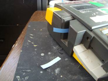

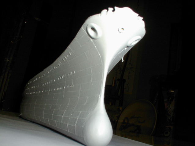

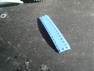

I used plastic tapes, since its surface is smoother than wood's planks.(No.1)
Metal (such as copper or aluminium) tapes would be applicable. 6mm width tape was cut in length 20mm.(No.2)

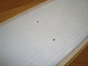

Heads of rivets were carved on the tapes' surfaces by using roulette, and I attached such tapes on the hull.(No.3,4)

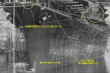

At this stage, my friend advised me that rivet's heads were not needed, and showed me a picture of the Akagi.(No.5)

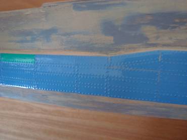

I only attached normal tapes. I posted several photos of my Akagi's hull. Smooth surface and narrow boundary lines are seen, (No.6-9)
Some people dare to carve the rivet's heads. I feel the power of mighty warships from such person's models.(No.10: This is a DeAGOSTINI Yamato that was built by the friends of mine)

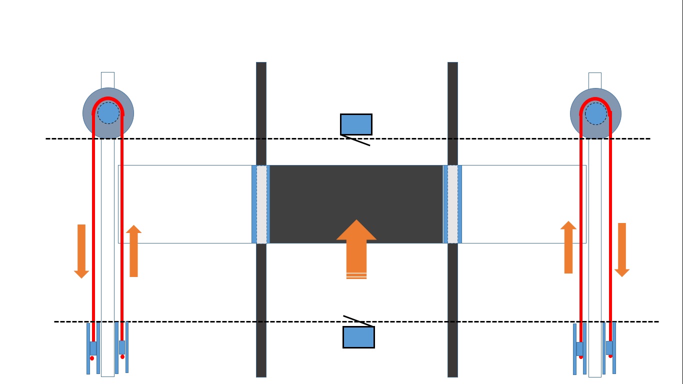

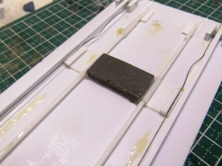

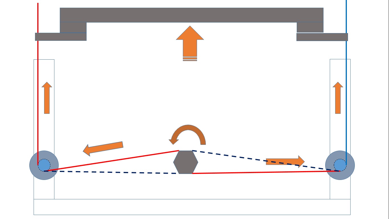

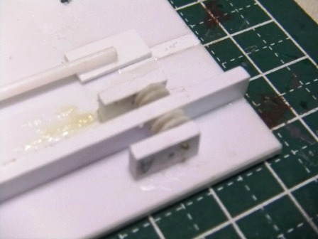

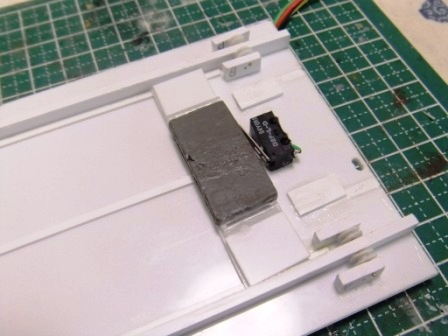

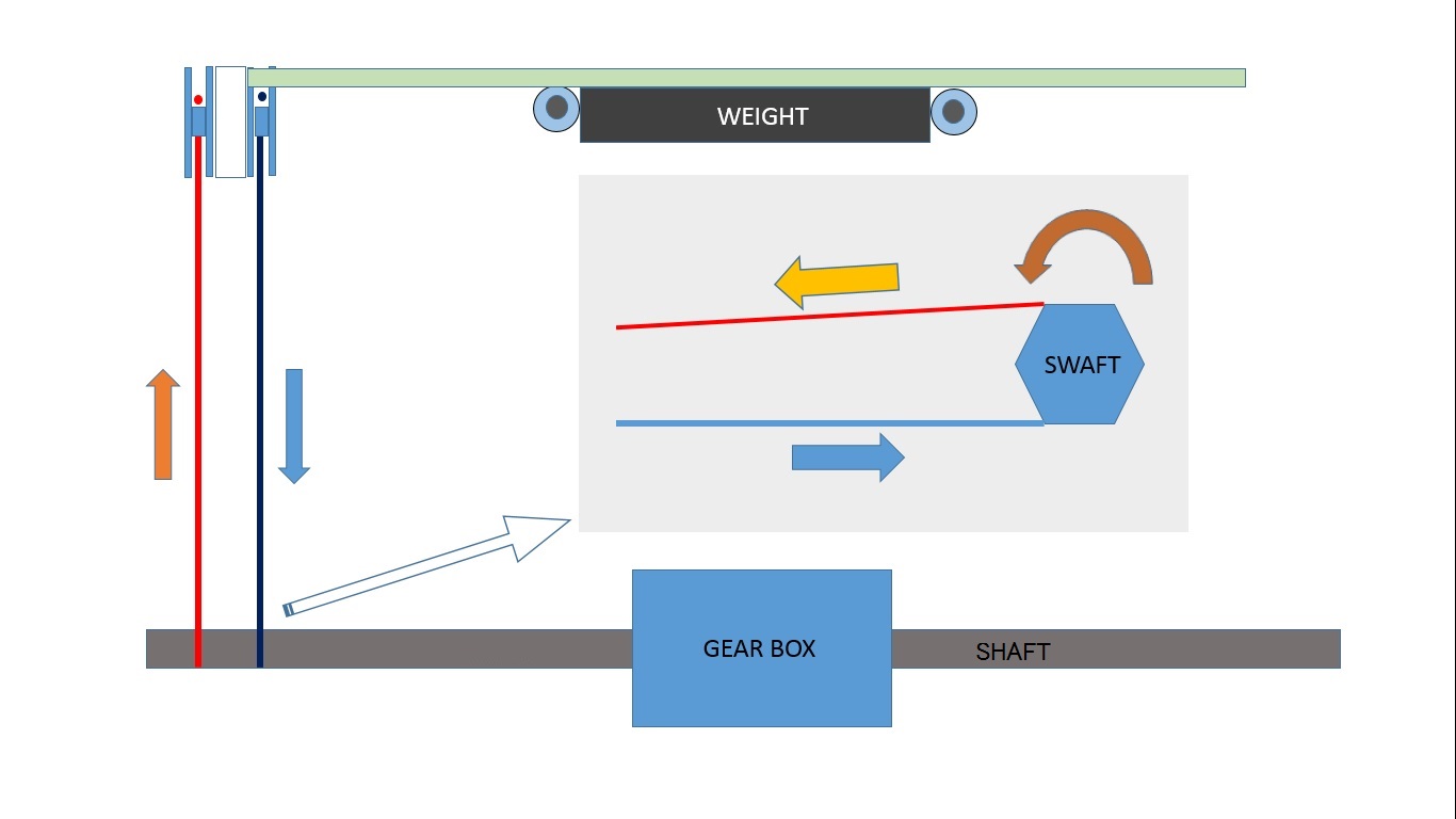

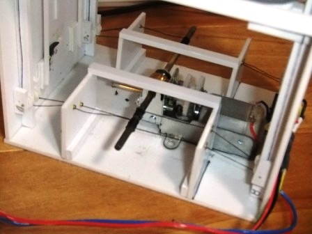

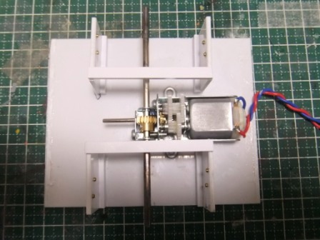

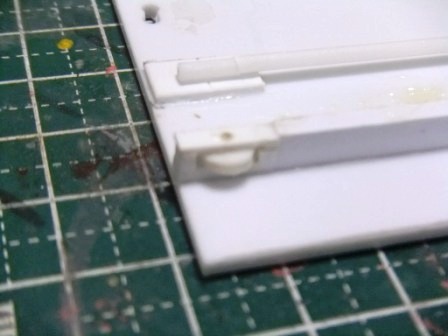

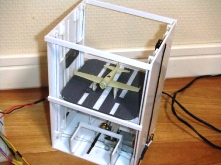

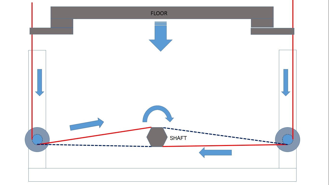

Hi Ted!
I attached some photos and schemes of my elevators.
A principle is to pull up or down simultaneously four strings that are fixed on 4 corners of the floor.
All the strings are fixed on the shaft through pulleys. The location of pulleys, strings and shaft is illustrated on the schemes attached.
Photos of real my elevator are also attached below.
Two weights which can be gone up and down smoothly are required, otherwise strings would become loose and errors also would arise.
Gesr and motor are commercial products. I used TAMIYA's gear box kit、"70103 UNIVERSAL GEARBOX".
http://www.tamiya.com/ja...cts/70103_universal.htm

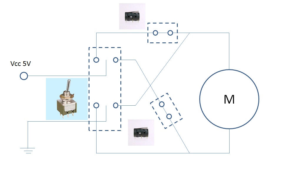

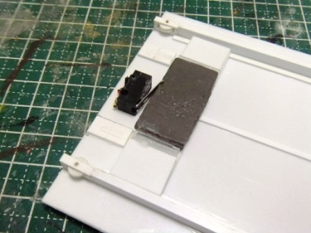

For the safety of the machine, sensor switches of upper and lower limits of the weight are installed.
If the weight touches the switch, electric supply for the motor is immediately cut.
A circuit for this elevator is indicated as the last attached picture.
