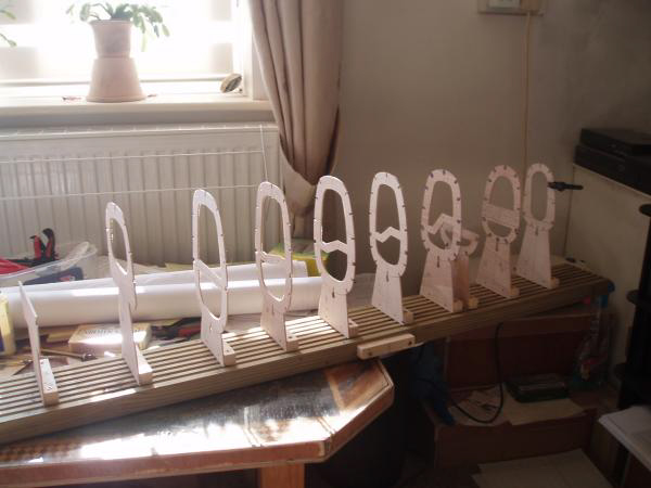

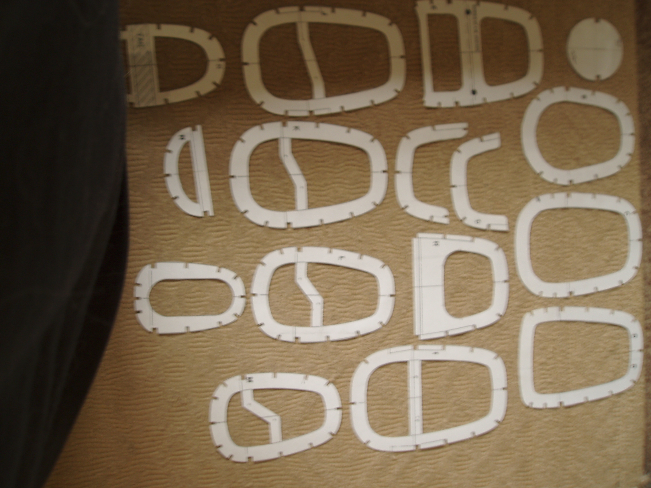

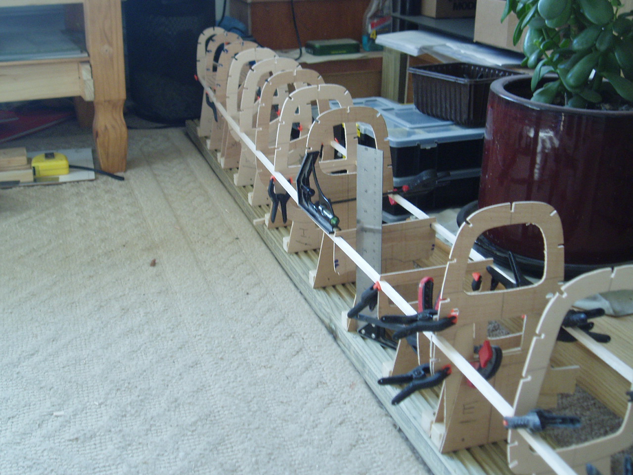

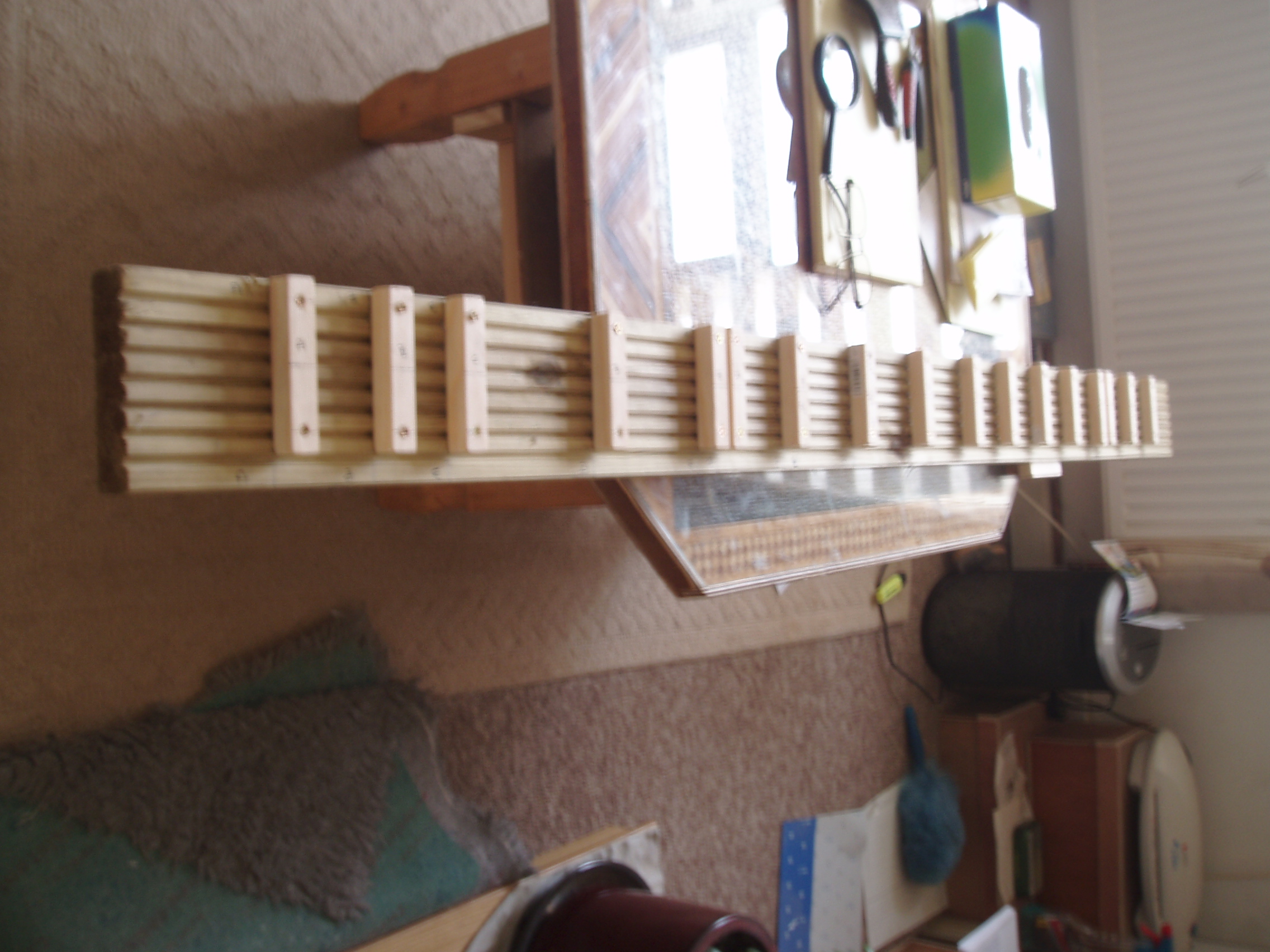

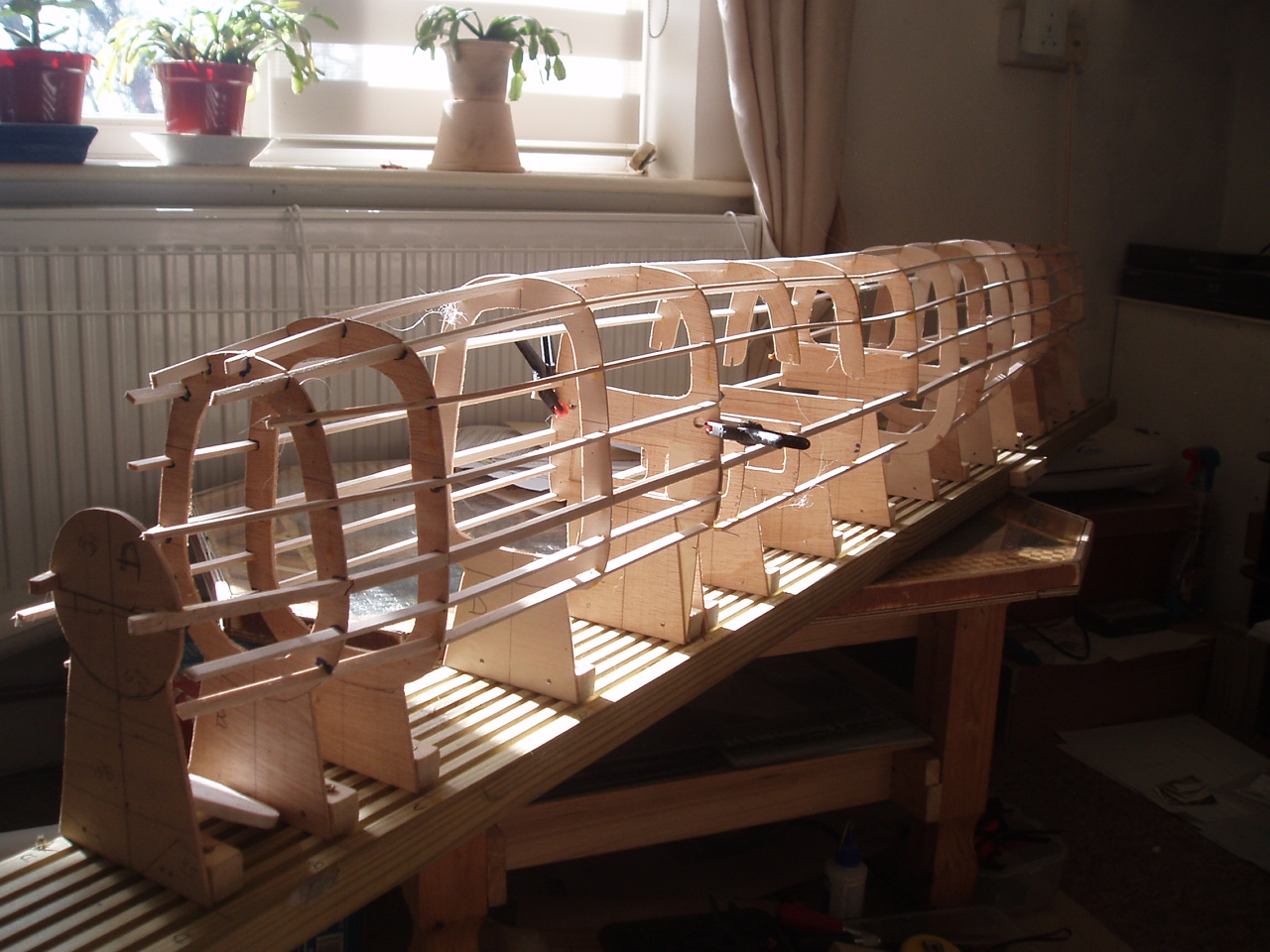

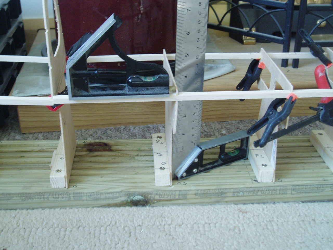

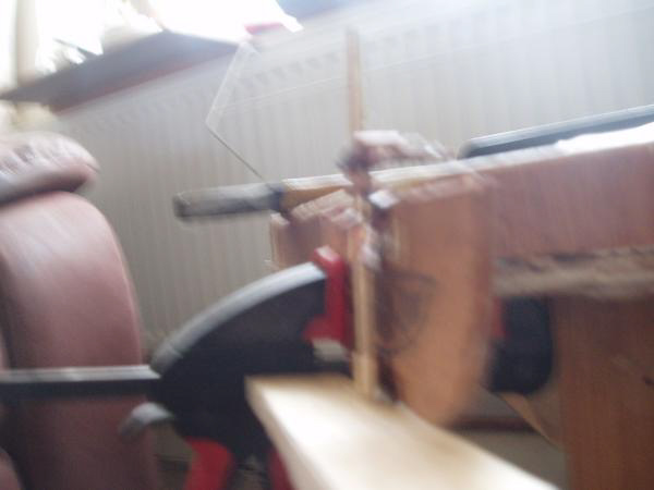

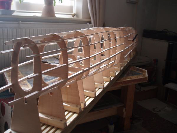

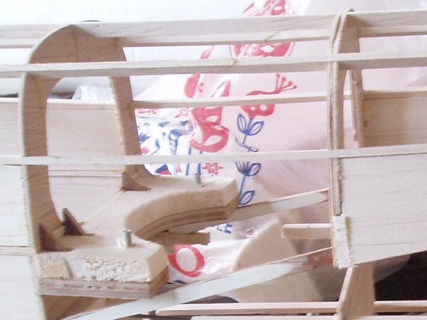

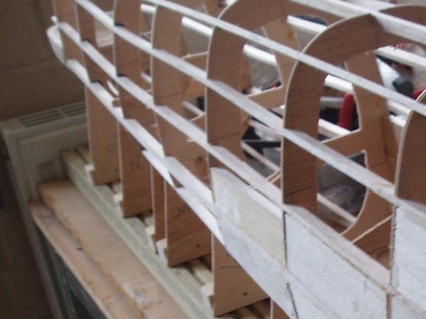

Well I've started with the easy bits first. I've just made the jig for the main body for the Lanc's which is just over 6' long.

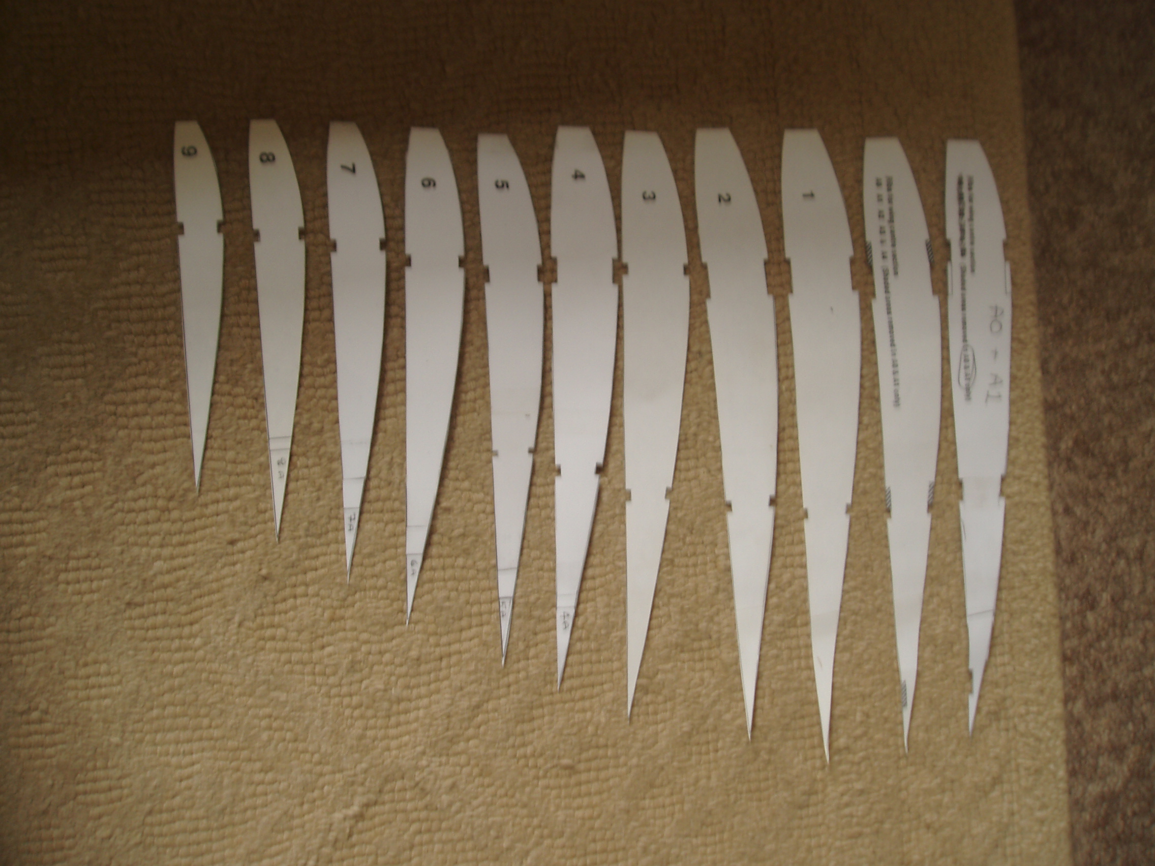

I've also stated to make the copy's of the main frame work to body and wing spars by photo copying the parts onto card and then laminate then before cutting out ready to draw around. Doing it this way makes them a lot firmer to draw around plus they can be wiped clean and used again if needed or given to anybody else that would like to try to build the Lancaster B1 when I've finished.

Hi all well as you can see thing are progressing with my Lancaster and its starting to look like a Zeppelin at the momentBigGrin there still alot to do as to the fuselage frame. but I have to wait until my local model shop get some more balsa wood in as I cleaned him out.
I'll get up dating as the build progresses.

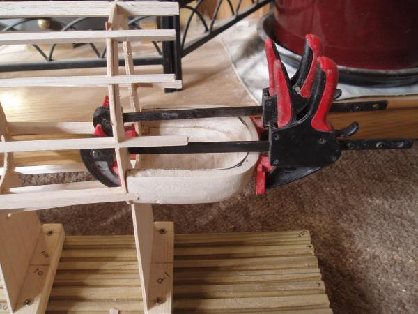

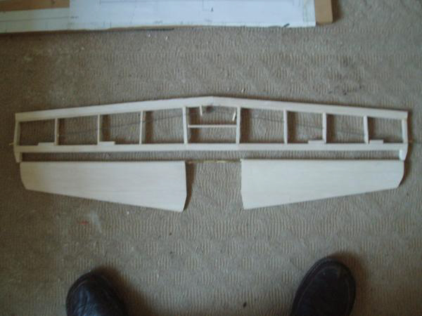

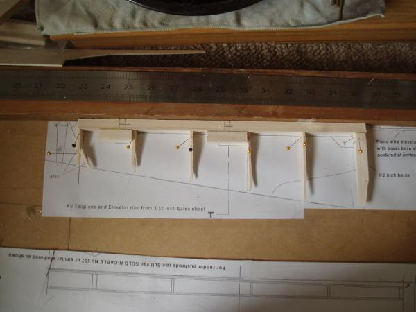

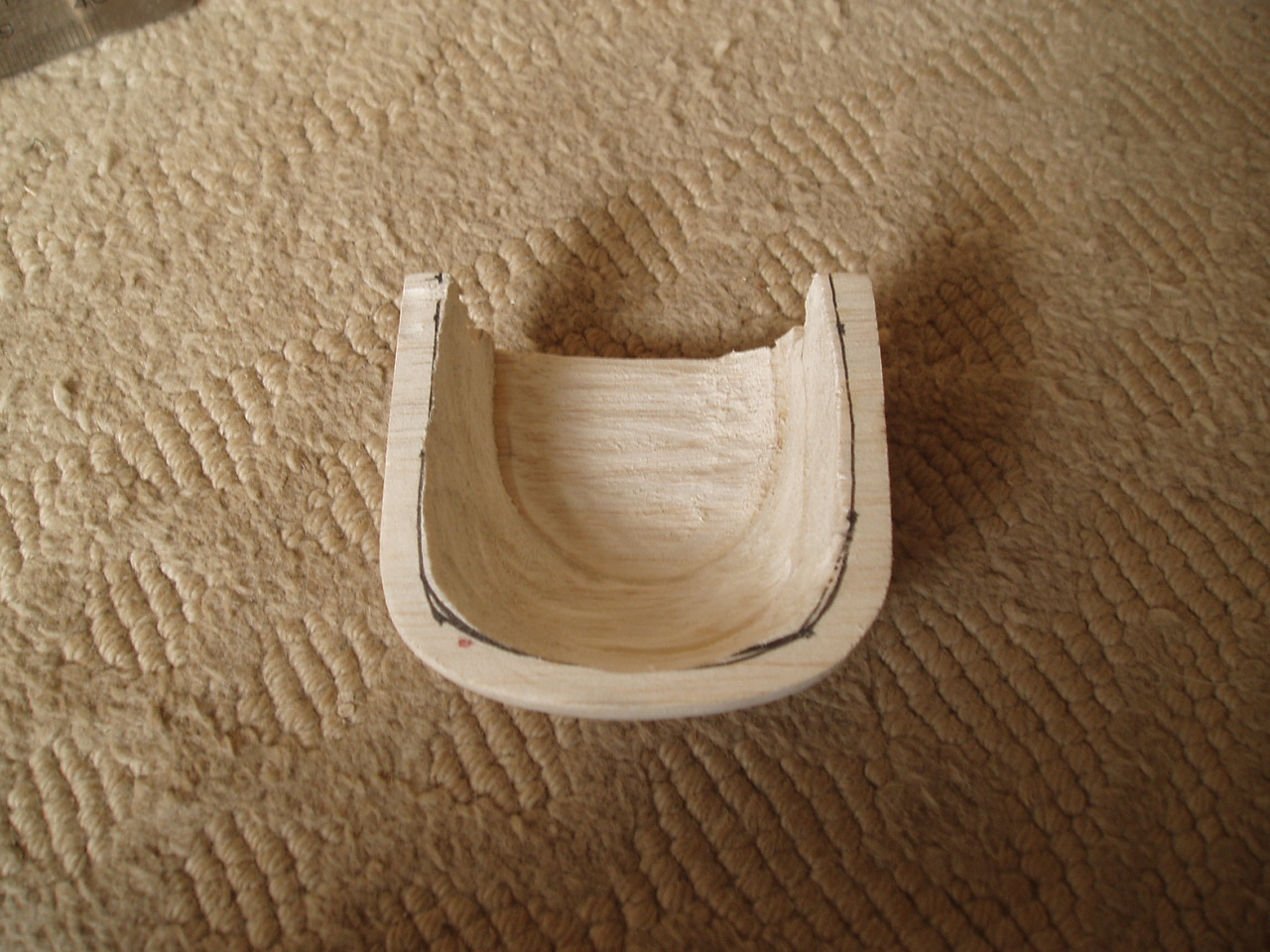

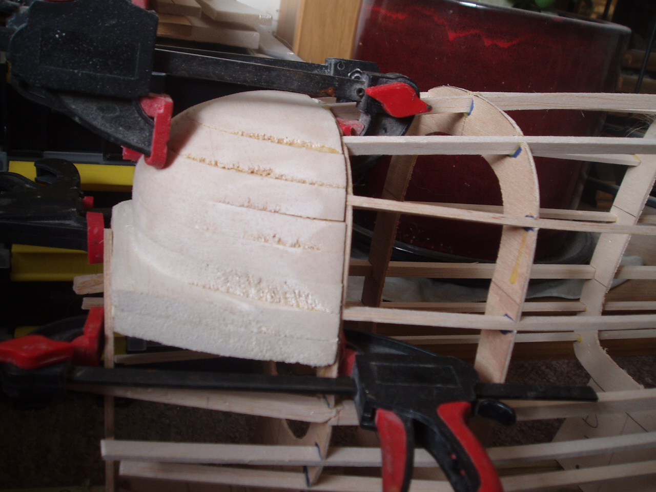

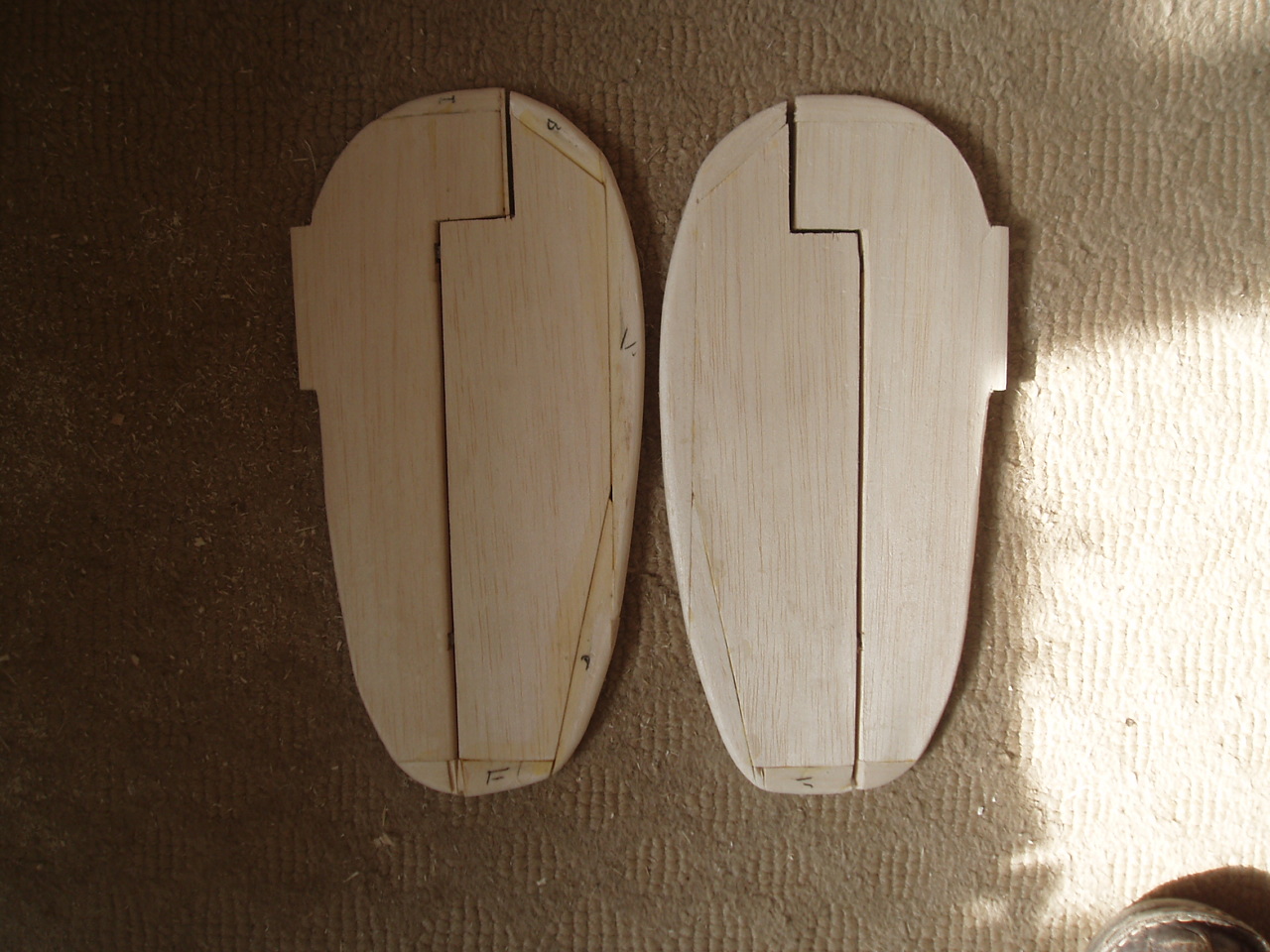

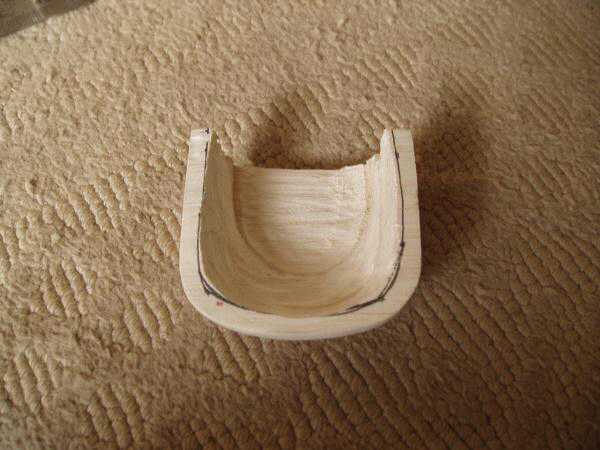

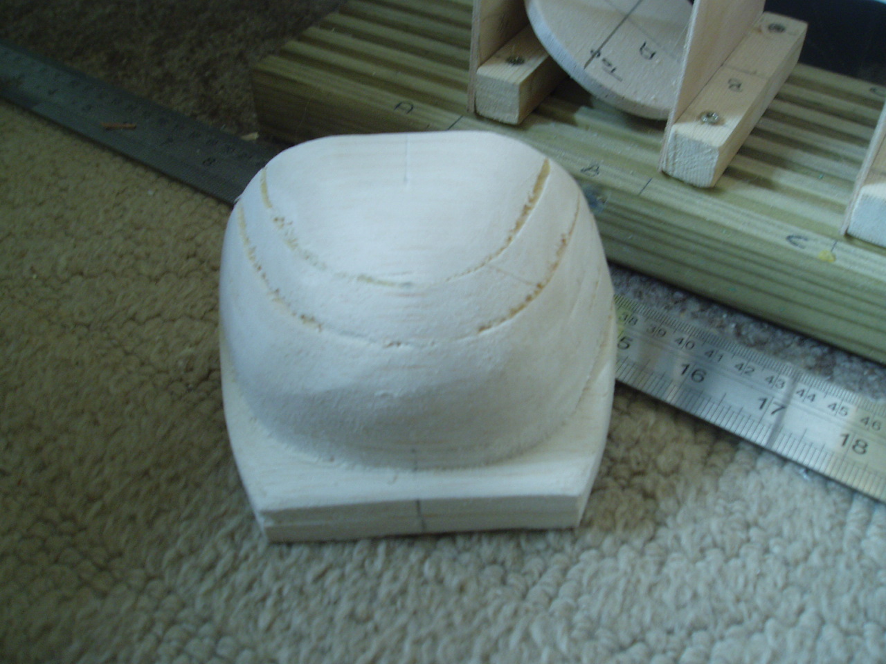

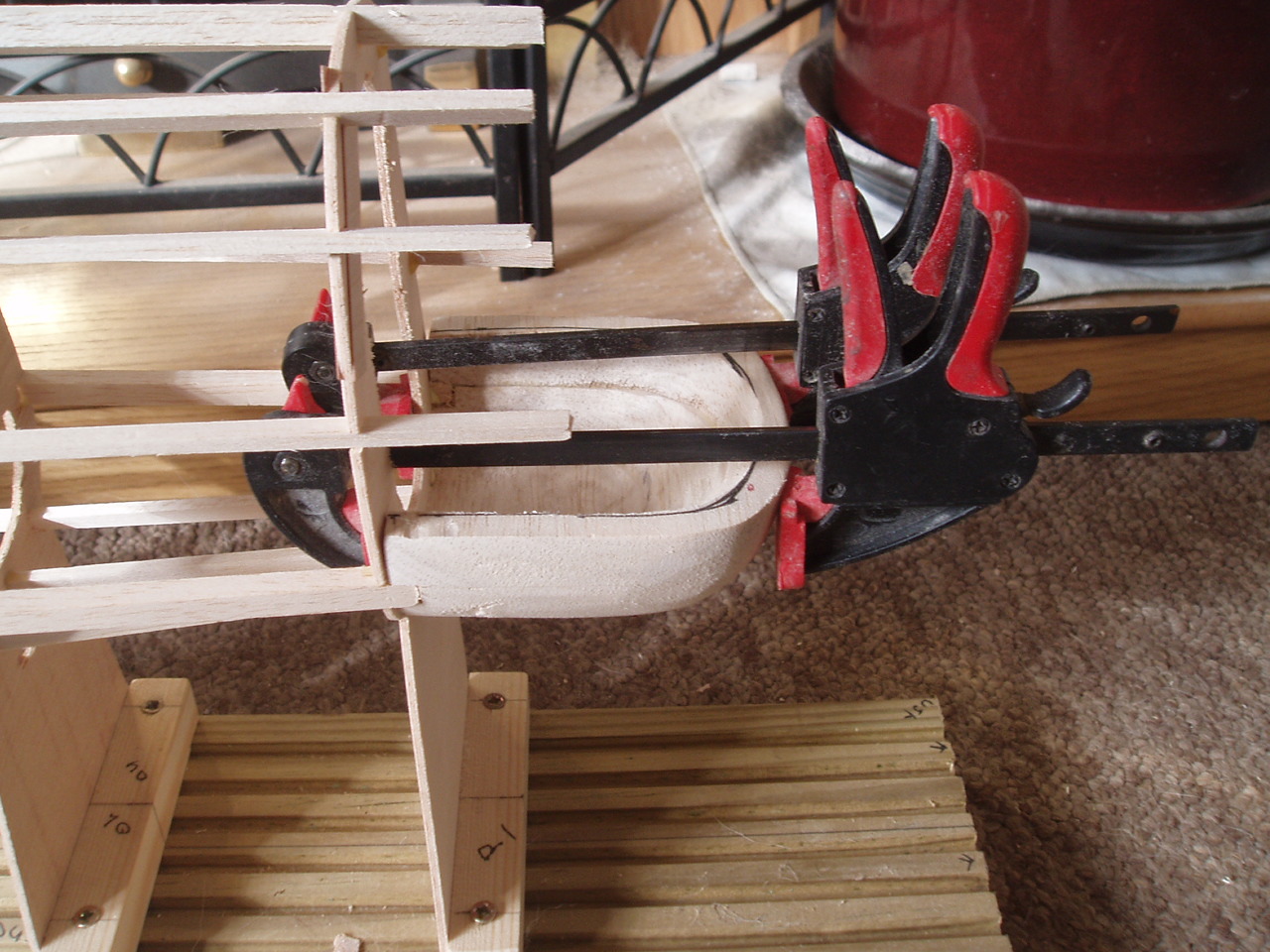

Hi all, Well I've done part of the tail which is made with from 1/8" and 1/16" balsa. It was a bit tricky as it all had to be made flat as you all know that working with light balsa it can twist very easily.
The front gun turret was taken out to make the Lancaster lighter so it can Carrie the large pay loud and was replaced by a dome which in this model is made from 3/8" balsa hollowed out.
the rear gun turret base is made from 1/2" balsa also hollowed out.and when the Lancaster is finished it should weigh it at around 9 LD.

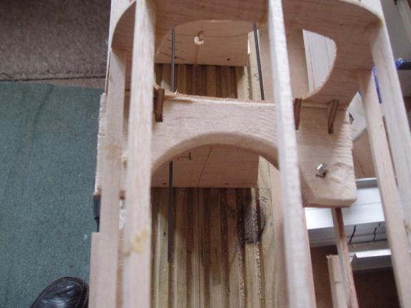

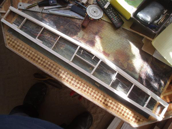

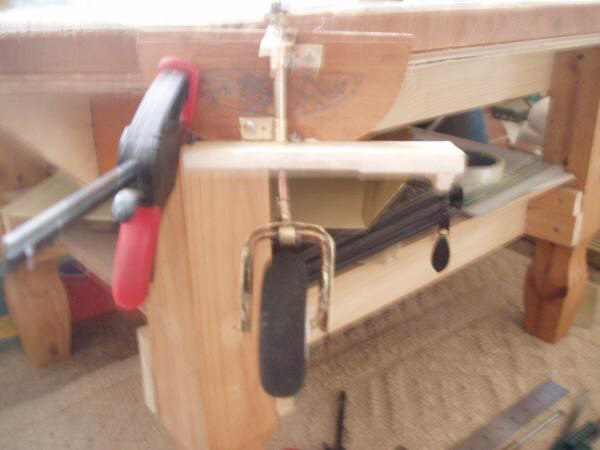

Hi Every body. well to keep you up to date I've reinforced the part of the body ware 2 sero's will go and some of the electrical bit will live. Also put in the reinforcing bracket were the main wing will be attache to the main body.

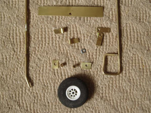

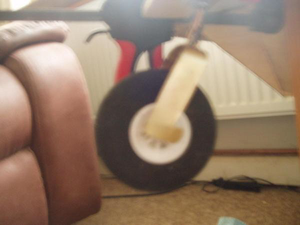

I've also built the rear wheel from scratch from brass which will be attached to the rudder push rod so it can be steered when it on the ground. There still a bit of tinkering to do with it but that can be sorted out when the Tail wing is fitted as I need to ever thing sit's. at the moment I've made a small frame for it so I can make sore it will fit into the main body and wing assembly.
The tail wing is my next part to build so it might be a day or so before I post pic's of the wing as it's being built.

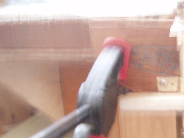

Sorry about some of the pic's. I done now what happened I'll take some more pic's tomorrow and hopefully they will come out ok .

HI All. as promised I reloaded the pic's that did not come out. the pic's are of the rear wheel all had to be made by hand but there is still a bit of work to be done but to Finnish it off which can be done when it come time to fit the wheel to the main body and tail wing.

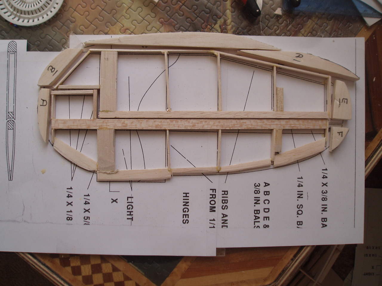

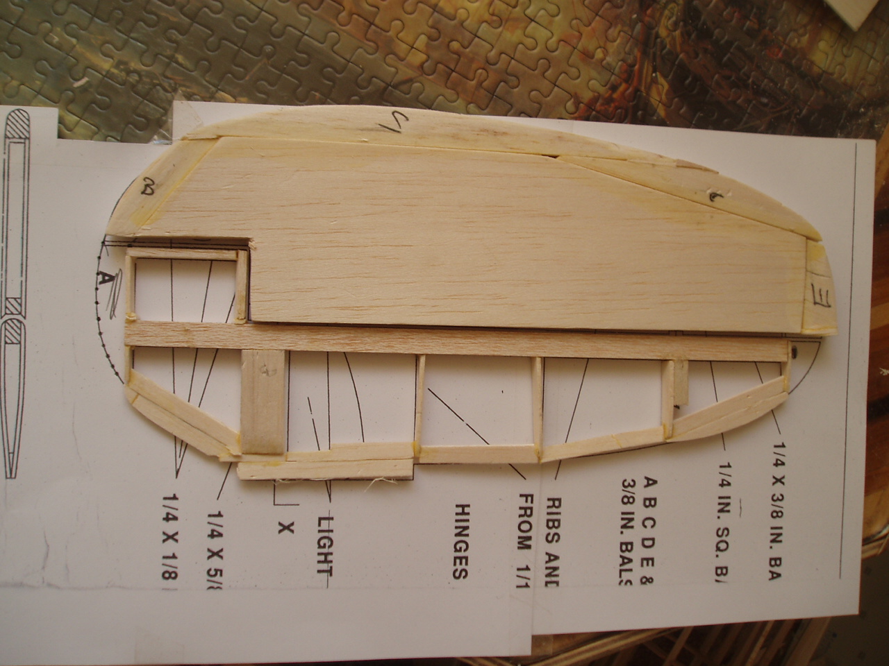

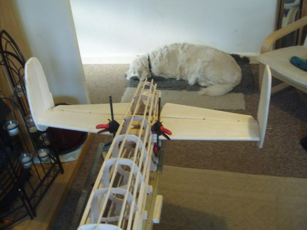

Hi every body. Well its been a will so for an update on my Lanc's.

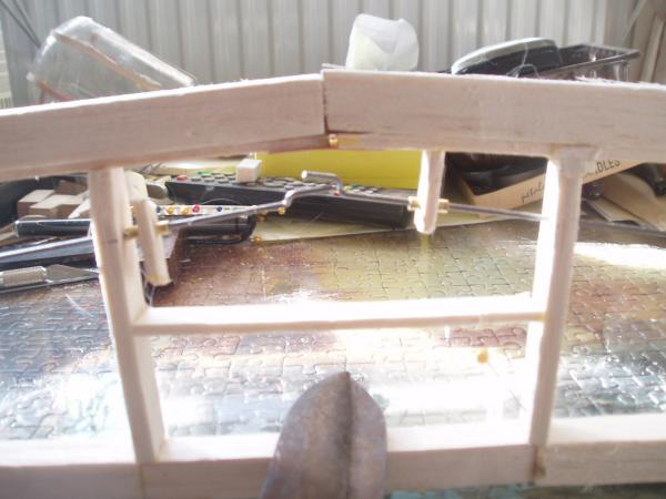

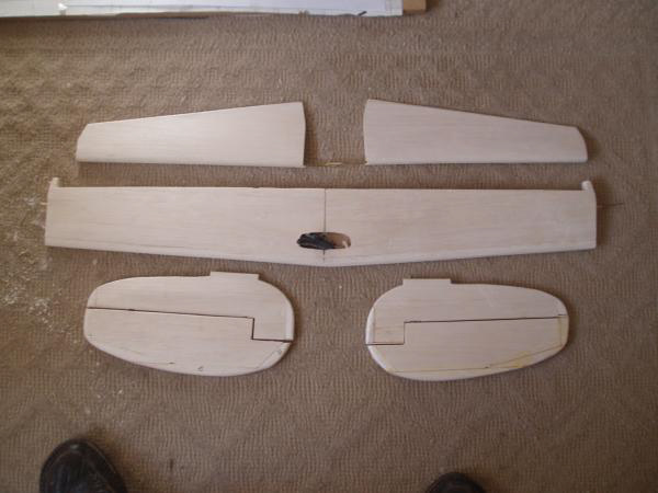

At the moment I've finished the tail wing with Rudder and elevator and rear wheel all attached to push rods.
There has only been one small hick up and that was nearly setting fire to the tail wing when I drooped the soldering iron onto the wing. All is well as only a small scorch mark on the wing and luckily it inbound so it can not be seen when the skin of the fuselage is put on.
All I need to do is attach the 2 push rods that run though the wing to the rudder and then glue the wing in place.
