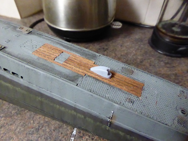

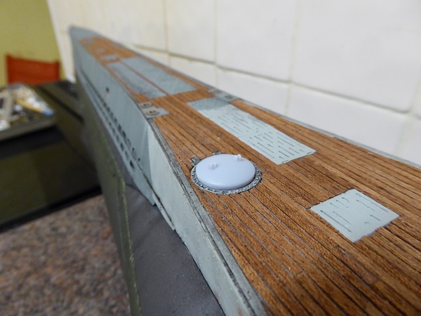

This weeks update of my 1/48 scale U230 U-boat build sees further detail added to the casing.
The attached photo shows the accommodation space hatch fitted in place.
#1969 Posted : 12 April 2018 22:09:39
The hatch from above.

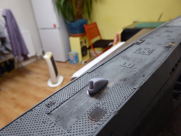

#1970 Posted : 12 April 2018 22:15:44
Looking forward.
There are small etched pieces that make up the hinges that attach to the hatch, but I've decided to fit these at a later date whilst I had handle the boat during this stage.
I also have to turn the boat upside down and rest it on the planking while I fit the rudders, fore and aft planes, prop shafts and propellers. Only when these components are fitted can I then upright the boat and fit all of the small, casing details including cleats, eyelets, the hinges as mentioned previously and the capstan.

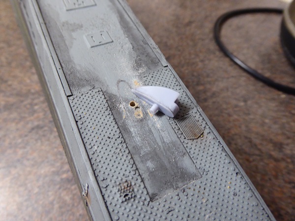

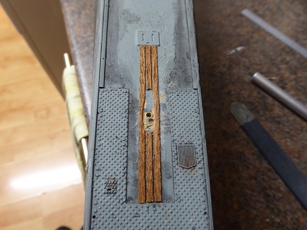

#1971 Posted : 12 April 2018 22:18:31
The next step was to turn my attention to the aft section of the casing. The first job was to clean up the aft navigation light housing, mark out and drill a locating hole in the casing and test fit for alignment.
The attached photo shows the aft navigation light ready for fitting.

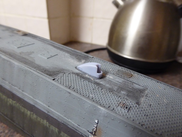

#1972 Posted : 12 April 2018 22:21:31
Aft navigation light housing fitted.
I will fit a small LED into the housing and wire it up at a later stage. The housing is not fixed at this stage; it just provides a footprint to plank around and then be removed until a later date.

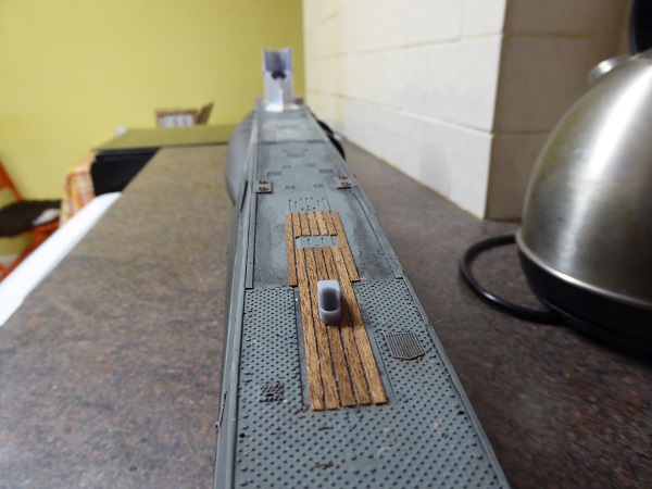

#1973 Posted : 12 April 2018 22:24:09
Showing the housing from another angle.

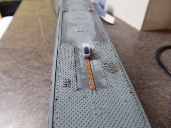

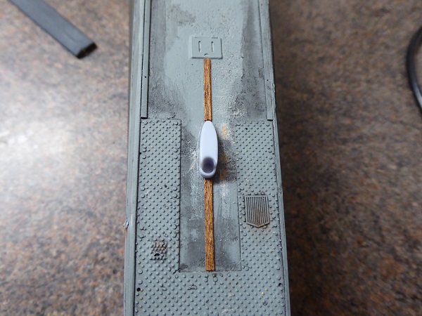

#1974 Posted : 12 April 2018 22:25:00
The attached photo shows the first central plank aligned and glued into place.
#1975 Posted : 12 April 2018 22:28:21
A further central plank fitted.
These act as guides from which all consequent planks are fitted in the construction of the mahogany decking.

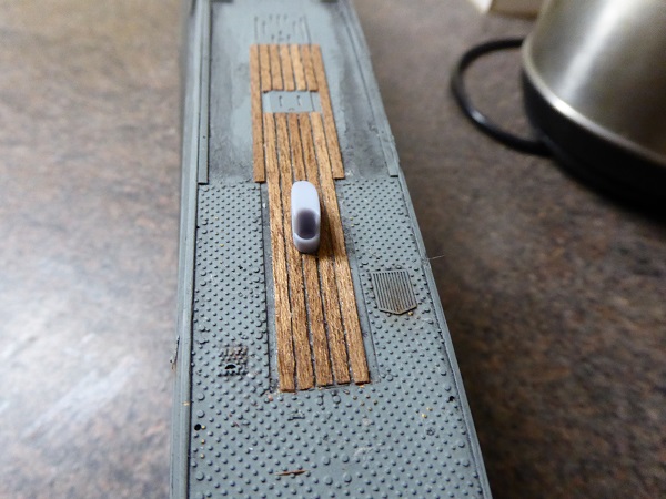

#1976 Posted : 12 April 2018 22:32:23
Two sections of planking were then laid either side of the central planks. The housing was then fitted and a scalpel was run around the housing edge. Several passes were required before I had cut through the wood.
The attached photo shows the surplus cut away.

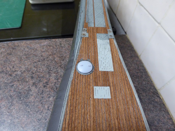

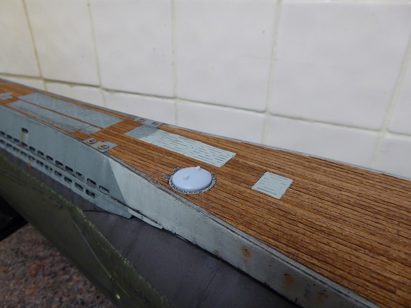

#1977 Posted : 12 April 2018 22:33:27
Housing refitted and further planking laid to make up the decking.
#1978 Posted : 12 April 2018 22:34:05
From another angle.
#1979 Posted : 12 April 2018 22:34:43
Looking forward.
