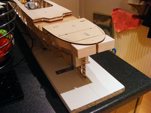

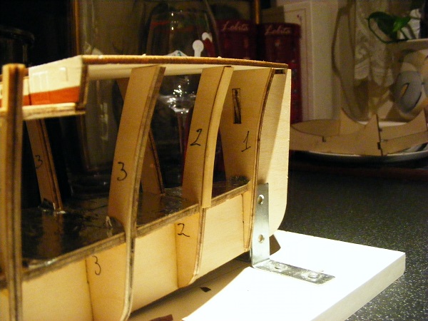

Finally for this evening I managed to fit the balsa block to the stern area and applied strips to a couple of the ribs to build them out, did these using some of the bamboo strips left over from the SOTS..... Tomorrow will start shaping the stern area and fairing the hull in preparation of the planking phase.....Cool Cool Cool Almost time to put some clothing on this beast..... Cool Cool

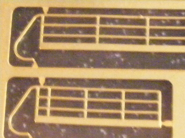

#166 Posted : 03 February 2014 23:11:31

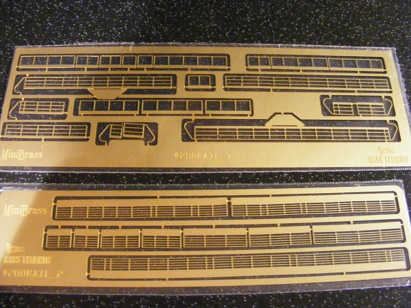

Some more brass etch parts arrived today, still got a few more to get yet.... Cool Cool .. Detail on this etch is incredible..... Cool Cool
#167 Posted : 04 February 2014 10:32:27
BigGrin Stunning work Alan the etch looks bril BigGrin Rgd Martyn

Thanks Martyn, quite a bit more etch to get yet, a little expensive but think it will be so worthwhile.....Cool Cool

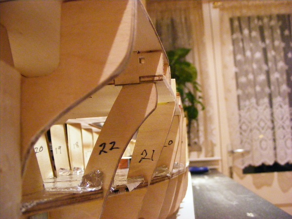

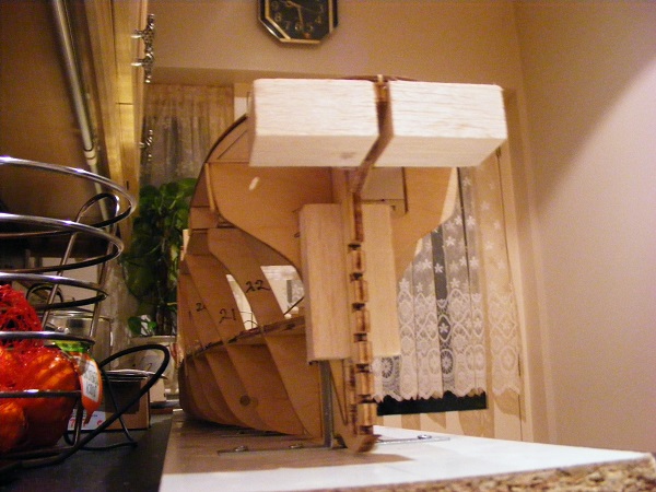

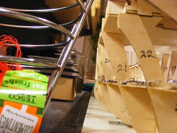

Ok, started fairing the hull and shaping the stern and have now decided to stop a little while and take stock of a couple of problems that are now staring me in the face.... will try to explain the dilemma I am now facing.... Glare Glare.. Although I previously said a couple of the ribs needed to be packed out I have found rib 22 to be way to narrow, pics show the rib is too narrow by about 5mm on both sides, this will have to be built up before going on any further... If I tried to plank as is then that area of the hull would have quite a distinctive hollow Glare Glare .. There are more problems to resolve...

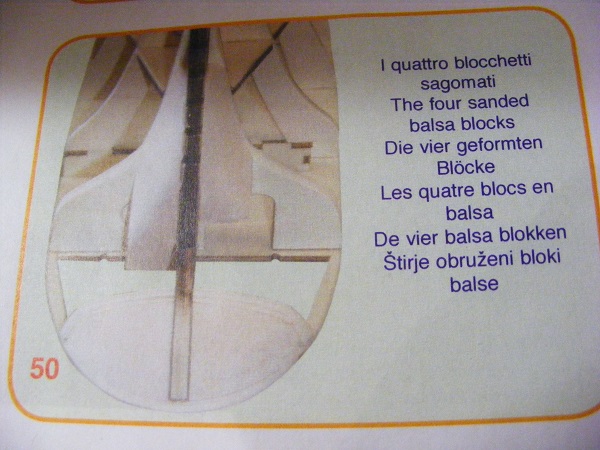

Next problem I came across had to do with the shape of the stern. The Titanic stern to me is an iconic part of the ship and getting this wrong for me would grate on me everytime I looked at the finished build so I feel I have to do something about it. This is the only pic on the instructions that show how the shaped balsa blocks should look once sanded... Followed the instructions and you can now see it looked as per the instructions...
#177 Posted : 04 February 2014 23:11:59

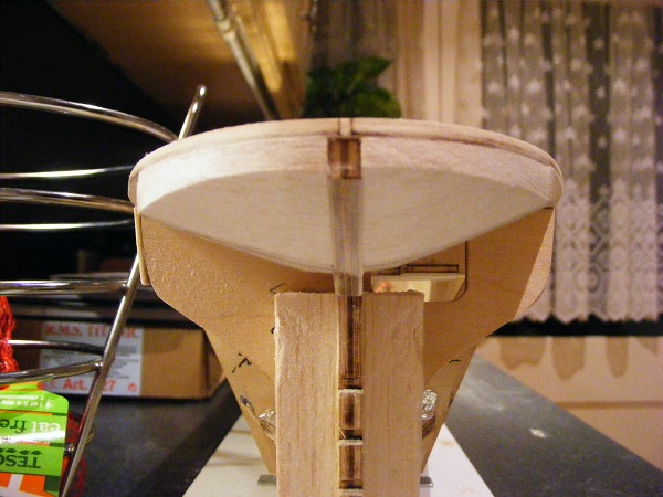

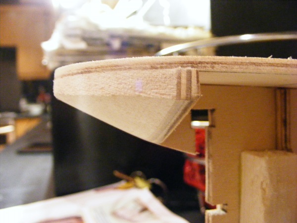

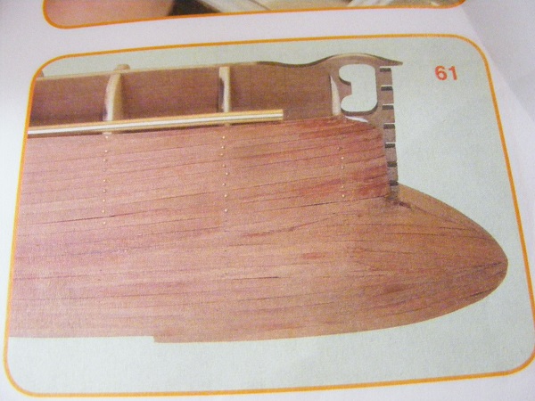

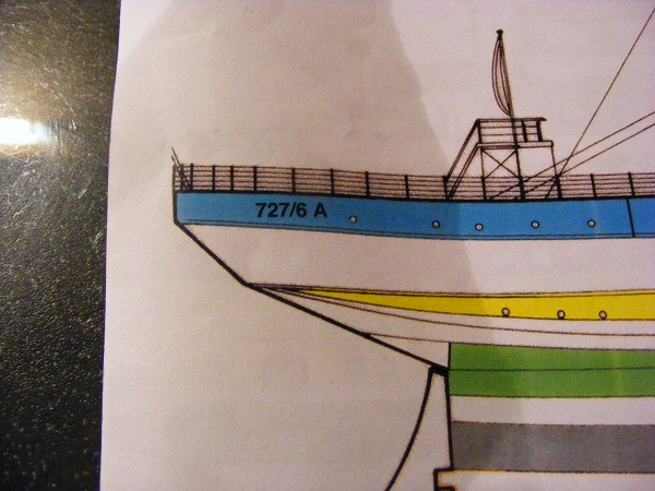

Once planked the stern would look like this and it was here that I really started to notice things didn't look right, certainly did not have the iconic ships stern profile that's for sure.... Looked into the next box and studied the instructions there and suddenly the instructions showed a different profile but no explanation or diagrams as to how this was to be achieved....
#178 Posted : 04 February 2014 23:19:25
Another dilemma is when using balsa to shape the stern area I now have to try and find a way to get the portholes to light up.... Have to do some thinking now and am going to start by removing the balsa blocks and starting this area again.... Concerned however by changing the profile I may end up with problems fitting the ply etch later but that will just have to be a problem to be resolved when the time comes.... Finding it hard to believe there is this distinct difference in the stern profile between part 1 and part 2.... Glare Glare .. Am now going to order some balsa from CMB so until that arrives I will get on with fairing the rest of the hull.... Cool Cool .. Will post how I intend to resolve this and how I progress..... Any ideas or advice would be welcome......
Happy building all...
