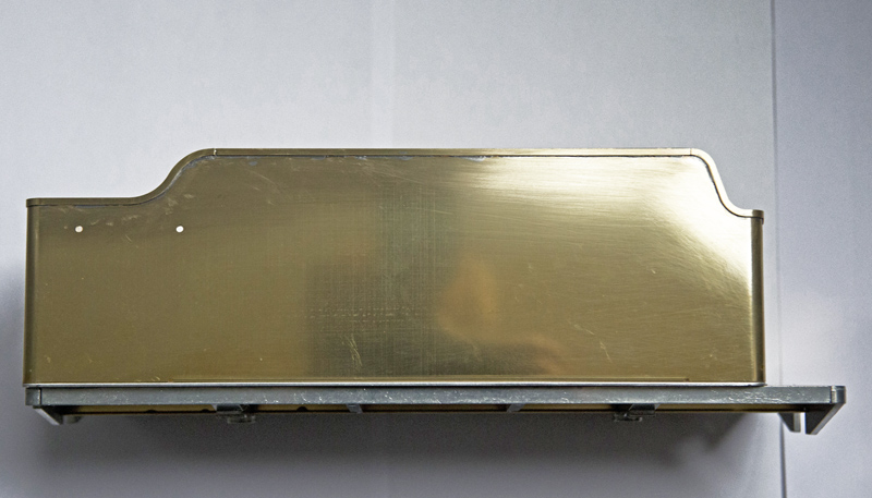

D51 Parts set 18 - Soldering
For those interested I have updated the 'Modelling Know How' section re soldering since the edging in particular in the latest set of parts continued to provide excellent opportunities.
regards Dennis
Dennis
#164 Posted : 17 October 2014 08:58:24
Joined: 08/08/2013
Posts: 184
Points: 567
Location: Runcorn
D51 Parts set 18
All the tender base parts were screwed in place as per the instructions. However with so many small cross head screws I am at present investigating ways of changing their appearance into rivets. Once painted they would look so much better. Next the edging was soldered to the two tender sides. See 'Modelling Know How' for further details. The sides were then screwed into place and the tender joints temporally screwed onto the sides together with the rear tender wall. Whilst the rear wall and joints were held in place by the screws the overlapping sections between the joints and the rear wall was soldered in place on the inside. Once soldered all the joint screws were removed. Having removed the screws, the holes were soldered up and the faces flatted. Finally the last piece of tender edging strip was soldered onto the rear section.
regards Dennis

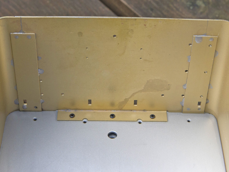

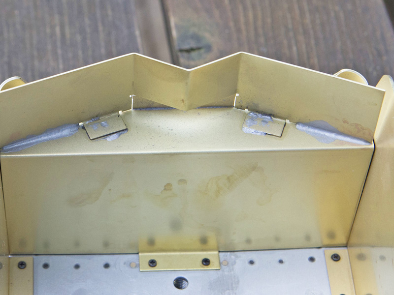

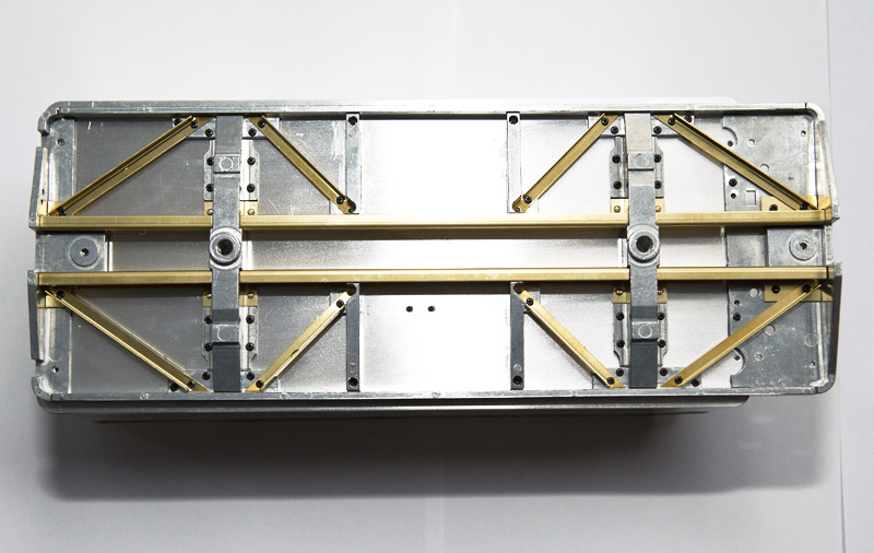

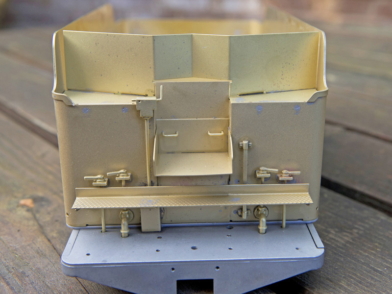

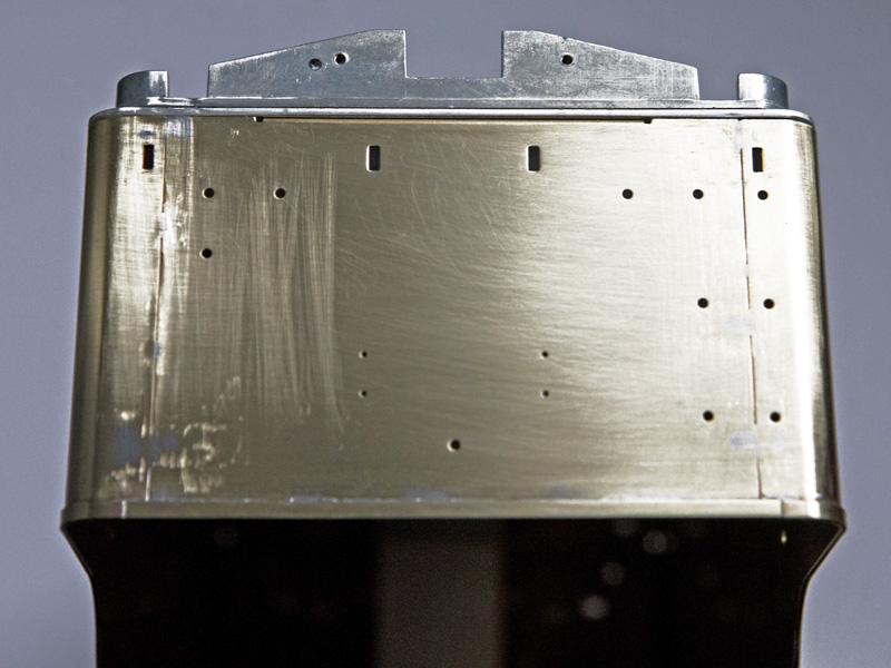

Parts set 19
Firstly please find a picture showing the inside rear wall soldered joints from parts 18 which I did not show last time.
Parts set 19 continued to present ideal soldering opportunities being all brass. Whilst the steel 2mm cross head screws were used to hold parts together, once soldered the screws were removed and the screw holes soldered up and then cleaned up. The main soldering continued to be done using the miniature gas burner the screw holes were best done using the 80w iron. All the various valves and pipework was also soldered in place. With these it was easier to tin the pin part of the valve and the ends of the pipework. Then using the miniature burner and liquid flux the soldering was completed. I have completed the sides of the tender bogies but since these are simply glued using epoxy I will leave showing them until completed and painted. I continue to be impressed by the quality of the kit and the fit of parts.
Regards, Dennis

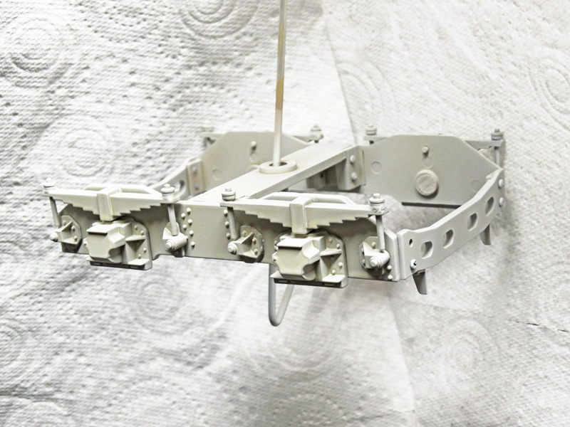

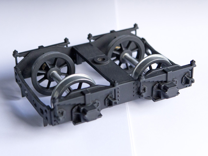

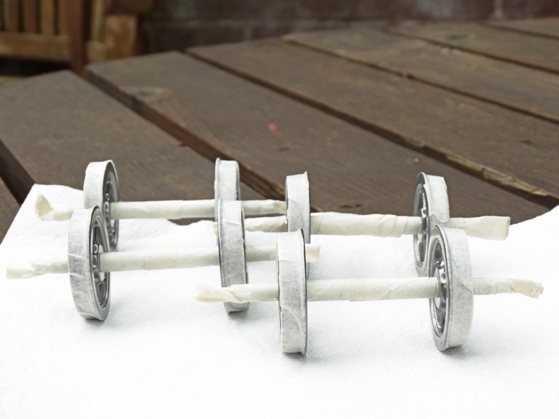

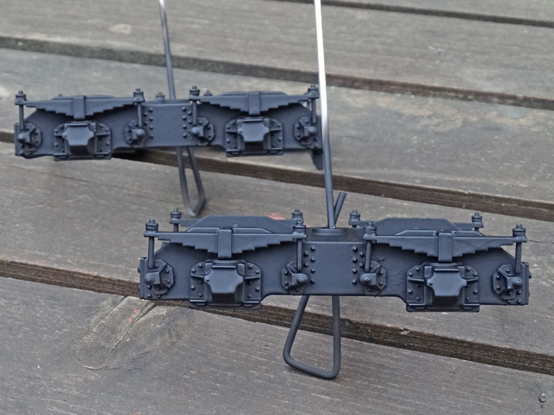

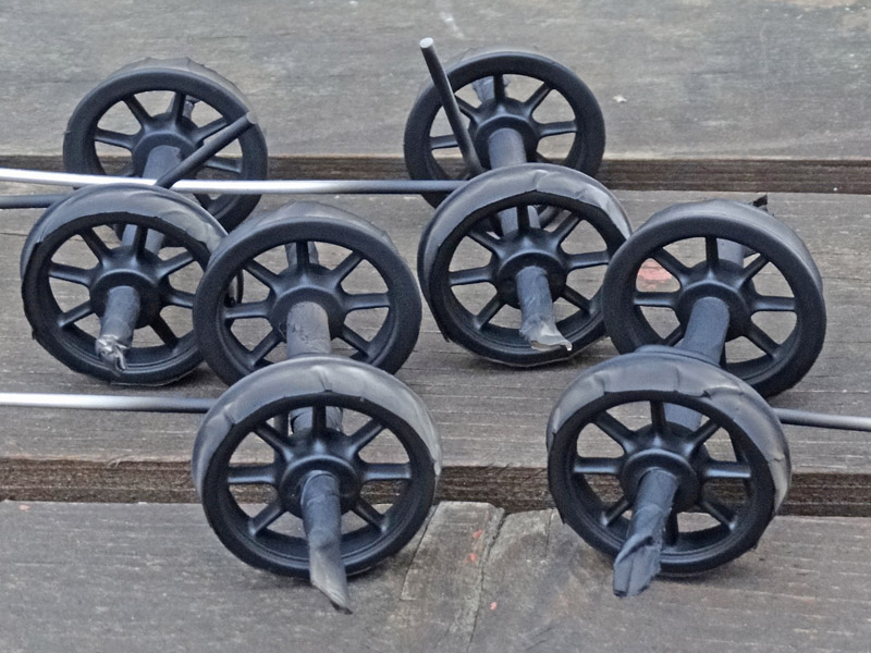

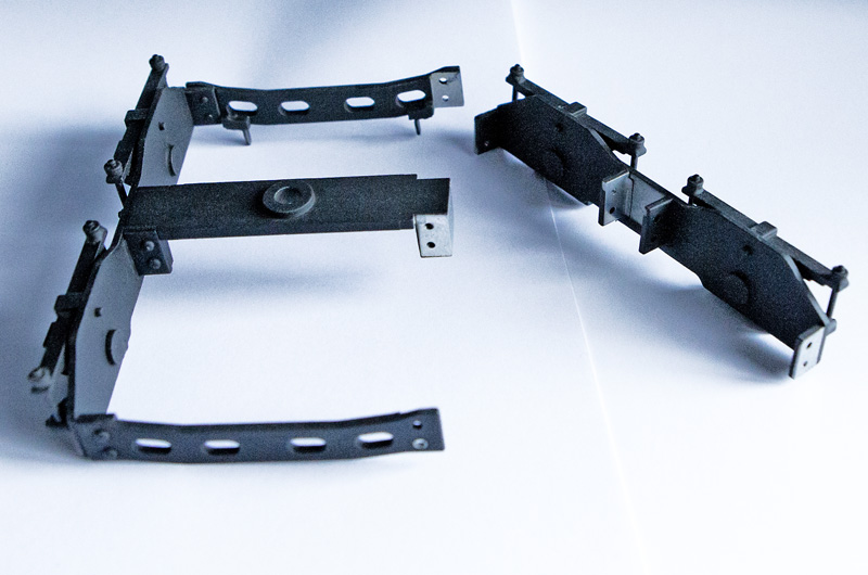

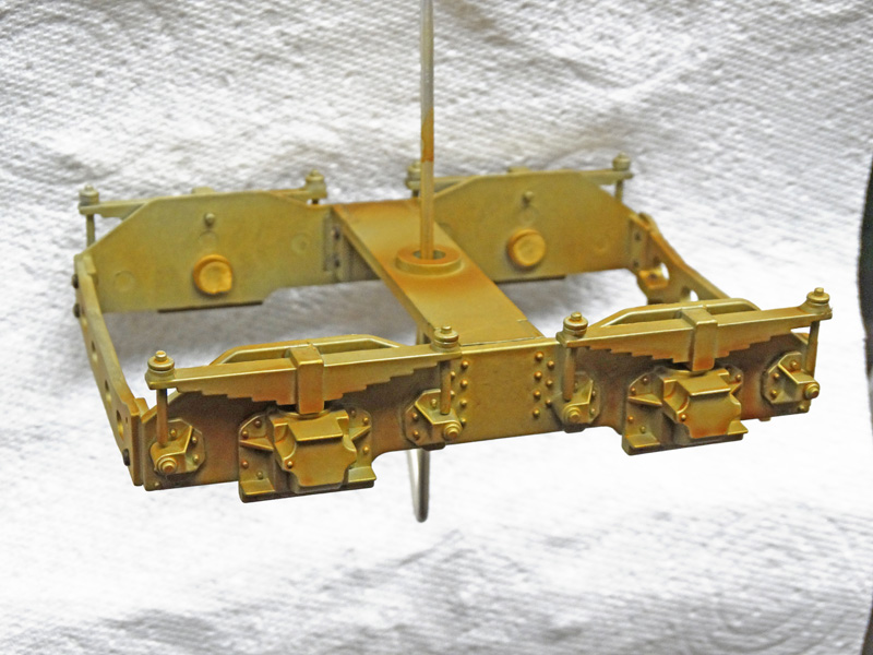

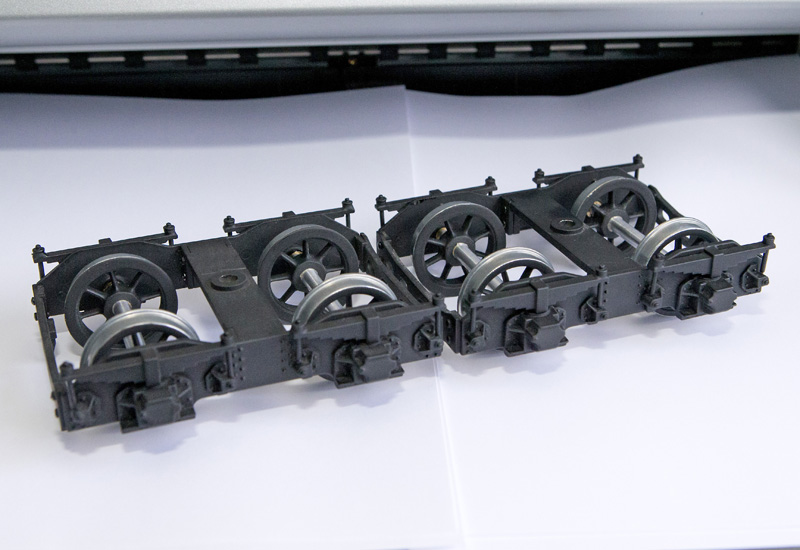

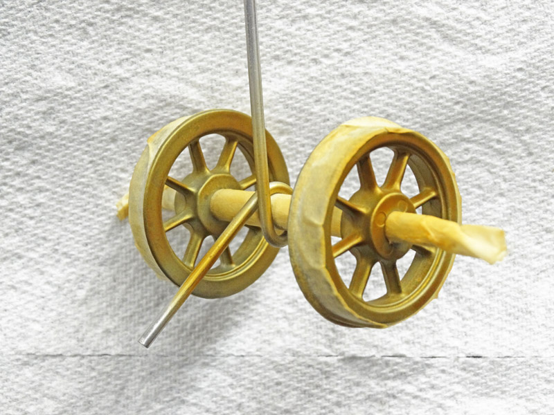

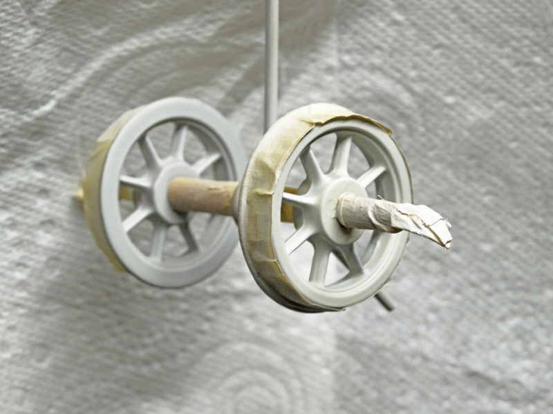

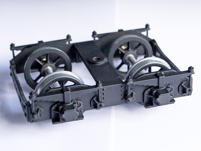

Parts sets 19/20 Painting the bogie assemblies.
It is some time since I painted the main driving wheels and therefore the bogie assemblies provided the first real opportunity to do some painting/spraying. Firstly since my main hobby is restoring motorcycles then the paints/products I use stem from that hobby. However similar products will be available from the usual modellers outlets. Non magnetic metals such as Aluminium, Brass, Zinc, Stainless steel etc do not provide the ideal surface for paint to adhere to. The simple answer is to use an etch primer first, this keys itself onto the parent metal. Following this I used a primer and finally an almost matt black. In fact I mixed this from a matt black and gloss black. All the paints were applied by airbrush although its possible that a small spray gun maybe better on the large areas such as the tender which will soon be ready for spraying, after parts set 21 anyway.
All parts to be sprayed were degreased first followed by masking off the various parts of the axles/surfaces on the wheel sets. The wheel bearings were masked off using small discs of masking tape cut using a cork borer tool. Although masking of the bogie joints would be an obvious solution I decided to complete one side and two ends, then using just three stews I attached the final side. After spraying the side was easily removed and the wheel sets inserted. A drop of oil was added to each bearing even though these wheels are unlikely to ever turn! All the screw heads received a small drop of high build superglue which after painting resembled a rivet.
Enjoy the pictures. The tender steps etc will be added soon.
regards Dennis
