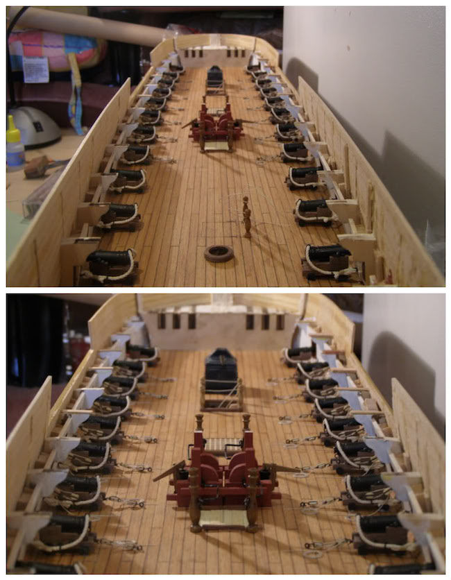

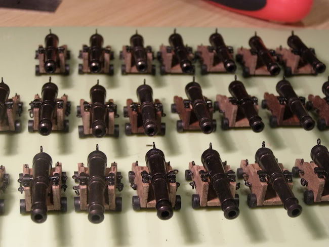

CoolDrool impressive looking cannon barrels Magpie
did u achieve that with just using blackener??
#162 Posted : 27 February 2011 16:11:11
Hi Stuart,
yeah, I used the Blackener from CMB. I did the Barrels, the eyelets the rings and the caps. Saves painting lol..
Chris..

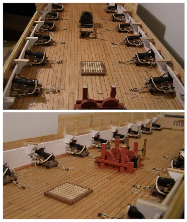

#163 Posted : 27 February 2011 23:17:21
Hi,
Here are the finished article ready for rigging now.
Chris..

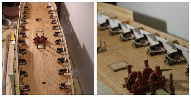

#165 Posted : 05 March 2011 00:50:39
Hi All,

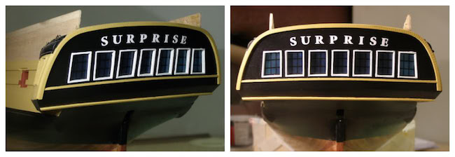

I have installed the name on the rear of the ship. Different font to the prototype but looks ok.
Chris..
Prototype.
Mine..

BigGrin your choice of font definately looks better & more in scale than the 1st picture

Really looks the buisness now that name plate is much better.

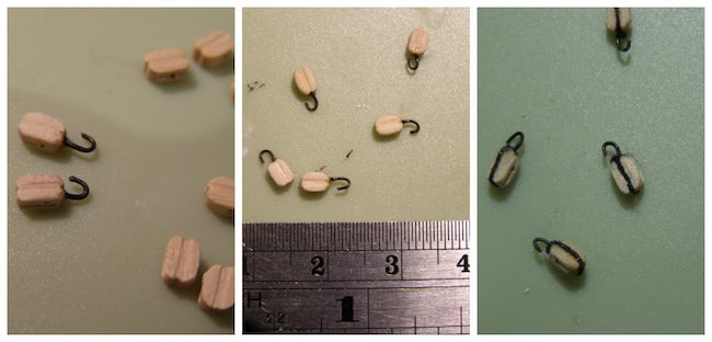

#170 Posted : 07 March 2011 00:17:18
Hi All,
Thanks for the comments..
I think the letters quite suit it.. :)
Here I have installed all the cannons with the Breach rope attached... Ready for the next step.
I have started the blocks... Eyes are sore now getting late and squinting looking at these.. :D
I found that by getting a sheet of course wet and dry and a hard foam sanding block. You put a small block in between them and rub around on top of the wet and dry sheet lightly you can sand the blocks all the way round. The ones on the right are originals un sanded..

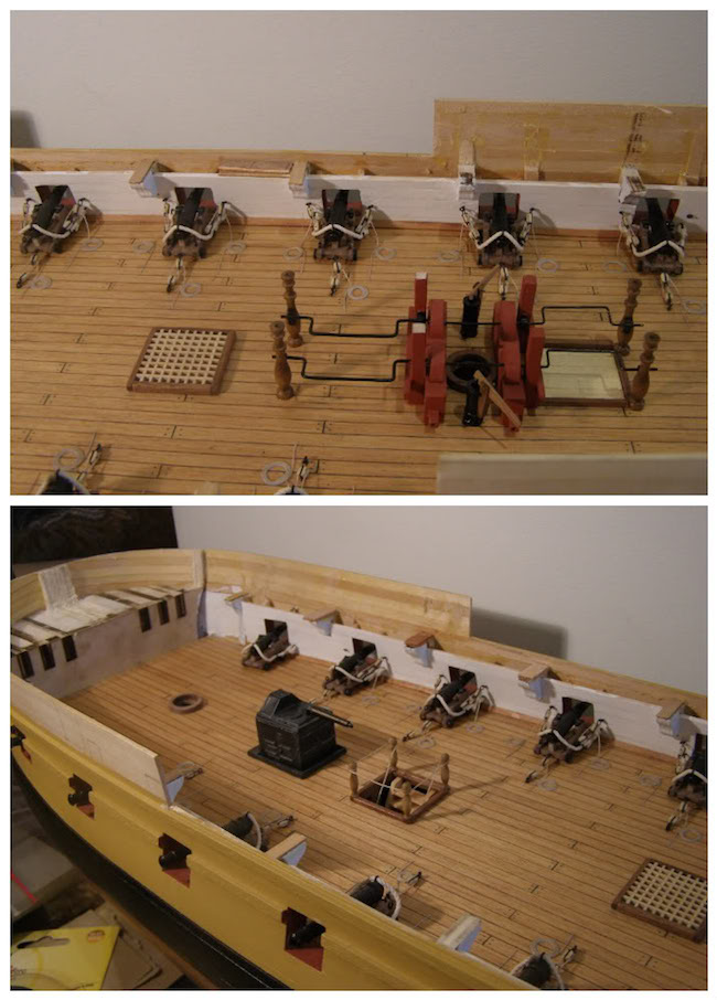

#173 Posted : 24 March 2011 14:50:56
Hi .
Here is the latest update.. I have spent a couple hours here and there doing all the blocks for the cannons in between running around after my 6 kids, but am finally getting there with the cannons. I have one side done apart from the rope coils. But will make those all in one go.
Once all done I can move onto the top deck.. Hurray. :) :)
Chris.

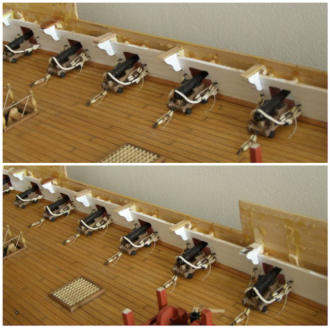

#176 Posted : 28 March 2011 00:14:05
Hi All,
Thanks for your comments Mike and Budgie,
Yep the cannons are time consuming..Lol
Its good stuff that blackener m8..
I have now finally completed the Cannons..Phew,,

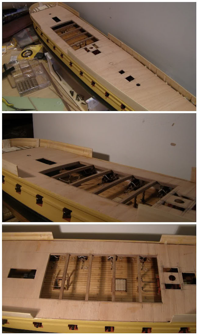

My next task is to start on the next deck and positions of the steps and the gratings. I have marked out and cut the holes out now. but no pics of the deck sorry.
Chris..
#177 Posted : 28 March 2011 20:49:55
Hi Again,
Been busy today...

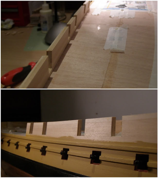

First I marked out the steps on the main deck ready for the hand rail, then I installed the pillars and the chain pump handles. Then the stove in the correct position. Once all done fitted the top deck.
All ready for the bulwarks to be planked now. Or do I plank the deck first..?
Chris..

#180 Posted : 29 March 2011 22:23:22
Hi all,
Well I've been a busy man today..Lol..
I masked the gaps up on the deck and the opening so I don't get too much saw dust under the deck. I the made the cut outs for the gun ports. and proceeded to make the frames. Then line the insides.
Chris..
