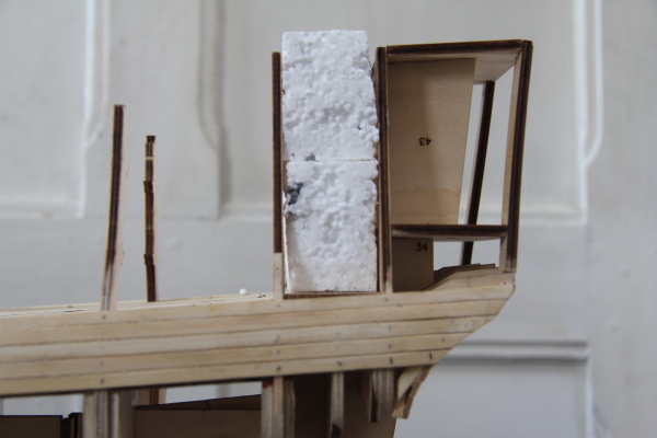

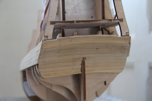

Well, that's five rows of planking done and the sixth pinned up to dry after soaking and bending.
Not much but it is so hot at the moment, it slows me down!
Also doing outside painting and fussing over my allotment.
I have tried to use only knot-free planks in this area where the gunports will be - in case the knots might make cutting the ports difficult.
Sanding off any high spots as I go, so that I won't have a massive job at the end.
The highest rib is protected with some polystyrene insulation foam.
Captain David attached the following image(s):
#168 Posted : 16 July 2013 18:52:03
BigGrin Nice work on the planking David BigGrin Good idea on the polystyrene. The ribs are very brittle and can easily snap Cursing Happy building rgd Martyn

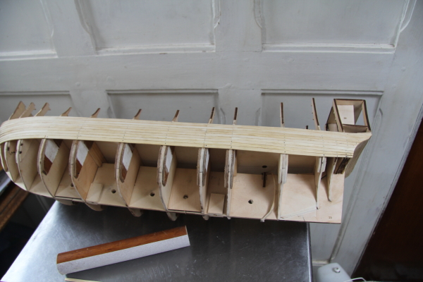

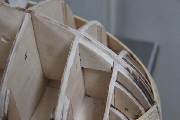

#172 Posted : 01 August 2013 08:10:37
Joined: 27/02/2013
Posts: 228
Points: 664
Location: Bursledon

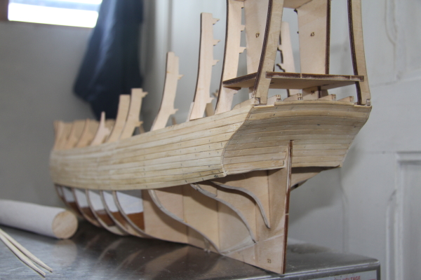

Ten layers of planking done at the top.
I have held off doing the bottom planking until now, waiting to work out a tool for sanding down the concave curves at the stern.
Finally settled on a pole I found lying around that is 34mm diameter. Not sure where it came from, maybe a parasol pole or an oar.
P60 aluminium oxide paper, attached with double-sided tape, did the job very quickly.
Now for those tapered planks at the keel...
Looking at the instructions, there seems to be nothing to attach the tapered tips at each end to.

#175 Posted : 01 August 2013 12:16:47
Excellent work DavidCool .If you are concerned about the ends,may I suggest you glue some timber to either side of the keel and blend it to the profile.You are quite right,your keel is 4mm wide and so is the slot so the ends are theoretically in fresh air.Increasing the keel thickness is quite common practice when you haven't infilled the hull.Hope this is of some help.
Kind Regards Nigel

Captain David
#177 Posted : 02 August 2013 08:26:38
Joined: 27/02/2013
Posts: 228
Points: 664
Location: Bursledon
Thanks guys.
My thoughts exactly, Nigel.
A bit of support put in now, 4mm ply scrap from the frets.

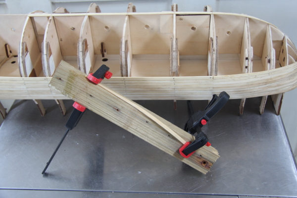

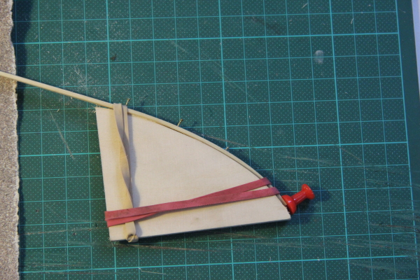

Captain David
#178 Posted : 03 August 2013 17:36:43
Joined: 27/02/2013
Posts: 228
Points: 664
Location: Bursledon

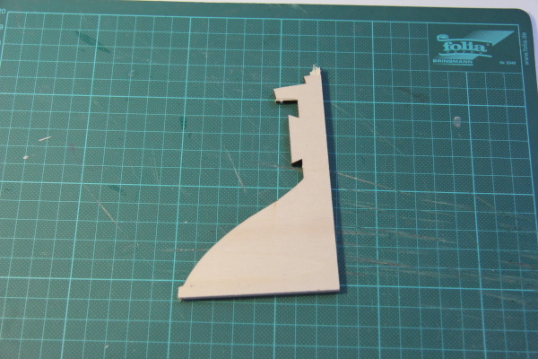

Doing the garboard planks.
To shape the first one, I made a former out of some spare fret. It looks like the piece from rib 27 but I'm not sure... Anyway, it looked like the right profile without too much modification.

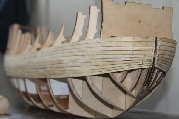

A map pin at the tip enables me to hold the fine tip (after tapering) and then either pin it or use rubber bands to hold the rest down while it dries out.
To get the twist in the aft piece, I am clamping around a scrap bit of wood after a long soak. If anyone has a better method I would be interested.

NMBROOK
#180 Posted : 03 August 2013 18:20:03
Nice work David and a novel way of twisting the garboard plankBigGrin .I don't think there is another way other than clamping to the ship itself,which is rather awkward.
Kind Regards Nigel
