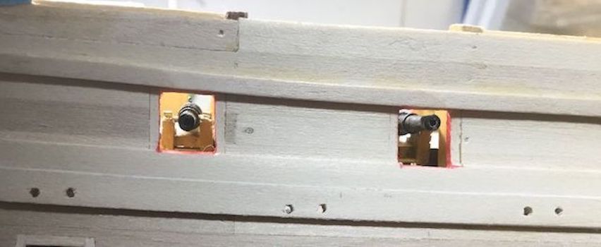

I have just completed the first lot of deck planking and thought I would place a cannon to see how it fitted. All of the cannons that I have built so far are too high in the five ports as well as hitting the bulkhead posts.
When I first got the Victory kit, I remember reading that some builders were experiencing a problem with the position of the cannons on the lower deck. There were a series of posts back around 2011 that discussed this and the answer seemed to be to deepen the axle slots so that the carriage sat lower.Looking at my cannons, if I do this, the carriage will be sitting on the deck?
For a problem like this to have been apparent almost from the beginning, I am surprised that a remedy, such as slight lowering of the deck and/or raising of the gun ports had not been incorporated into the instructions.
Could someone let me know if this is the only answer to the problem apart from shaving off the bottom of the wheels, which seemed to be an option in 2011?

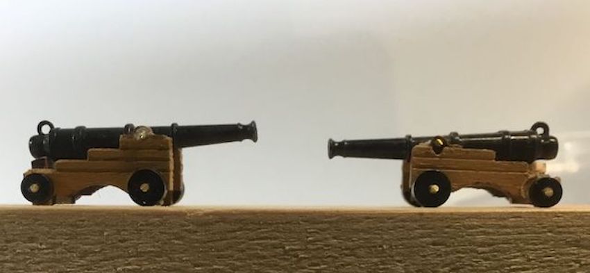

I have been giving some thought to my problem of cannon alignment with the gun ports on the upper deck where they were sitting way too high.
What I decided to try was to cut off the uppermost strip of cannon side support panels, recut the grooves for the pivot pin then continue the build as per normal. This results in the gun barrel being lowered about 1mm.
Below I have shown a comparison of the normal and the modified cannons which don't really look all that much different. The difference becomes more apparent when the two alternatives are offered up to the gun ports. I will be playing with the "wedge" under the barrel to get the cannon looking central externally.
While I think this may be a solution, for me anyway, I would appreciate any comments...good or bad.
Thanks. Chris

#176 Posted : 13 April 2020 19:54:37
Joined: 30/11/2017
Posts: 493
Points: 1,482
Location: South Norfolk
Thanks. Chris
Hi Chris,
This is the exact way how I sorted out the same problem on my build.
https://forum.model-space.co.uk/default.aspx?g=posts&m=263028#post263028
I think it was a design flow in the kit, others have the same issue.
Happy building!
Laszlo
z8000783
#177 Posted : 14 April 2020 07:19:35
Groups: Unapproved
Joined: 24/05/2010
Posts: 1,761
Points: 5,351
Location: London & Greece
That is a brilliant solution, Chris. Not for the purist obviously but these guns will never be seen - apart from the barrels poking through. Looks really good, well done.
As I said earlier though, double check the quarter deck guns as you won't want this solution there.

#178 Posted : 14 April 2020 07:32:23
Joined: 21/04/2011
Posts: 1,089
Points: 3,296
Location: Buckinghamshire
John, I think the purists would be a bit annoyed that the problem arises after the kit has been around for so long.
Still, it is a problem and we’ll get round it somehow I expect.

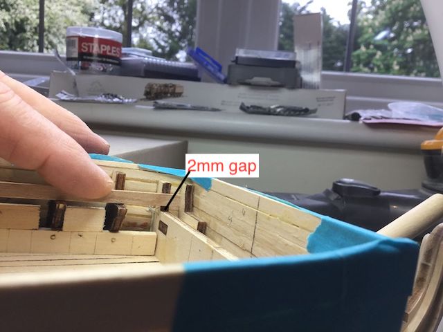

I am at the stage where I will be making up the support beams for the quarterdeck.
On laying a planking strip across the bulkhead support brackets, there appears to be a 2mm gap between the number 12 bulkhead and the guide plank. (See photo below). The relationship between all other bulkhead brackets and the plank seem within tolerance, apart from one at 16 which will need a a little sanding.
My question is: Is it OK to build up bulkhead 12 by 2mm to make the decking smooth or will this have repercussions later on in the build?
goddo attached the following image(s):
#180 Posted : 29 April 2020 22:50:35
Hi Goddo, you should be fine to build up bulkhead 12 by 2mm.... She's cominga long very nicely, well done....Cool Cool Cool
