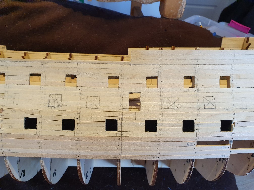

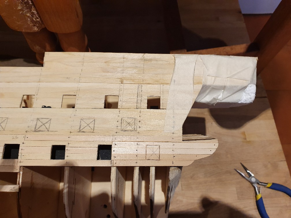

Hi all..
Im moving along slowly but!!!!
Theres a but..
Look at the picture and are the cannon ports positioned wrong!!!!..

the top and bottom rows look fine. the middle row however looks like they are up against the bulkhead and looking at the official build they may need to be off the bulkhead by about 5-8 mm

Hi Ant 62!
I just compared my DelPrado hull with your photo and my middle ports are very similar to yours - however - the DelPrado construction method is completely different to the DeAg and my gun ports are actually fixed to the bulkheads so they can't be altered in position!
Erik is quite right though, I just checked with photos of the actual Victory and the middle gun ports are right in the centre of the ones above and below, not offset. I would suggest just measuring the distance between the upper and lower ports and divide it in two, that'll give you the exact centre of the middle port.

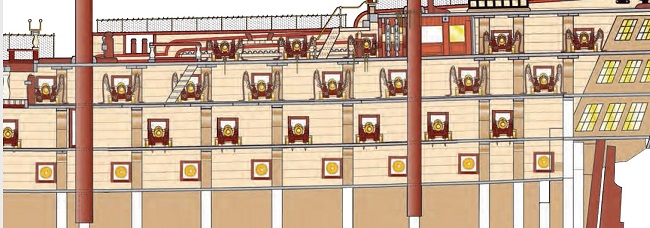

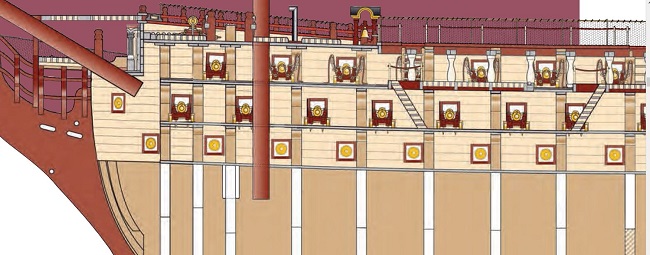

Looks to me like you're missing the first port near the bow on the center row and the stern most port on the bottom row doesn't look right. Do a comparison of your port positions using the pics attached....

[quote=Erik A]the top and bottom rows look fine. the middle row however looks like they are up against the bulkhead and looking at the official build they may need to be off the bulkhead by about 5-8 mm
https://forum.model-spac...aspx?g=posts&t=1573[/quote]
As in the picture below i have moved the middle port row 6.5mm from the bulkhead...

#170 Posted : 09 January 2020 01:27:45
Joined: 06/07/2018
Posts: 106
Points: 308
Location: New Zealand
ThumpUp

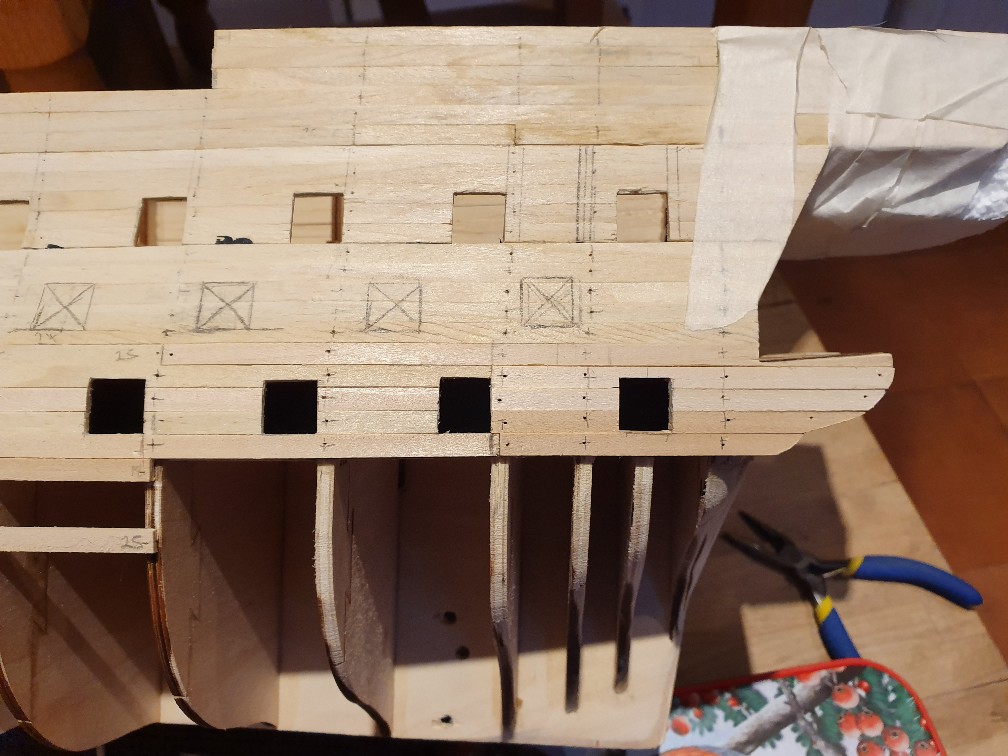

I have repositioned the middle gunports on both sides and ready to start cutting them out..
On the lower row and the gun port closest to the stern i will carefully cut back a few rows of planks on both sides to a bulk head and then replace them..
Then mark out the cannon port in the appropriate location and cut them out....

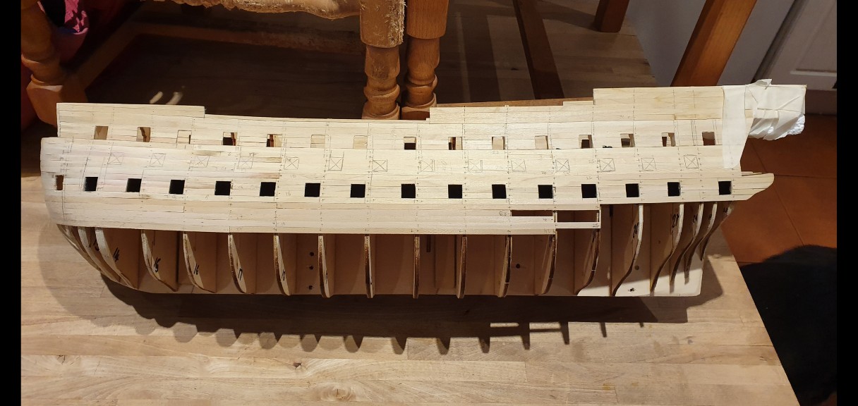

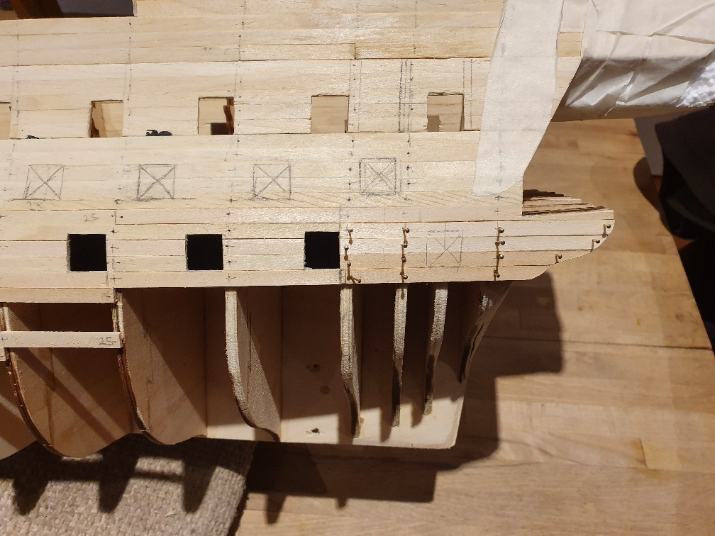

Well i removed the planks near to the stern and cut out the cannon port...
I didnt need to do anything on the otherside as i had not touched it to cut the cannon port out..
Latest pics with regards to the above mentioned work..

birdaj2 wrote:
Well done on getting back to this pisition of your build.
That has been some hard work you have had to put in.
Thanks for that i appreciate it BigGrin
I must admit that i had to have a good long think about it before i attempted to repair the damaged areas...
But what i did learn from the repairs gave me a different insight into the build...
When i striped the planking right back i wish i stripped it all off now but never mind...
I do have another full Deagostini Victory kit here that my missus bought me as she thought i would struggle to repair this one im building......
I have amazed myself in what i have done with the repairs i know its not perefect but this is my first proper build and its a journey......

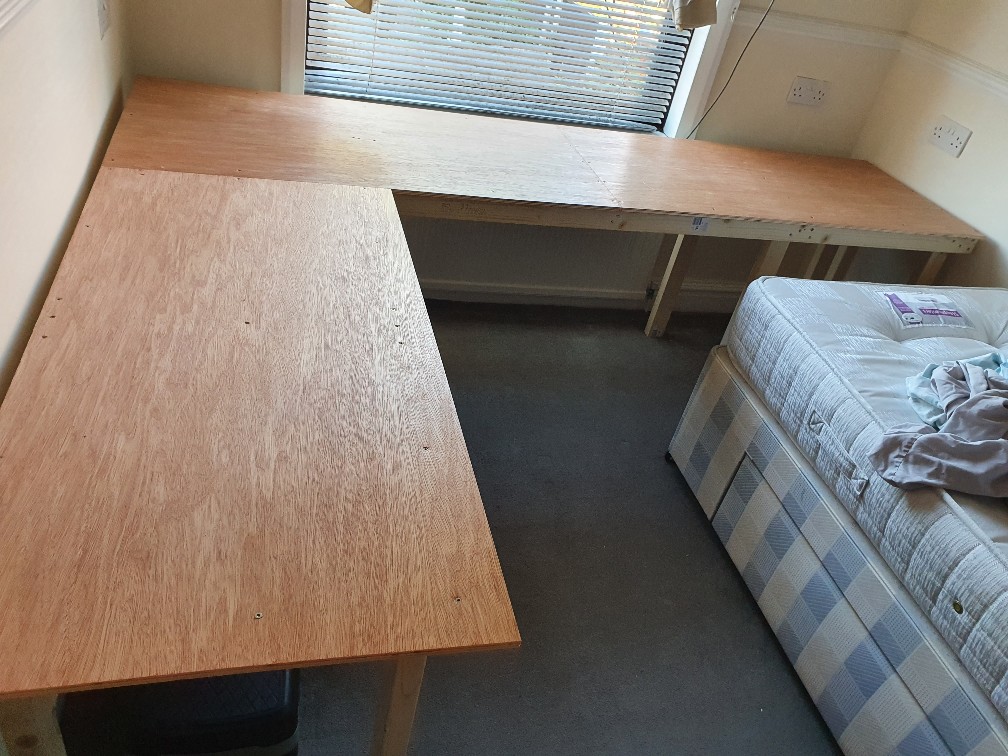

Work bench almost completed another coat of quick drying varnish and a storage shelf to add..
