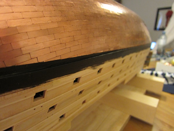

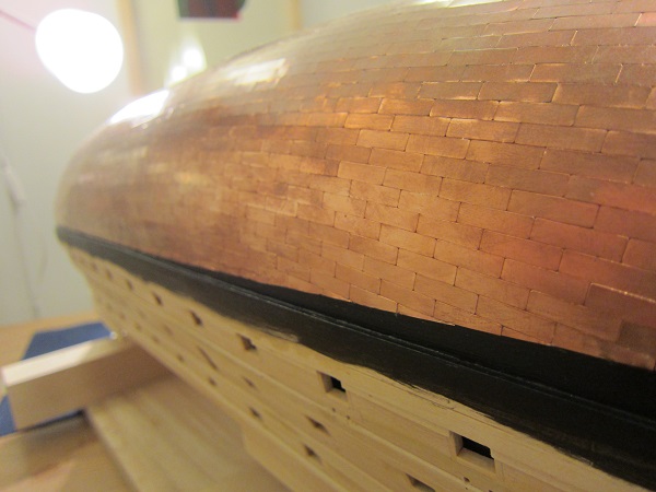

Hi guys, it`s been a while!
I didn`t have much time for my build lately. But today i could at least finish the starboard-side of the tiling!!!
All the small tiles at the waterline have been a real challenge - i had to do many of them more than once.
But overall i`m quite satisfied with the result.
Comments welcome.
Greetings Walter

Thanks Alan, Reiner, Steve, John!
I just wanted to add one piece of advice for all of those, who haven`t started the tiling yet.
For the most part of my tiling-work i used a hard plastic board, as you find it in the kitchen, as surface for the cutting of the tiles.
I thought, that would be hard enough - but never was fully satisfied with the result the tiles looked like after the cutting.
The cutting-line always was a little bit deformed - as you can see in my pictures, if you look really close. Also i had to use a big amount of pressing power - which made my fingers hurt after some time.
It wasn`t until yesterday and the last two tiles i had to cut (and me swaering i guess), that my wife came up with the idea of trying to cut on a glass-board.
And as most of you will know - no deformed lines, much less pressing needed!!
You can imagine, that i cursed myself not to have thought of that solution much earlier :))
So the right cutting-surface is of the utmost importance - and it seems that glass is the best solution. Maybe this is of some help for some of the builders (but i´m afraid i`m the only one to realize this fact that late!)
Well its a learning curve - we all now it - and i had to learn it the hard way.
I´m still not looking forward to the tiling of the port-side, but maybe now it will be a little bit easier!
