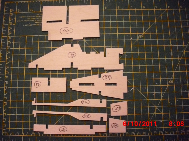

#167 Posted : 06 October 2011 09:57:25
I numbered all the parts on the back for ease of identification when fitted, then I cut them out(cutting from both sides) and then sanded them:-

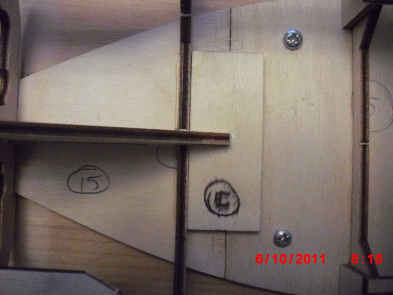

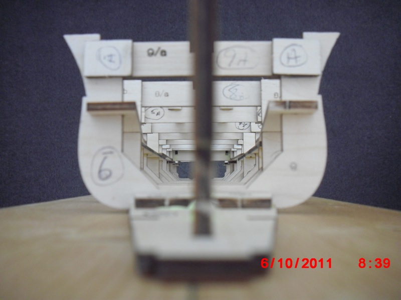

#170 Posted : 06 October 2011 10:10:31
I have included some photos of various angles of the ship for info.
If you have any questions or comments feel free.
Working around parts 16a and 17a handle with care.:-

great job there mike,a small suggestion if I may,why not mark the centre lines on the base plates and ribs,make everything easier to square up.keep them there pics coming.

a very good morning again mike,I think you misunderstood me there mike,I meant centre lines on the base pieces of the ship and the formers,to line up with the centre line on the base jig.only in one of the pics the ships base piece looks slightly of line,the very end one,could be a trick of the camera angle,or the base of the ship is not fixed?
