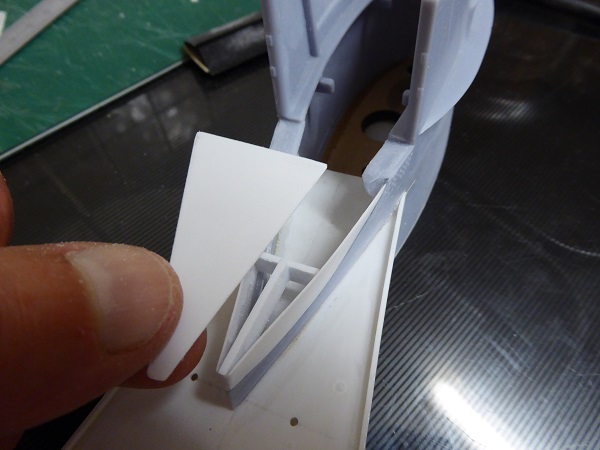

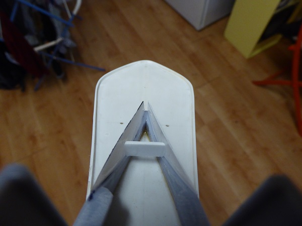

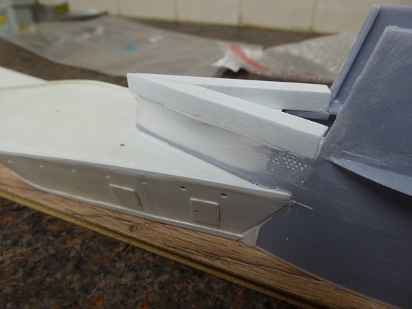

These 'fillers' weren't that strong or robust as they were so I added bracing pieces. The attached photo shows the first one in place.
#162 Posted : 20 September 2018 19:45:52

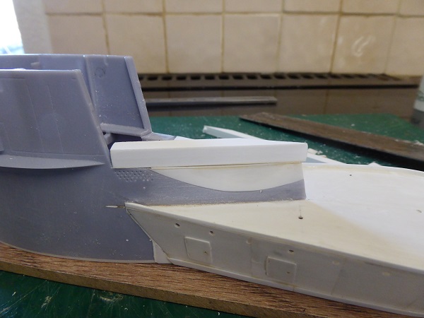

The second bracing piece fitted.
#163 Posted : 20 September 2018 19:46:34
From another angle.

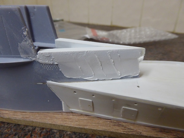

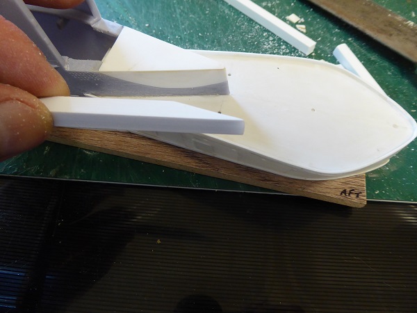

#164 Posted : 20 September 2018 19:48:14
The second bracing piece filed to suit the angle of the original upper deck. In hindsight I will have to modify this to be upright, but that will be put right during the next couple of weeks.

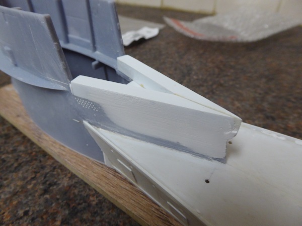

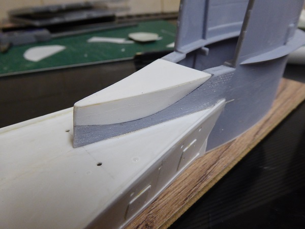

#165 Posted : 20 September 2018 19:49:11

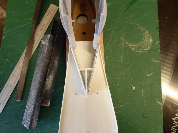

I then made a 'triangular' shaped bridging piece to support the top edges
#166 Posted : 20 September 2018 19:53:27
The same bridging piece fitted and glued in place, being held down with that ultra-rare 'modellers weight'.LOL

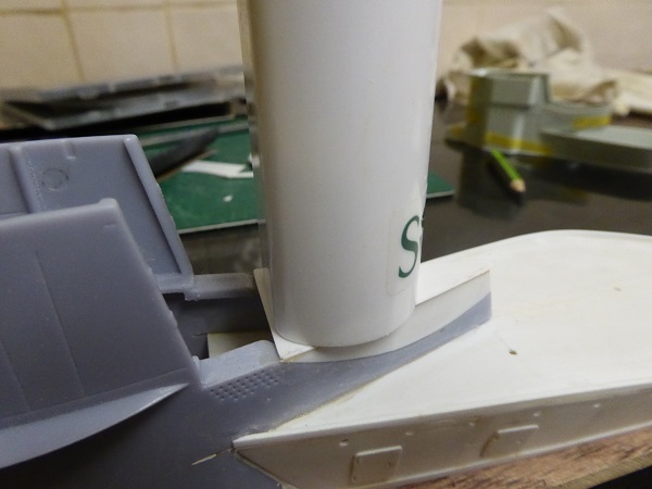

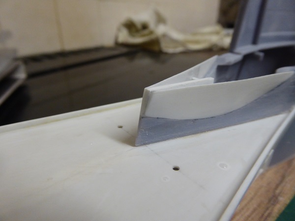

#167 Posted : 20 September 2018 19:54:21
Filed to suit.

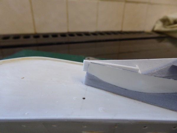

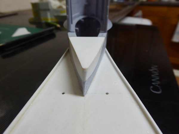

To get the upper deck to the correct height, a further 10mm has to be added to the bridging piece. I started by adding angled strip, 6.0mm square and cut to shape.
#170 Posted : 20 September 2018 19:57:55
6.0mm square strip fitted.
#171 Posted : 20 September 2018 19:59:52

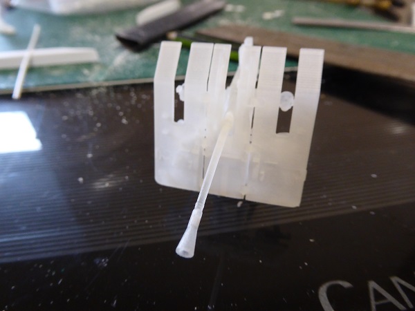

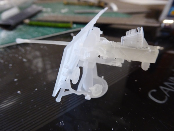

That concludes this weeks update, but before I sign off I have some more photos to share with you.
Ever since I decided to build this particular U-boat [U230] with the type IV conning tower [additional upper and lower decks], I have been conscious that I would have to source very specific armament to complete it; a 3.7cm single mount M42 flak gun for the lower deck and two x 2.0cm, twin barrelled C/30 flak guns for the upper deck.
Now, 1/48 scale isn't as popular as 1/35 scale, especially for military models and especially for 1/48 scale guns for U-boats.Blink
Maybe 18 months ago i spent an evening looking for 1/48 scale guns of the type I mentioned above, but to no avail. More recently, as I've been working on the conning tower, they have got me thinking again. I came to the conclusion that I would have to buy them in 1/35 scale, of which Tamiya make land based versions of these guns and then measure, scale down and scratch build. A very time consuming process. Early last week while I was pondering all of this I thought 'i'll have one more look' on the internet and see what was out there, if anything. Lo and behold I came across a supplier making exactly what I was after in 1/48 scale! Amazing! The company is Shapeways; they supply 3d printed parts, produced from CAD by a team of designers. The designer of the guns also designs CAD for all types of submarines and ships in many scales. Have a look if nothing else! It's good to know what is out there.
Granted, 3d printed parts are a bit on the fragile side, not a problem for me anyway, as I will reinforce where necessary. I'm just glad I have the correct armament in the correct scale!!BigGrin
Without further ado, I present to you the first of the guns; 1/48 scale, DKM, 3.7cm, single mounted M42 flak gun.

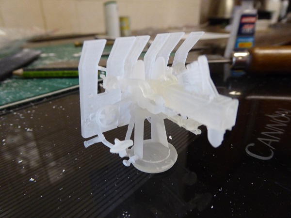

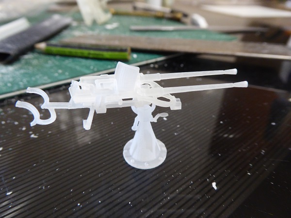

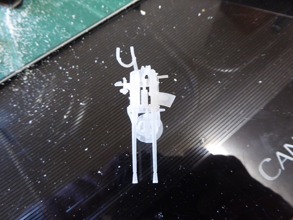

#176 Posted : 20 September 2018 20:25:54
For the upper deck; two 1/48 scale, DKM, double-barrelled, 2.0cm, C/30 flak guns. I've only included a photo of one of them.

Great update, the guns look the biz.ThumpUp
#179 Posted : 21 September 2018 07:13:39
BigGrin That gun looks the bizz and the towers looking goodCool
#180 Posted : 21 September 2018 08:12:35
Thanks Mark!Cool I'm so chuffed to have finally found the correct guns in 1/48 scale!
