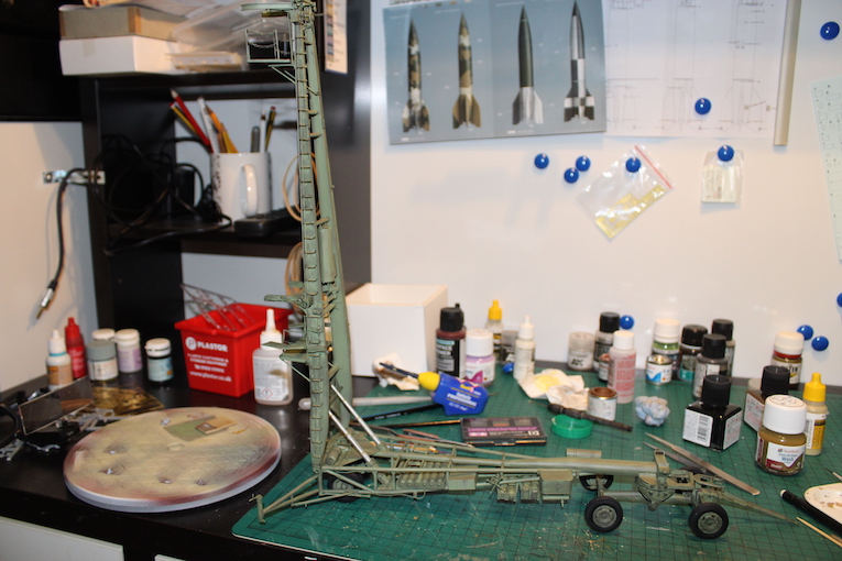

Now at the point of weathering the Hannomag I need to consider the story of the vehicle. The kit has for distant parts which all have a different story and so a different level of weathering.
The A4/V2 rocket needs almost no weathering as they are used not long after building.
the launch stand I imagine is regularly repainted after a few uses so some weathering of the flame deflector and not much else
the trailer used several times but won't be an old piece of equipment some parts see a lot of contact with people other parts nothing, some weathering required
The Hanomag SS100, that could have been in service for some time perhaps being reassigned from the front line or an artillery unit, it could be an aged asset and it sees lots of contact with people, so needs the most weathering.

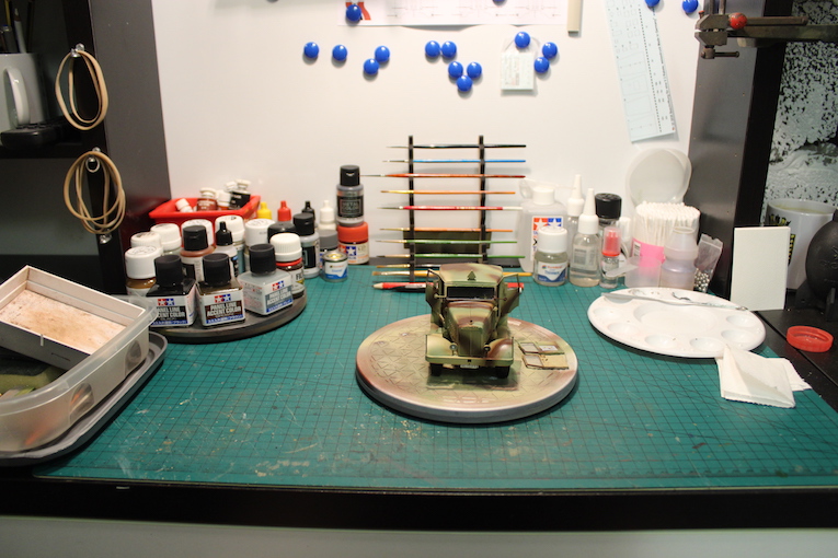

I dont always know where the weathering is going to take me so I set up to have all possibilities to hand so I have what I need as my thoughts unfold during the process.
I thought it was worth sharing what I pulled together for this task
First a collection of brushes in different sizes for washes, chipping, clear coating and dryprushing.

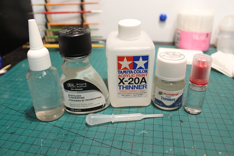

Assorted thinners, enamel and acrylic turpentine for tube oil paint the small bottle has white spirit for manipulating washes the large dropper bottle distilled water for thinning ready thinned paint and a puppet for ensuring no contamination.
I keep a selection of empty bottles to hand so I can keep a particular paint or was mix if I run out of time before finishing, the large open bottle is filled with water and used for dip cleaning brushes to ensure they don't clog while in use, the scoop will have white spirit in it for the same purpose but for oil based paint.

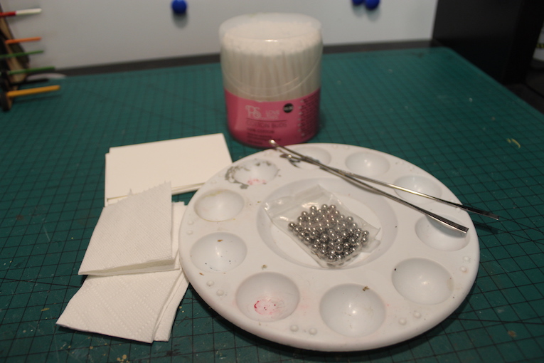

pallet used for decanting and mixing paint, I keep a bag of mixing balls and always ad one to new paint when first opened, much better than a paint stirrer. I use the paint stirrers if I have any heavy settlements to shift the wide end is great for scraping pastels. the cotton buds for controlling runs etc. the white cards are used for checking paint shading for effectiveness the tissues is used for quick brush drying, removing paint from brushes for dry brushing and emergency mop up!!LOL
I have pulled together a selection of tube paint that I may need, as well as other paints that agin I may need or I know I have to use such as the black and yellow for the convoy triangle.

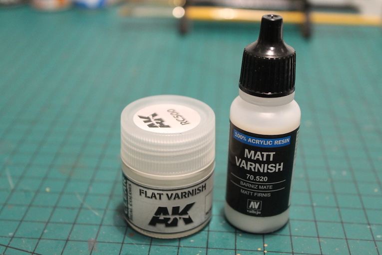

I have two options for matt varnish I will test both and decide which gives the finish I prefer for this job.

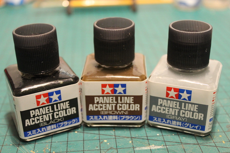

I have the full range of Tamiya panel line accent, these have applicator brushes in the lid, effectively a pre mixed wash they do save time.
I am a big fan of the Vallejo metal color range, the chrome is great for mirrors etc and the burnt iron makes for a good worn metal finish.
I have an ever growing collection of washes and filters, I selected the likely candidates.

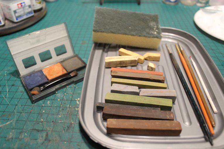

I have a small selection of pastels and weathering powder, the sponge and worn brushes are only used for applying powder never for paint.

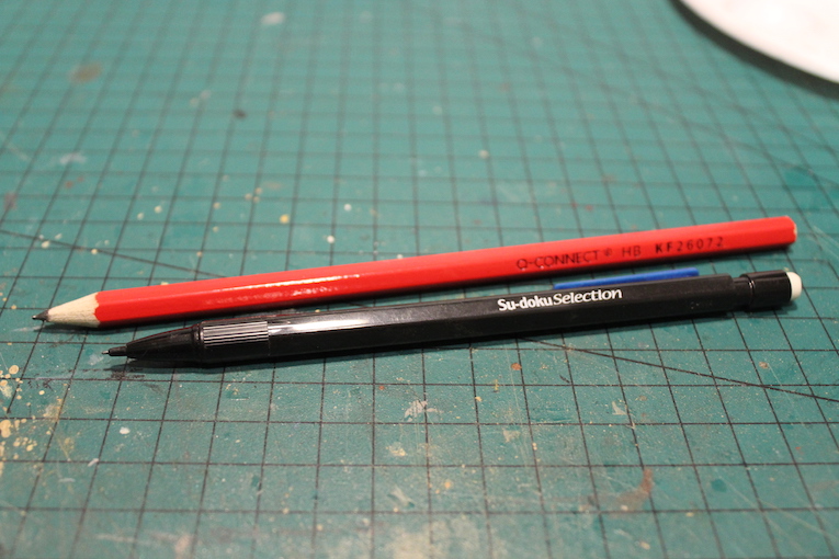

The humble pencil is great for metabolising detail such as worn footplates.
so we are ready to add some depth to the final model.

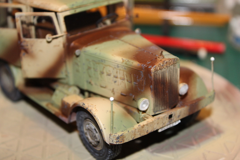

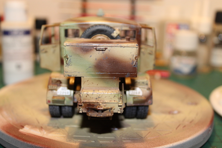

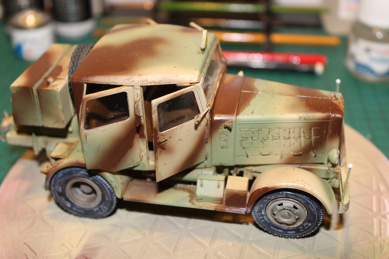

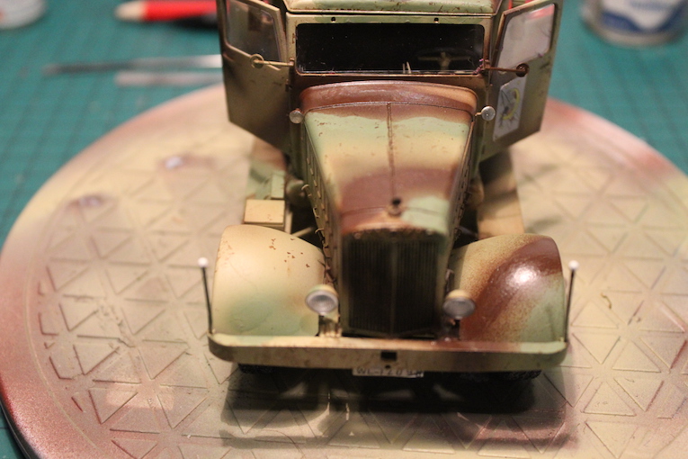

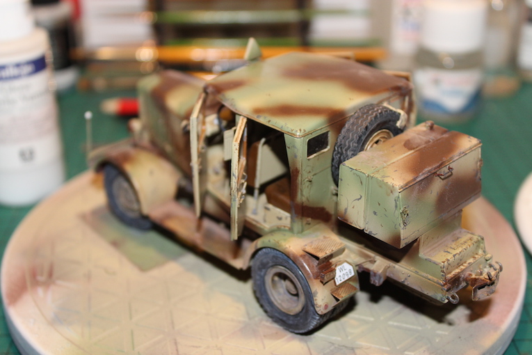

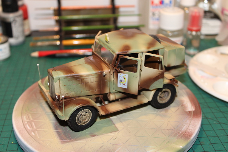

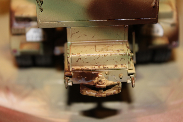

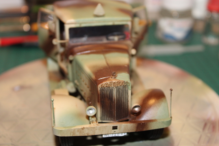

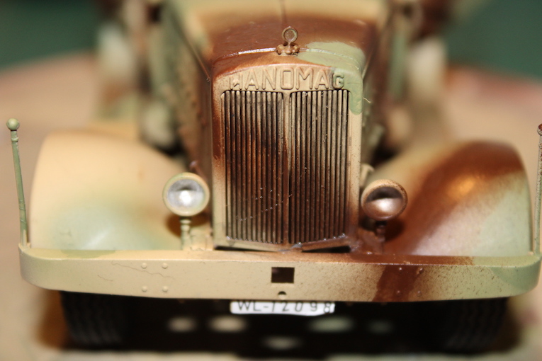

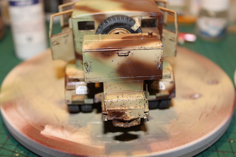

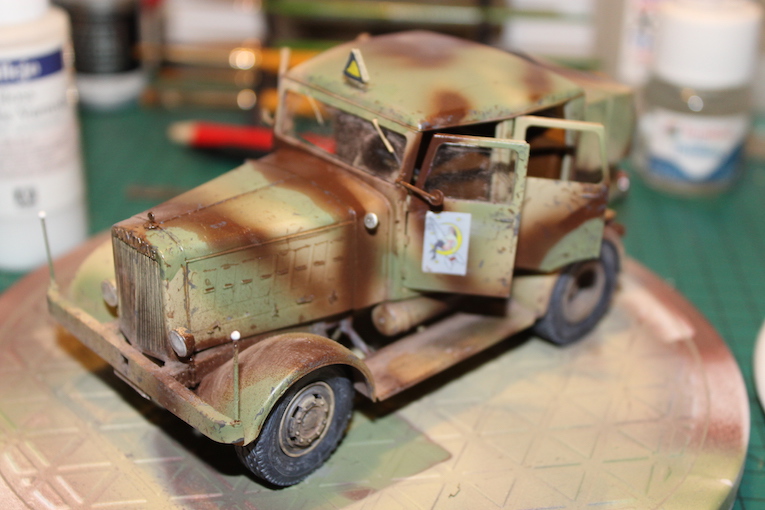

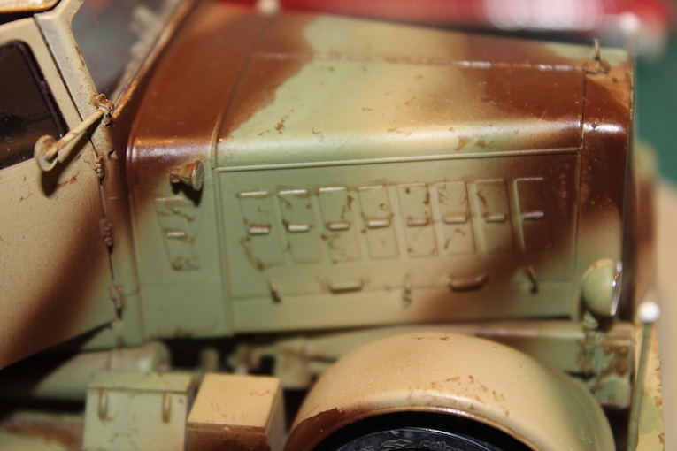

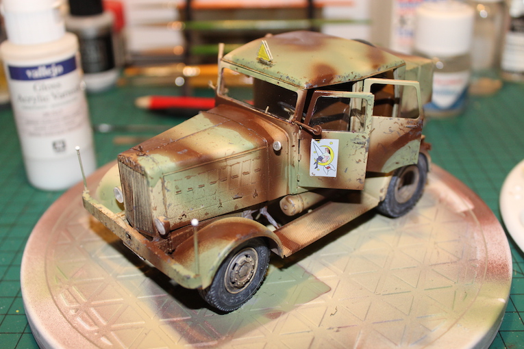

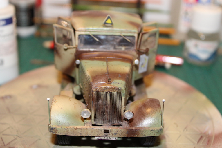

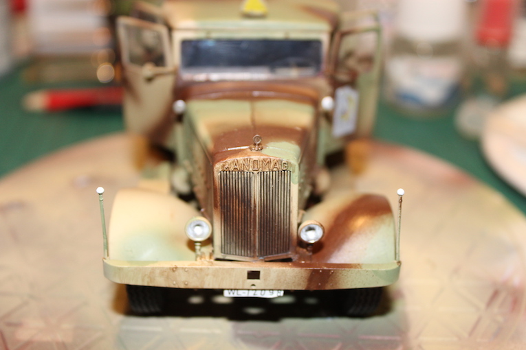

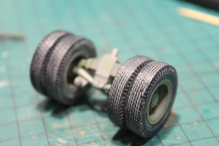

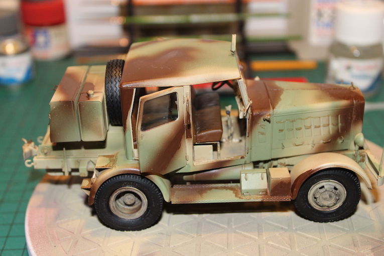

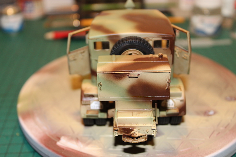

weathering of the Hanomag starts with a black panel line was applied to the radiator and wheel rims. I then applied a brown filter to the hole thing. A brown pin wash was then applied to some ares such as the girl foot plates.
Chrome paint was used for the wing mirrors additional lamps and heal lamp lenses as well as the rear reflectors. the forward doors can then be fixed in place.
The kit comes with either clear lenses or black out covers, I went with clear lenses. the width markers had their tops painted white at this point.

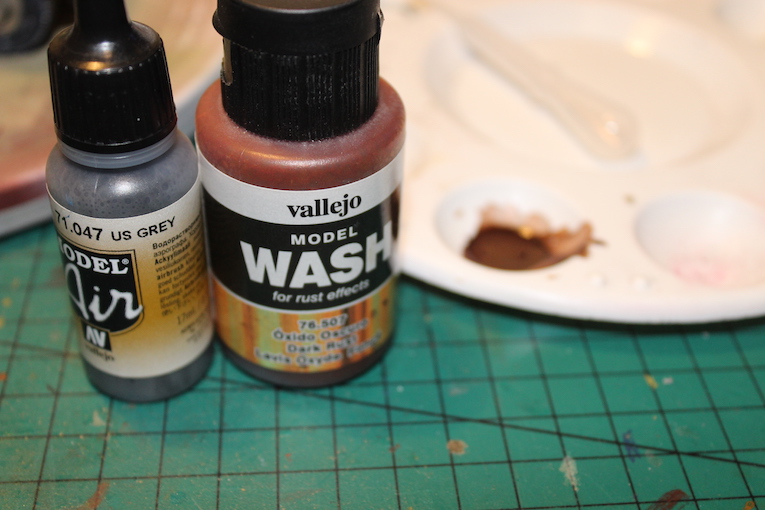

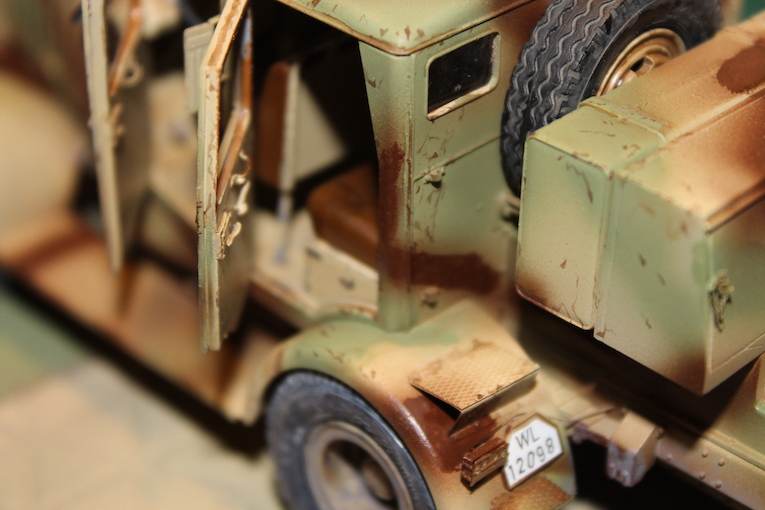

My next task was rust chipping, this was done by mixing grey and rust paint, 4 drops grey to 2 drops rust. The chipping was done with focus on heavy we are areas but also to give an all over worn look. the tyres were given a wash of dust.
The second round of chipping was done with just dark grey paint.
Finally I used a mix of pastels to Ade muck grime and try and calm down the starkness of the chipping

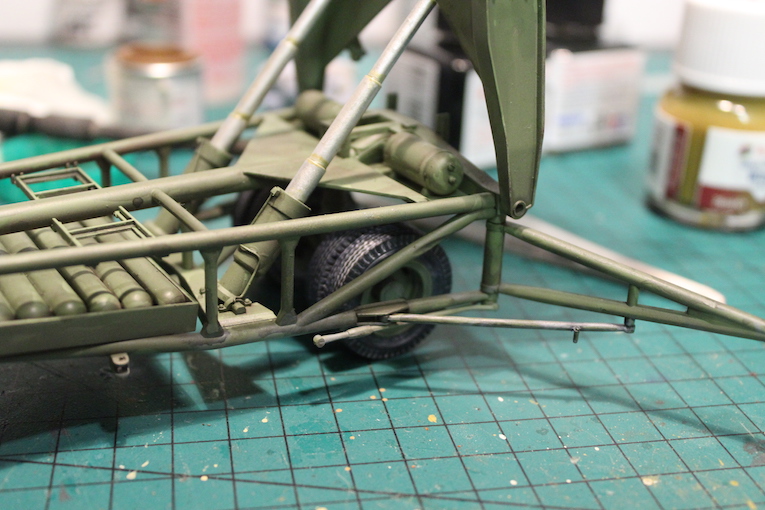

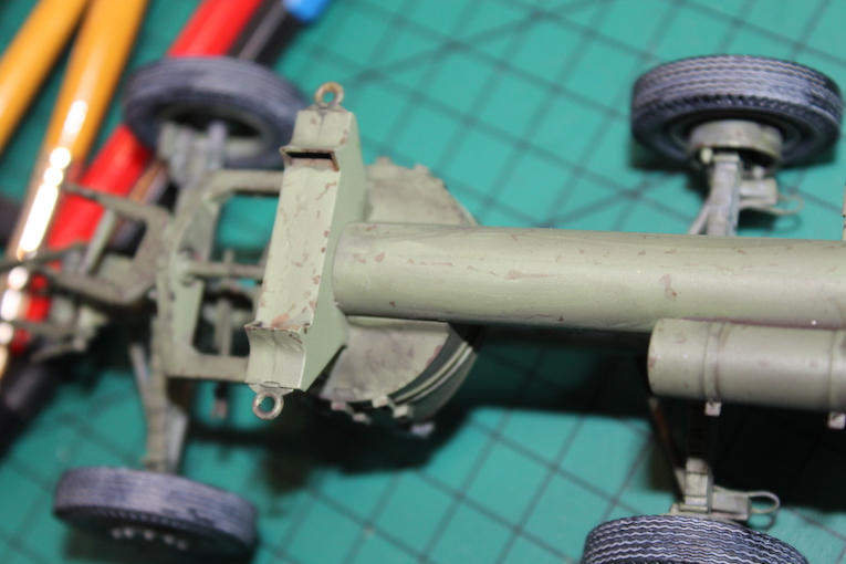

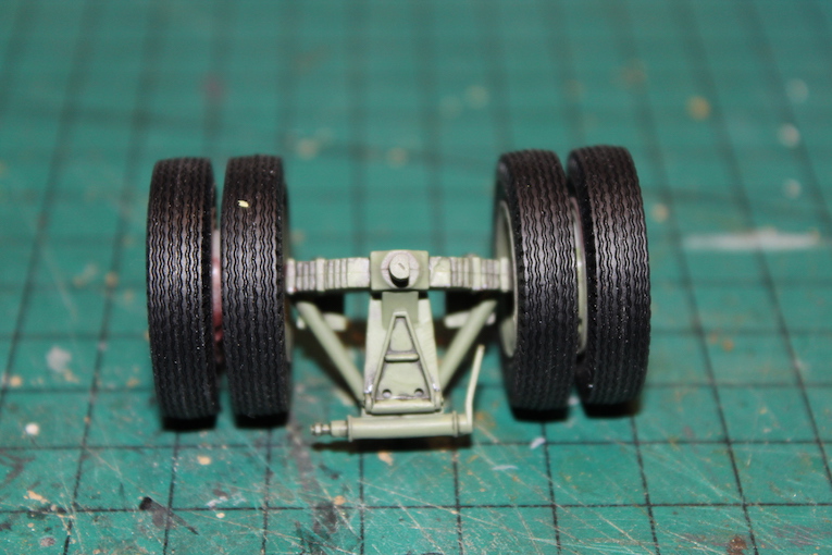

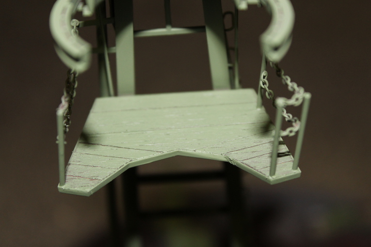

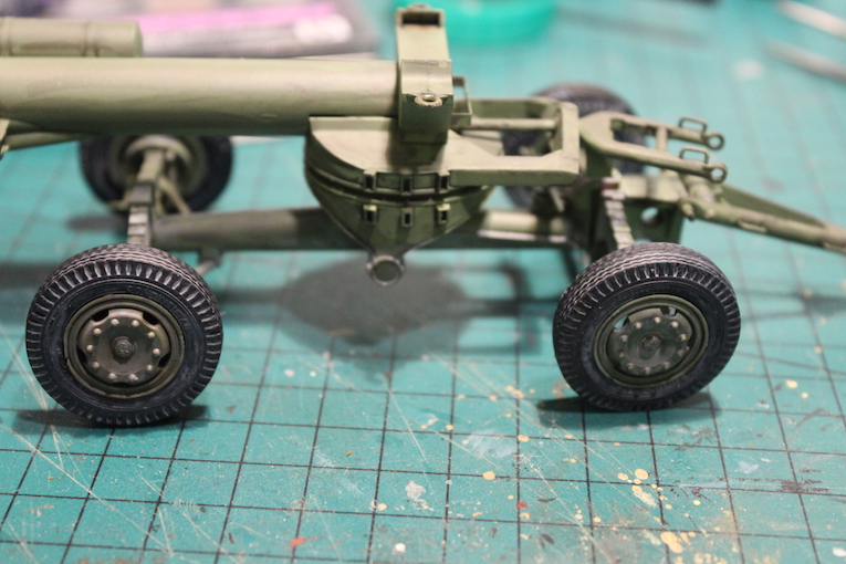

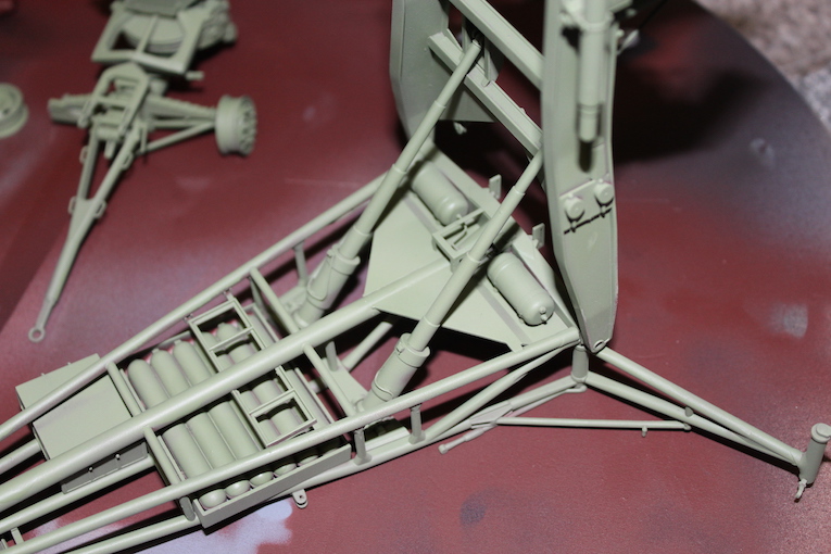

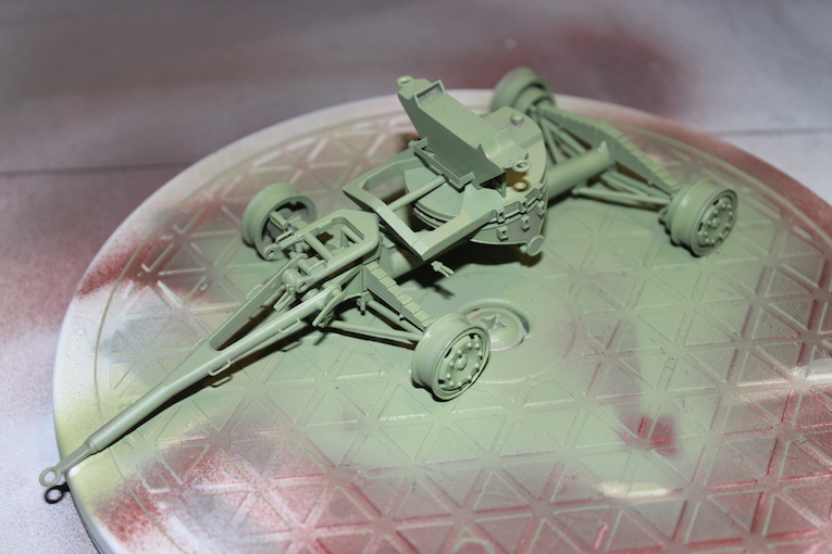

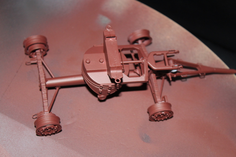

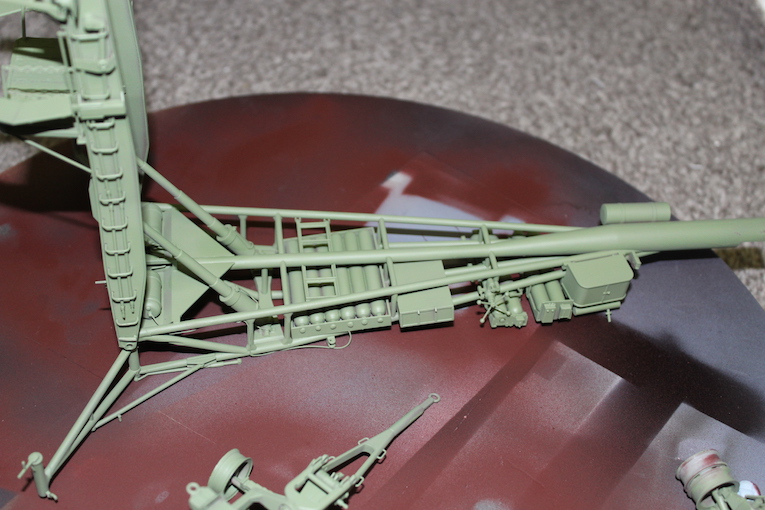

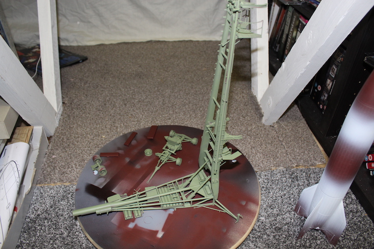

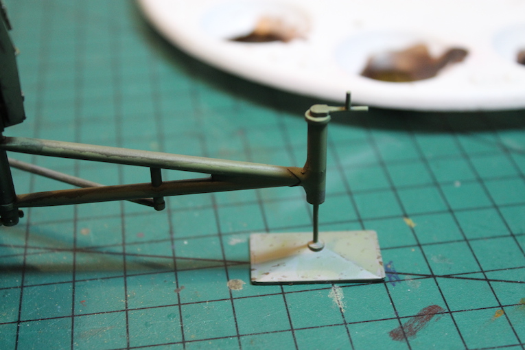

Painting the trailer starts with priming in the same way as the rest of the kit. The two top coats are the same late war green that I used on the rocket launch stand.

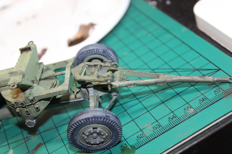

#168 Posted : 16 July 2018 22:24:52

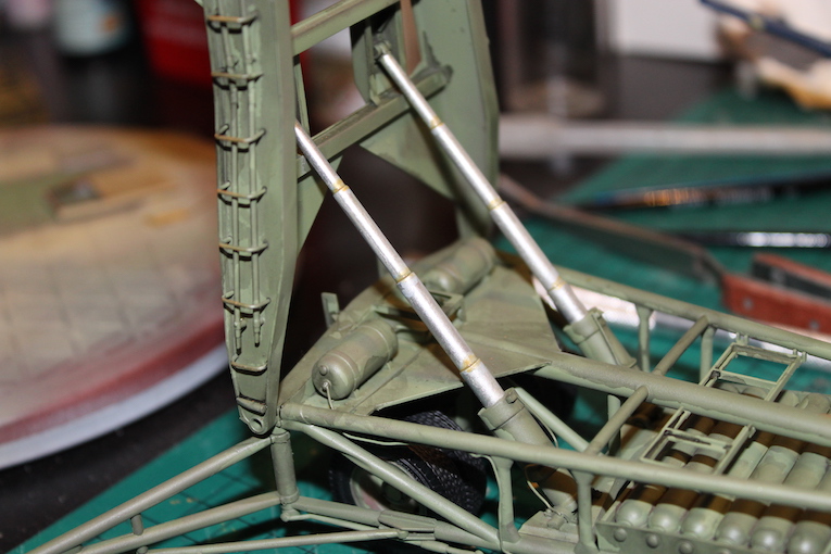

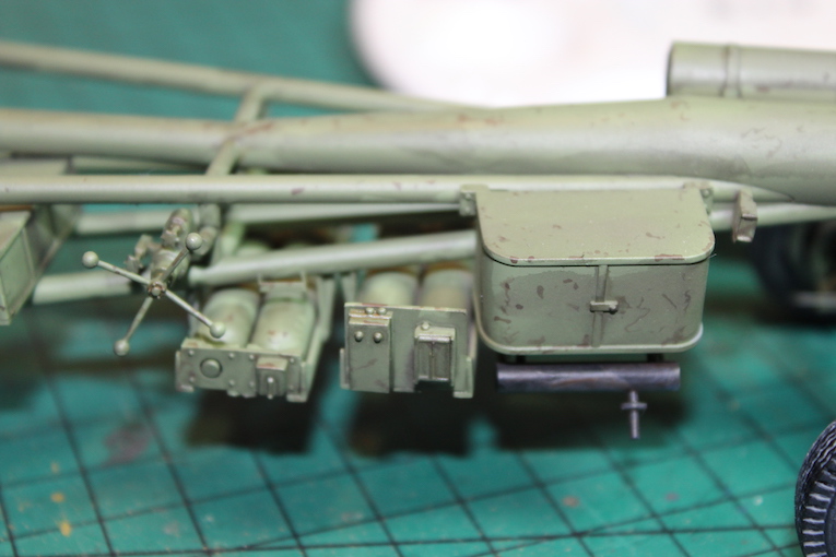

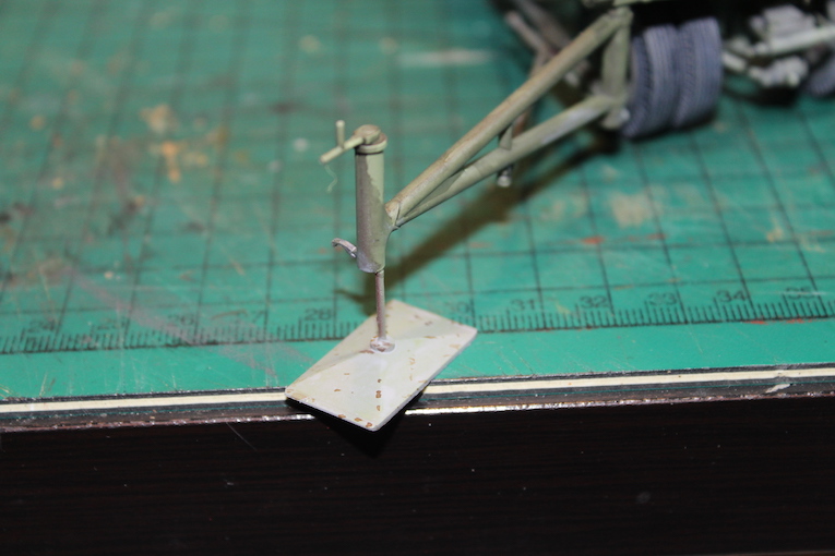

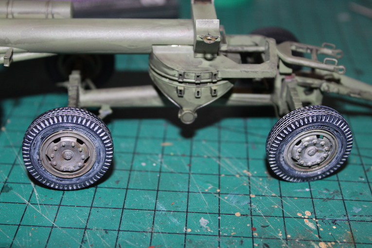

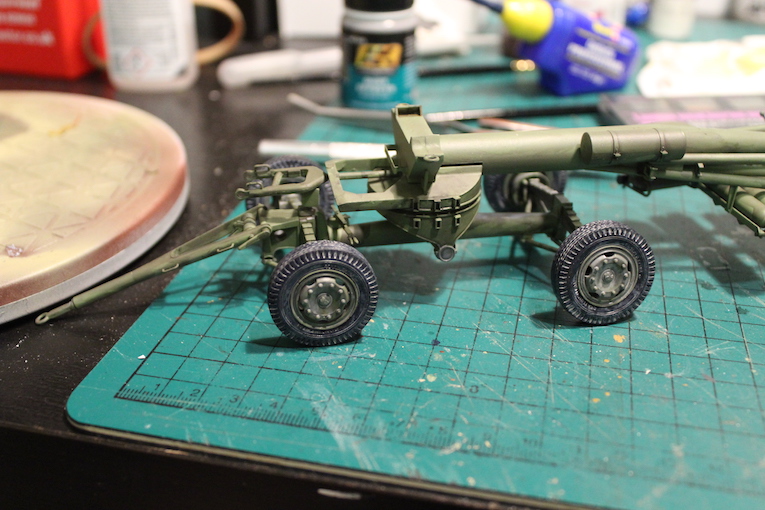

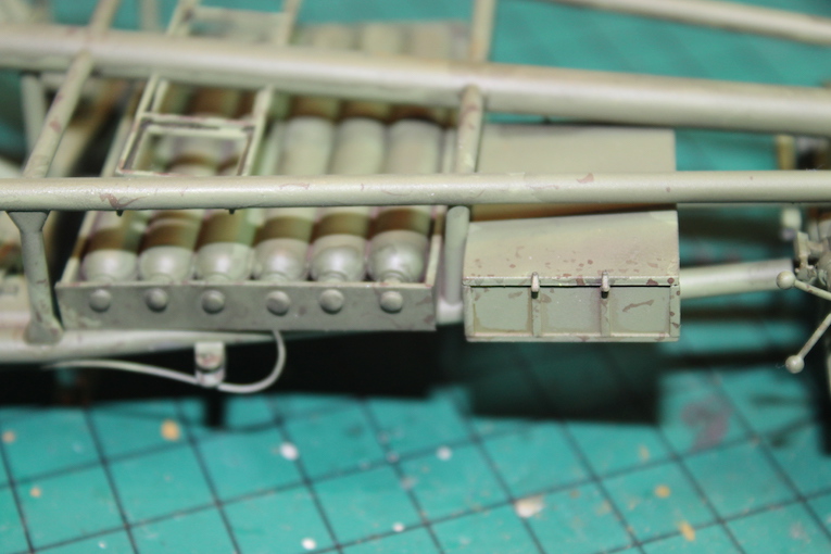

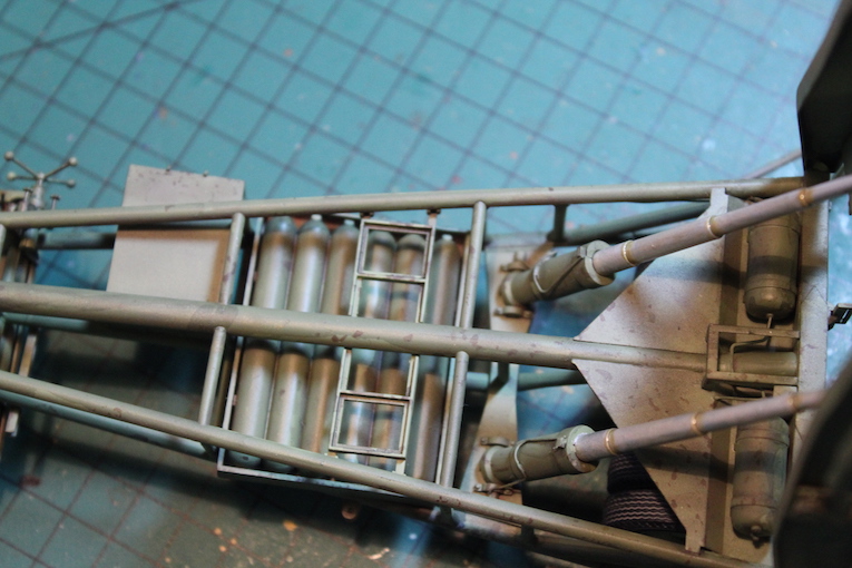

Just like the Hanomag I started with a black pin wash for the wheels and suspension.
The hydraulic rams were painted chrome and then a pin wash in umbral oil stain.
the whole thing was then given a wash of burnt umber and black mix. the rungs were given a dust of orange and brown pastel to look a bit like fresh rust.

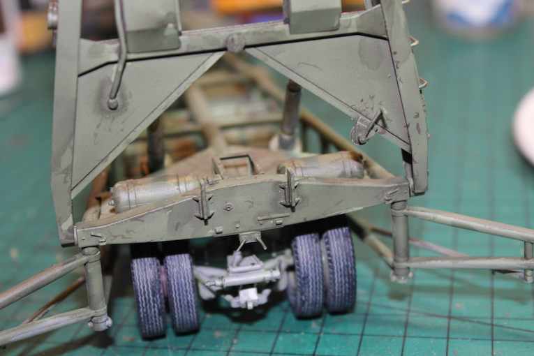

I then applied a black pastel applied with a sponge to the surfaces to add variation to the green paint.
The wheels and some parts I imagined would get kick up from the wheels with dust wash.

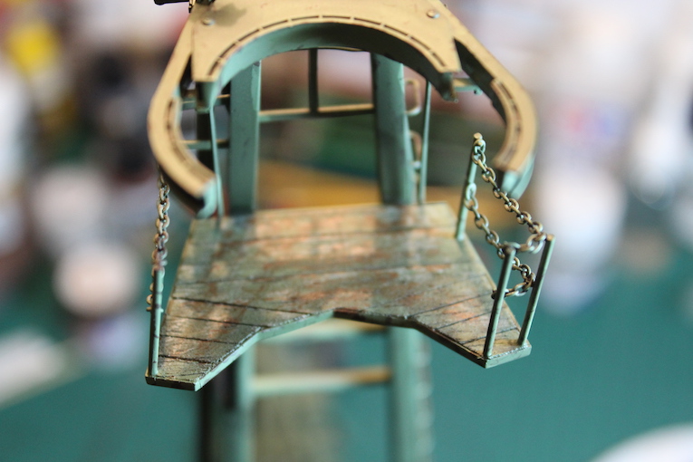

I used the same prices for chipping starting with a rust grey mix then a pale grey

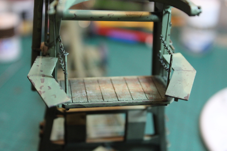

The wood platforms were given a black pin wash to bring out the texture followed by a dust of pale grey pastel with a brush then a mix of brown and grey pastel was applied by a sponge to simulate a warn look and the dust of boots.
finally a HB pencil was used to metallise rungs and Handels
That completes the buildBigGrin Cool
