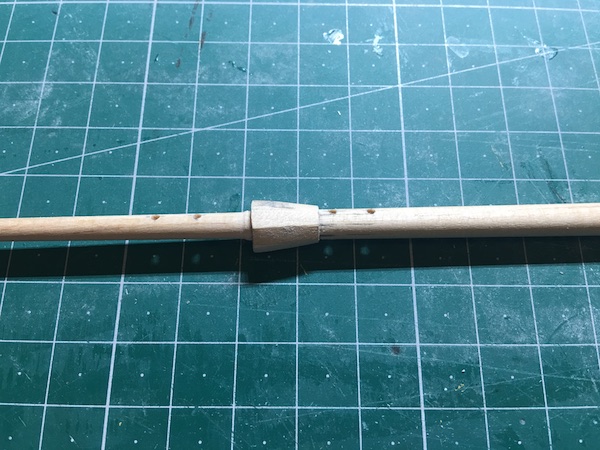

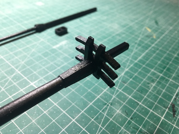

After couple of days pause some work done:
Issue 69:
- Octagon on fore topmast completed and tapered
- Bottom of the topmast also carved to octagonal
- Hand mast and rope guide made
- Rope guide glued to mast cap and painted black
- Hand mast and topmast also painted
Happy building!

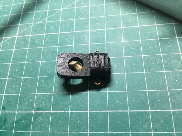

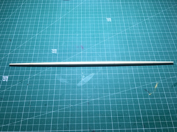

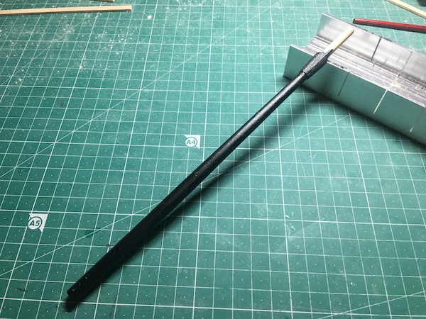

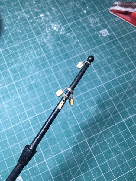

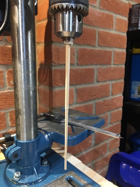

Today's work so far on Issue 70:
Fore topgallant mast tapered.

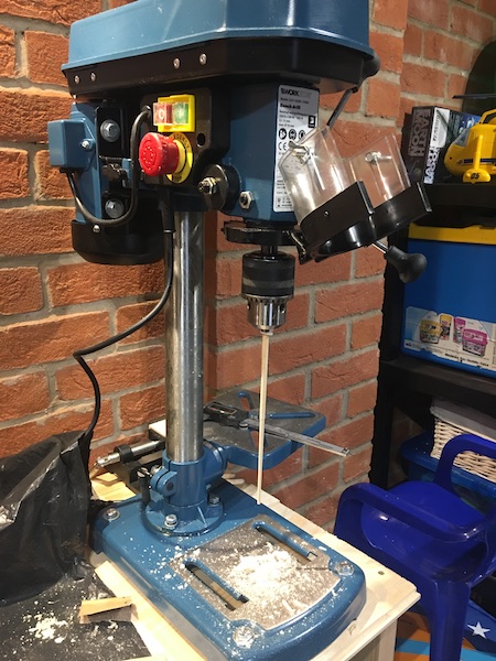

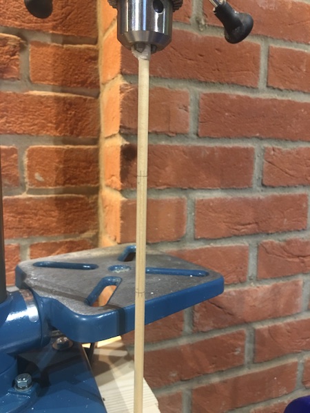

I upgraded the method what I used for tapering the studdingsail booms and showed in this post:
http://forum.model-space.co.uk/default.aspx?g=posts&m=263291#post263291
As the diameter of the topgallant mast is too big for the chunk in my Dremel I used my pillar drill with the same technique to wrapping sandpaper around the mast and moving it up and down to shape the perfect taper.
Basically it works like a vertical lathe.
The result is beautiful... I wish I was used this method for the main mast, would have been much quicker.
With this method I completed the tapering on the fore topgallant mast (incl. the step in it) within 15 minutes.

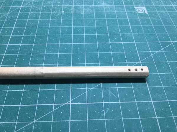

After tapering completed I made the octagonal hounds, also the octagonal carving at the bottom section.
Holes drilled, bead glued to top.
The mast and mast cap painted black.
Topmast cross trees glued in place and painted black.
Will carry on rigging and assembling the parts later on today, after the paint dried.
Happy building!
Laszlo

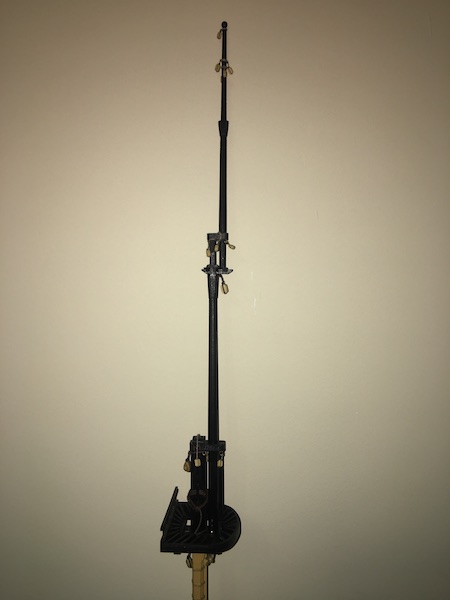

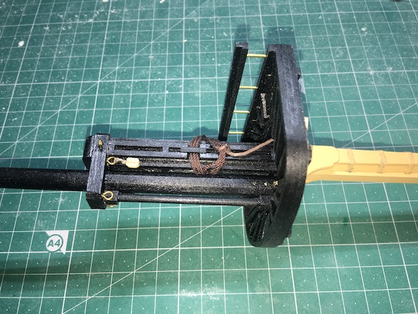

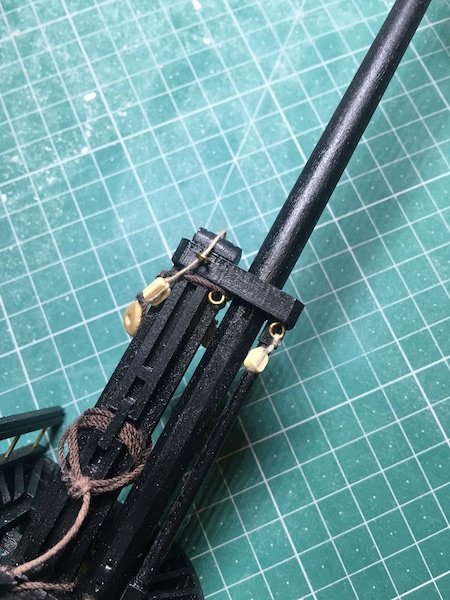

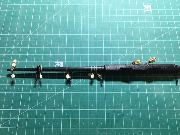

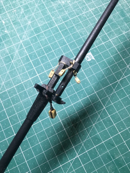

Busy day today, Issue 70 finished:
- Topgallant mast with mast cap assembled to the fore topmast.
- Brackets and cradles fitted
- All rigging blocks fitted.
With this now the fore mast fully completed, will be test fitted to the hull tomorrow.
Two masts done (main and fore), two to go (mizzen, bowsprit) BigGrin
Happy building!
Laszlo
#170 Posted : 22 December 2017 09:32:17
You make that mast tapering sound easy but it looks difficult to me. You know what your doing though and your results are very nice.

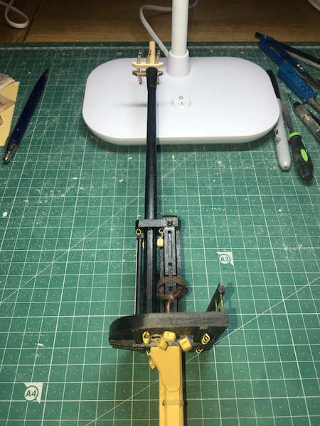

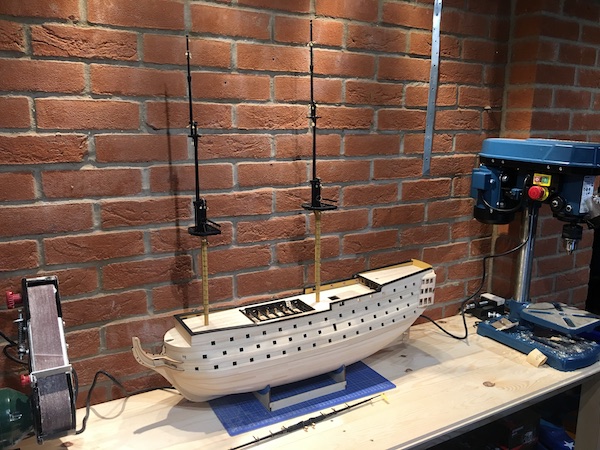

As promised, today I test fitted the fore mast to the hull together with the main mast.
Next to the ship is the main yard on the bench.
Isn't it looking great? Cool
Happy building!
Laszlo

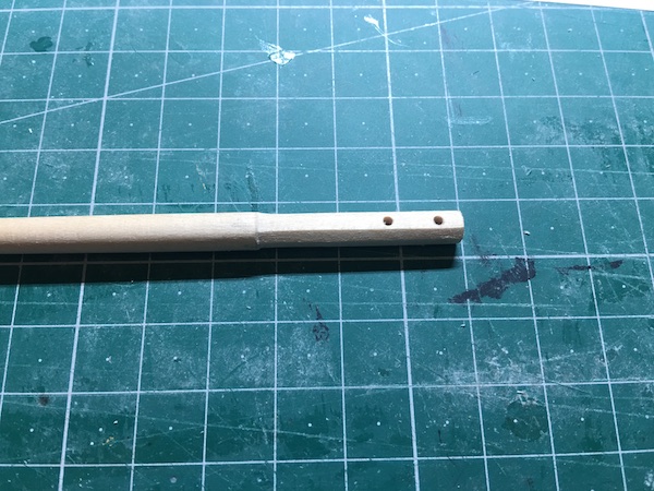

Started to work on Issue 71:
With the same technique with my pillar drill I tapered the fore yard to the required diameter.
It was a bit more challenging as the yard is longer than the topgallant mast, hence I had to turn the upper part of the drill away from the base to provide a bit more space.
Also after one end is tapered it was a bit more tricky to hold the tapered end in the chuck vertical but I managed to do it, resulting nice and equal tapering on both ends.
Happy building!
Laszlo

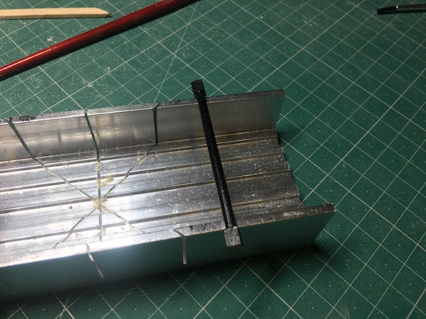

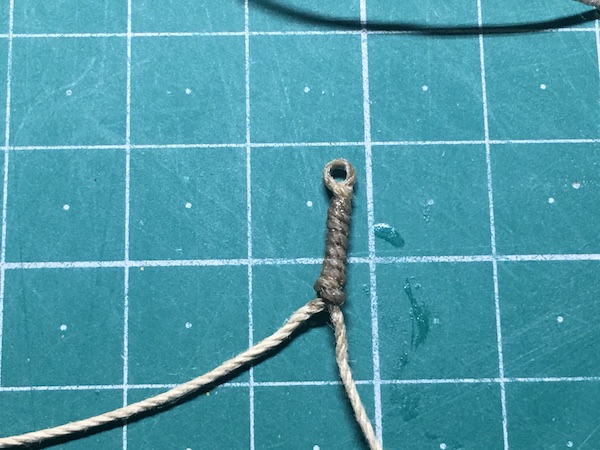

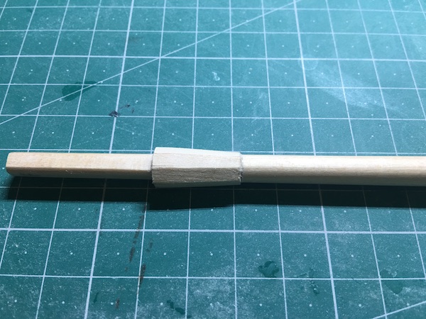

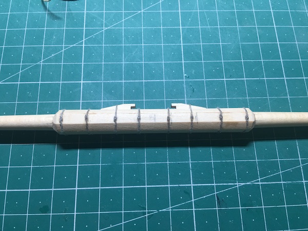

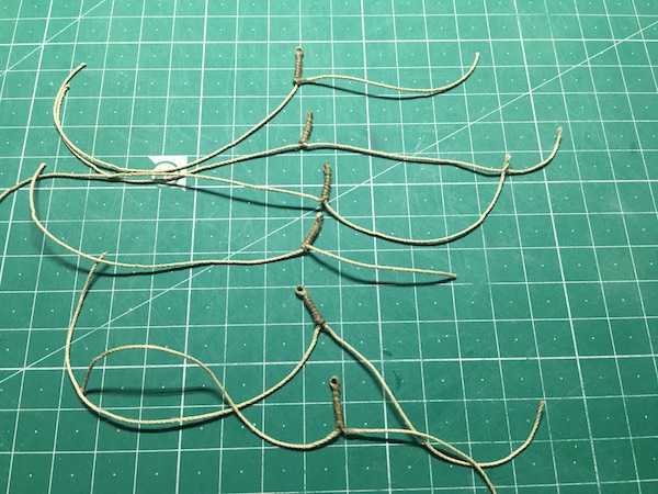

Further work today in Issue 71:
- Octagonal section added to fore yard
- Slings and bands added
- Six footrope supports made, again I used my own invention from thread as they are made from ropes on the real ship, not brass as in this kit. See details on this on my earlier post if you're interested:
http://forum.model-space.co.uk/default.aspx?g=posts&m=263336#post263336
I had to stop for today as my fingertips are covered with superglue, as a result of making the footrope supports. Laugh LOL
Happy building!
Laszlo

#177 Posted : 24 December 2017 18:09:07
Joined: 30/11/2017
Posts: 493
Points: 1,482
Location: South Norfolk
Hi Shipmates,
First of all, I'd like to wish Merry Christmas to all of you, who are occasionally or regularly reading my build diary.
Some work still done today on Issue 71:
- Studdingsail boom irons fitted
- Footrope supports rigged to the yard
- Yard painted black.
I'm note sure why Blink but I left the irons unpainted, even if the magazine saying to be painted.
I also done it this way on the main yard, maybe I though it's better to show that they are made from metal.
Happy building!
Laszlo

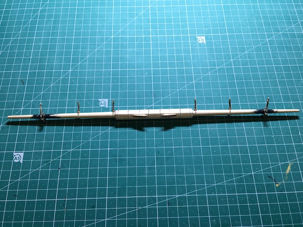

#178 Posted : 24 December 2017 21:30:39
Very nice work.
You are rwally good at getting your tapering nice and even across either end of these parts.
#179 Posted : 25 December 2017 00:16:32
Very nice work, coming along very nicely....Cool
gingerale75
#180 Posted : 25 December 2017 00:54:52
Joined: 30/11/2017
Posts: 493
Points: 1,482
Further work done on Issue 71 while waiting for Santa.
No sign of him so far... LOL LOL LOL LOL
One side of the fore yard fully rigged.
Happy building!
Laszlo
