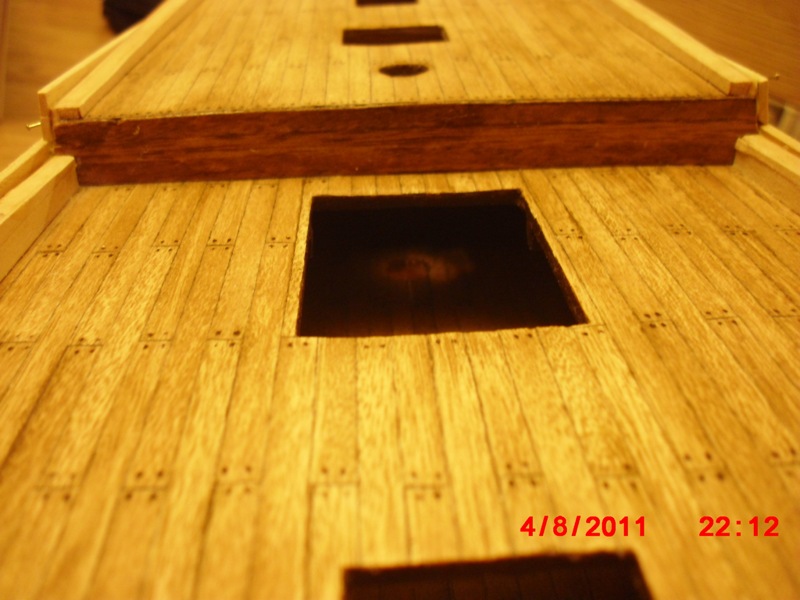

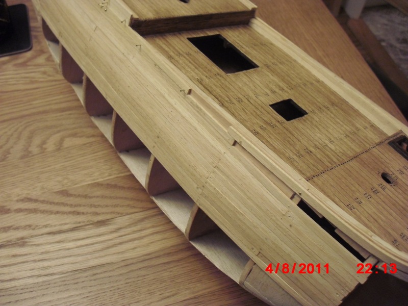

I decided to continue planking this side and use up all the planks I had received so far ( 2 packs 20 planks per pack)I was very happy withe the result,although the planks as I mentioned before did not have consistant thickness, but as this is a double planked model the thickness is not critical heres how she looked after the planking :-

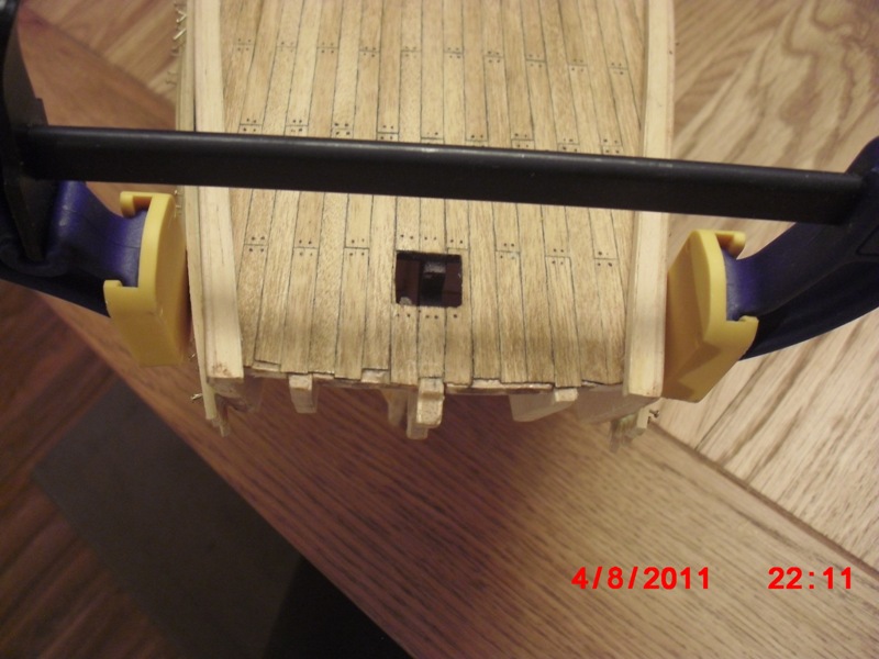

Finaly this is some more photos for you to judge the build, thank you for watchingBigGrin

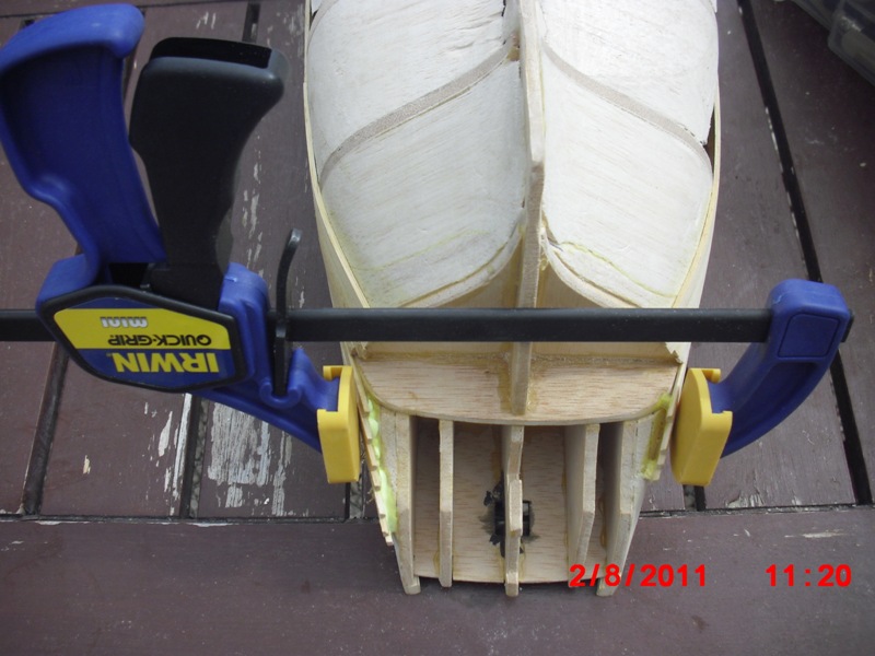

I am pleased with how the stern looks with the balsa infills doing their job, heres a photo of the stern with one of my trusty longbars doing its JobBigGrin Cool

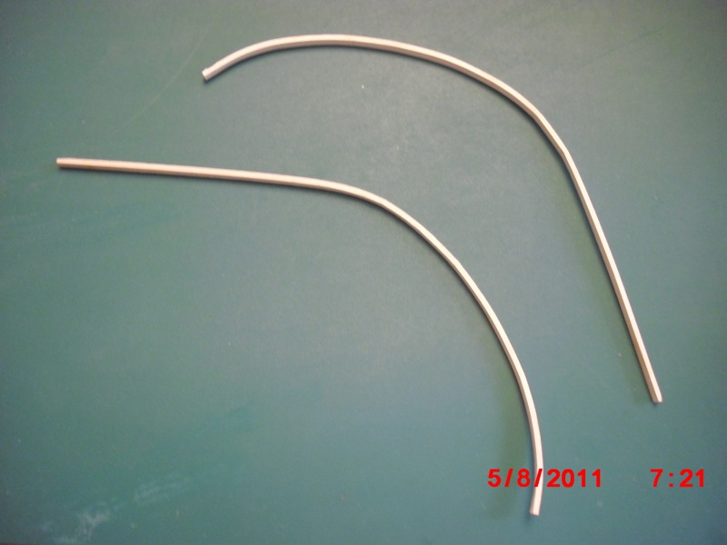

Hi everyone here is the next instalment of my Endeavour build.
I an continuing with the Hull planking, first up I am covering how I prefer to bend planks to go round those tricky curvesBlink we have one of those curves on the Bow of this Ship, here is what I do:-
1) Put the planks in a suitable recepticle.
2)Fill with very hot water.
3)Place a heavy object on the planks to keep the submerged.
4)Leave for 30 mins at least.
Here are some photosBigGrin

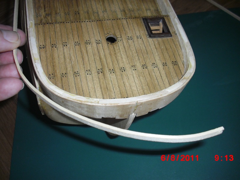

#173 Posted : 06 August 2011 11:34:22
Next I take these wet planks and fit them to the ship WITHOUT GLUEING!!!useing pins/nails/clamps depending on space.
At this point they do not have to be fitted in the exact position, but they do have to be fitted to the curve.
Leave them to dry out completly at least 24 hours, then remove them,and shape them if you have to, then fit them.Some more photos:-
THIS IS MY METHODE OTHER PEOPLE ON THE FORUM WILL HAVE THERE OWN PREFFERED WAY OF BENDING PLANKS!ThumpUp
