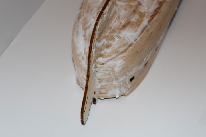

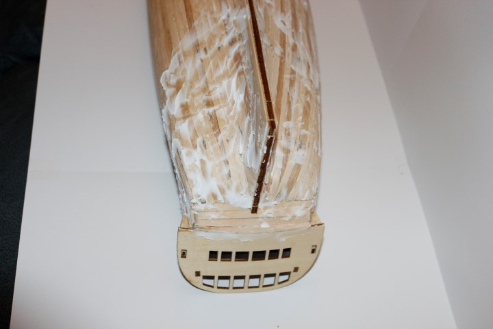

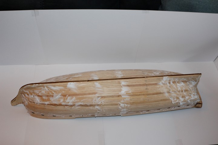

Quick update on the HERMIONE build:
STAGE 13
Hello again,
This weekend I've started on the filling of the hull.
I'm using a new product to me called 'red devil OneTime lightweight filler' (see link below). Have to see how I get on with it.
filler
I've gone over the hull for the first time with it and will sand it down again tomorrow. It will then be ready for its first coat of primer which will show up any more imperfections which need either filling up or sanding. More on this to follow.
Thanks for all your very welcome comments and for looking in again.
Happy building
David

@Martyn and Graeme. I was using the 'cheap & cheerful' alternatives but thought I'd give a 'specialist' filler a try. It is indeed much lighter than I was used to and it is much finer and filled the smaller gaps much easier but time will tell once it's been sanded and primed.

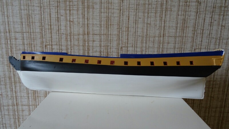

#175 Posted : 27 September 2017 17:30:24
Joined: 25/08/2017
Posts: 14
Points: 51
Hi David.
I think I am slightly in advance of you with the hull build and and have just come against a problem which I don't think is of my making. I am about to start on stage 17 which requires the use of a scraper shown in image 120.
I had ordered a scraper set but on investigation the correct shape was not present on the scrapers I had been sent. After long discussions with one of the customer help staff we realised that there are two scraper sets available, 17000 and 17001.
Nowhere could I see an option on the purchasing web site to select between these different versions and I had been sent the wrong one for this particular stage. It would appear from the notes relating to this stage that it may be necessary to have both sets.
Does anyone know if both scraper sets are necessary for Hermoine ?
Hope the sanding down and painting goes well.
Norman

clockmaker
#178 Posted : 28 September 2017 11:32:57
Joined: 25/08/2017
Posts: 14
Points: 51
Hi David.
Thanks for comments on painting. Normally I make a mess of painting. Was very pleased how it came.
I used the Admiralty range of water based paints obtained from Cornwall Model Boats. The yellow is their yellow ochre.
I brush painted the white and yellow but air-brushed the black and blue as I though there would be less chance of bleeding under the masking tape.
Thanks for the Artesania Latina web site info. Found what I wanted. Much more comprehensive site.
Norman.
